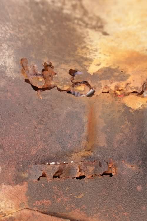

Getting through the bonnet stripping, at least most of the paint is off now. Just a fair old bit of surface rust and two small holes:
Here's some of the rust... Flap disc seems to be quite ineffective against it, unless I'm using it wrong? What should I be doing here? Any ideas would go a long way.

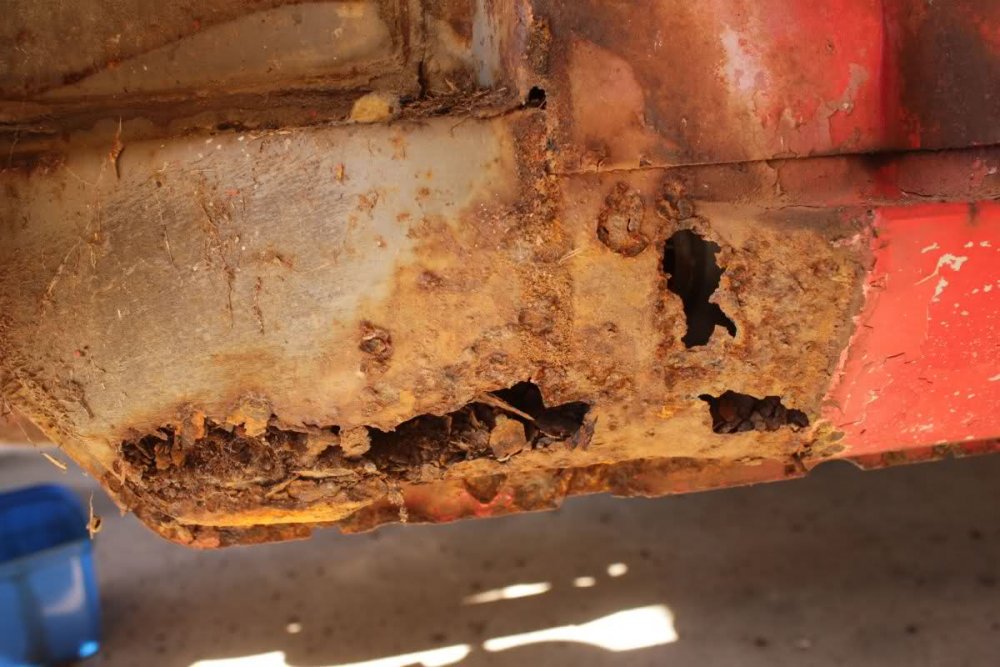

I couldn't get the passenger side fender off because one of the bolts that holds it to the sill has rusted round, and since the head is recessed beneath the fender I can't get a grip with vice-grips... What should I do? Also I pulled the fender up to have a peek at the rail, it's definitely much worse than the drivers side. Not totally rogered, but will require some sheet welded on.
Oh, and there was this little surprise waiting for me underneath:

With the bolt in the fender, you can try screw extractors, these dont always work and sometimes just butcher what is left of the bolt, or you can drill it out and retap it.
I wouldn't use an 80 grit flap disc on the panels to remove paint or rust, it would gouge the metal too much, what i see in the pic you posted is beyond surface rust, something like that needs to be cut out, it's too pitted... but bonnets aren't that expensive so i would look for a good second hand one.  ;)

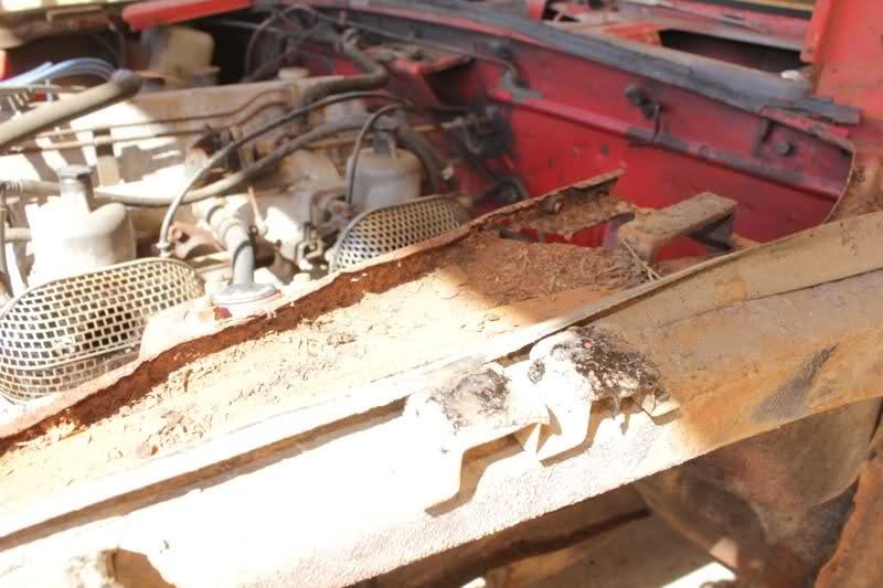

Going to have to get creative with some sheet metal in here;
Underneath the passenger fender. Other than the bit of thin sheet that bolts the fender to itself, the whole thing looks pretty solid.

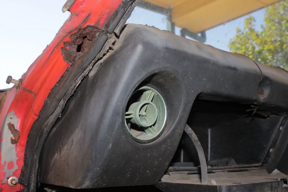

And in the A pillar. This is a bit concerning as I've got no idea what lies underneath that a-pillar... I get the impression that I'll have to pull the roof-skin and a-pillar skins off at some point to assess how bad it is under here, correct?
