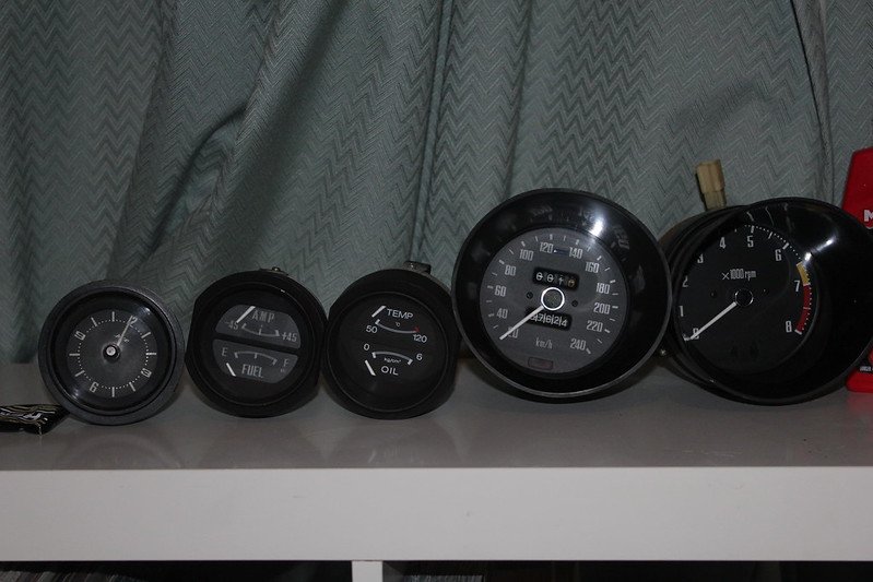

Decided to rip the gauges apart:
Before and after:
Nice and shiny:
Happy with how the tacho and speedo turned out! Can see the numbers reflecting off of the black surround. Will look pretty cool when I'm driving it one day hahah.

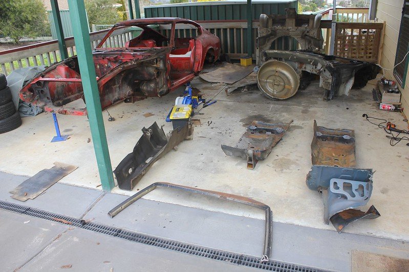

Attacked with ye olde trusty 4"
Decent sill panels, floors, footwells, spare battery tray, spare spare wheel well, good A-pillars + front roof rail.

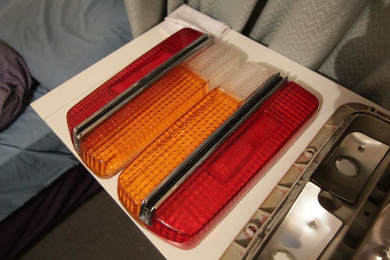

Cleaned up tail light lenses. Might get the centers re-chromed down the track, but that's a while off:
Photo of all the guages done:

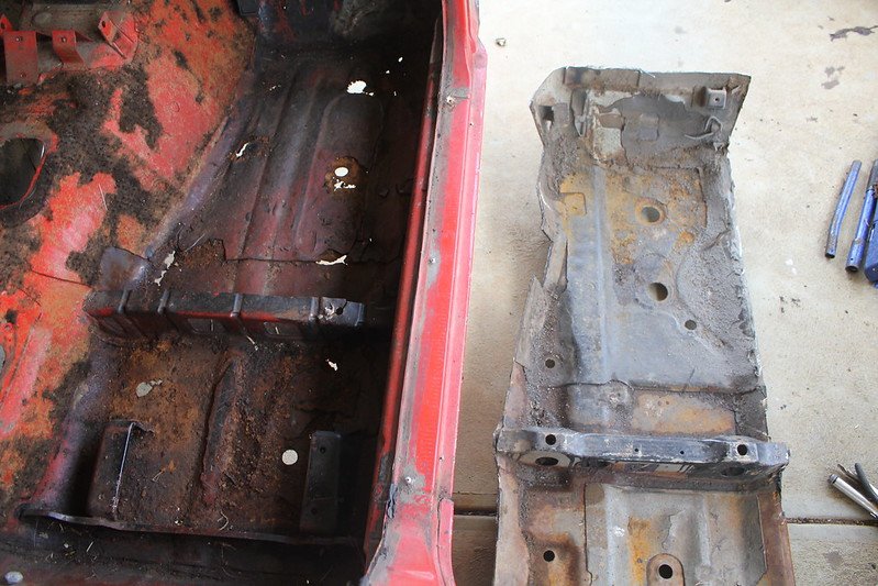

Comparison of floors. I mainly got it for the footwell section, because that was boned. Probably not worth getting new floor pans, as I think these replacements are pretty good.:

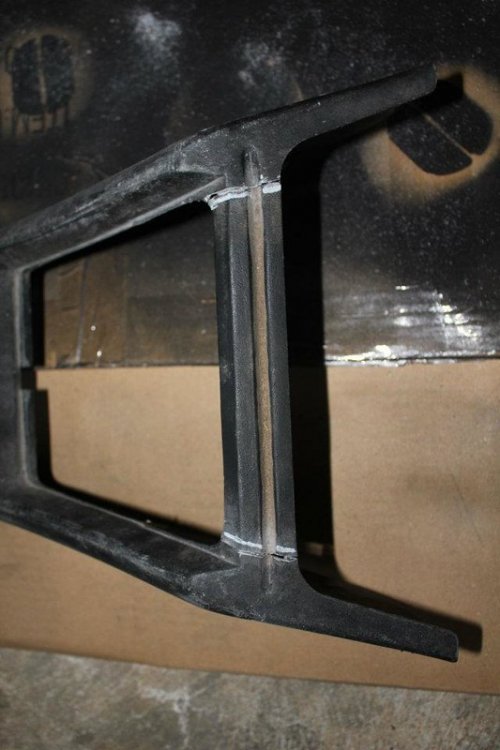

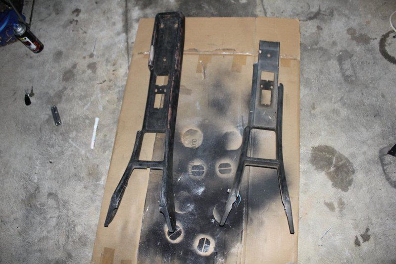

Bought this center console from Dimitri aaaages ago, can't remember if I posted it up or not.
As you can see, it didn't have the front support bar thingy, so I cut it out of my old one and made one good console! Will need to spend a bit of time on the joins, but not going to bother until it's time to put it into the car.\

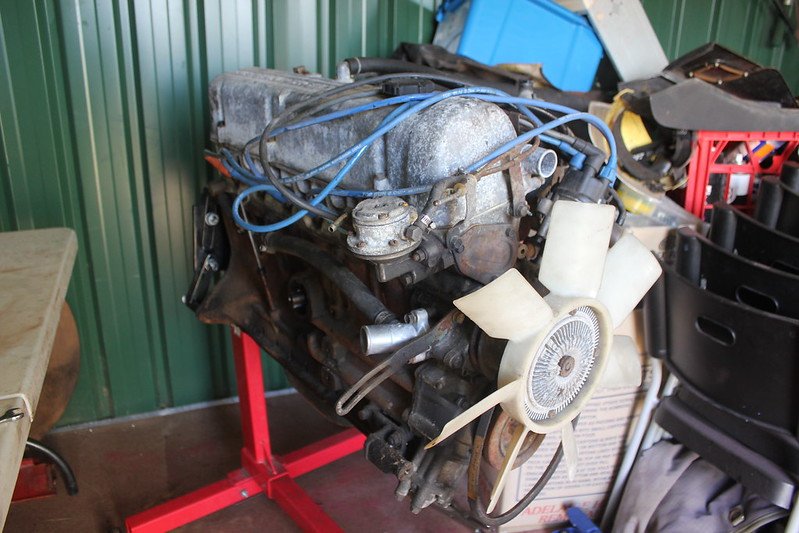

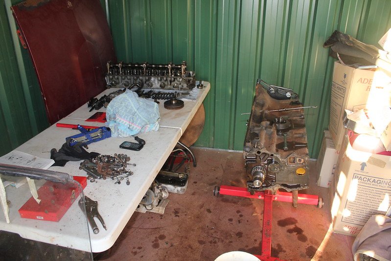

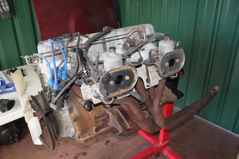

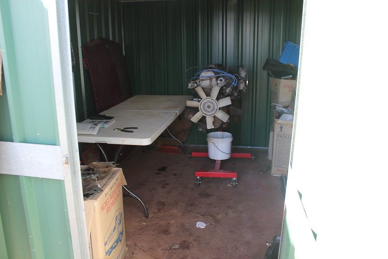

So. Engine.
Managed to get it around the side of the house, down a small flight of stairs, through a small door and up on it's stand. That was fun.

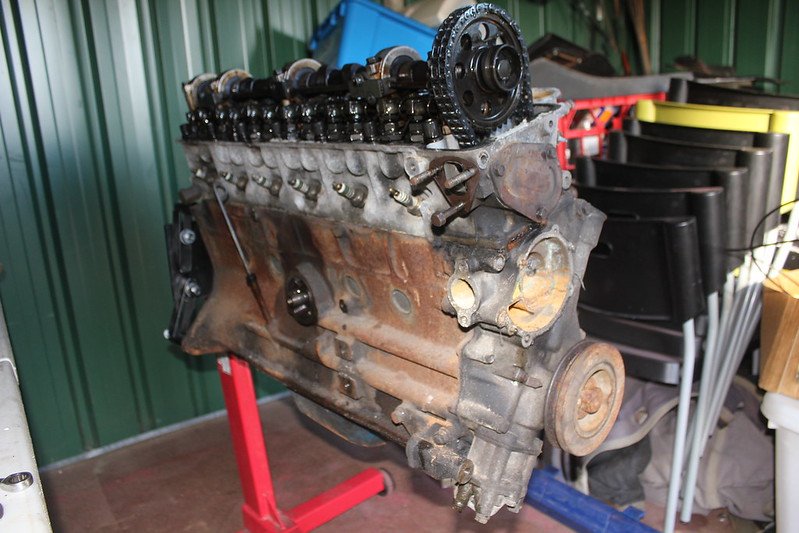

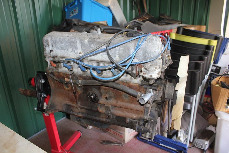

Ancillaries all off:

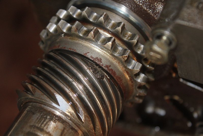

Unfortunately noticed a small chip on the crank.... Should I worry about this?
As a side note, the timing chain guide had snapped.... Just where it bolted on, didn't seem to be a big problem. Thought that was strange. Will have to hunt one down.

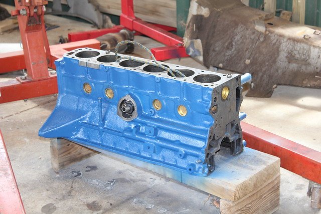

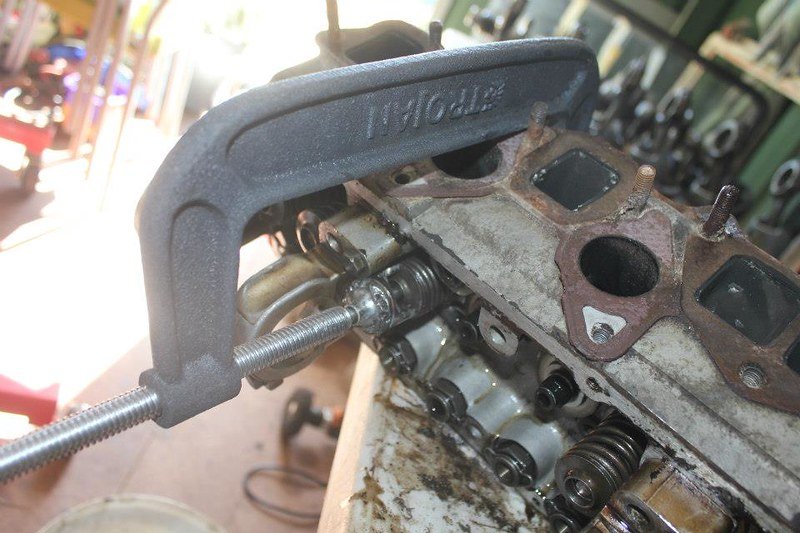

Crappy china shiver valve spring remover bent like a banana 8 valves into the job. So goodbye $40. Went to bunnings, $27 later had all the parts to do this. Probably should have used a deep socket, but this does the job well enough.
Spent hours cleaning the block. Wire wheel, rust converter, wire wheel, wax and grease remover, high temp primer, high temp ford engine enamel, new welch plugs.
8246742340_e9942771fd_z.jpg Quite happy with that outcome. looks good I reckon.
What color is the dipstick tube meant to be? And that funny (coolant?) pipe that sticks out the other side of the block?

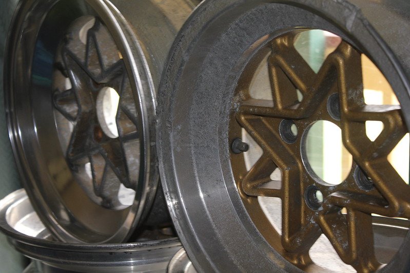

Here's a photo of the wheels that will go on the front. Techno TRV. One polished, 5 left (took two hours...). Need to paint centers too, then sell 4 of them and keep the leftover pair.
