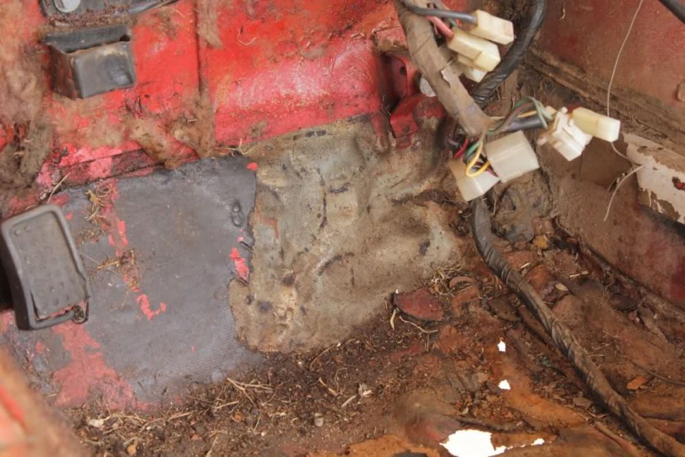

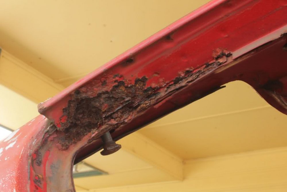

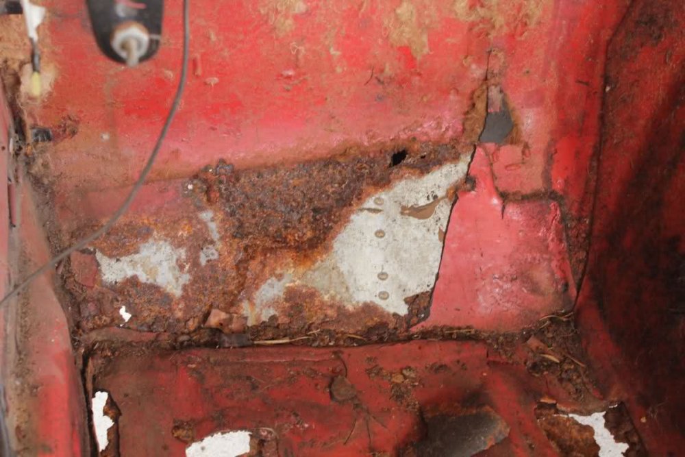

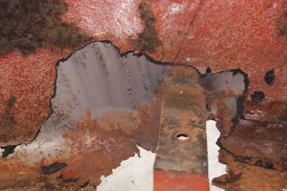

thriller Posted February 14, 2012 Author Posted February 14, 2012 Thought I'd chuck a couple more up. I think this is pretty much straight under the rust hole in the C (or is that B?) Pillar. Going to be a mess inside here. Passenger footwell: Drive footwell. Must have had a bit of a ding here, run into a stump or something. Probably best to cut and replace, it's a pretty simple looking curve. FRESH METAL!!!! Peeled back a tiny bit of sound deadener on the tran tunnel. Aaaand here's how she's looking: Quote
Rat1314 Posted February 14, 2012 Posted February 14, 2012 I think this is pretty much straight under the rust hole in the C (or is that B?) Pillar. It'd be the B pillar on that car, You count the pillars from the front to the rear A,B,C... you get the idea. On another note this is one hell of a project you are undertaking, I hope you finish it and I lookforward to seeing the progress that you make. Quote
