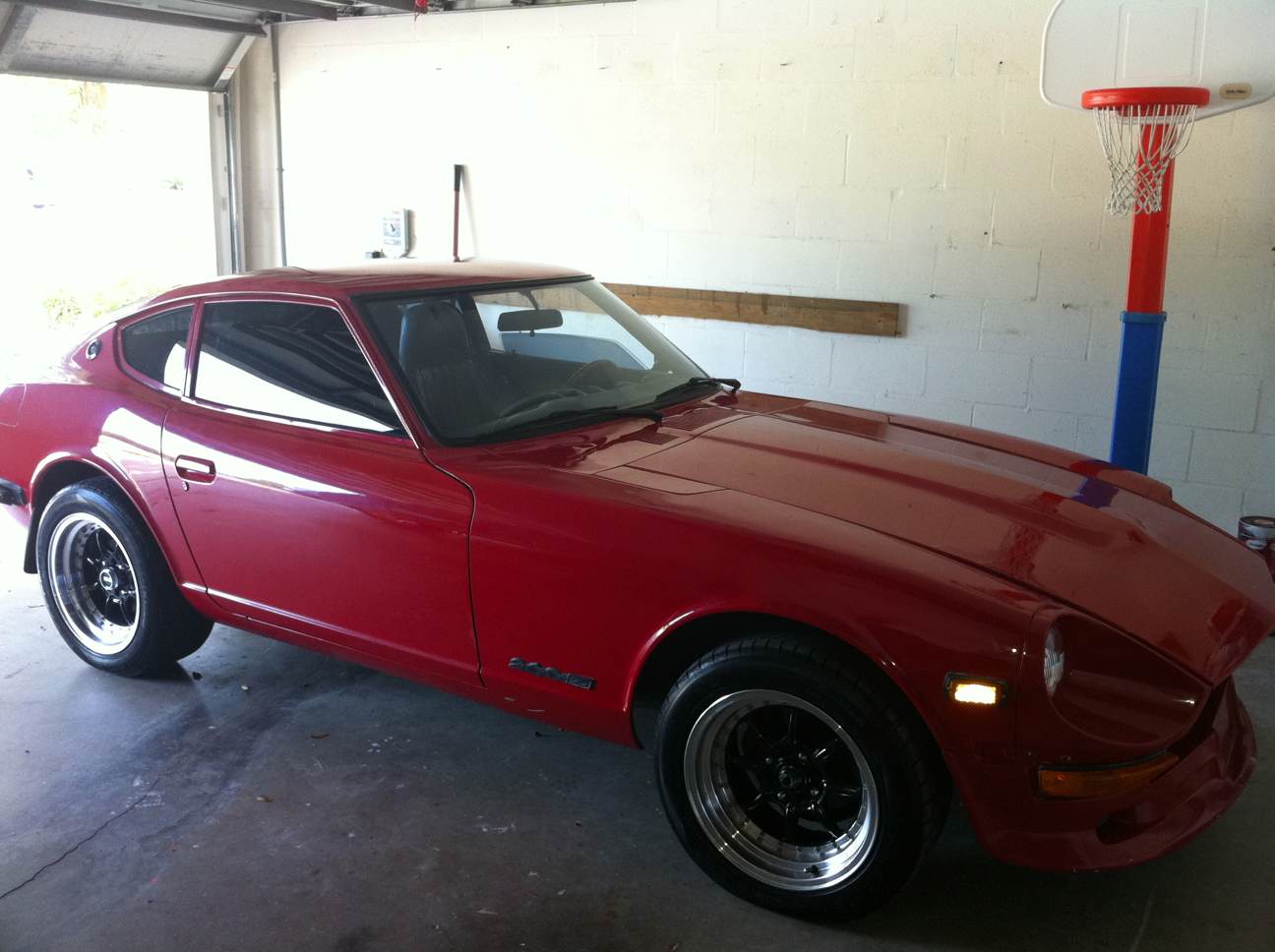

reverendzed Posted June 3, 2011 Posted June 3, 2011 I couldn't help myself! 74 260z, 10 foot paint job, great interior, some rust..but It's a start! Quote

Bruce Posted June 3, 2011 Posted June 3, 2011 gday Rev, well done on the purchase. Love the wheels on it. excuse my ignorance, but whats a 10 foot paint job? Is that your truck parked next to it? cheers Bruce Quote
reverendzed Posted June 3, 2011 Author Posted June 3, 2011 Ha, Bruce it means that it looks best from 10 feet away! Probably a bit harsh it'' just not 'show quality! Quote
