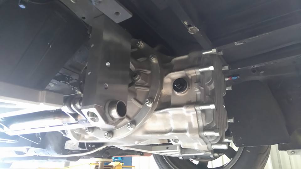

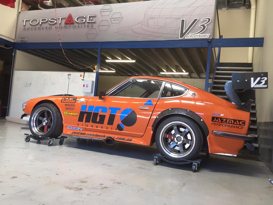

Ledge Posted February 9, 2017 Author Posted February 9, 2017 Well lads there is no real rest with a car like this. Finally addressing the R200 longnose. Ive found although it hasntbroken it just isnt up to the acceleration rate the car is putting out. I may be wrong but the car has had a strange rear vibrationthat i cant find. everything is replaced except the R200, But when i changed from the 3.9 to the 3.3 it was better. So total diff changenow to eleviate it.Also ive just dropped the car off to Topstage for some front and side aero updates. Cheers Quote

Ledge Posted February 9, 2017 Author Posted February 9, 2017 Yeah Winters quick change KatoKid 1 Quote

tir33d Posted February 11, 2017 Posted February 11, 2017 (edited) Nice how its just a quick mention of diff, there are a few people here that have changed rear ends. Everyone seems on a different route though. After breaking a pinion at Bathurst I also felt the urge to change. Only my route is via a independent 9 inch. Just cut a big hole through the centre of my car. I have four R200's in my shed - hopefully I will only ever need one 9 inch. And we wont talk about costs either !! Edited February 11, 2017 by tir33d Quote
Ledge Posted February 12, 2017 Author Posted February 12, 2017 Richard i could get it in Sports cars class yes. Ive had a guy look at it. Nice how its just a quick mention of diff, there are a few people here that have changed rear ends. Everyone seems on a different route though. After breaking a pinion at Bathurst I also felt the urge to change. Only my route is via a independent 9 inch. Just cut a big hole through the centre of my car. I have four R200's in my shed - hopefully I will only ever need one 9 inch. And we wont talk about costs either !! The winters is a 10" crown wheel. I didn't need to cut the floor, had to section out the upper cross member though but that was due to the quick change part. Maybe the 9" housing is bigger. Quote

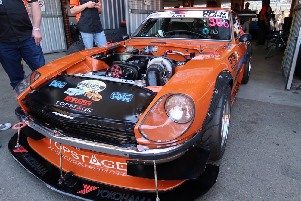

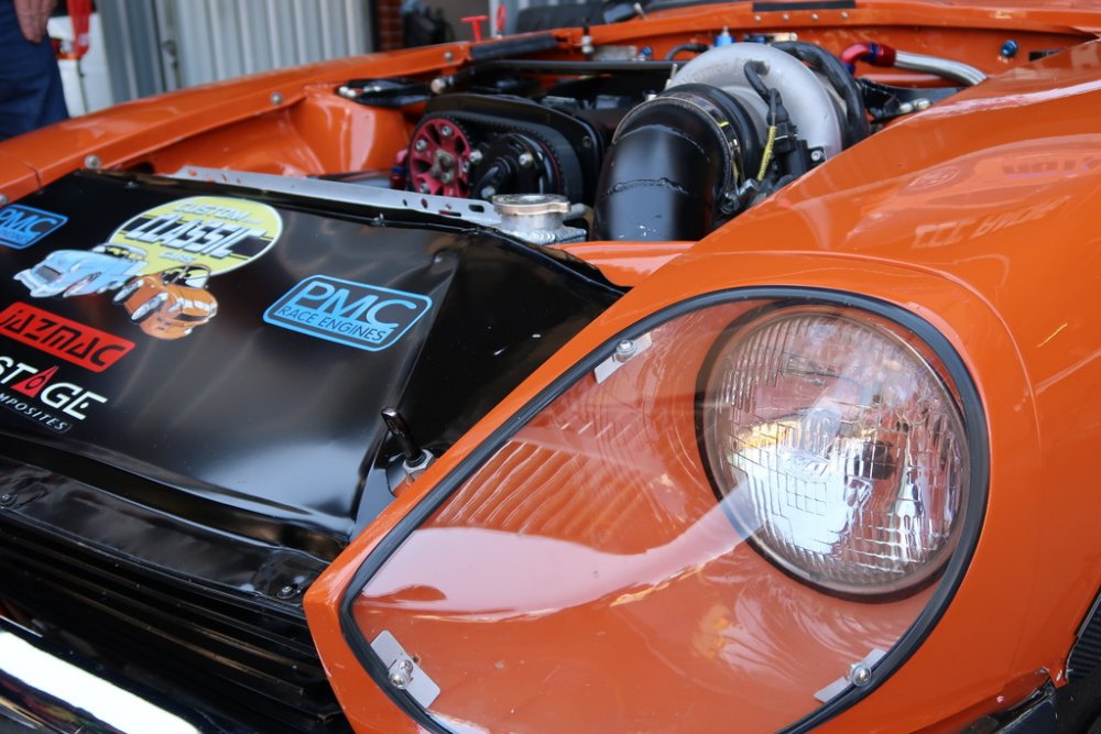

d3c0y Posted May 14, 2017 Posted May 14, 2017 Any reason the inlet area is so big? Is the cooling with the RB marginal? Quote
Ledge Posted May 14, 2017 Author Posted May 14, 2017 Never had cooling issues, but better to go bigger and blank some off then too small and have to hack some out d3c0y 1 Quote
