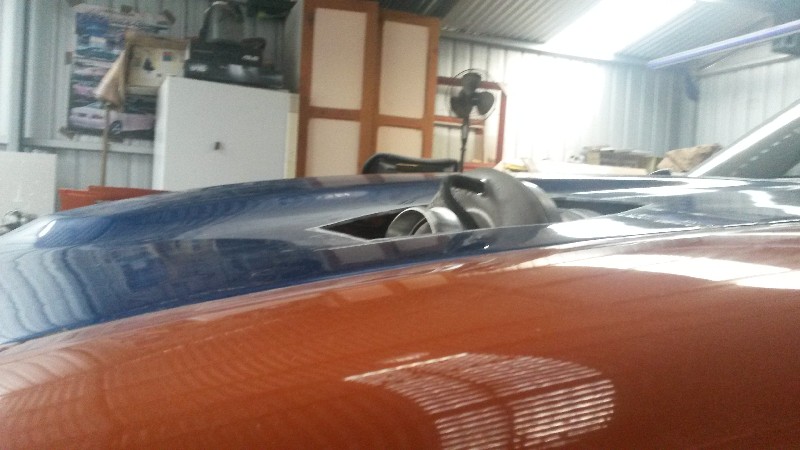

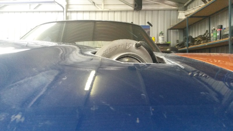

dat240z Posted April 21, 2015 Posted April 21, 2015 Oh wow.... That's either a dinner plate sized turbo or the highest set manifold out there.. I'm guessing the first. Looks good mate, that thing will sound like a jet Quote
Ledge Posted April 22, 2015 Author Posted April 22, 2015 Oh wow.... That's either a dinner plate sized turbo or the highest set manifold out there.. I'm guessing the first. Looks good mate, that thing will sound like a jet Combination of a few things. The manifold is from raw brokerage in the states. Its designed for rb in z. But we have stood the engine up straight to make a few things work better. This has pushed the turbo up through the bonnet. And yes itis a big turbo Quote

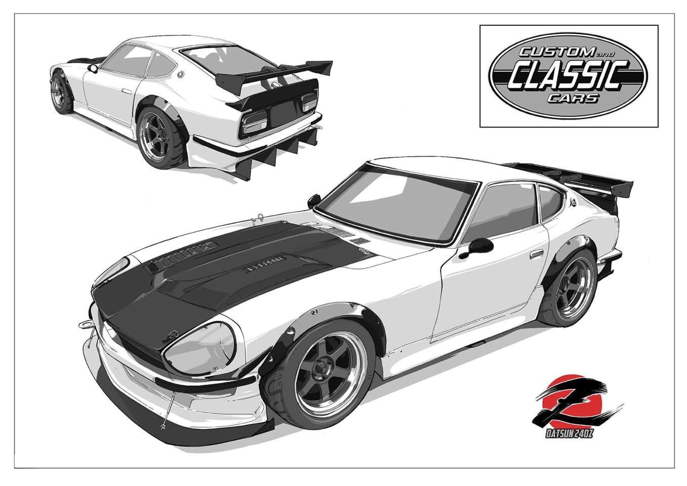

Ledge Posted July 6, 2015 Author Posted July 6, 2015 Nice pic a good mate drew of the new look the car will have. Will still be orange. Quote
d3c0y Posted July 6, 2015 Posted July 6, 2015 Has Freddy designed the aero package for this car or did you do it yourself? Quote
Ledge Posted July 7, 2015 Author Posted July 7, 2015 Yeah Topstage is in charge of that. The pic aero is just a guide for now Quote
d3c0y Posted July 7, 2015 Posted July 7, 2015 Makes sense then, I thought a couple of the elements were a little strange. Quote
260DET Posted July 7, 2015 Posted July 7, 2015 Those wrap over wing supports are the go, apparently the disturbance they cause on top is not as degrading as if they were underneath. Quote
d3c0y Posted July 7, 2015 Posted July 7, 2015 They are called swan necks. The theory is to not disturb the low pressure air and cause the wing to stall underneath due to separation. Quote

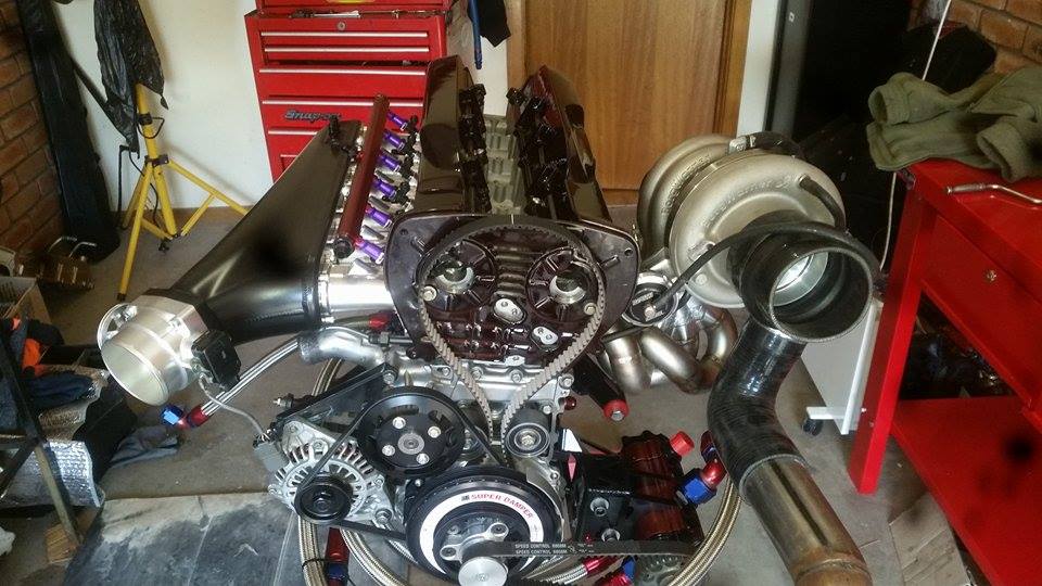

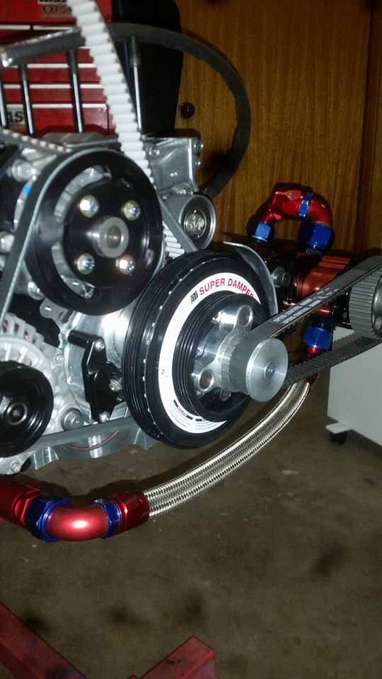

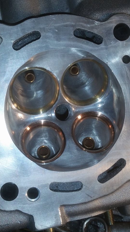

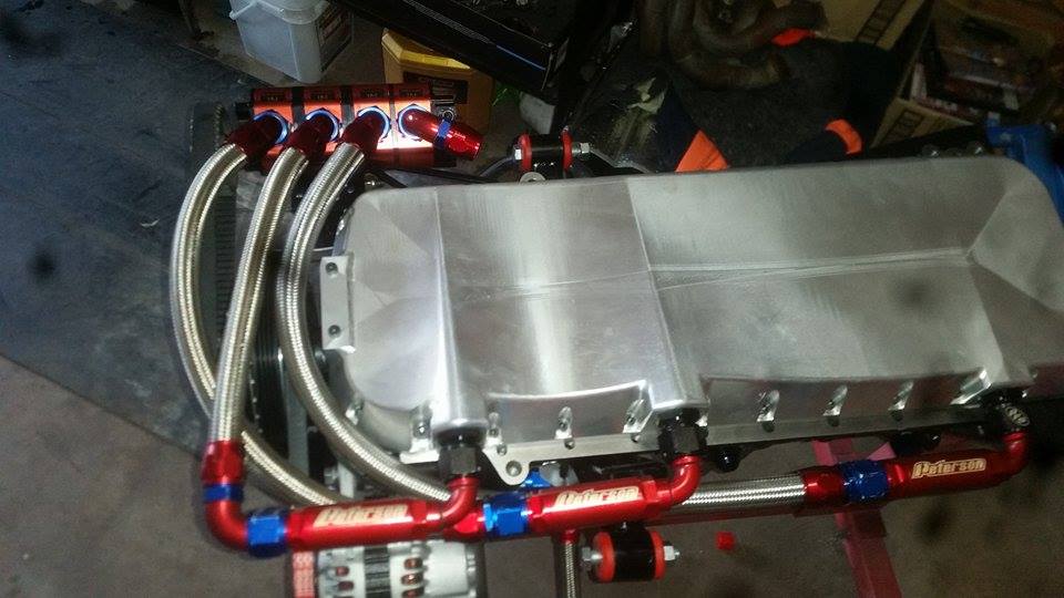

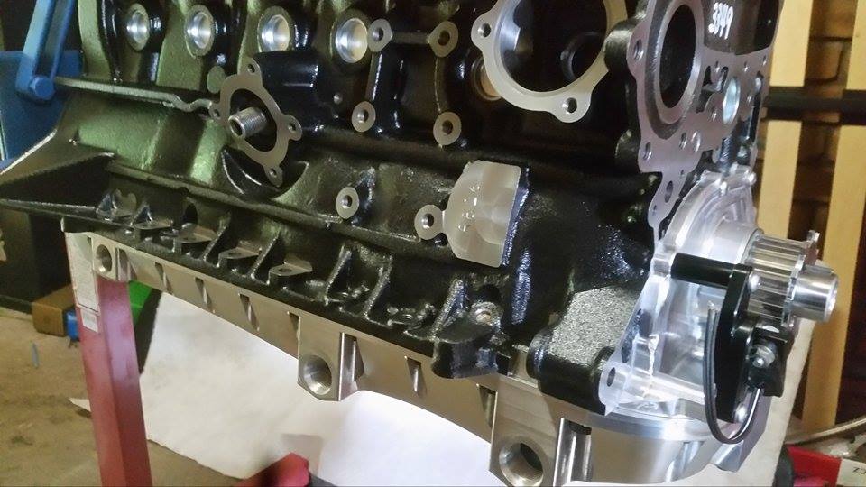

Ledge Posted August 2, 2015 Author Posted August 2, 2015 Few engine Progress pics. Getting close now Quote

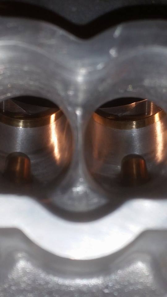

Jap Metal Posted August 2, 2015 Posted August 2, 2015 Coming together nicely mate What is the bottom end combo Crank rods pistons bore / stroke Quote
Ledge Posted August 2, 2015 Author Posted August 2, 2015 Billet 28 stroker crank, Custom rods and pistons. 10.5 comp ratio. More head work than even imaginable. Berrilium seats etc etc. Stupid big duration and lift cams. Quote
