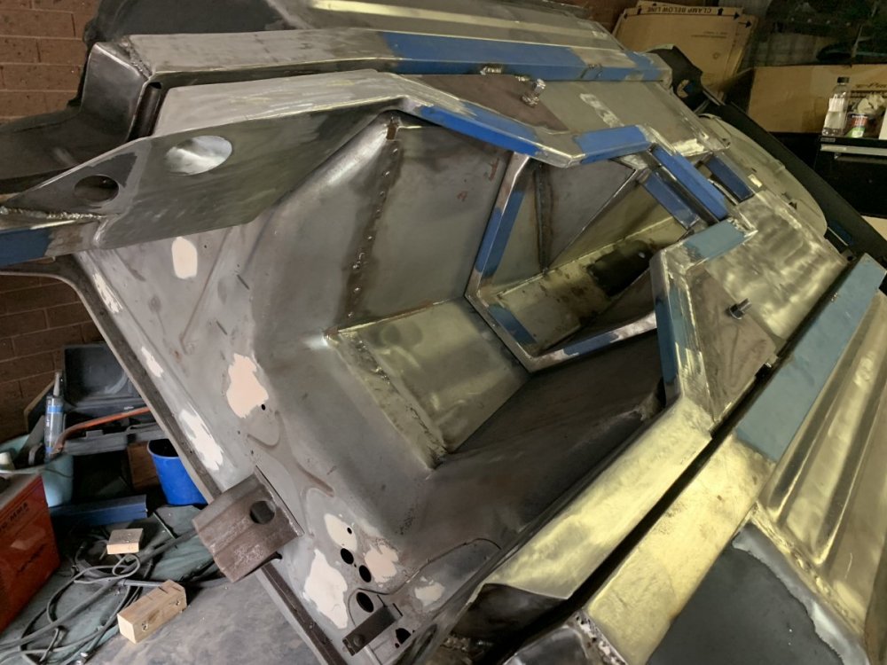

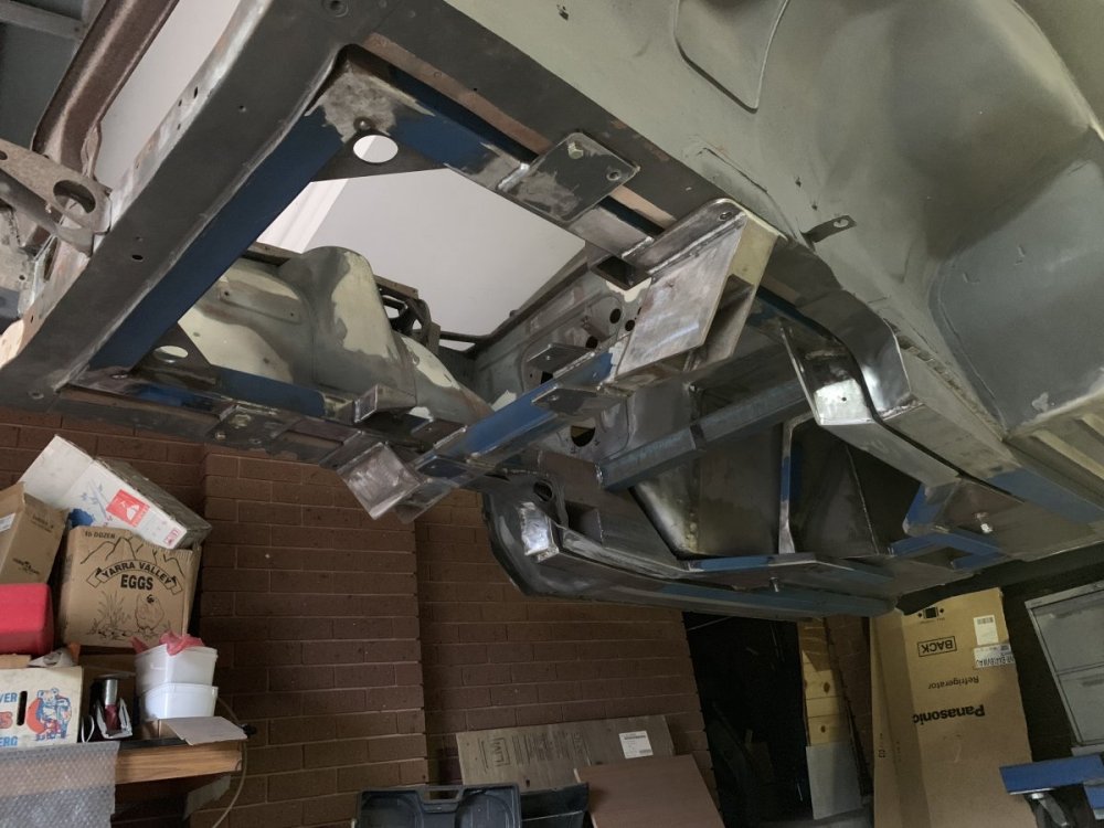

Sirpent Posted May 4, 2019 Author Posted May 4, 2019 This relationship is getting complicated I cut away half of the rear chassis today, reconfigured it so all is flush with the new rails. A flat bottomed car is now a real posibility but of course ran out of gas sgain Till next week Ponyo240z and CBR Jeff 2 Quote

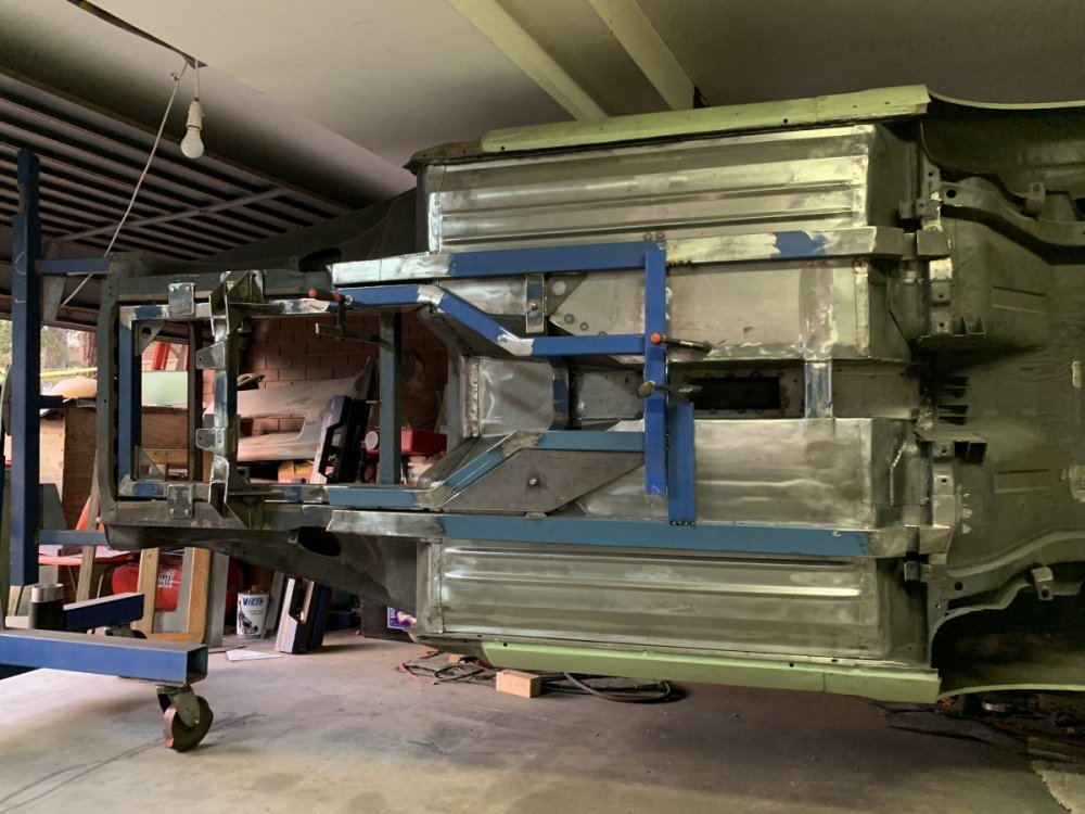

Sirpent Posted May 25, 2019 Author Posted May 25, 2019 Been past 2 weeks but made some progress today Chassis reconfiguration is now flush with the new rails Gearbox rear mount is next up CBR Jeff 1 Quote
CBR Jeff Posted May 27, 2019 Posted May 27, 2019 Looking amazing John. Body will lift off the drive train cradle once it all done? Jeff Sirpent 1 Quote
Sirpent Posted May 27, 2019 Author Posted May 27, 2019 39 minutes ago, CBR Jeff said: Looking amazing John. Body will lift off the drive train cradle once it all done? Jeff Hi Jeff Yes, that cradle will carry the motor, trans, front suspension, steering rack and headers down to the merge section as a complete unit meaning it can be raised into the bay or the body lowered onto it Quote

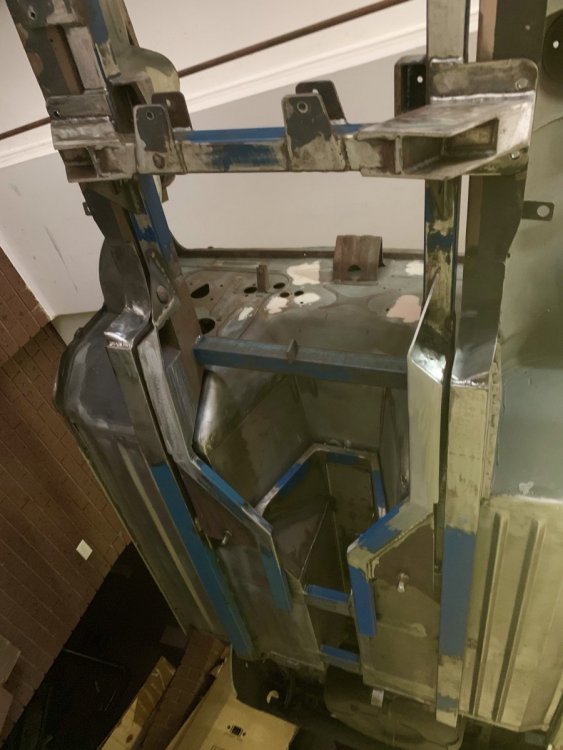

Sirpent Posted June 1, 2019 Author Posted June 1, 2019 Some movement today finished up the lower torsion rod mounting points incasing the cavities with pipe sections along with closing off the cradle rails at the rear. Removed the temporary cross brace and now I’m ready to trial mount the motor and box so as to configure the revised gear box mount hopefully next weekend Cheers john KatoKid, OdinZ, CBR Jeff and 1 other 4 Quote

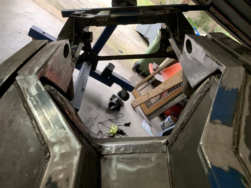

Sirpent Posted June 22, 2019 Author Posted June 22, 2019 Rear gearbox mount almost done, just need to fix the height position and fab some outriggers to the cradle lots of room for the twin exhaust and will tuck inside the tunnel snd of course start of the obligatory smoothing of some weld areas and metal finishing due to my OCD KatoKid 1 Quote

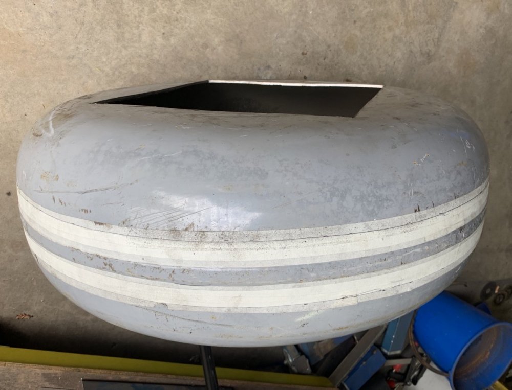

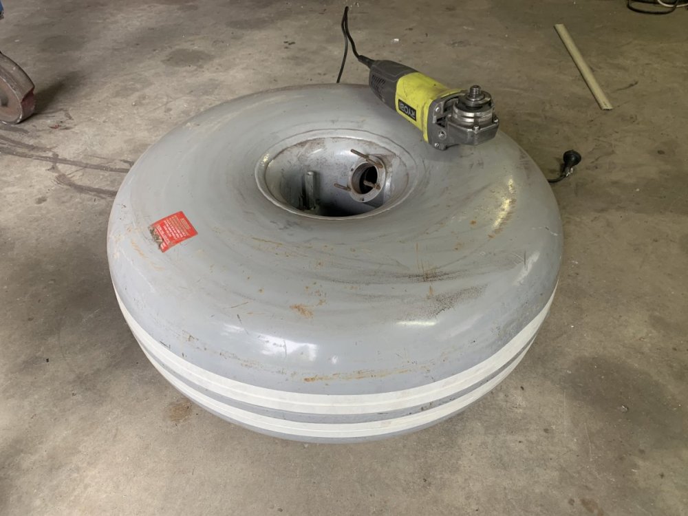

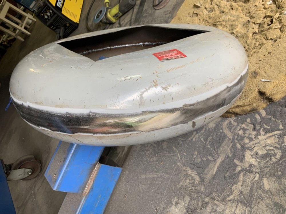

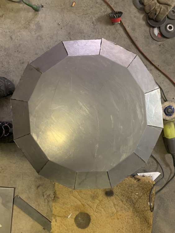

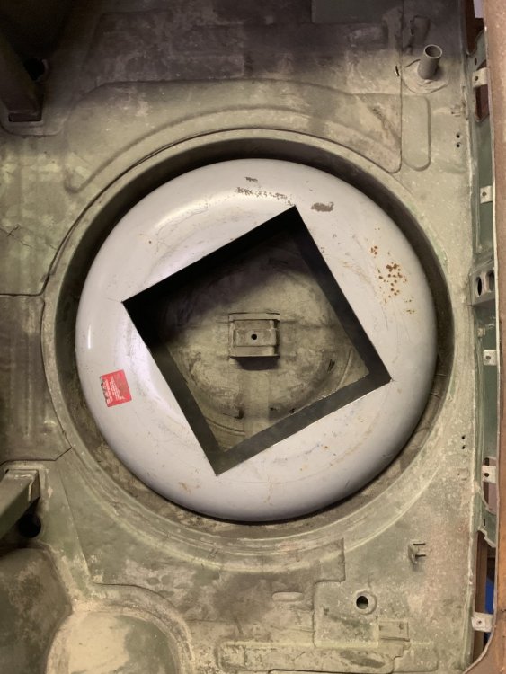

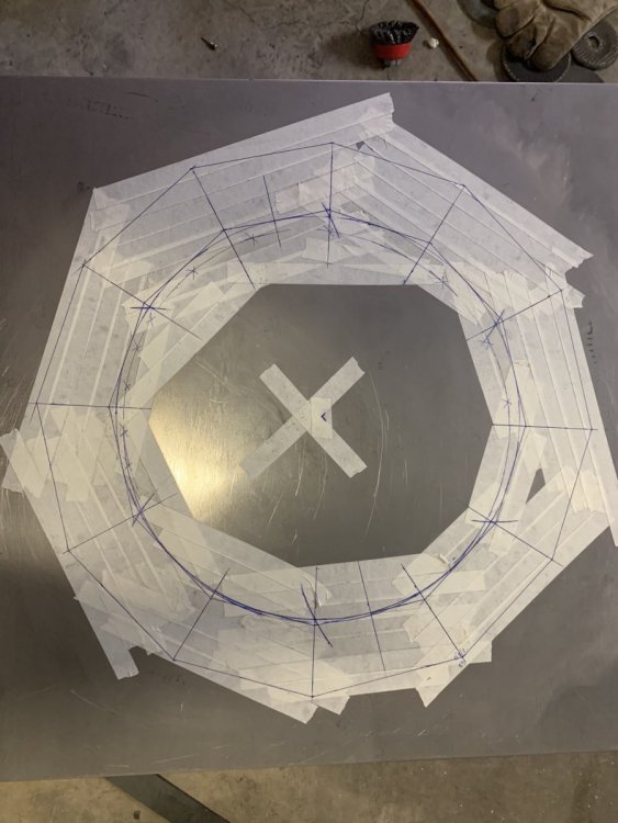

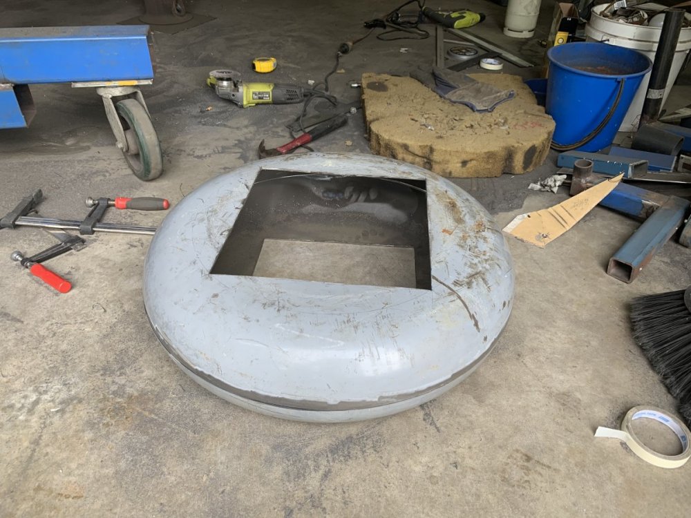

Sirpent Posted August 10, 2019 Author Posted August 10, 2019 (edited) Been a few weeks, unfortunately illness and waiting for John Lange to finish the custom rear control arms have slowed me down So moved onto the rear fuel tank fabrication, using the LPG donut tank as the basis First was chopping 65mm out of the height through the centre aa well as removing the center tube section Then it was a matter of fabricating a centre rise section to clear the spare wheel well hump With the modifications, I’ve worked out it should be between 58-60 litres plus another 8-10 in the additional surge tank All in all so far a perfect fit See you all next week Edited August 10, 2019 by Sirpent CBR Jeff and AndBir 2 Quote

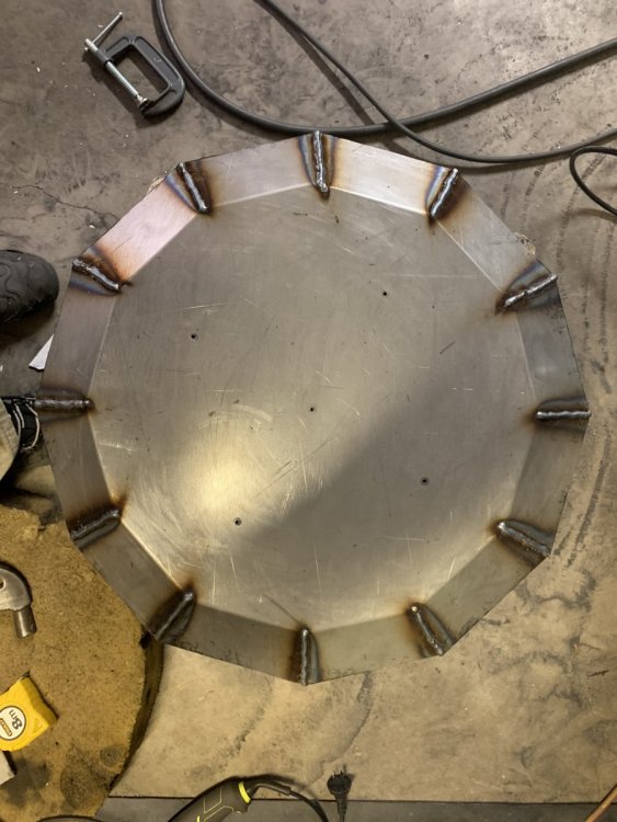

Sirpent Posted August 17, 2019 Author Posted August 17, 2019 When necessity is the mother of invention Core of the tank is now complete and now to move onto all the ancillary pipes and fittings KatoKid 1 Quote
Sirpent Posted August 24, 2019 Author Posted August 24, 2019 Port lid for the new surge tank done now to build the guts of it next week all OdinZ 1 Quote

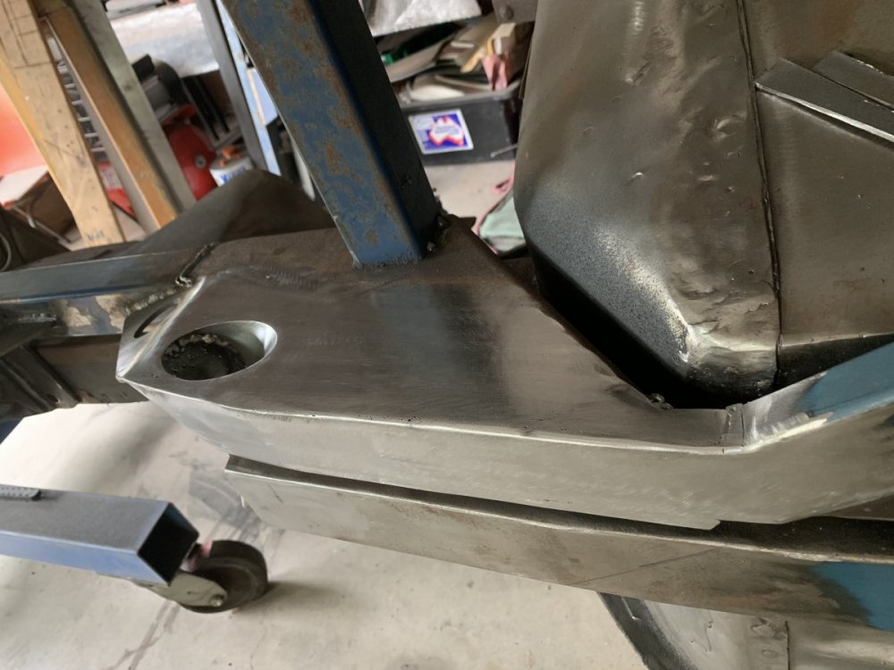

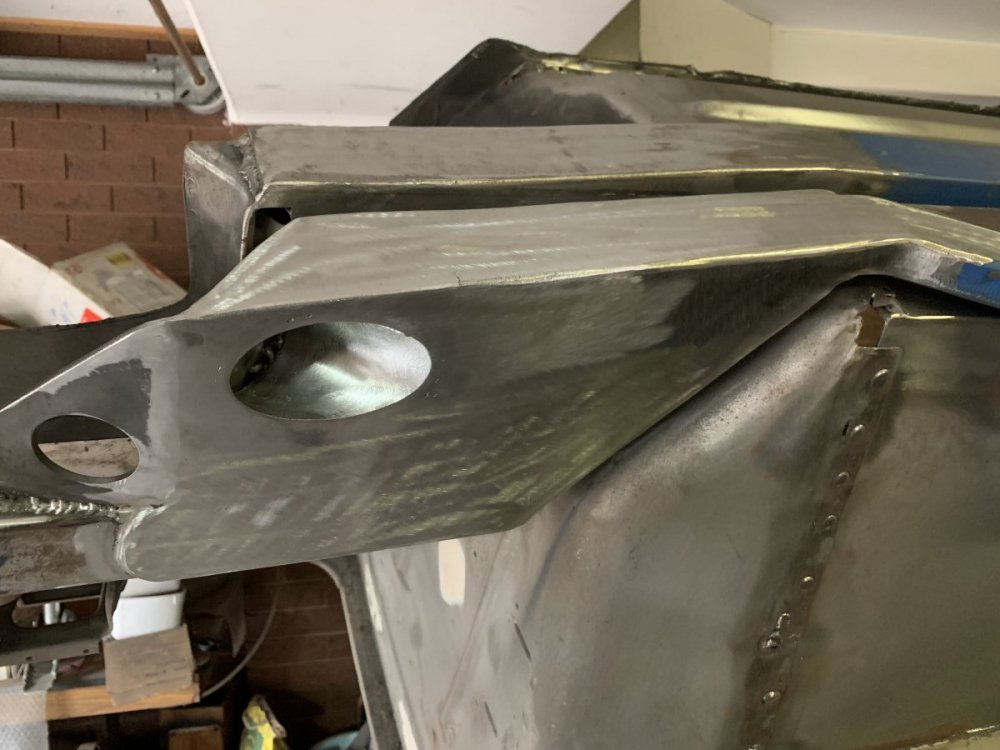

Sirpent Posted December 27, 2019 Author Posted December 27, 2019 Merry Christmas Zholics Custom rear lower control arms near completion jpndave 1 Quote
jpndave Posted December 27, 2019 Posted December 27, 2019 Those control arms are really nice! Good job! Quote
CBR Jeff Posted December 27, 2019 Posted December 27, 2019 John as usual very nice work. Good to see your back in the shed :-) Jeff Sirpent 1 Quote
jeff43 Posted December 27, 2019 Posted December 27, 2019 They look awesome John, very nice work. Enjoy the shed time. Cheers Jeff Sirpent 1 Quote
