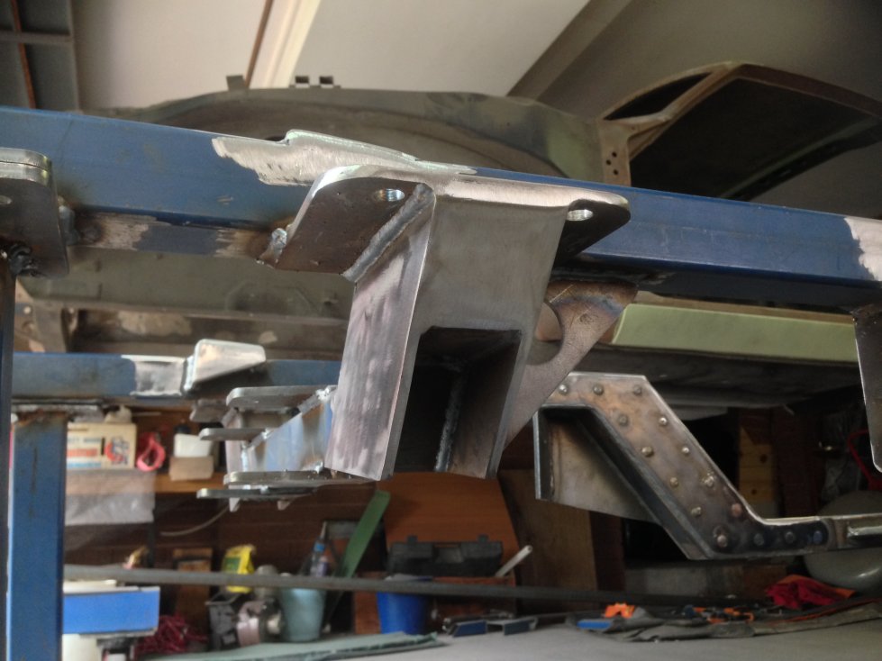

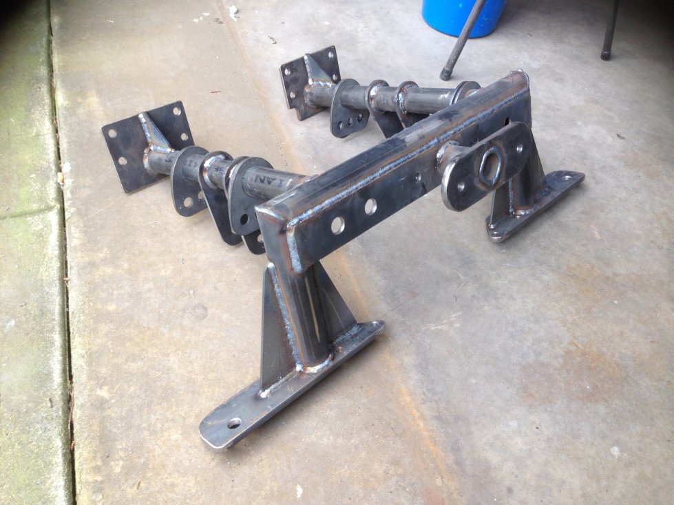

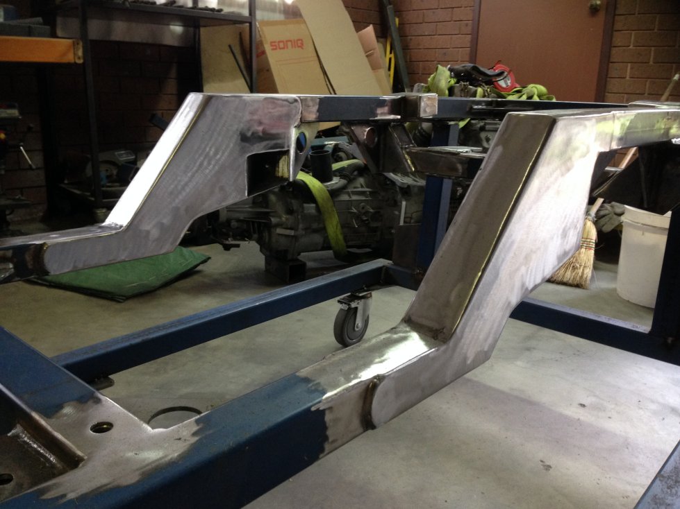

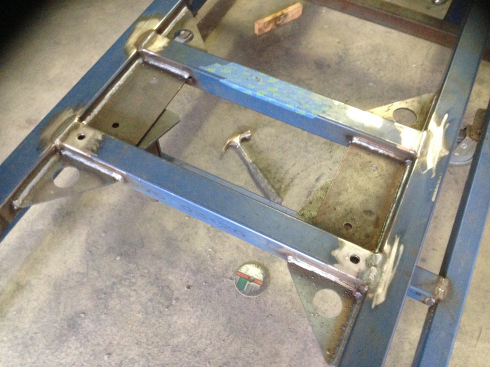

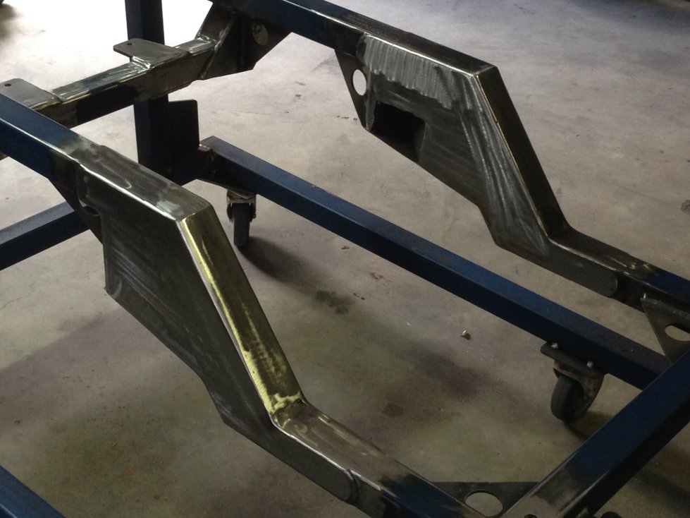

Sirpent Posted August 28, 2016 Author Posted August 28, 2016 After updating my build in jeff's thread by accident............... Take 2............... Chassis all welded now, just a few pics for now but overall really happy as it looks and is a hell of a lot stronger and sorted now. Heaps of gussets especially around the rear diff / LCA cradel. Lots of deburing and clean up of some of the welds, John Lange can now also fabricate the rear LCA's now that the cradle is stable welded and transportable. A final fit up of the chassis complete with engine trans and diff followed by welding in the new tunnel then all off with the body to all be plastic bead blasted and locked up in EP before going any further. Cheers John CBR Jeff 1 Quote
CBR Jeff Posted August 28, 2016 Posted August 28, 2016 After updating my build in jeff's thread by accident............... Take 2............... Chassis all welded now, just a few pics for now but overall really happy as it looks and is a hell of a lot stronger and sorted now. Heaps of gussets especially around the rear diff / LCA cradel. Lots of deburing and clean up of some of the welds, John Lange can now also fabricate the rear LCA's now that the cradle is stable welded and transportable. A final fit up of the chassis complete with engine trans and diff followed by welding in the new tunnel then all off with the body to all be plastic bead blasted and locked up in EP before going any further. Cheers John Looking nice John. Some great engineering there and lots of work. I'm looking forward to seeing it come together and one day hearing and seeing it drive. Jeff Sirpent 1 Quote

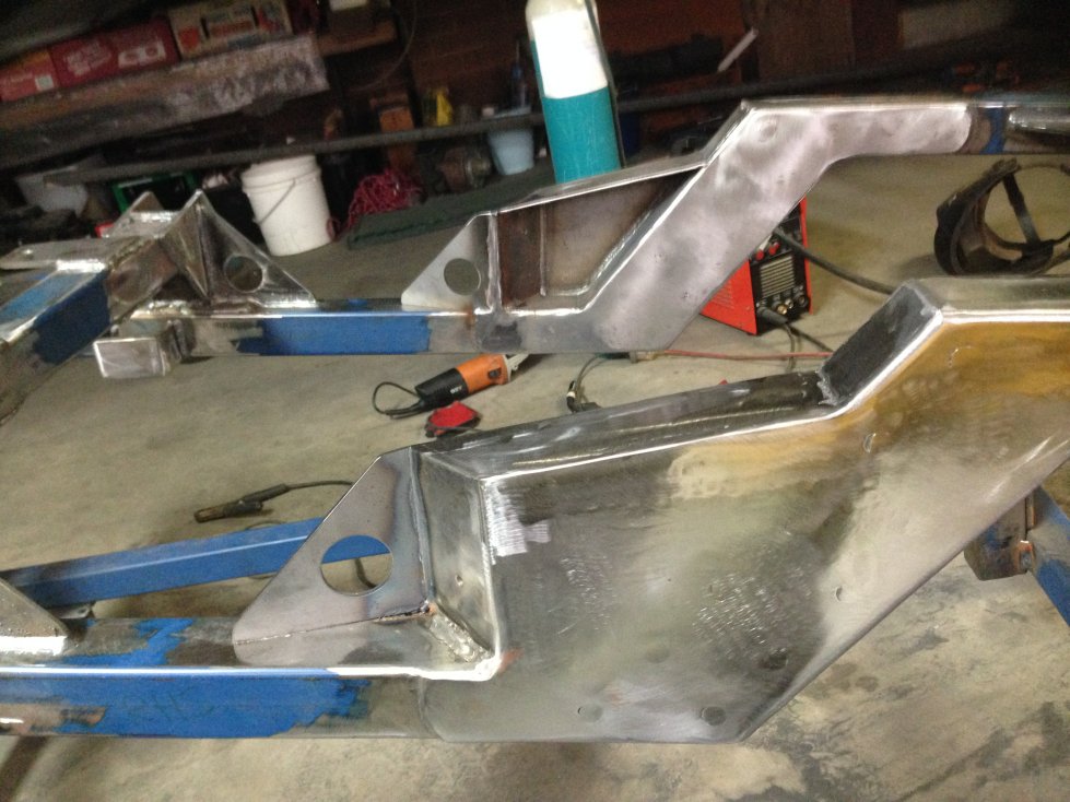

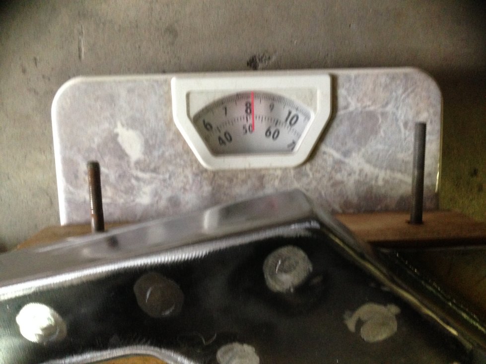

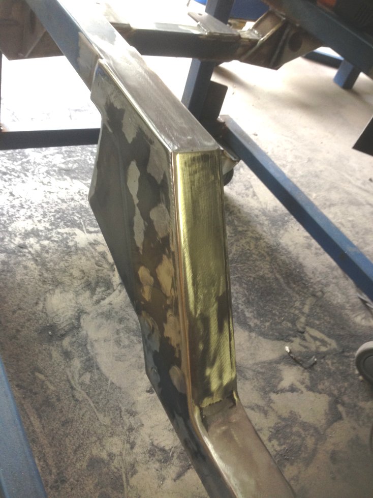

Sirpent Posted September 4, 2016 Author Posted September 4, 2016 A day of "Spit and Shine" grinding on the welds today Chassis weighs in at 51 Kg, rear diff cradle is just over 15Kg..............Happy fathers Day all Cheers John Quote

luvemfast Posted September 4, 2016 Posted September 4, 2016 I was wondering what the finished weights were just this morning, after seeing pics on FB. Suprised that it's not more, by the thickness of the steel used. Looking good mate. What's next? Plating, powder coating or both? Quote
Sirpent Posted September 5, 2016 Author Posted September 5, 2016 (edited) I was wondering what the finished weights were just this morning, after seeing pics on FB. Suprised that it's not more, by the thickness of the steel used. Looking good mate. What's next? Plating, powder coating or both? A way to go before the decorative finish Simon, there are a few area's that need some over-welding just to make it uniform, in the meanwhile the list and plan is #1 Get the rear lower control arms fabricated (The cradle is in the back of my car and I'm hoping to get to John Lange's this week to get him started on them) #2 Get the new tunnel welded in #3 Fit the engine trans diff control arms on the chassis and then bolt the body to it all to check fit #4 Get the engineers out to inspect it all #5 Pull it all apart and use David (Kato's) suggested paint Valspar TB543 on the chassis After all that it's back onto the body and finally I can apply myself to getting the shell prepped for paint with a deadline of December 31st to get it to a paint shop for final color. Cheers John Edited September 5, 2016 by Sirpent Quote

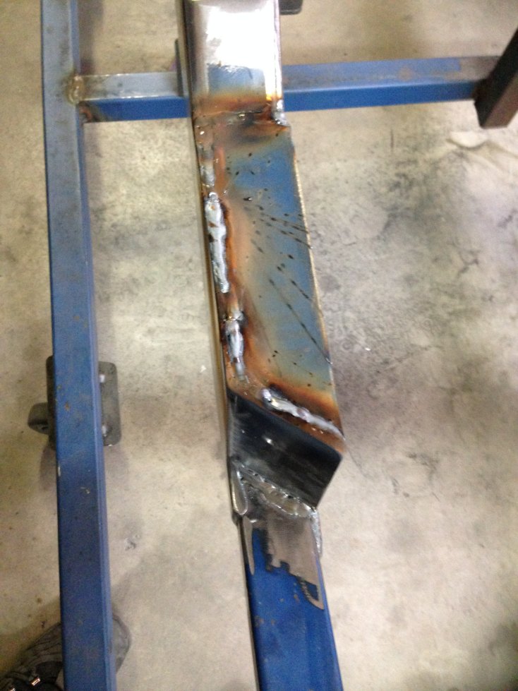

Sirpent Posted September 11, 2016 Author Posted September 11, 2016 Well after all that grinding, I can say that I no longer have an iron deficiency LMAO mspecr and jeff43 2 Quote

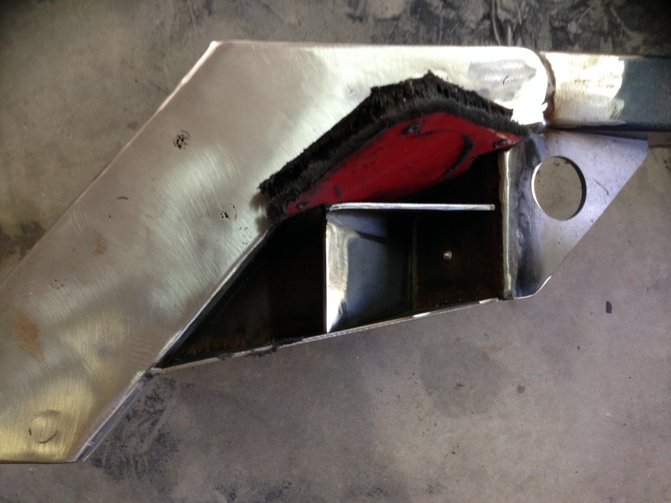

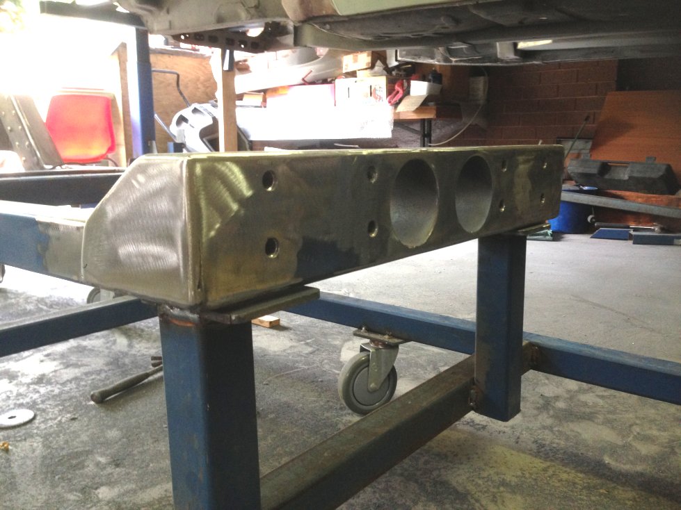

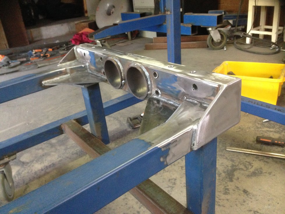

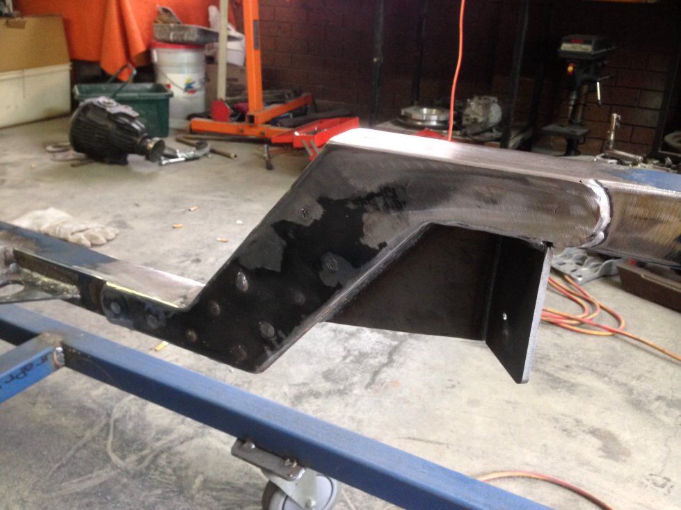

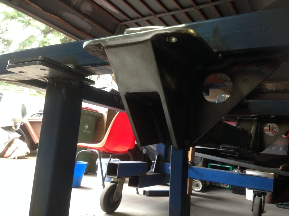

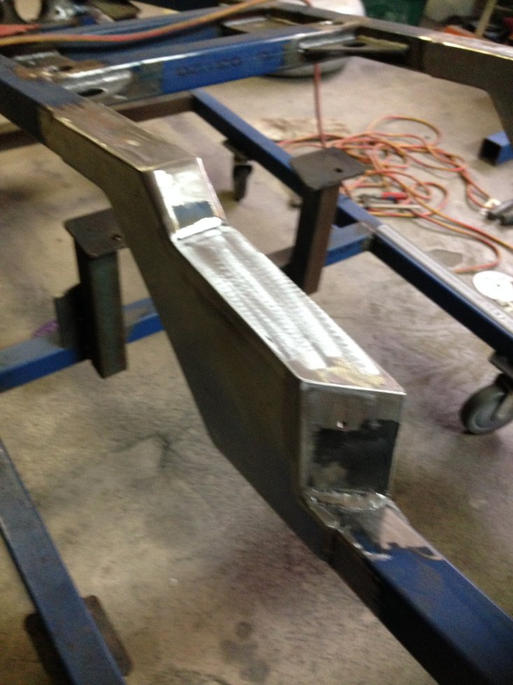

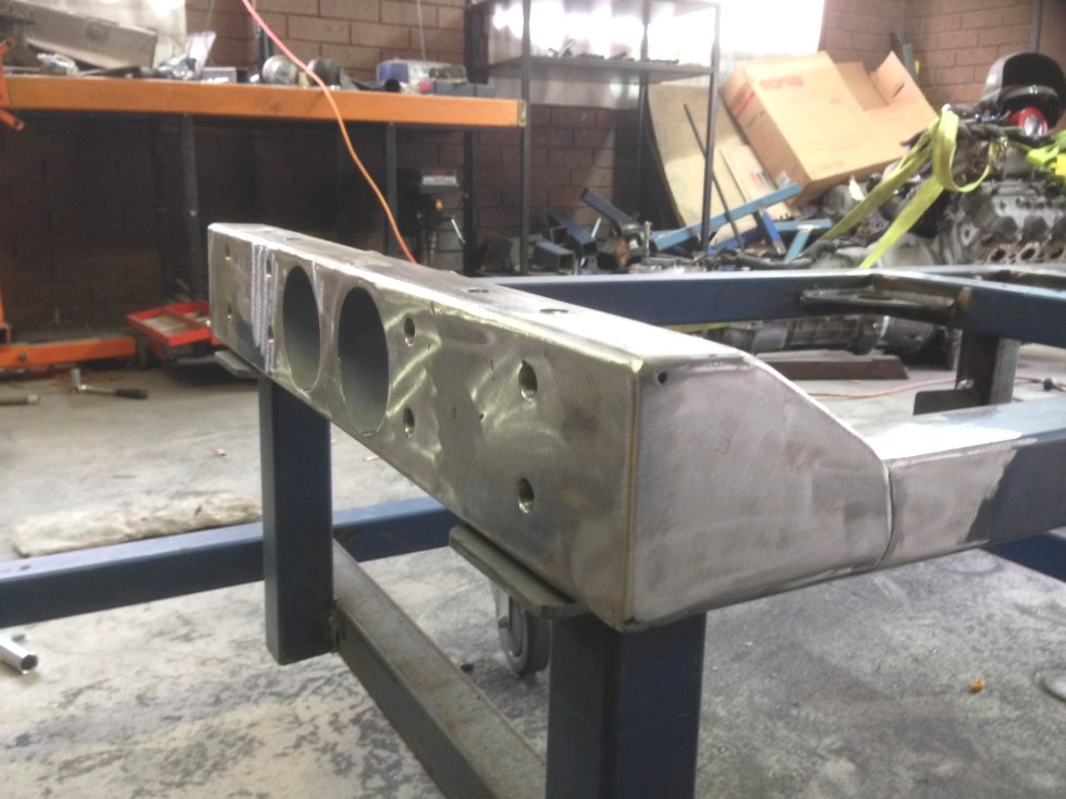

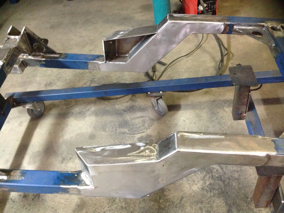

Sirpent Posted September 18, 2016 Author Posted September 18, 2016 While waiting for the rear diff cradle to return with the new LCA's............... Decided that the front torsion bar mounts needed some reinforcement. Quote
CBR Jeff Posted September 18, 2016 Posted September 18, 2016 :-) if you keep going like that John it's going to be unbreakable! Jeff Sirpent 1 Quote
Sirpent Posted September 18, 2016 Author Posted September 18, 2016 :-) if you keep going like that John it's going to be unbreakable! Jeff Just thought the last thing I wanted was to be driving and the find one of the LCA's decided it would freewheel because the mount gave way LMAO Quote

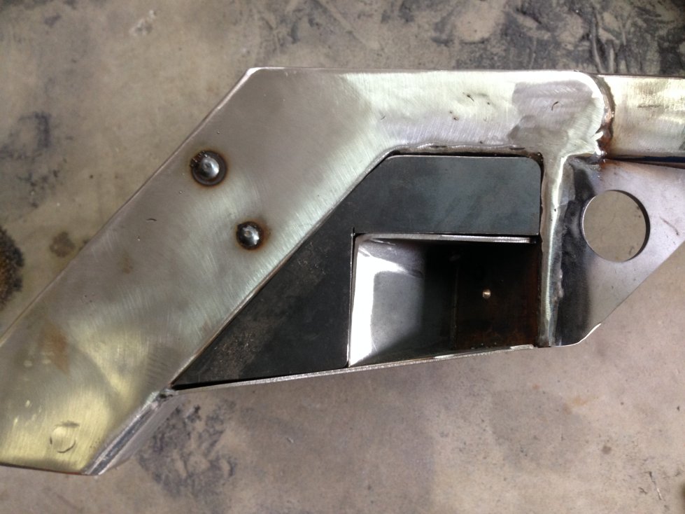

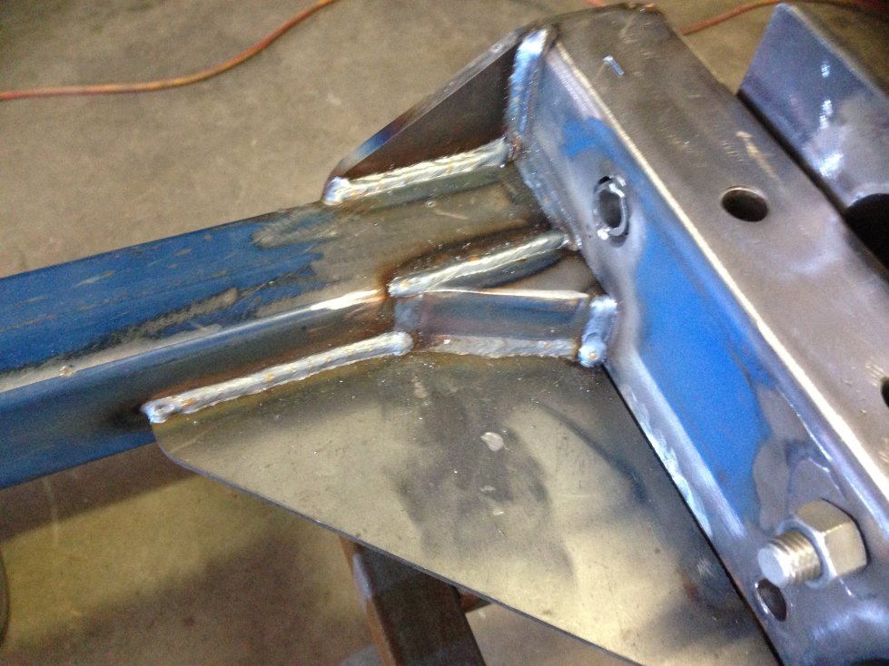

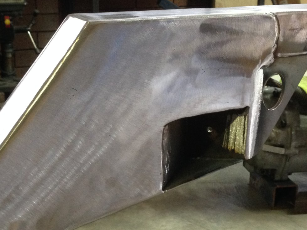

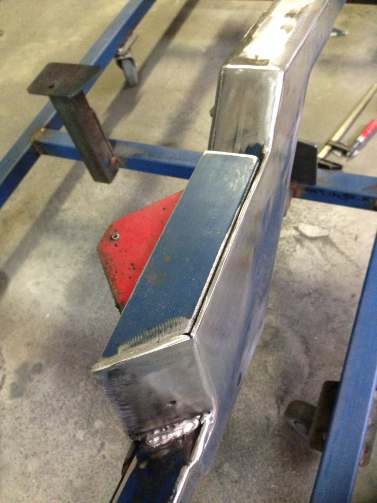

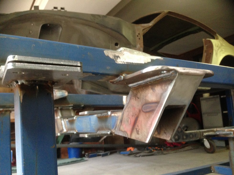

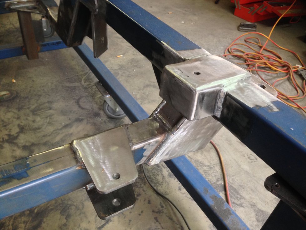

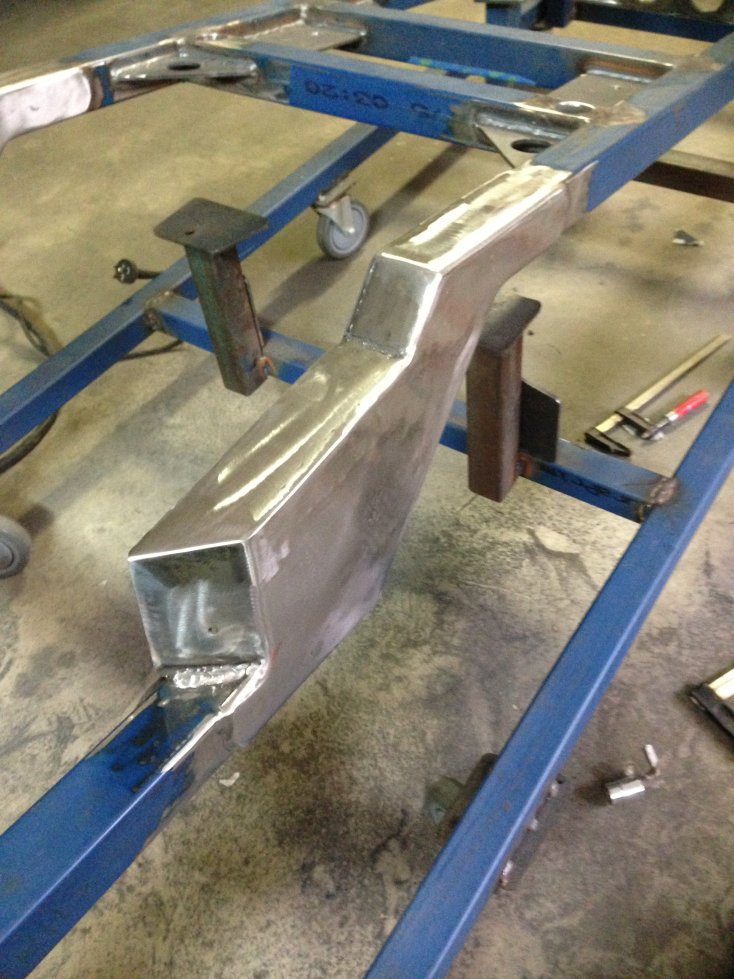

Sirpent Posted September 25, 2016 Author Posted September 25, 2016 Just some seam overwelding and linishing back today and boxed in the lower tosion bar mount points leaving boxed in access points for the torsion bar nuts. Cheers John Quote
