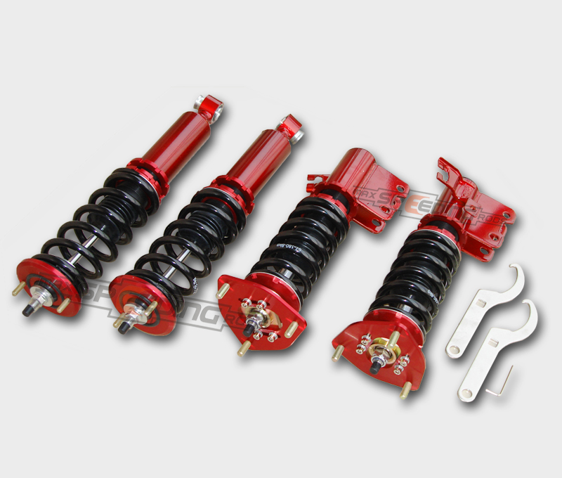

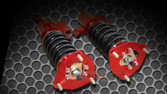

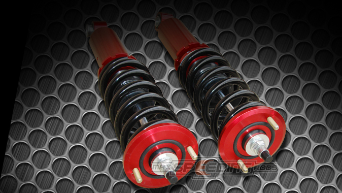

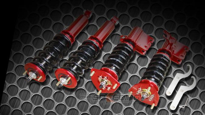

luvemfast Posted December 20, 2012 Author Posted December 20, 2012 I've finally bitten the bullet and am upgrading my suspension. What I have now, is great for the road. Just not quite up to the standard I'd like for track use. So S13 coilover mod it is. The key is to use base height adjustable units. Looking forwards to getting stuck into these Coupled with some adjustable lower control arms and caster rods............. Watch the seconds fall! Quote
ZED83 Posted December 21, 2012 Posted December 21, 2012 Look the goods Have fun fitting these! If you want to keep the same hight make sure you measure up before you strip it all out, will save you a lot of time. You can get the adjustable camber plates from Techno toy or RHD-Japan under Kameari think they do front an rear. Techno toy do the tension control arms/caster or Datsun-parts LLC do a full kit includes both sides with caster and control arms! Quote

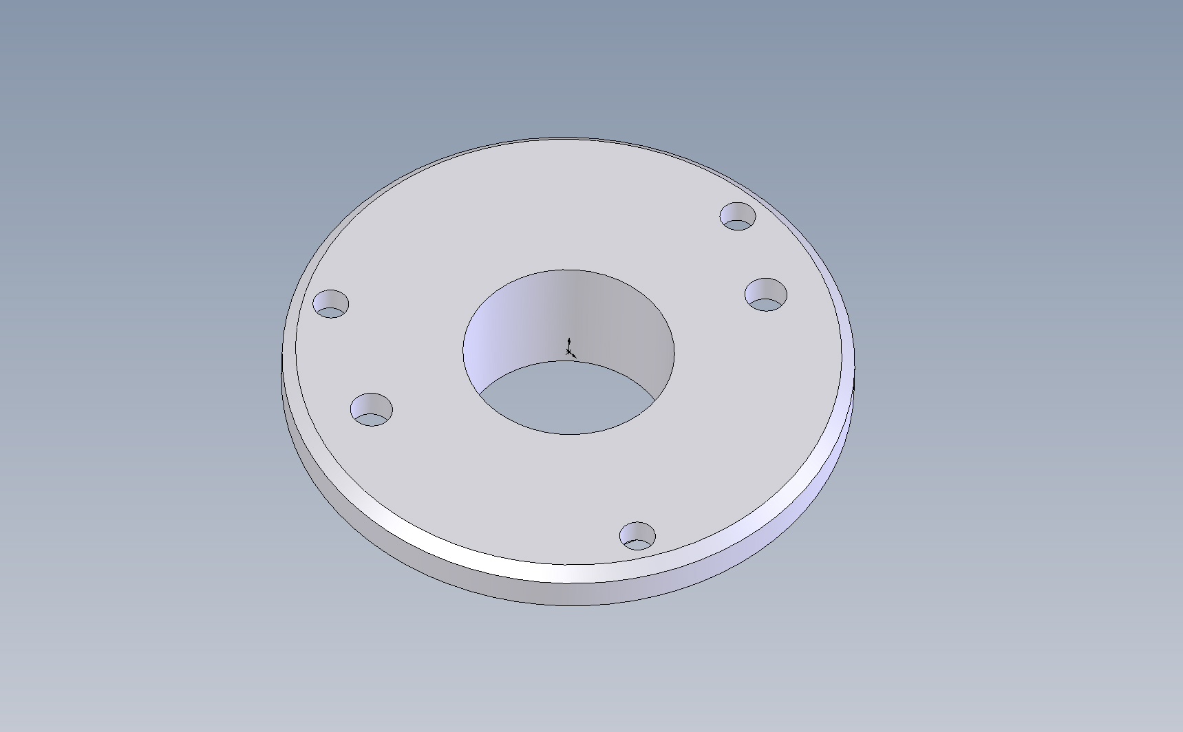

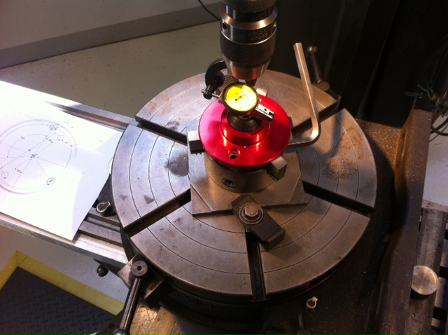

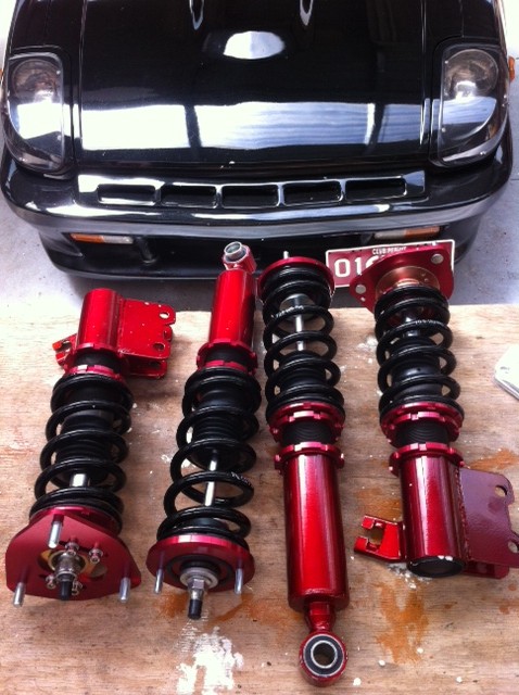

luvemfast Posted January 10, 2013 Author Posted January 10, 2013 Well while I was away on holidays, I received my coilovers in the mail Now the work begins to fit them. I'm going to start with the rears. I need to modify the strut tops, then they should go in quite easily........ Heard that before! I've measured and modelled up what I need to do, hopefully can get time this afternoon and get them in tonight. The spring rates are- front- 8kg (447lb) rear- 7kg (391lb) They have 24 way adjustable dampers. Given that Google tells me that an S13 weighs 1,224kg and an S130 2 seater weighs 1,216kg. The spring rating should work pretty well. (I've removed a heap of weight purely from removing front and rear bars, A/C, massive cruise control unit and driver seat swap to name a few mods) I'm also going to take my time with setting up the front height. Think its going to take me longer to play around/thinking about what to do, rather than do the physical work! So hopefully, all goes well. Quote

Riceburner Posted January 11, 2013 Posted January 11, 2013 Oh things are getting serious now. They look perdy and 24 way adjustable Stiffer fronts, nice to see... i dont get why people run Harder rears springs than fronts. How'd you calculate what spring rate was needed? I agree with Benny. Golow but nothing too stupid, it's a track pig not a show pony Quote

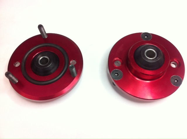

luvemfast Posted January 11, 2013 Author Posted January 11, 2013 As Gareth said, not stoopid low. It's a track car, but also road use. Doubt it would be much different from the height now. I already have to take my driveway on an angle, so it doesn't bottom out. Spring rates are what they come with. As I said, weights are similar of the 2 cars. So a good place to start. Here are some pics of the rear top mounts ready to fit. Quote
