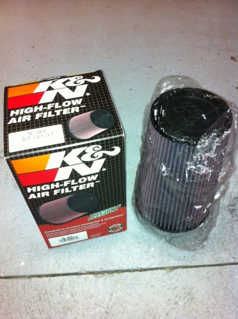

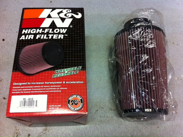

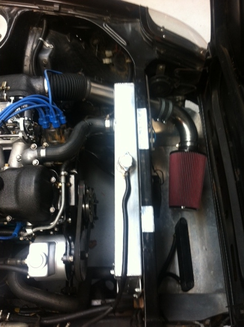

luvemfast Posted June 12, 2012 Author Posted June 12, 2012 I've also, finally, hooked up the cold air intake. Seems to work well. The hard part was connecting the TWM air box to the 3" pipe. Ended up getting a connector from the wreckers. Ford AU XR8 I ordered 2 K&N cone filters as much of the cost was in shipping. So I have 1 brand new unit for sale. RE-810 3" inlet x 8" long (I think) $65 takes it. Quote

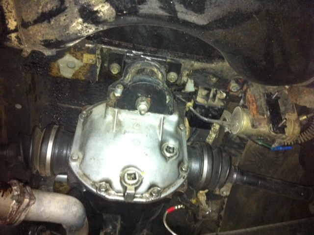

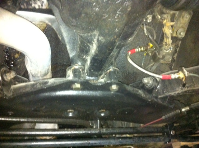

luvemfast Posted June 12, 2012 Author Posted June 12, 2012 I was under the car looking at the diff. Can I get some help here. I'm getting one of Jakes LSD R180's with a 4.1 ratio. As I haven't worked on an S30 car for a decade, will it fit to these mounts? Also opinions on going from R200, to an R180? Its smaller and lighter. But don't want to break it :-\ I've read that some racing guys prefer them. They find them strong enough and like the 10kg+ weight saving. Plus, I think a 4.1 ratio would be better suited for my usage. Quote
Scando Posted June 12, 2012 Posted June 12, 2012 You will need to modify the moustache bar as the R180 rear cover isn't as deep as on a R200. In 240Z's and 260Z's you just run a 240Z moustache bar for an R180 or a 260Z moustache bar for an R200. Not sure if a 240Z moustache bar fits a 280ZX??? The front mount should be fine. I've run 266rwkw through a welded R180 on 255 semi-slicks with no issues. An LSD won't be quite as strong as a welded diff but I don't think you'll have any issues with it. Quote
PZG302 Posted June 12, 2012 Posted June 12, 2012 As Shane said, the r180 will be fine. If you break it you either have way too much horsepower or are abusing it badly. The old 240 only ever used CIG R180's and coped with 200rwhp, 212 ft/lb of torque and standing starts with sidestepping the clutch at 3500rpm. I don't understand why everyone wants to go to R200 in what most would consider mild applications, I can understand those with V8's going to the R200, but with an L series why bother??? Quote

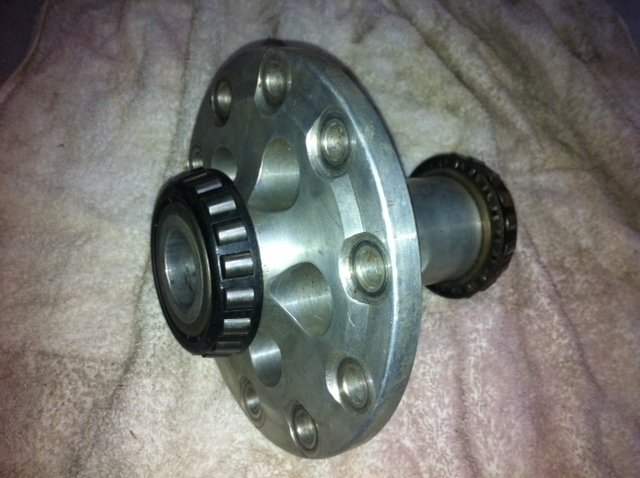

luvemfast Posted June 12, 2012 Author Posted June 12, 2012 Thanks gents. Was exactly what I wanted to hear. I'll just have to mod the rear mount and that should make it a bolt in job Now, for the halfshafts........... This was my other option. R200 locker! Might be for sale soon then. Quote
NZeder Posted June 12, 2012 Posted June 12, 2012 those lockers are illegal on the a road car here in NZ so not sure about AU. re the diff - The 2000cc version have R180 setups so you can get parts from them....well here in NZ we can as about 60%+ of the ZX imported from Japan into NZ were the L20E power versions. Quote
d3c0y Posted June 12, 2012 Posted June 12, 2012 Plenty of Aus delivered 280ZXs came with R180s just grab the rear end setup out of one of those. Should be cheap as! Quote
NZeder Posted June 12, 2012 Posted June 12, 2012 Plenty of Aus delivered 280ZXs came with R180s just grab the rear end setup out of one of those. Should be cheap as! yes I recall now - Auto's have R180's from the factory Quote
luvemfast Posted June 12, 2012 Author Posted June 12, 2012 Plenty of Aus delivered 280ZXs came with R180s just grab the rear end setup out of one of those. Should be cheap as! Even better Jake Everyone loves bolt on! Now.............. Who has a rear R180 280ZX diff mount? Dimitri? Quote
