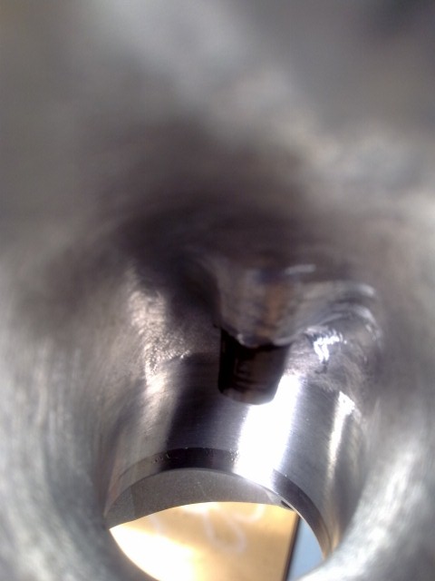

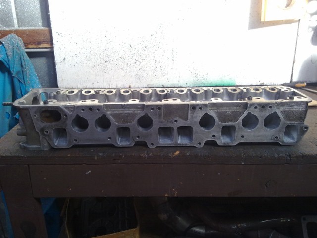

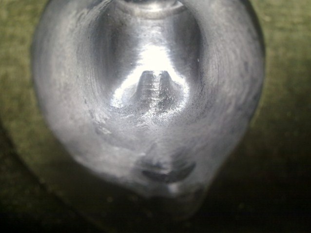

peter mc Posted August 26, 2011 Posted August 26, 2011 today's effort i should have the ports finished on the weekend and then i will fit new guides and seats and Finnish the chambers Quote

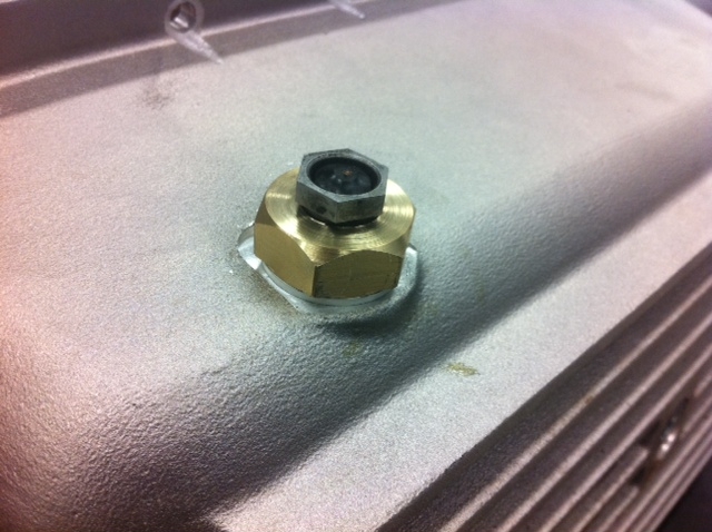

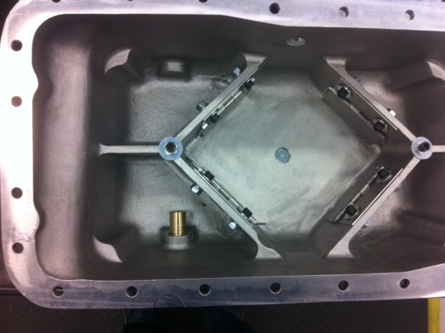

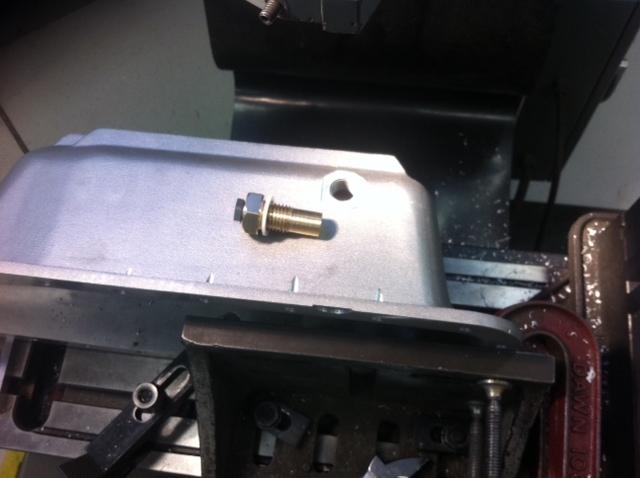

luvemfast Posted August 31, 2011 Author Posted August 31, 2011 While Peter is doing his magic, I've been doing a couple of small jobs for the new build. After the oil failure of Frankenstein, I'm not taking chances to damage the race engine. This was the main reason for putting the Arizona Z Car baffled sump on. To fit the oil temp sensor like factory, so it can be removed while there is oil in the sump. It was necessary to make up a bung. It was pretty simple. Turn some brass with an M20 x 2.5mm thread on the outside and internal M16 x 1.5mm, then mill a 28mm hex on the head. Drill, tap and spotface the sump. There are a couple of bosses cast into the sump for adding such things, it really is a nice bit of gear. Get one while the $ is high. Fit the teflon washer and screw in I've oreded a new sensor from MAS and he has sent it in the mail. Thanks Ash I've got a few other things that I need to do, but have had a frantic weekend (10 month old daughter in hospital). I'll try and get the stuff sorted. What else do I need Peter? Does anyone have a good spare oil pump/ dizzy drive gear from the front of the crank? Quote

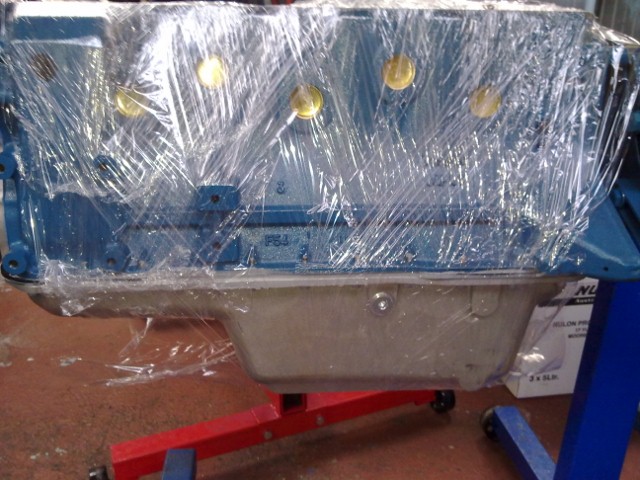

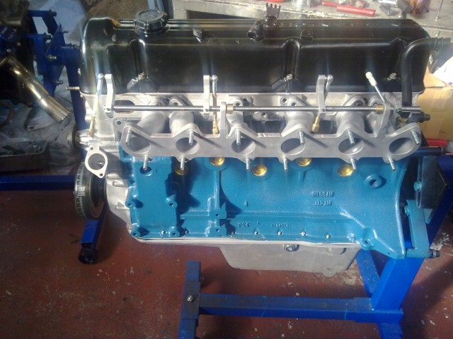

peter mc Posted September 9, 2011 Posted September 9, 2011 hi Simon just a pick to show you were we are with the L28, i have got the sump and girdle fitted and all the timing gear so next thing will be Finnish the head when it comes back from the shop so it wont be long Quote
Moderators Zedman240® Posted September 9, 2011 Moderators Posted September 9, 2011 Didn't realise that sump is so friggin big! looking real good! Quote
peter mc Posted September 9, 2011 Posted September 9, 2011 yer abuot 7L off oil with the filter very good sump for the $ Quote
260DET Posted September 9, 2011 Posted September 9, 2011 Arizona sump? Good thing, just don't hit a ripple strip with one. Interested in seeing the girdle fitted. Quote
peter mc Posted September 9, 2011 Posted September 9, 2011 one good thing they weld really nice if you do crack them when you crash Quote

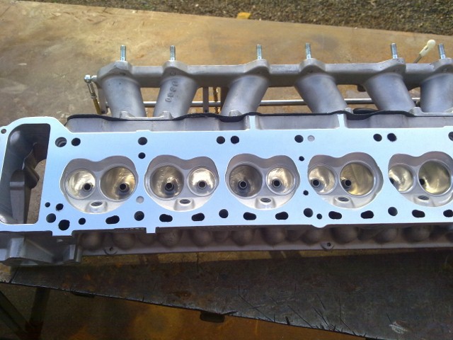

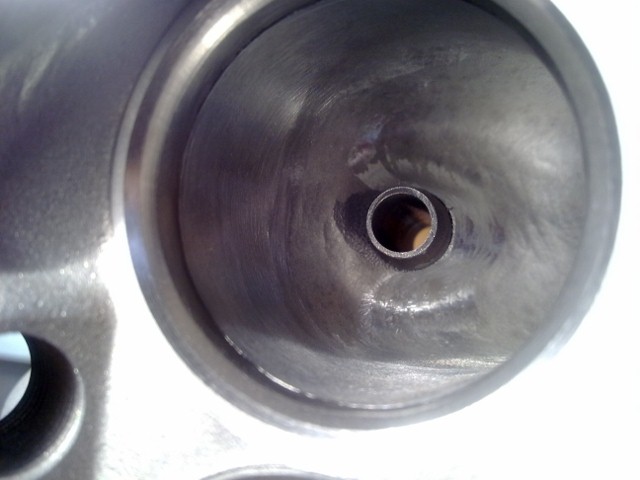

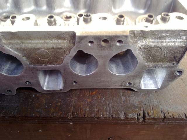

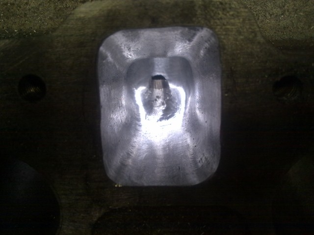

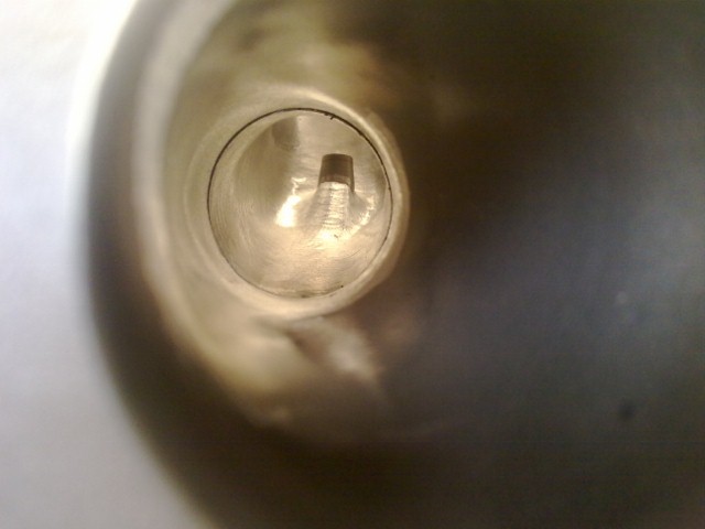

peter mc Posted September 13, 2011 Posted September 13, 2011 Simon some picks of the head with the manifold on, spent some time matching the ports to the manifold and blending the seats as they were replaced .also tapered the guides on the inlet and shorter on the exh side hope you like the picks Quote
Sirpent Posted September 13, 2011 Posted September 13, 2011 Magic ! Jus seems a shame to hide all this work at the end, then again the performance gains will always speak for the fine work you did Pete. Quote
luvemfast Posted September 13, 2011 Author Posted September 13, 2011 Tis looking the ShizBits Big Mac. Hanging to have her bolted together and home where she belongs. For those that think I'm not saying much about the pics should know that Peter sends me heaps of progress pics. Quote

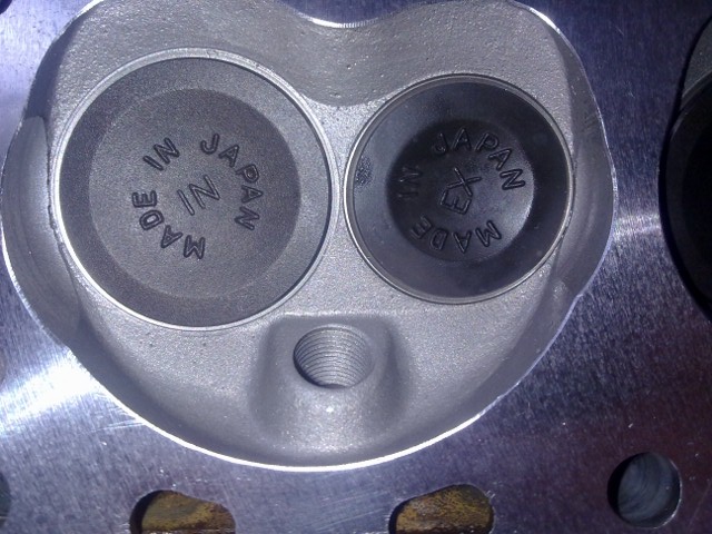

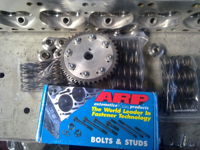

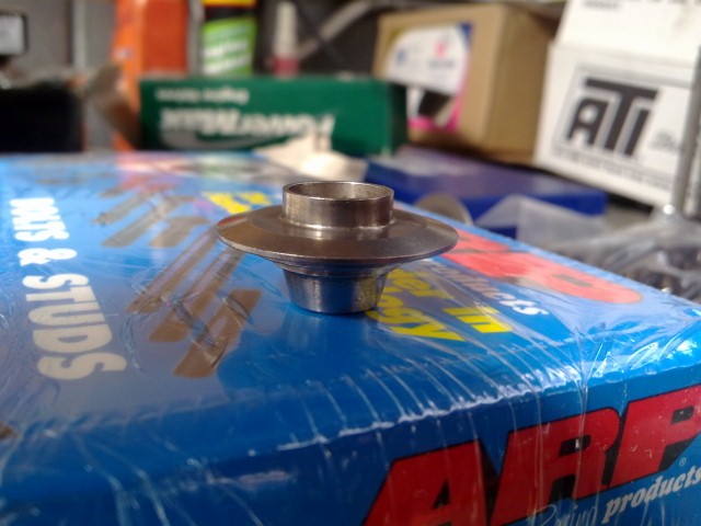

peter mc Posted September 14, 2011 Posted September 14, 2011 hay Simon some more picks of the parts for the top end new hsd springs ,high side retainers , APR studs , and adj timing gear hope to fit it all up on Friday ,,, and then set the cam up next week Quote
luvemfast Posted September 14, 2011 Author Posted September 14, 2011 If only the head on your shoulders was as sexy as the head going on my block. Quote
