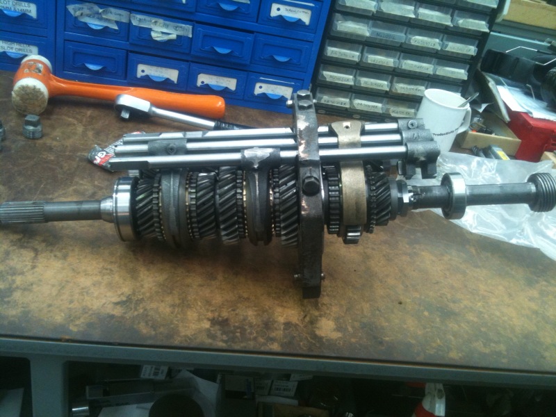

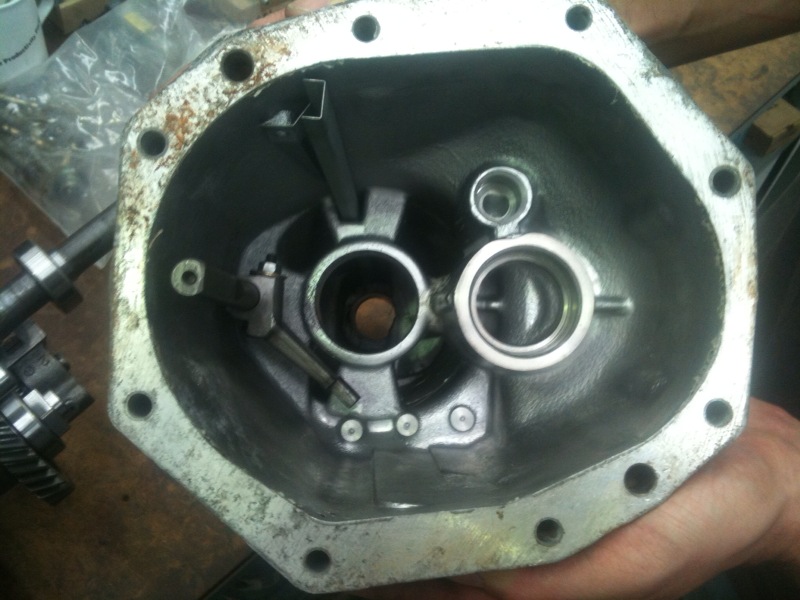

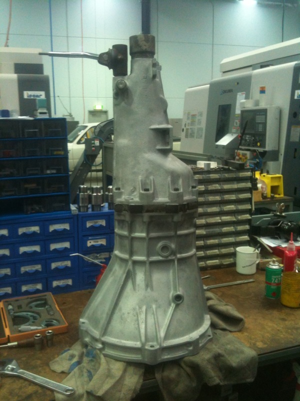

luvemfast Posted March 9, 2010 Author Posted March 9, 2010 Thank goodness my Z spends most of its life up on stands the height of a four wheel drive. With all this rain and flooding we've had here in Melbourne. Thought that some prepwork for an upcoming sprint meet at Calder park should be done. Getting the Carbies tuned was high up the list, but haven't gotten there yet. While changing the gearbox oil, it is expected to find some teenie tiny bits of steel filings on the magnet on the sump plug. We found large chunks! So gearbox out and off to Hollinger to be rebuilt. My best buddy works there and I have been waiting for years to take my box there. So no time like the present. After pulling it aprt , we found that the main bearing was rooted. Maybe you've seen the pic that Fev took of it when it wasn't looking. Aprt from that, it looked really good inside and the experts were happy to reuse all the gears and synchro's. Sandblasting and hot washing of parts that can be to make it look pretty and new bearings have been ordered. I'm looking forwards to get it back together. Will post some pics when I get some. Quote
hunterzed Posted March 9, 2010 Posted March 9, 2010 Hey Simon, good to see there wasn't too much of a problem with the box. At least you'll be back up and running fairly soon and fairly cheap too. Good luck. Steve Quote

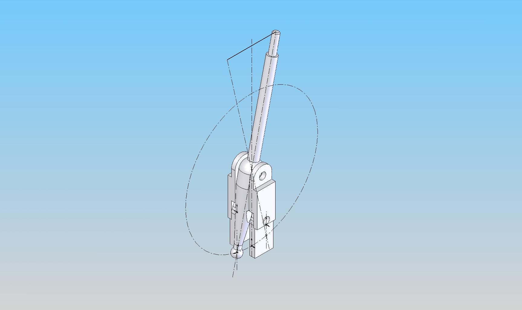

luvemfast Posted March 11, 2010 Author Posted March 11, 2010 Been playing around with an idea for a short shifter while the box is out. Standard pivots 40mm from the ball end on the gearstick, this design pivots 90mm from the ball end. Only shortens 1st-2nd, 3rd-4th & 5th- reverse direction though. Pretty simple to do though, only 3 new parts and 2 new fasteners. If it works at all that is! How far is the standard gearstick top from the gearbox? My old is cut shorter, but would make it factory height again. Quote
Moderators Zedman240® Posted March 11, 2010 Moderators Posted March 11, 2010 Simon, just make sure your gearbox is ok to handle the quicker shifts! Quote
luvemfast Posted March 11, 2010 Author Posted March 11, 2010 Simon, just make sure your gearbox is ok to handle the quicker shifts! I asked it and it said ok. How do you propose I do that? Its being reco'd, what more can I do? Quote
Moderators Zedman240® Posted March 11, 2010 Moderators Posted March 11, 2010 Being a gearbox 30+ years old and never being designed for a short shifter, I'm no expert but something may wear prematurely. If you had a gearset made for it, that's another story. You'd be the first I know of who have made something like this so I guess we will find out how it all goes.. Quote

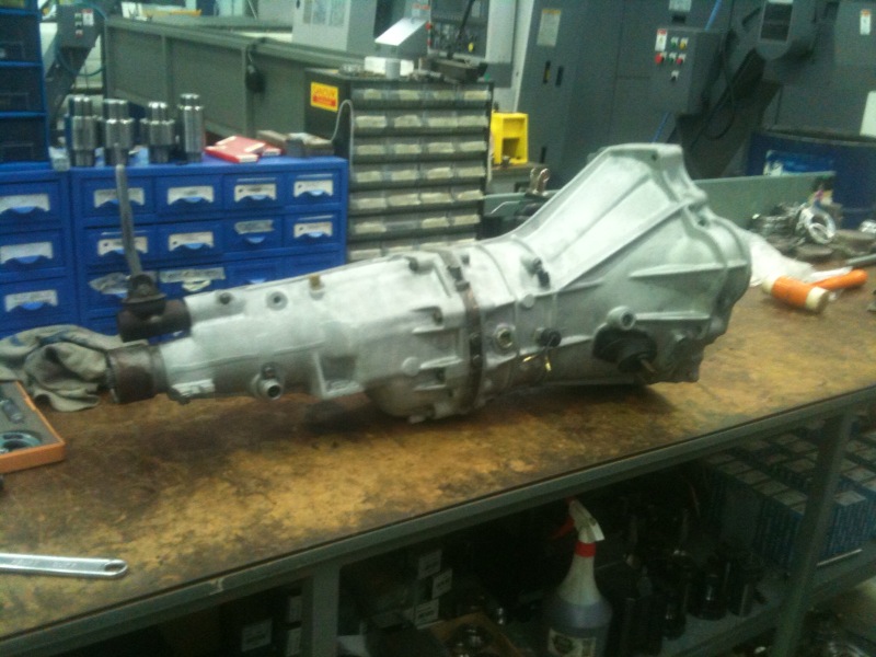

luvemfast Posted March 19, 2010 Author Posted March 19, 2010 Well tonight has been fairly productive as I have a drivable Z once more. The gearbox was finished off Thursday night, I had a hard on all day thinking of getting layed.... under the car to fit it. Everything went smoothly and I kept waiting for something to go wrong so I'd have to pull it out and start over, but it never happened. Tomorrow is the big test day for the original reco'd gearbox. I've been running a 260Z gearbox in it all this time, so will be interesting to see the difference. The short shifter hasn't been made yet, so obviosly it hasn't been installed. While we were under the car tonight, dad moved some cobwebs and shinned the torch under where I had been working and discovered a big redback spider..... right next to where my hand was. Talk about lucky huh? I squished it with some pliers...... My mate who works at Hollinger, and helped me rebuild it, asked "If I minded someone else fu*king around with my box while I wasn't around?" To which I replied "Nah man, as long as you lubricate the shaft before engaging the fork, don't damage any of the ring gear and leave it nice and clean when finished after your play. I'm cool with that." Sad but true story. Here's some pics of the box..... Quote

luvemfast Posted March 24, 2010 Author Posted March 24, 2010 Hey Simon, good to see there wasn't too much of a problem with the box. At least you'll be back up and running fairly soon and fairly cheap too. Good luck. Cost about $130 in the end, which is pretty good in my books. Didn't take too long either, thanks to some help. Quote

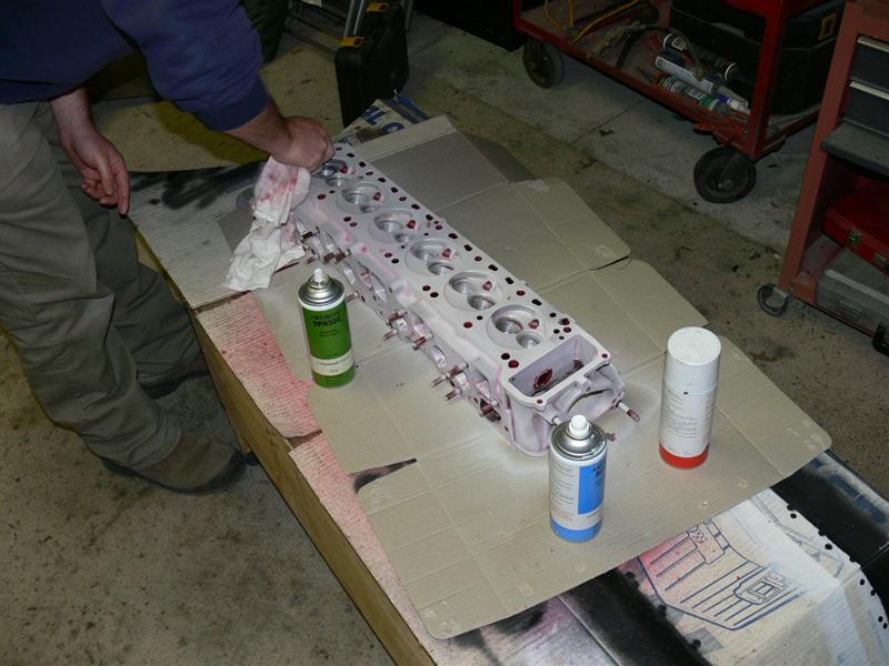

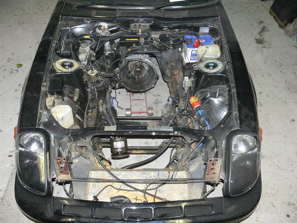

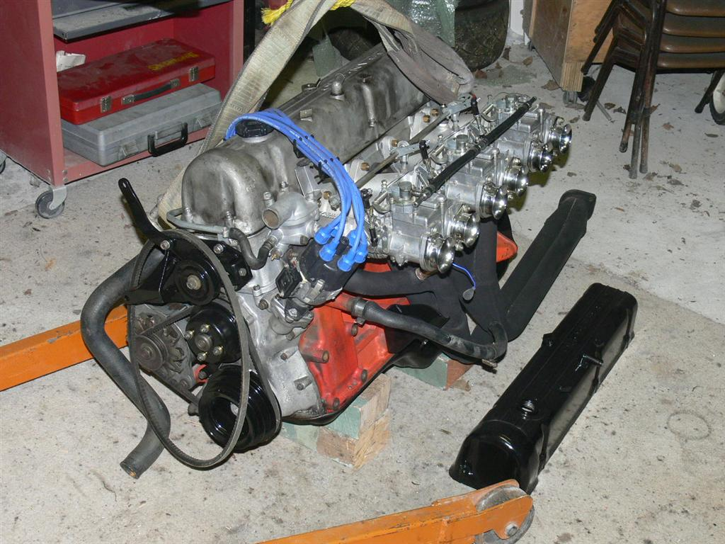

luvemfast Posted August 22, 2010 Author Posted August 22, 2010 Frankenstein Engine rebuild stalled as a fellow forum Z'er mentioned that he had an L28 he no longer needed. I pounced at the opportunity to get my baby going once more. Only this engine had some goodies on it that I have always wanted to do. *2mm oversize pistons from a Toyota (hence the name "Frankenstein", thanks Gareth for the name) *.49" lift 74 deg cam *Balanced bottom end It came down from Brisvegas on a pallet that Ross had secured brilliantly, thanks mate It looked a bit worse for wear on the outside, but I had high hopes for the ineternals. Up on the engine stand it goes for inspection, only to realise it has a middle sump fitted. Oh well, time to look in my parts bin for Z bits. While the sump was off a visual was carried out and cheking it turned over freely was done, the right bits were put on. Then bolt ons were removed and taken for sandblasting to give her a a bit of make up to pretty her up. Once it was all painted and put together it was time to install it in the car as a complete assembly. It took way longer to get in than expected, and I had to take the carbies off as they were hitting the strut tower. "Why are they so close?" oh well keep going. Benny came over to help finish it off and when I told him that its weird that there wasn't enough room to get the carbies on. He laughed and asked if I had the engine mounts on the right side, I laughed and said "Of course they're on the right side...... Oh wait............. oh sh1t!" Quote

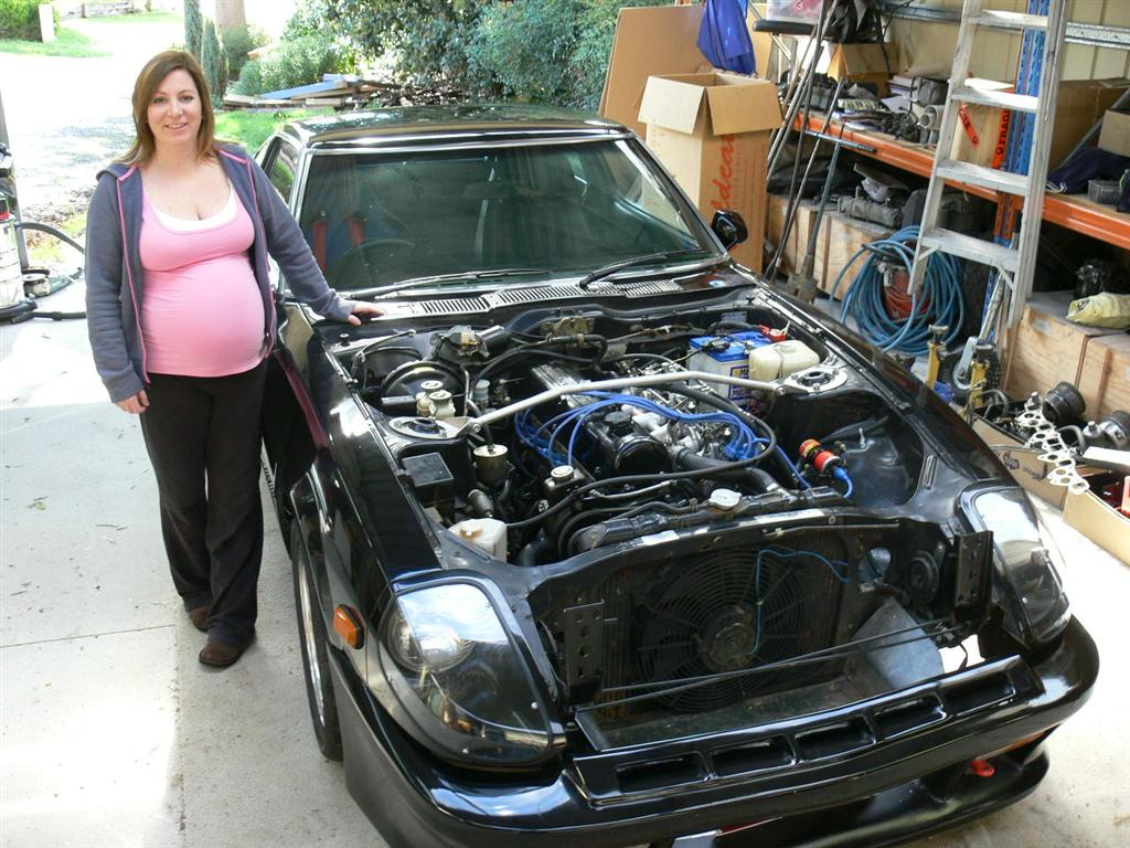

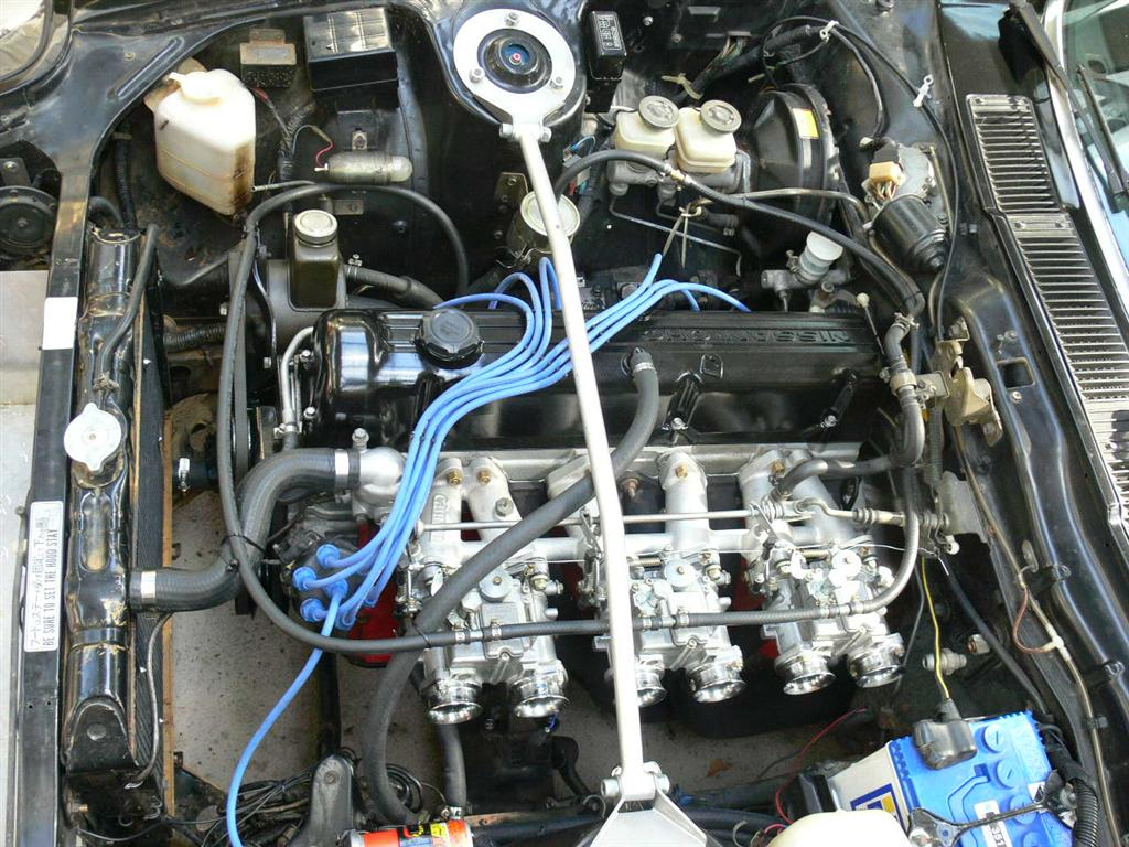

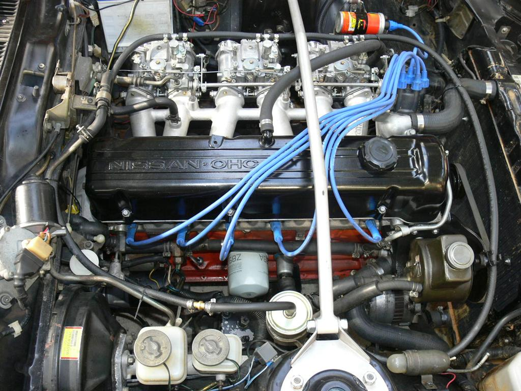

luvemfast Posted August 22, 2010 Author Posted August 22, 2010 So we fixed the engine mounts and fitted the carbies (now there was room) and radiator. All this was done between Ben laughing at me! Next the fluids needed topping up, which means to remove the old oil filter and put on the new one....... Simple right?........ Wrong! The new L28 doesn't have the mounts to change position of the filter because my car has a big power steering box, right where the oil filter is. So we had to undo the engine mount once more to get the filter off, then drive down to the auto parts store and get a matching oil filter, but shorter. Luckily the AU Falcon does just that. So homeward bound to get this baby fitted and running. Once the radiator was filled we were ready to fire her up, only now the rad is leaking water out of it. Bugger. i'll get a new one next week. No matter, we'll keep an eye on it. Here is the first fire up The timing was set after this video, which made a massive difference. I took it out for a spin later and it went awsome, much more power than its ever had and it is responsive too. You can feel the cam, it revs soo quick and pulls all the way to 6,500RPM. So I can't wait to get it back on the road properly now, DECA is coming up in a few weeks. I entered at the club meet and blew the engine on the way home a few months back. So I'm pretty amped right now. Oh yeah, my wife and I are also expecting our 2nd baby mid Oct, she's obviously the preggo one in the pic below . Quote

Riceburner Posted August 22, 2010 Posted August 22, 2010 Excellent there'll be a heap of Z's. The backfire was pretty awsome in the video, it looked like it got your battery! Loved the 'it's alive' comment, very apropriate Quote

luvemfast Posted August 22, 2010 Author Posted August 22, 2010 The backfire was pretty awsome in the video, it looked like it got your battery! It did, there is a brown mark on the battery. It was before timing was set, in the video I was just turning the dizzy trying to get it to run better by ear. FAIL, it was soooo retarded. Now running at 15° advance. Also forgot to mention that when I dropped the car to take it for a test run. I put it in reverse to back out and nothing happened. It was in gear, but not engaging drive. I thought that because it was running a different flywheel that it may need the pivot adjusted in the bellhousing. But once Iit was jacked up you could see that the slave cylinder was already sticking out way too far, the pressure was released by bleeding system and all was good and happy in the world again. I may not be able to come down to the Island to watch this wekend though Gareth. But have fun Quote
AussieZed Posted August 23, 2010 Posted August 23, 2010 Hey mate, Is that actually the motor that I sold you?? Gee you work fast. If it is that motor, legend has it that it came out of a 'very special' LHD 280z 2 seater imported by a US serviceman at Pine Gap, so it's found it's way to a very appropriate home.... .... and man do I LOVE the look of the motor .... I'm suffering serious carburettor-envy ... I'm going out to my car to stare grumpily at my SU's. R. Quote
