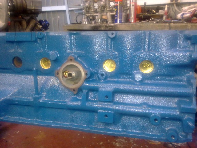

luvemfast Posted August 14, 2011 Author Posted August 14, 2011 Wurp wurp wurp wurp wurp Woooooooooooooooooooooo That what guys are going to here as I pass them on the track........ Especially Gerhard Nice big bores Pete Shot from underneath? Don't know if I've posted about the specs? But.... P90 head, porting by PMC 89mm Domed forged pistons, custom made at JE pistons. 140mm long forged rods (pin height raised in pistons), Max Speed Rods. Crank and block with modified and lugged oil passages. Controversial Block Girdle, supplied by me. Arizona Z Car aluminium baffled sump. ATI harmonic balancer. 4140 lightened race flywheel, with Sachsen clutch (TBA) Recurved, mechanized electronic dizzy. More headwork TBA If this doesn't put a smile on my face when I drive it, I'm selling the Z! just a few picks of your L28 mate Oh, should that read L30? Quote

Riceburner Posted August 17, 2011 Posted August 17, 2011 L30........ I don't think this will be allowed, you should go with an L24 instead What's the predicted power output from this? Quote
luvemfast Posted August 17, 2011 Author Posted August 17, 2011 What's the predicted power output from this? Whatever yours is +10% Its pretty much your engine with a bigger bore, longer rod length and more compression. However, my car weighs more. So will be intersting on the track together. Quote
NZeder Posted August 17, 2011 Posted August 17, 2011 FYI my old L30 just like this but 90mm bore, L28 crank, L24 rods and custom pistons I got from Japan (old Tomie items cast but only a few g's heaver than a 87mm JE item) is making 215PS at the wheels on 40mm webers at 5450 the new owner is happy enough So that might give you an idea on the power levels you should get - and more I hope Quote
luvemfast Posted August 17, 2011 Author Posted August 17, 2011 it will make 170kw atw no problem Woooooooooo Gunna pull some awesome skids.............. In my pants Quote
Sirpent Posted August 17, 2011 Posted August 17, 2011 Whatever yours is +10% it will make 170kw atw no problem Pretty good Simon, Thats about -10% less than mine should make. Sorry mate just having a small dig LOL Quote
