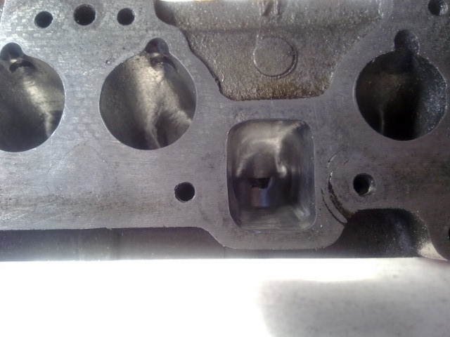

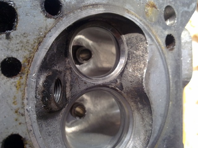

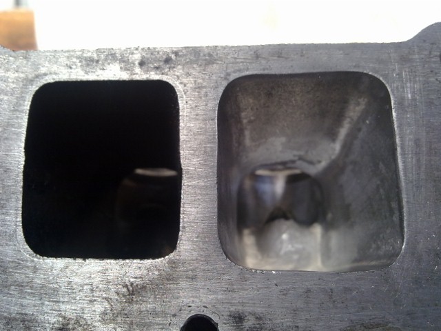

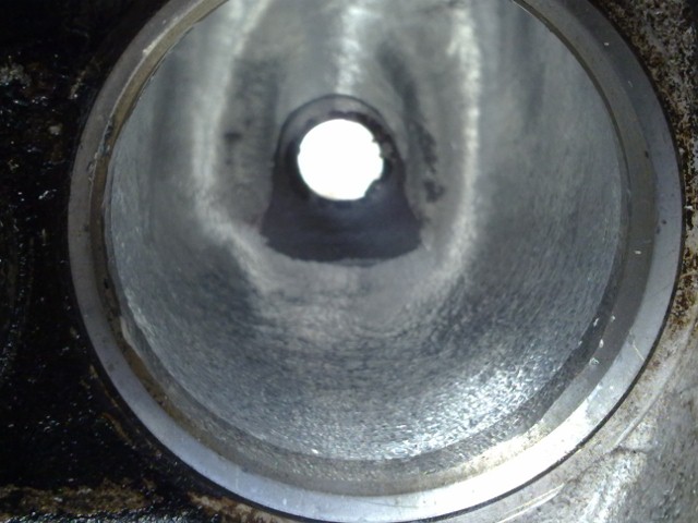

peter mc Posted August 22, 2011 Share Posted August 22, 2011 HI simon i started the head today thort i would post some picks Quote Link to comment Share on other sites More sharing options...
luvemfast Posted August 22, 2011 Author Share Posted August 22, 2011 Are you illiterate as well as dense? Your comment above makes NO SENSE whatsoever...! This is what I've been dealing with. Jim at Max Speeding Rods clearly cannot understand nor comprehend that they could have possibly made a mistake. His big come back is I'm not using them in an FJ20 and that Kameari rods have 21mm pins. Even though he told me earlier they are OEM. I don't think he knows what he is on about. HI simon i started the head today thort i would post some picks Looking great mate Quote Link to comment Share on other sites More sharing options...
Riceburner Posted August 22, 2011 Share Posted August 22, 2011 This is what I've been dealing with. Jim at Max Speeding Rods clearly cannot understand nor comprehend that they could have possibly made a mistake. His big come back is I'm not using them in an FJ20 and that Kameari rods have 21mm pins. Even though he told me earlier they are OEM. I don't think he knows what he is on about. Looking great mate I used spool Australia when purchasing my rods, found them to be great. Max Speeding Rods will come up online for potential customers searching info and with the shocking service and incorrect supply of parts shown here, I'll bet customers will look elsewhere. Another porting masterpiece on it's way, with a 76 cam this should be a monster! Quote Link to comment Share on other sites More sharing options...

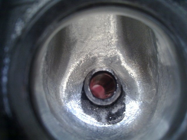

peter mc Posted August 23, 2011 Share Posted August 23, 2011 HI Simon 2 more ports finished ....the dust pan is one exhaust port. and the spool rod are hear and are all good and 22mm Quote Link to comment Share on other sites More sharing options...
luvemfast Posted August 23, 2011 Author Share Posted August 23, 2011 Don't blame me for your messy house mate Update with Sir Max a Wrong. Afte much pushing and negotiations. They have agreed to refund my money, less postage. So it's good to know they will stand by their product and take ownership of problems. In the meantime, looking forwards to watching Peter's hard work Quote Link to comment Share on other sites More sharing options...
peter mc Posted August 24, 2011 Share Posted August 24, 2011 and we half way there Quote Link to comment Share on other sites More sharing options...

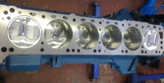

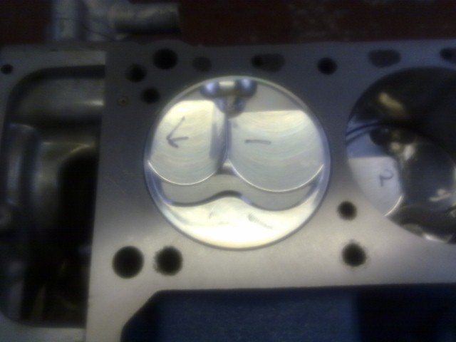

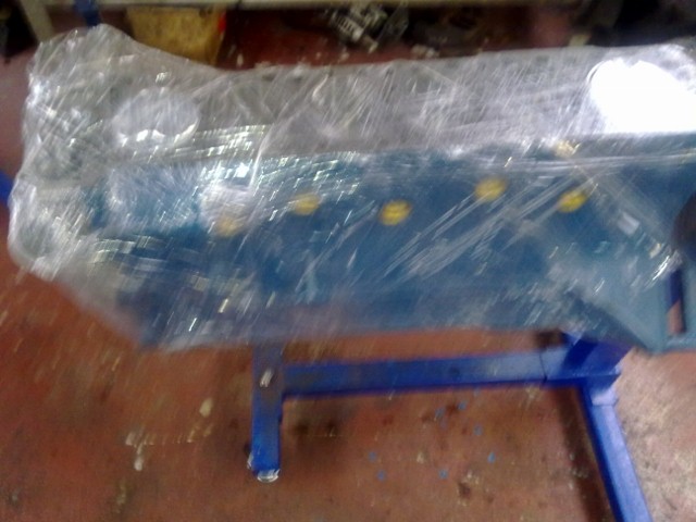

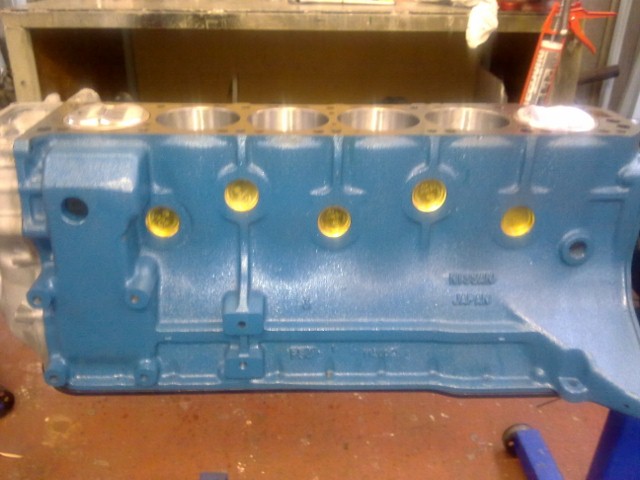

peter mc Posted August 25, 2011 Share Posted August 25, 2011 Hi simon got the rods back from the balancer so put it all together and wrapped it all up hope you like the picks and my arms are fine new tools are much nicer to use ... Quote Link to comment Share on other sites More sharing options...
