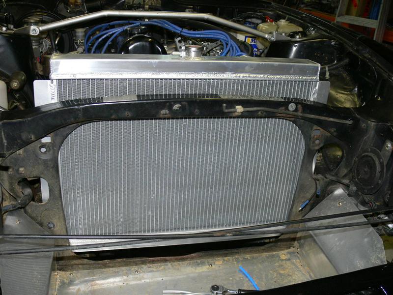

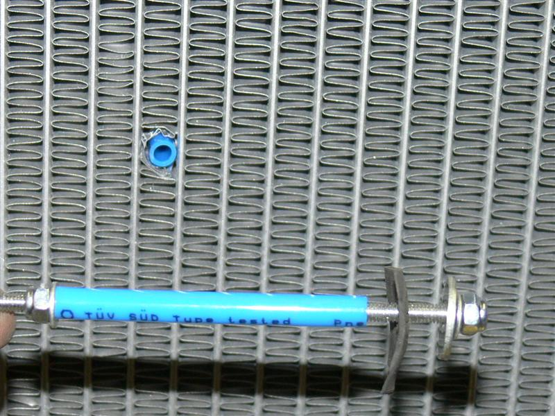

luvemfast Posted September 8, 2010 Author Posted September 8, 2010 Got a replacement radiator from ASI in Laverton for $215, thats a good price. Geez I hope it works The first pic is of it straight out of the box and sitting behinf rad support panel, sits about 70mm too hight due to side mounts hitting chassis rail. So out with the jigsaw and viola. Perfect fit. It needed 10mm spacer washers between the mounts and the rad support panel, which I turned up from brass beforehand. just in case (made a few sizes). Glad I did, as it wouldn't fit otherwise. The inlet and outlet line up perfectly and the core is close to 15mm thicker than factory one (45mm to 60mm,approx). Also had to cut the rad mount around the air holes in rad support panel. Next I needed to fit the electric fan. The previous setup was a blow through as there isn't enough room between radiator and engine and it worked fine. So I thought I'd just do the same, but since this one is aluminium I needed to protect the soft metal with the mounting screws (allthread). Luckily we have heaps of Festo air line laying around at work and since I only needed about 200mm, found some scrap to use to protect the allthread, well er, radiator. All hooked up and worked no worries. Flushed out the cooling system, then topped her up and now she's ready to rock'n roll. Quote
luvemfast Posted September 8, 2010 Author Posted September 8, 2010 Took her out the next day for a test run and it was horrible. Wouldn't idle, ran rough, then ok, then rough again. Wouldn't rev over 5,000rpm and felt like it wasn't driving on all cylinders, thought that I had totally stuffed something up. :'( It was only when was playing with the jetting one night. That I removed the covers on the carbies only to find cylinder 5 main jet tube had come undone. I changed the jets over, checked everything was tight and fired her up....... Woo Hoo!! Fixed the problem. Took her out for a test run and she's sweeeeet. Just need to change the oil and filter this weekend, play some more with the jets and I'm ready for DECA. I've lined up a trailer to tow it to Shep and back, just in case........ Anyone have any idea on what jets I should start at? I have a selection of jets to choose from. Triple 40PHH Mikuni carbies Ø88mm flat top pistons (2mm oversize, which makes it a 2.9L) 0.49 inch lift 74° cam balanced bottom end recurved and mechanical advance dizzy, set to 15° advance with timing light Extractors 6-2-1 to 2.5" exhaust Quote
Moderators Zedman240® Posted September 8, 2010 Moderators Posted September 8, 2010 $200 for an alloy radiator..that's a bargain! My one owes me approx $600 with a fan though..but still, Davies Craig fans aren't that pricey! looks great Simon...well done. Quote

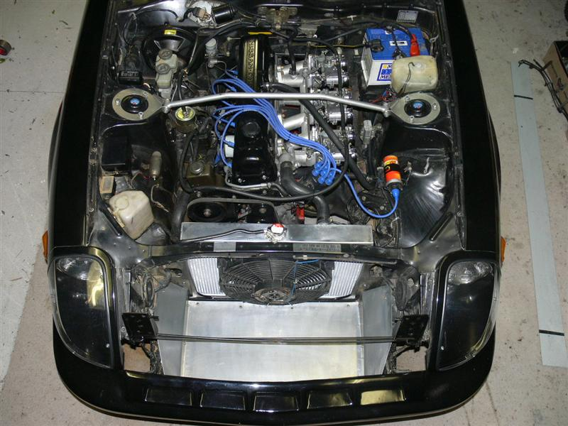

Riceburner Posted September 8, 2010 Posted September 8, 2010 Nice Out of interest what does the sheetmetal do infront of the radiator? Quote
luvemfast Posted September 8, 2010 Author Posted September 8, 2010 Nice Out of interest what does the sheetmetal do infront of the radiator? There is nothing between the spoiler and the car, just fresh air. The aluminium sheetmetal is to force flow through the radiator. Quote
Riceburner Posted September 9, 2010 Posted September 9, 2010 There is nothing between the spoiler and the car, just fresh air. The aluminium sheetmetal is to force flow through the radiator. Ok, very well thought out, did you notice any difference with it? Do you know if 240/260's would beifit from this kind of handywork also? Quote
luvemfast Posted September 9, 2010 Author Posted September 9, 2010 Ok, very well thought out, did you notice any difference with it? Do you know if 240/260's would beifit from this kind of handywork also? Did make a difference. I don't know what your spoiler set up looks like. But if its not connected, it should force the air through the radiator rather than flowing around another path. Path of least resistance, your a plumber aren't you Gareth? Quote
Riceburner Posted September 9, 2010 Posted September 9, 2010 Did make a difference. I don't know what your spoiler set up looks like. But if its not connected, it should force the air through the radiator rather than flowing around another path. Path of least resistance, your a plumber aren't you Gareth? Mine does look similar, looks like I'll be doing that upgrade soon then. Yes plumber but my skills finish with pipes.... and stuff Quote

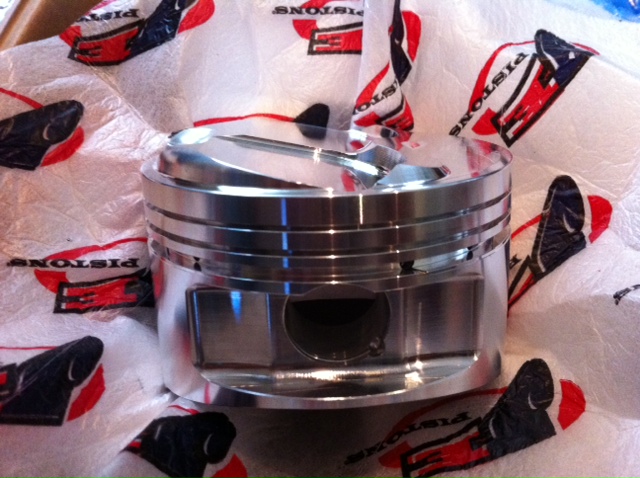

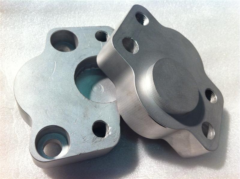

luvemfast Posted March 30, 2011 Author Posted March 30, 2011 Just received some new bits last night. The collection of go fast parts is improving These have been imported from the states from JE, custom made to my specs. http://www.racetep.com/JE.html They are forged and to suit a P90 head aiming, Ø89mm and aiming for 10.5:1 compression. Coupled with my forged conrods, should make for a strong bottom end. Quote

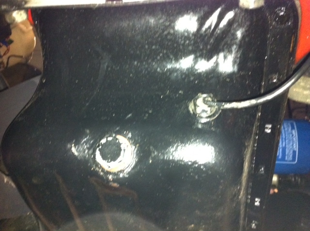

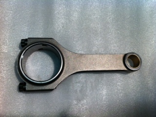

luvemfast Posted April 6, 2011 Author Posted April 6, 2011 Got out in the garage last night to prepare the car for Winton this weekend. Grease & oil change and check over the car. You know the drill. While I was under there. I decided to try and find a solution to my oill temp not working. Low and behold, I found an L28 sump in a box. Which had the thermocouple still in it Will be good to know what the oil temp is again. Oh and while I'm at it..... Here are my new forged 4340 conrods FJ20 units, the pistons were made to suit due to the extra 7mm length. We're always after a little bit longer aren't we? Quote

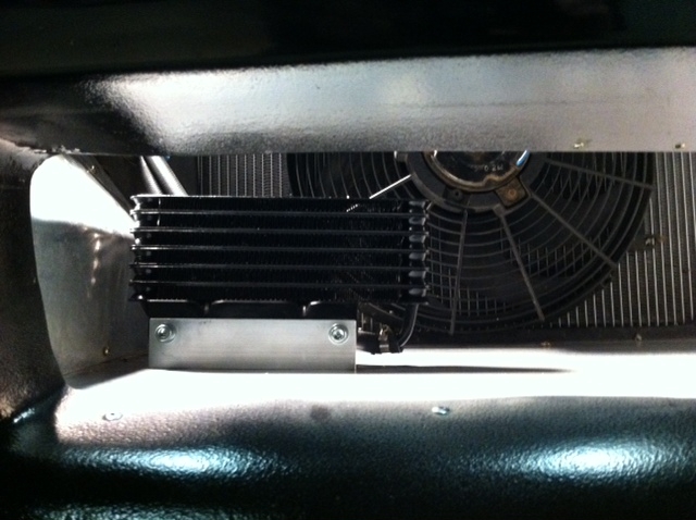

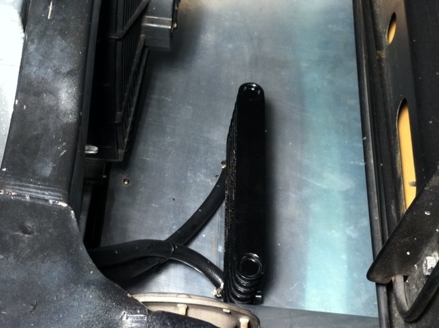

luvemfast Posted April 7, 2011 Author Posted April 7, 2011 I've always found at the track, that the power steering fluid gets too hot and "boils" over. Granted this was with the last motor and radiator which ran much hotter than the current set-up. But I'm not willing to take a chance and find out it still does it at the track. So last night decided to fit a cooler that I had laying around. Hopefully this all works well. Quote
