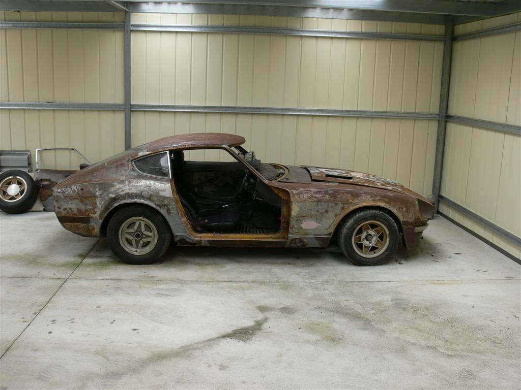

During that time, I got the itch for another Z. I went with my dad to look at 2 280ZX 2 seater's, both in the trading post the same week. The first place had a 240Z sitting in the corner of the garage. Half stripped of parts and paint, looked very, very sorry. Under closer inspection, I noticed it was turbo'ed and had nitrous.....sick. I ended up buying that to restore. While dad bought the other 280ZX 2 seater from a farmhouse out near Ballarat, it had been sitting in a barn for about 8 years.
My 240Z sat under a tarp for about a year while I built the garage. Then I stripped it down to just a rolling shell and started on the bodywork with my fathers help. He would help me with my Z, I would help him with his Z.
But, it all got too much for me though as I had becoming a father soon and I already had no time to work on cars. So my new best friend Ebay had a job to do. I sold the car for parts and used that money to go halves in the 280ZX 2 seater with Dad.

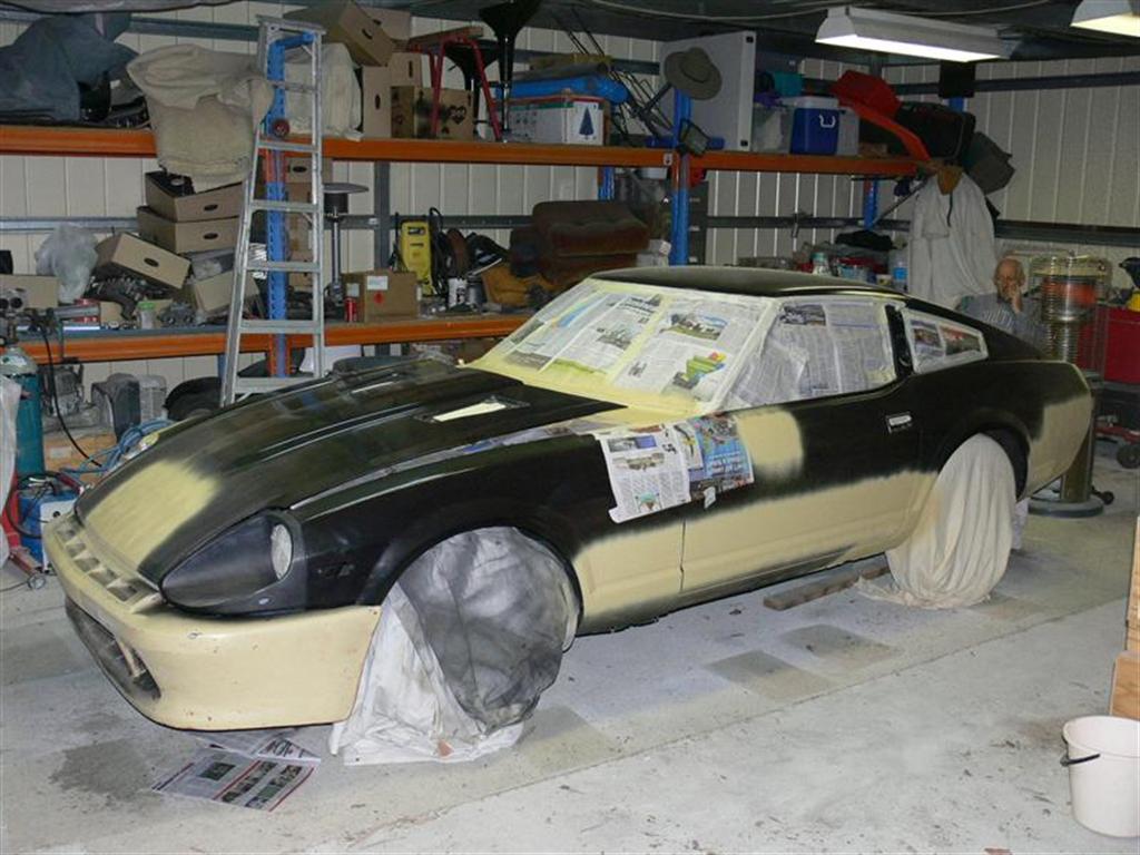

It had a quick paint job, a rear end transplant from a series 2 and a new clutch. That’s all we did to it before I bought in on it.

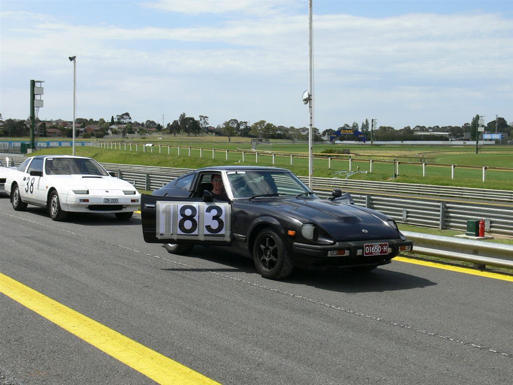

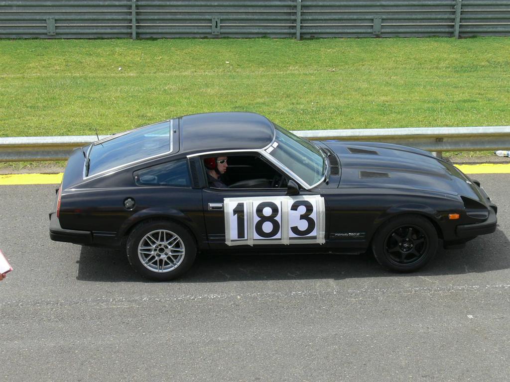

Wow, it was a 35°C day. Which on the track is bloody hot. Mum entered in the 200ZR, it had a dodgy ignition module we found out later (Even I could drag it down the straight). To the Datto’s credit, it did fantastic to take 2 drivers without an engine failure after all that time sitting in a barn. I have the philosophy from my 4X4 days. “When in doubt, rev it out”. I tend to go as fast as possible, find the line of being out of control, then pegg it back a bit. After setting my best time for the day, I had a brain fade at the end of the front straight, when braking I dropped it from 5th to 3rd. This created the biggest compression lock up that I have ever experienced. I didn’t jump on the brakes, I thought to myself. “I can accelerate out of this”. Boy was I wrong, maybe with more power. But what happened was the car flicked around to be travelling at over 100km/h on the grass, backwards. It was all in slow motion. When it stopped, I thought “WOW that was fun”. Don’t think I want to do it again anytime soon though. That was the last lap of the 3rd session. Dad went out on his 4th run and set his best time for the day. Then back to me to jump back on the horse. I set another fastest lap and on my 2nd lap of my 4th run, after dad had his 4 runs, I was having a blinder. “Fingers and thumbs…….fingers and thumbs” I thought to myself as each corner was smooth and fluent. Until, approaching turn 9 after racing through the chicane’s I jumped on the brakes…….. "Ping". My foot went straight to the floor. Which meant I was carrying a lot of speed into a 90° left hand corner. I threw the car sideways to wash off speed and try to get around the corner without luck and end up with the front of the car in the sand trap. I limp back to the pits only to find that I spat out a front driver side brake pad. I think my driving philosophy changed that day! My best time was a 1:43.31, 2nd last in class only to my dad in the same paddock basher.
There are things to take away from every negative event. First, check underwear. 2nd You're not as good as you think you are. 3rd Make sure that you can slow the car down and go around the corner.

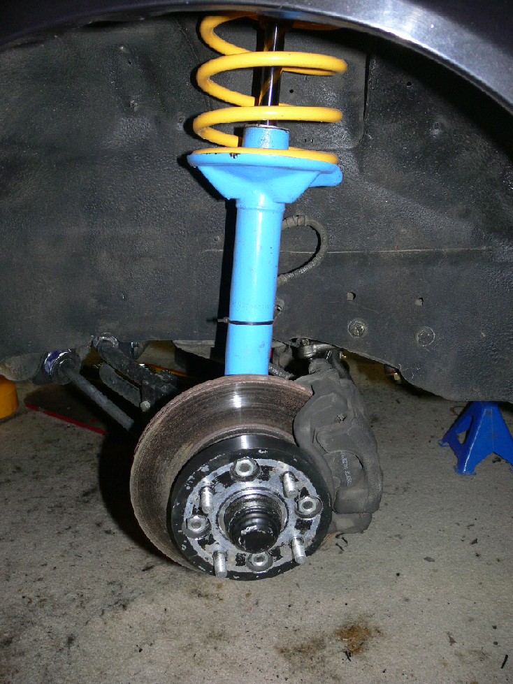

Suspension
After Sandown the car went up on blocks. Brakes and suspension needed work. Brakes are a big job that I'm not ready for just yet, so handling it is. Research showed that Tokico shocks seemed to be the best bang for buck and it’s hard to go past King Springs. Only one problem, no one in this damn country carries performance parts for my car. WTF's with that? The Aussie dollar was strong against the greenback so the USA was ripe for the picking. I found a guy through HybridZ willing to send to Australia. So I got Illumina's for the front and HP's for the rear (don't make adjustable rears). King Springs also made me custom extra low coils (2"), std lowered height is 1". Great now I have the parts, time to fit them. Off comes the front end, springs off. WOW. I can push the front shocks down with my pinky easily. When I pulled them apart to fit the cartridges, it was all perished and doing NOTHING to dampen. Very good choice for replacement.
Captain obvious tip of the day.
While everything is all-apart, I highly recommend to clean the bits and pieces. Then get some spray paint and go for your life. Cleaning components gives you a very good opportunity to inspect them for condition and fatigue. While the spray paint makes it look da sh1t.
Put all the parts into a paper bag. Shake it until the rattling stops. Now pull out the complete assembled strut. It’s that easy. Once fitted on the car, I remembered my “mishap” at Sandown. Brakes. No time or money just yet for the upgrade. A very nice and noble man, Dave Toleman, “loaned” us some standard 280ZX front calipers as ours needed an overhaul. New pads and a bleed and its time to test. YAY, my favorite part to upgrades!

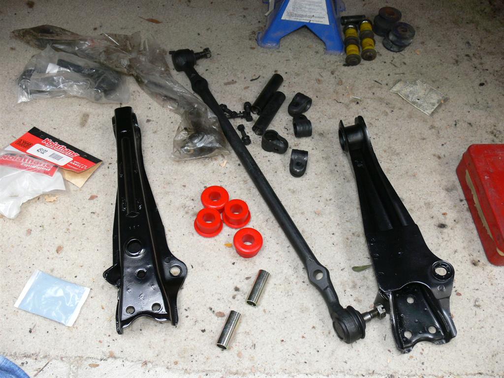

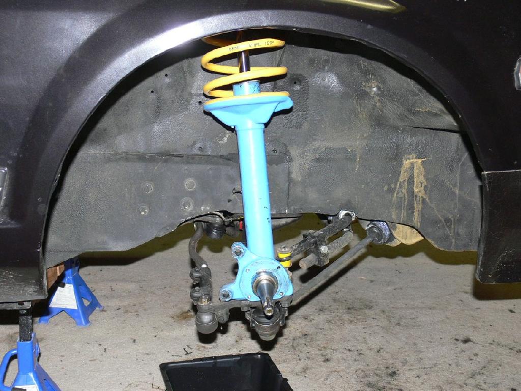

Front End
Once again, the car is up on blocks and the front end tinkered with to find out whets going on. There is some movement in the draglink arms. That’s right folks. Due to cost cutting in the late 70's, the peeps in Japan took a step backwards for the series one S130 model Z’s from rack and pinion used in S30 cars. The boys on the tiny continent saw the error of there ways and changed it back to R&P for series two onwards.
So I picked up the phone and rang Rob Mills at Ringwood Auto for some replacement parts. I went to him as he’s been racing Datto’s for years and is familiar with them. When in doubt, replace the whole lot. Tie rods, idler arm, ball joints and all bushes were ordered. Once again not all parts available easily. New draglink $300 ex Jp. Same money for reco. Alan Entwhistle said there was a series one 280ZX at Centre Rd wreckers, so of we go…. Before we took it off the car we checked it as nice and tight, no slop at all. When I undid the idler arm knuckle, a small rubber washer fell off. The penny dropped. Ours must have perished and fallen off. We have spent hundreds of dollars and hours of work for a 20cent washer.
When in doubt, don’t replace the whole lot, just yet.  Check all the parts are actually on the car.
Oh well, at least we know its all good now!

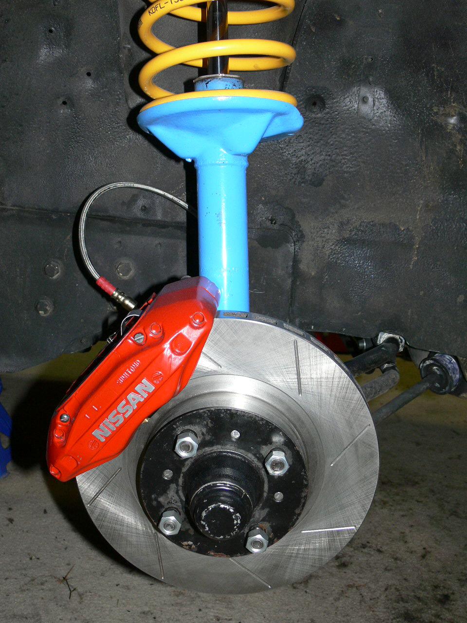

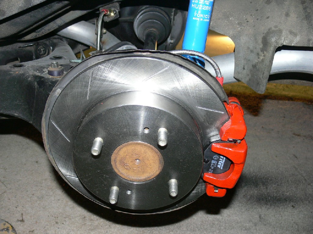

The next event was Calder Park, on a very gloomy and wet morning. Since my experience at Sandown, and early conditions being slippery, I had lost my confidence. Rather, I lost my balls. As the day progressed, I started feeling much better. Going from slowest in my group, to being held up and quicker than some cars. What impressed me the most was the fact that the M5 and other little BMW’s were really holding me up on the corners. The Z’s major downfall was the 4.3 ratio diff, making the top speed not so good and made it hard to pass on the straights (My plan of making the car handle first, then improve power was starting to be very annoying). The car was also farting and stuttering about half way up the straight, costing lots of top speed time. Late in the day I was about to change to a larger diameter rear tyre (to try and increase top speed) when I noticed that the rear brake pads were getting low. End of the day for me, with a best time of 1:18.85
Rather than replace the pads, lets do the
Brake Upgrade
Quick version
Z32 300ZXTT 4 spots on front with 296mm x 30mm slotted rotors
Standard rears with slotted rotors
Stainless lines
Machined a custom bracket to fit front caliper to the strut
Full details, check this link.
http://www.viczcar.com/forum/index.php/topic,2546.0.html

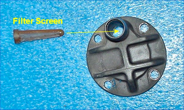

One addition that I should have had in the last post was in regards to the car farting and carrying on up the straight at Calder. It was the simplest problem to fix, but an easy oversight.
Clean the filter in the fuel pump. Duh.

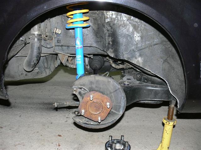

Another of my oversights in this journal is the diff. As mentioned earlier, we have an R200 4.3 LSD in the rear from a Z31, which runs CV joints. I made up some adaptor plates out of M200 tool steel that I had laying on my bench at work. I thought that it would be ok to use, was I wrong.

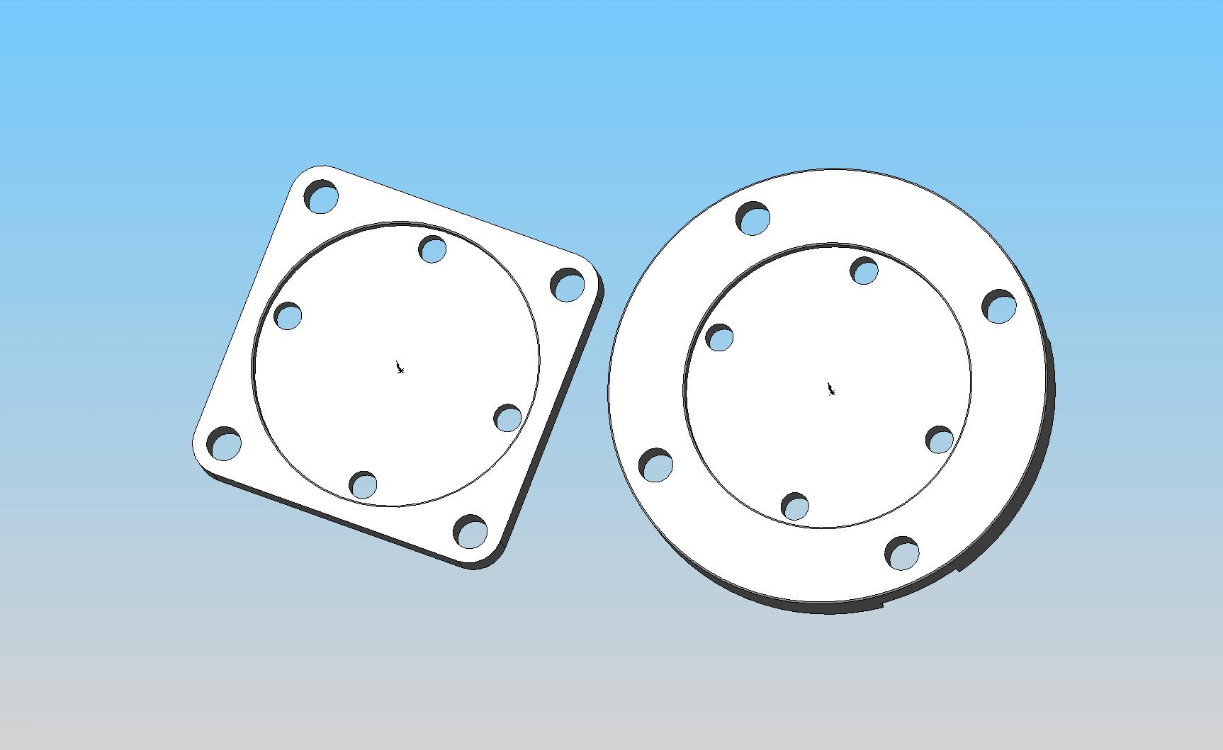

The reason the Z stopped was due to the passenger side CV adaptor shearing the bolts. End of the day for yet another mechanical failure, only this time I had to take responsibility. Luckily for us, we took the car down on a trailer.
So it was now time for CV adaptor mkII. My best mate works at Hollinger and turned me up a couple of blanks out of EN36A. I then milled them to make the strongest CV plates in the world. Now its not relying on the bolts for clamping pressure, they just hold it on. The hub is now fully recessed into the adaptor. If this breaks I will eat my hat!

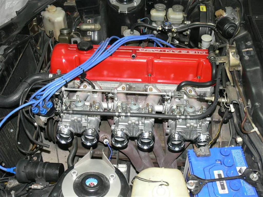

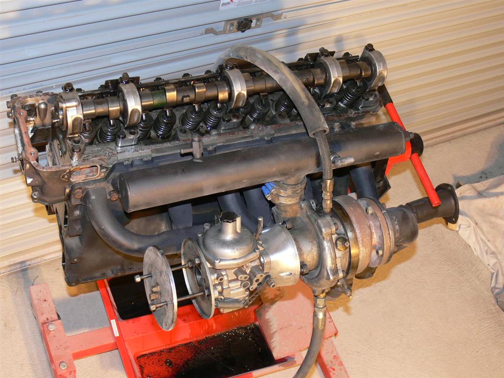

Last night I spent some time out in the garage changing the choke size on the Mikuni's, going from Φ32 to Φ36.
Its not as simple as boring out your current chokes. Apparentley there is some science to this car tech stuff. There is a radius, land and multi step taper to copy, exact.
To do this, I went over to see Lou Mondello who loaned me a smashed up Φ36 choke for me to copy (without the smashe up part  :P). I then modelled it up on Solidworks (PM me if you want the file) and machined the internal details on the CNC mill using high speed machining principals, small cuts, high speed. Then cut the external diameter on the wire cutter.
Fitting proved to be not as simple as I had hoped. One would say that there more than one type of PHH Mikuni design. The one supplied was slightly different, being that the slot to go around the accelerator pump was different and not directly opposite the location spot.
Meaning to fit them I had to mark the screwjack/retaining screw point and drill a point by hand with a pistol drill. Hairy, going slightly too deep would see the choke being binned. Once this was done, it was a matter of putting it all back together.
The best part was that it started and ran at the end.
Will test drive it tomorrow, hopefully.
Pics show a diect comparison of Φ32 and C36 chokes fitted.

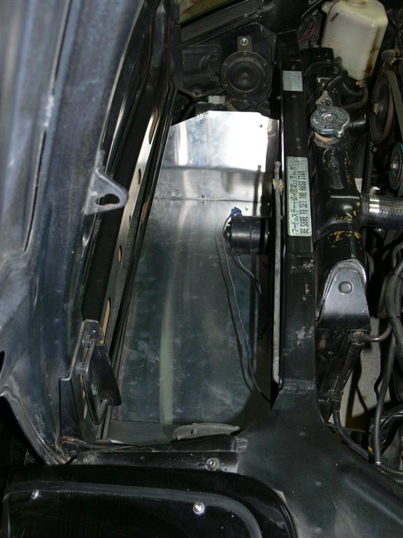

Also worked on air flow through the radiator last night.
$12 worth of Aluminium, a jigsaw, pop rivets and self tapping screws.
Mind you this was done until 1am, apparentley noise travels further at night and I was in the dog house for being noisy. But thats the way it goes, when you want the car to be cooler!
Test tomorrow  :)

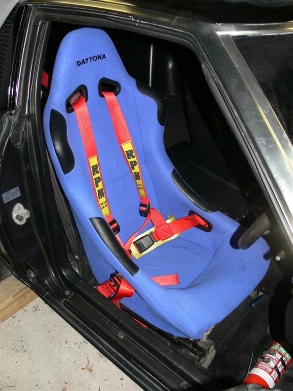

Here's some random shots of work missed from the forum.
Seat, harness and oil catch can.
The seat needed to be on rails so that my wife could drive it, if she wanted. I'm 6'5, shes 5'1. So I got a spare set of rails from the wreckes and modified them so that I could sit low enough while wearing a helmet and put it as far back on the rails as I could. And guess what, even then my wife can't reach the pedals when all the way forwards, classic.
The oil catch can is just a copy of something I saw on the internet, coz I don't have much of an imagination. Its 3mm aluminium that sits behind the passenger front wheel on the footwell/firewall. It was needed after taking the factory EFI off and fitting triples. I cut and folded it up, then gave it to my mate who said he'd love to learn how to use the tig welder at his work. Once I finished teasing his crappy welds, I tested how much it would hold. Do you think that 4L will be enough? :o Looks and works good enough to me.
