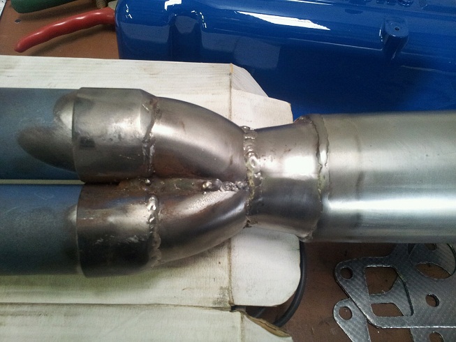

Riceburner Posted March 26, 2012 Posted March 26, 2012 They are the same as the 'SW Motorsport' item's... IMO These pipes seem to have a lot better finish, single piece instead of two piece with a flange and these are 'firing order'..... Enough about Simon's pipes, seems a lot of people have been looking at them Should be a beast! Whats the theory behind the megaphone and how do you work out what length is required? Quote

luvemfast Posted March 26, 2012 Author Posted March 26, 2012 Whats the theory behind the megaphone and how do you work out what length is required? That's a very good question. I've been doing some reading and about 7-9 degrees is what's recommended. Works out to be 3.2" to 4.1" long. Yet Peter has done some dyno work and found shorter length works better. Or was he just saying he found that his short length, did the job? What were we talking about again? Quote
Riceburner Posted March 26, 2012 Posted March 26, 2012 You made the sticker yet? NISSAN BIG OHC. That would be cool. Lol. So does it reduce in size or expand... would you use it to step up from the 2.5" secondaries to a 3" system? Quote
peter mc Posted March 26, 2012 Posted March 26, 2012 i found that it helps the mid range if you reduce the pipe at the merge colecter down to 2.1/4 and then rip it up to 3in as fast as i can , 40mm or so i will take a pic tomorrow so you can see it Quote

zedevan Posted March 26, 2012 Posted March 26, 2012 They are the same as the 'SW Motorsport' item's... Are you sure? They are a 2 piece system from memory aren't the SW motorsport ones 6:2:1 or 6:1? these look like 6:3:1's, which I have a damaged pair of sitting here, so i need to either get them fixed or would love to grab a pair of these if he's able to make more as you're asking Quote
peter mc Posted March 26, 2012 Posted March 26, 2012 yep there very different pipes , the pipe SW makes is 6/2/1 , so these pipes might be very different in the tune Simon i think you best ask peter hall what they like , he is a very nice bloke give him a call Quote

luvemfast Posted March 27, 2012 Author Posted March 27, 2012 Forget the link I posted earlier about the expansion chamber. That's a different technology........ And a bit of a black art. Bu still, interesting stuff non the less. I called Peter Hall and had a chat today. This exhaust was a bit of a prototype, too large for the Tarmac rally engine it was bolted to. The principle of the firing order is stolen from the saloon racers. Apparently they swear by them. But for me, it's a case of suck it and see. I currently have the intake and exhaust off the car. And you guessed it........ There is a problem. These headers were made for the longer Cannon or Redline manifolds. My TWM fouls in a few spots. So I need to remove some material. No biggy but I adds to time off the road and I'm getting antsy. Oh. And I've ordered my K & N cone air filter today too. So getting everyhing sorted Quote
peter mc Posted March 27, 2012 Posted March 27, 2012 hi simon this is what i do for the pipes to fix the 3500 torque dip ... this ones my dyno pipe so its a bit ruff ,i built 4 difrent pipes to find the fix Quote

peter mc Posted March 29, 2012 Posted March 29, 2012 Simon you need to run a magnaflo rear muffler to make it work or it will be very loud. , give me a call i will talk you thro it , the 3in is 12hp on your motor over a 2.5 in Quote
