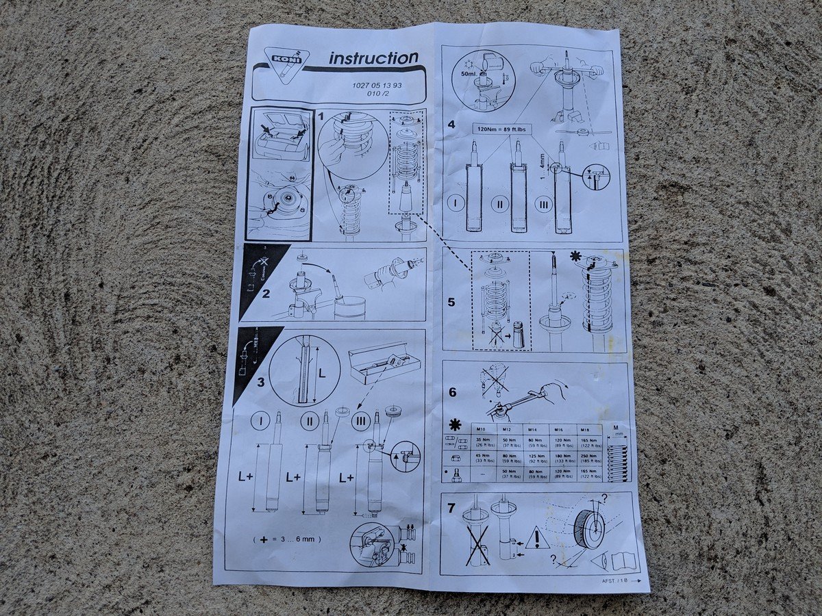

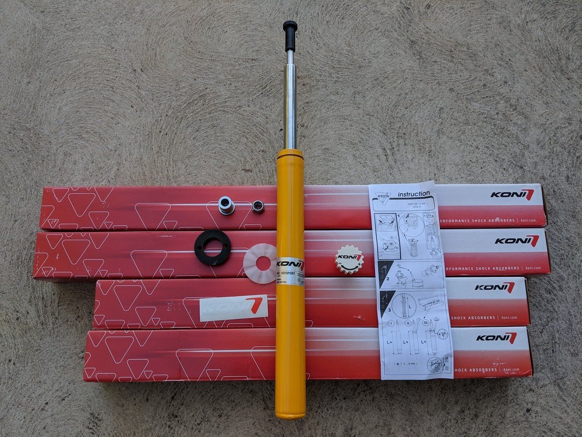

Cozza Posted March 12, 2019 Posted March 12, 2019 Thanks for the pics George, nice to see some more parts arriving. those instructions are clear as mud, you should have no problems. Haha! Quote
