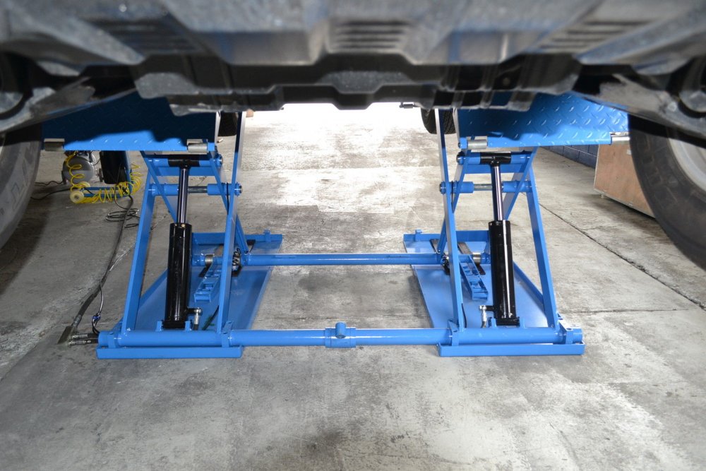

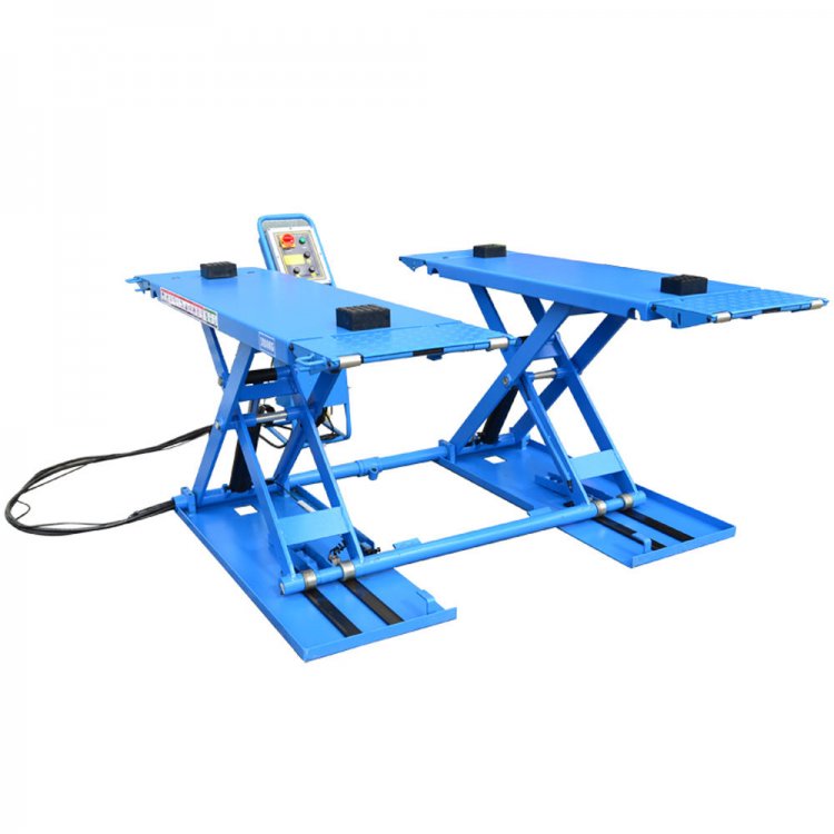

Administrators gav240z Posted September 6, 2017 Administrators Posted September 6, 2017 Anyone using 1 of these or have feedback on them? http://www.ebay.com.au/itm/Portable-Mid-Rise-Scissor-Car-Hoist-Vehicle-Scissor-Lift-Tyre-Shop-Home-Hoist-/122536242054?hash=item1c87baab86:g:iRgAAOSw7FRWVBVy Reason I'm looking at them is limited head height in garage and currently renting my place so need something that can easily be removed later. Thoughts? Quote
aircobra Posted September 6, 2017 Posted September 6, 2017 doesnt look that stable to me. the garage lifts are much more widely spaced. what are you gaining over 4 stands? Quote
600Z Posted September 6, 2017 Posted September 6, 2017 Hi Gav, I have one of the four post hoists the same as in the link below. It's easy enough to jack the car up while on it if you want to take the wheels off or do suspension work and much more stable and if you have the height at least you can stand under the car to work on it. No need to bolt down like a two post and comes with wheels if you want to move it around. I'd just work out what your wanting it to do and wether it would get in the way for some of the work your planning on doing. I also use mine for storage to get one of the cars up out of the way. It was $3000 delivered to my door in Tassie. Cheers, Justin https://www.ebay.com.au/itm/132312709213 Quote
nizm0zed Posted September 6, 2017 Posted September 6, 2017 Its expensive for what it is.Having said that, it'll work for what you want, but doing anything between the ramps is an absolute PITAIt looks stable enough to hold a zed or other mid size car.I havent used that exact one, but we had very similar at the tyre shop I worked at years ago.They get very dirty underneath because they can be hard to clean around.I have the same headroom problem in my shed and I did consider something like this but ultimately decided that it wouldnt be useful enough to me to justify the cost or space required.It helps that I own my house though so I could look at a proper hoist as one of my options. These do have the advantage of a very low floor profile so its supidly easy to get really low cars on them, that'll help with resale laterAircobra, this goes higher than axle stands, does it quicker and more conveniently and is a bit more stable. Thats about its only advantages though.Your still going to be lying on the ground for any work underneath it, but at least with stands you can still do gearbox/driveline work. PeterAllen 1 Quote

EJ101 Posted September 7, 2017 Posted September 7, 2017 Anyone using 1 of these or have feedback on them? http://www.ebay.com.au/itm/Portable-Mid-Rise-Scissor-Car-Hoist-Vehicle-Scissor-Lift-Tyre-Shop-Home-Hoist-/122536242054?hash=item1c87baab86:g:iRgAAOSw7FRWVBVy Reason I'm looking at them is limited head height in garage and currently renting my place so need something that can easily be removed later. Thoughts? My only concern would be the locking. How does the magnetic lock work or does it. That's why i'd want to see one in the flesh. I'd get nervous buying stuff like this on ebay. Quote
nizm0zed Posted September 8, 2017 Posted September 8, 2017 My only concern would be the locking. How does the magnetic lock work or does it. That's why i'd want to see one in the flesh. I'd get nervous buying stuff like this on ebay. Im fairly certain from looking at it, it requires (electrical or mechanical) input to release the lock, but the locks are always engaged, or about to engage in one of its lock positions when its lifted, regardless of whether it has power or not. At least thats a sensible approach to engineering a saftey system, but like you say, ebay can be hit and miss sometimes Quote

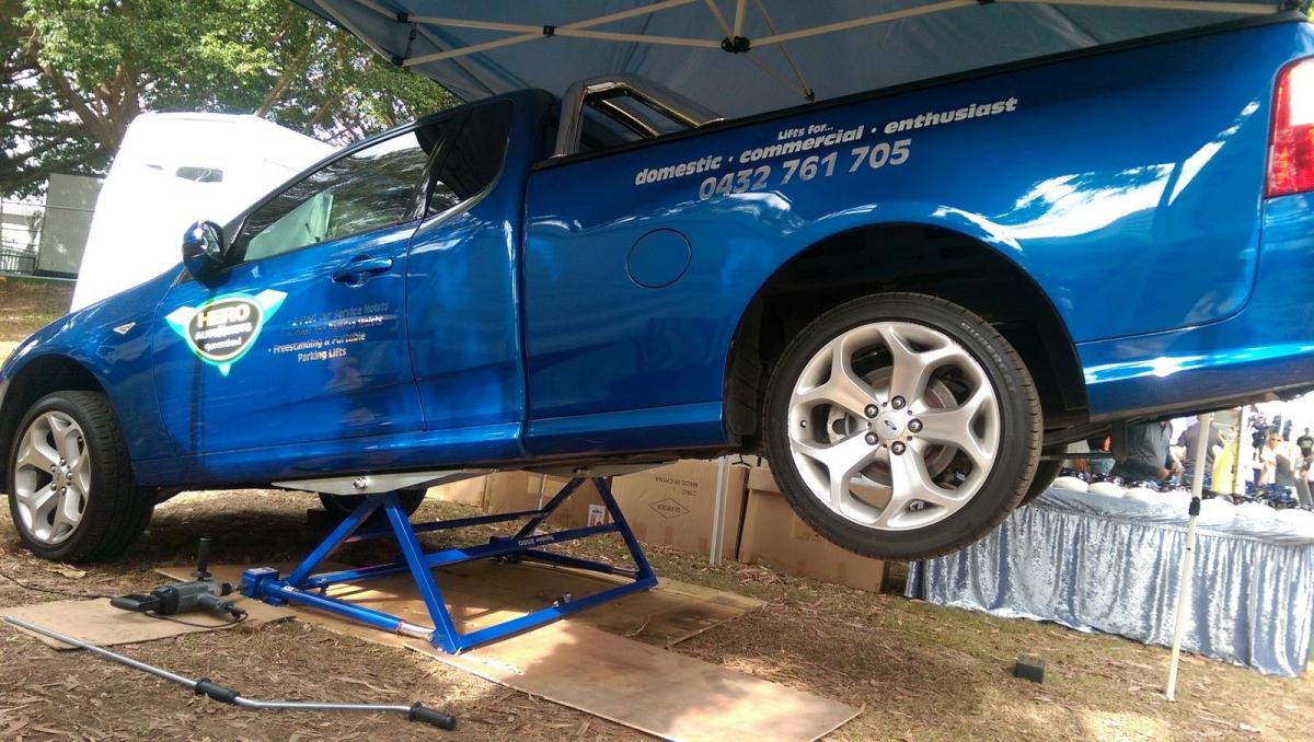

24 Dat Posted September 10, 2017 Posted September 10, 2017 Just saw this on ebay http://www.ebay.com.au/itm/Portable-Mini-Scissor-Lift-Spider-2500-self-powered-car-hoist/162028850887?_trkparms=aid%3D777001%26algo%3DDISCO.FEED%26ao%3D1%26asc%3D20160801204525%26meid%3D06bb56f1dc5741a6b1edf9fe8698c765%26pid%3D100651%26rk%3D1%26rkt%3D1%26&_trksid=p2481888.c100651.m4497&_trkparms=pageci%253Adcb2ba1a-9675-11e7-a578-74dbd18055bc%257Cparentrq%253A6ddea5ba15e0aa12a9440c6bfffd8e67%257Ciid%253A1 Quote
Agno Posted September 11, 2017 Posted September 11, 2017 If I was getting under that ute I would want something in place as a secondary safety measure to ensure the rear end doesn't pivot onto my head if the car shifts rearward for whatever reason. OdinZ 1 Quote
