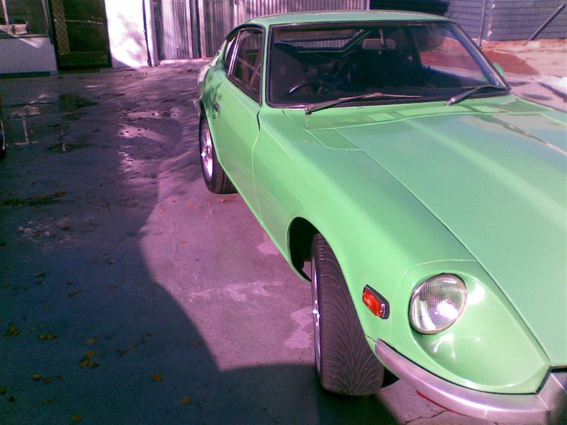

620Z Posted May 5, 2010 Posted May 5, 2010 Great work Scoota. I think only a person who has gone through this work can appreciate how much time and effort goes into it. At least you will be pretty confident when you say it's one of the few rust free Zeds on the road. And that is always good to know when the car is sitting in the garage knowing that it is not rusting away in there. Ha. Quote

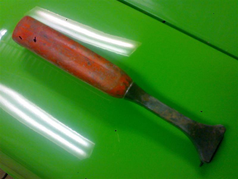

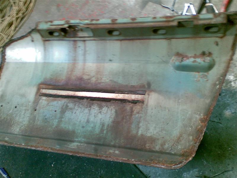

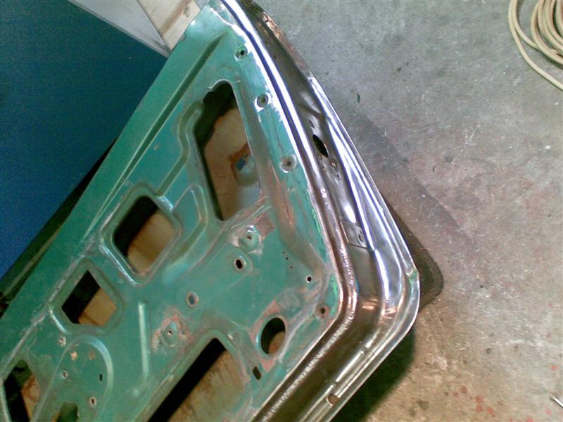

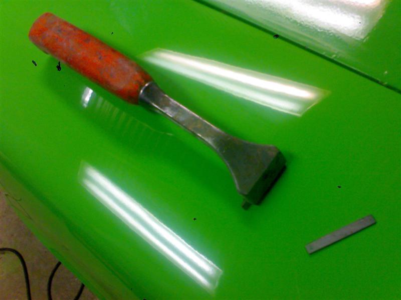

Scoota G Posted May 11, 2010 Author Posted May 11, 2010 Well i had a lazy weekend, this type of work certainly takes it out of you. Anyways i'm happy with the progress so far.... here's a couple of pictures of that scraper Quote

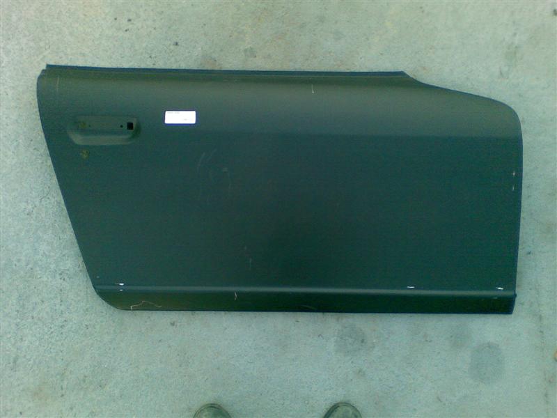

Scoota G Posted May 19, 2010 Author Posted May 19, 2010 Again social factors got in the road but i was really wanting to work down one side of the car at the time. This one came today and the other on is due next week as they were out of stock. Quote

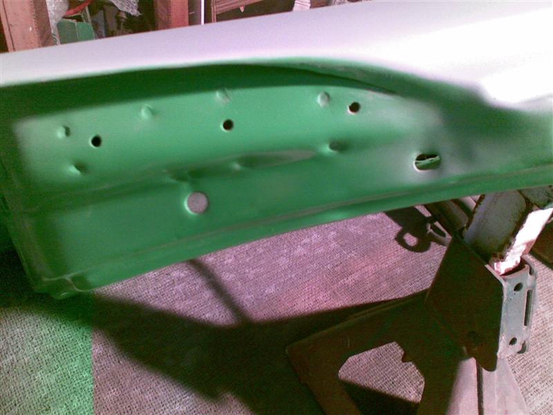

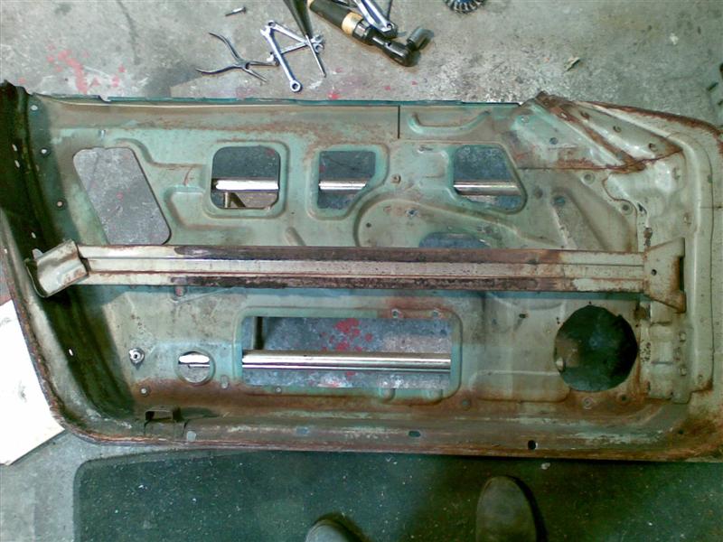

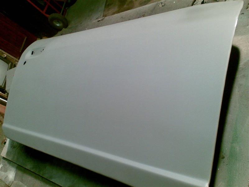

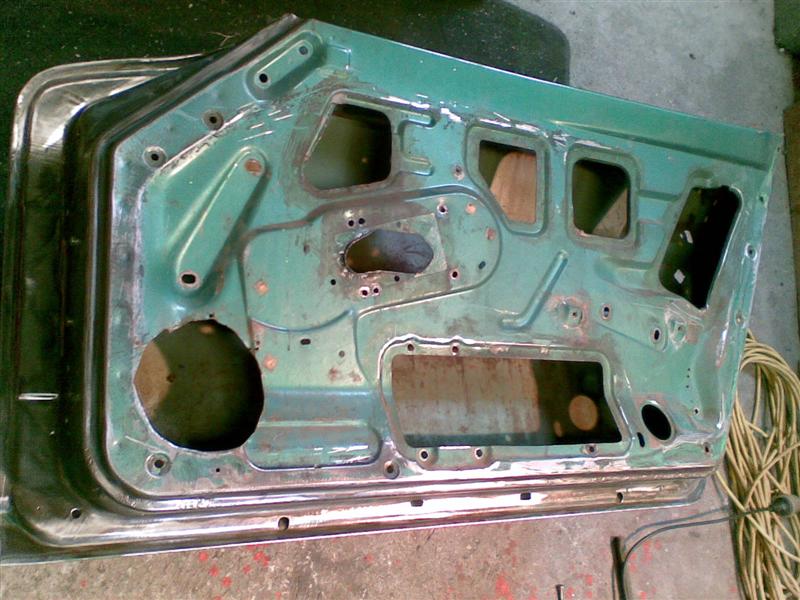

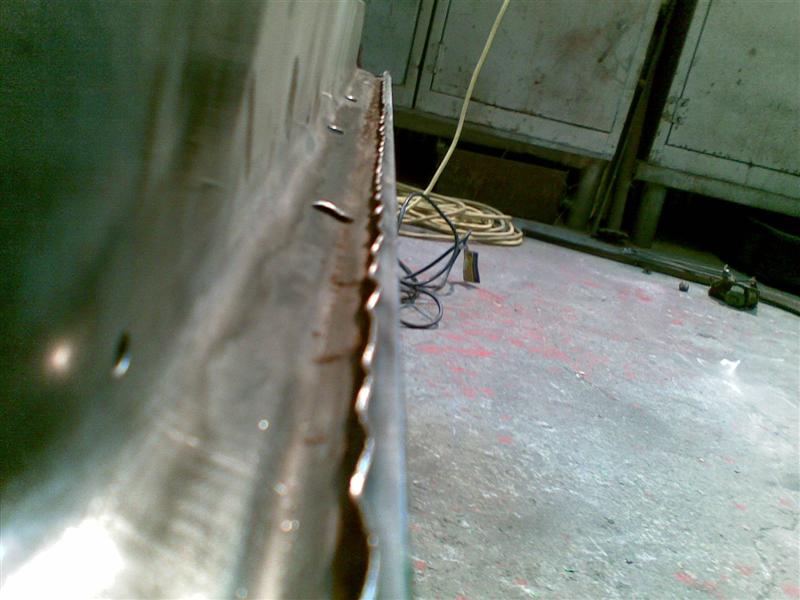

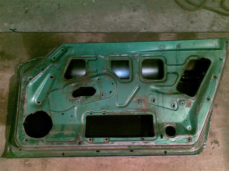

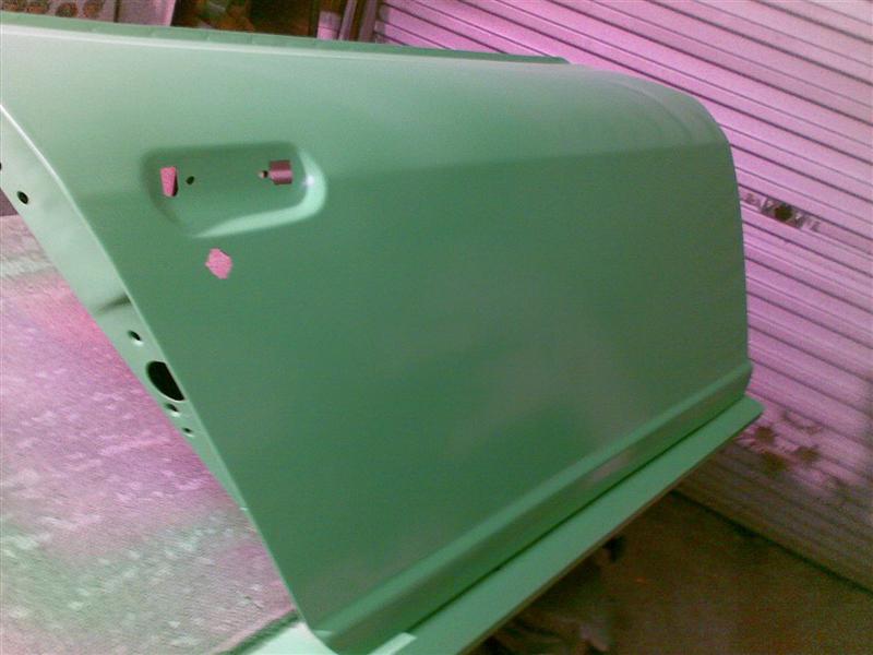

Scoota G Posted May 24, 2010 Author Posted May 24, 2010 I'll get back on topic now, taking a week or so off and stripping the door skins. I'm using lurch's guide to removal thread and it's working brillantly. From the looks of it so far the new Rare Spares skin is a very good fit. Quote

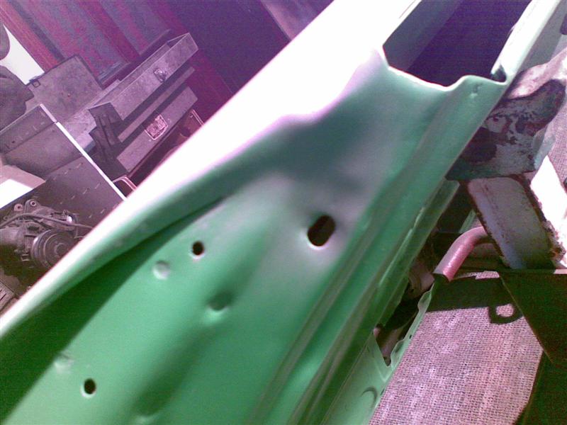

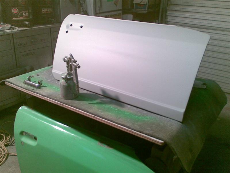

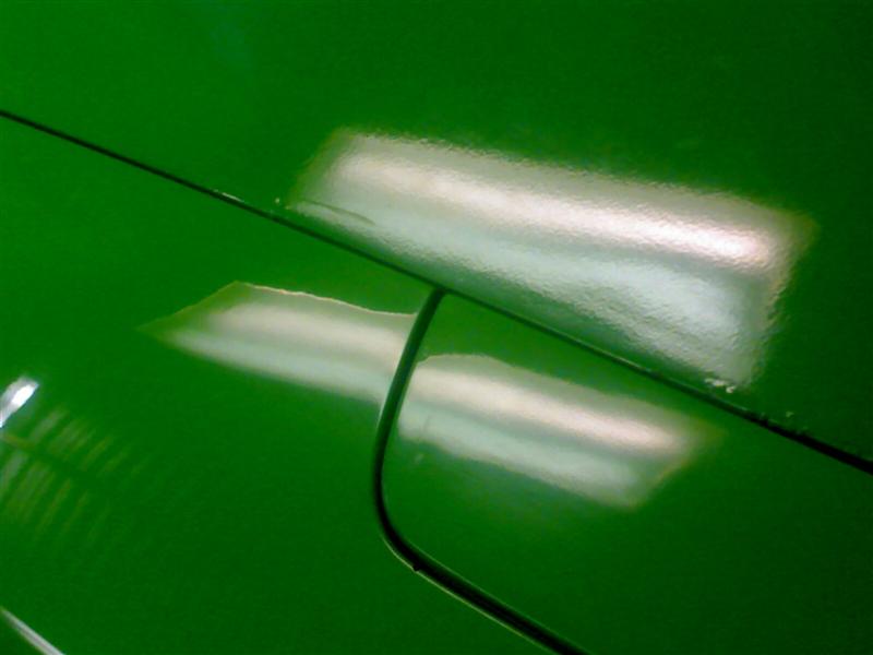

Scoota G Posted May 24, 2010 Author Posted May 24, 2010 Another picture... a bit Bored waiting for the paint to dry. Quote
C.A.R. Posted May 24, 2010 Posted May 24, 2010 Good stuff Mark. So no issues with the fitment or the skins themselves? Quote

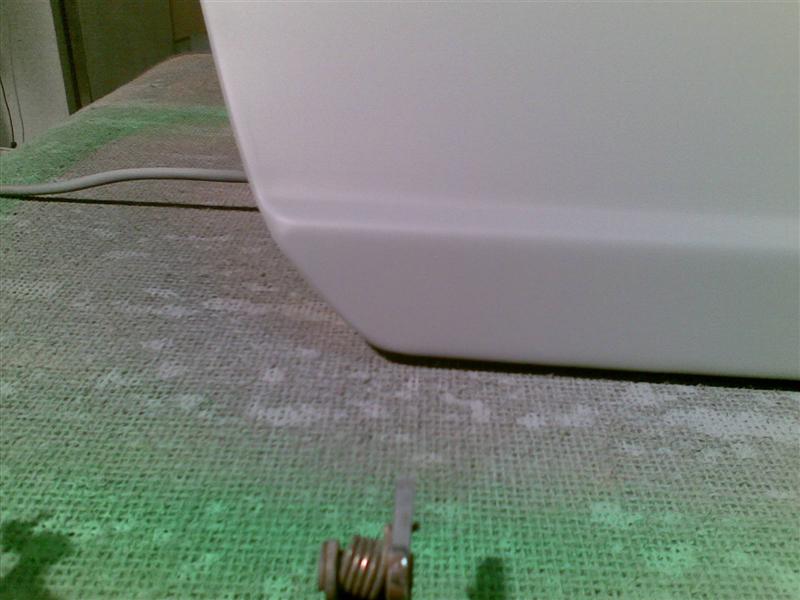

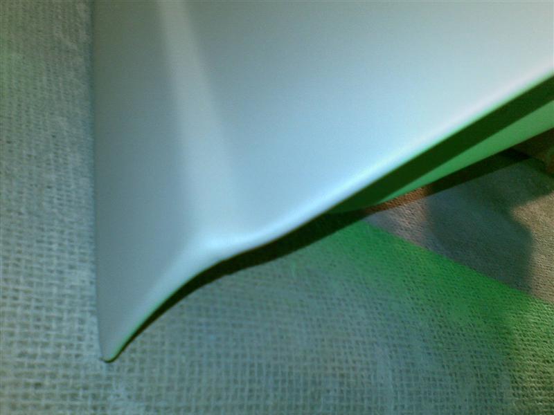

Scoota G Posted May 24, 2010 Author Posted May 24, 2010 The skins are great but just a little problem with the radius on the bottom rear not folding over quite right. Worst problem is now my Interior light is stuck on :o. Made the removal tool and it worked awesome, epoxy on the inside too. I'll slice a tiny bit out of the radius lip and get it sitting right. Quote

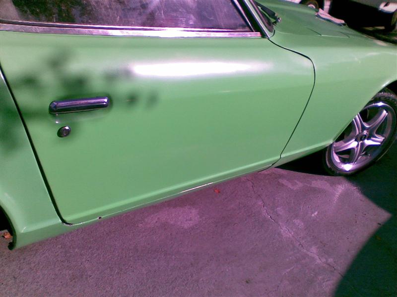

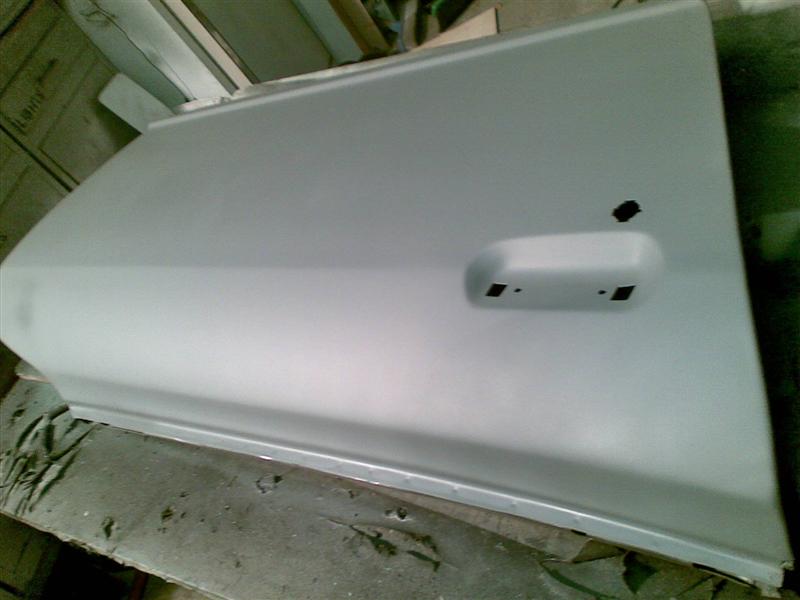

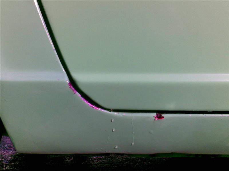

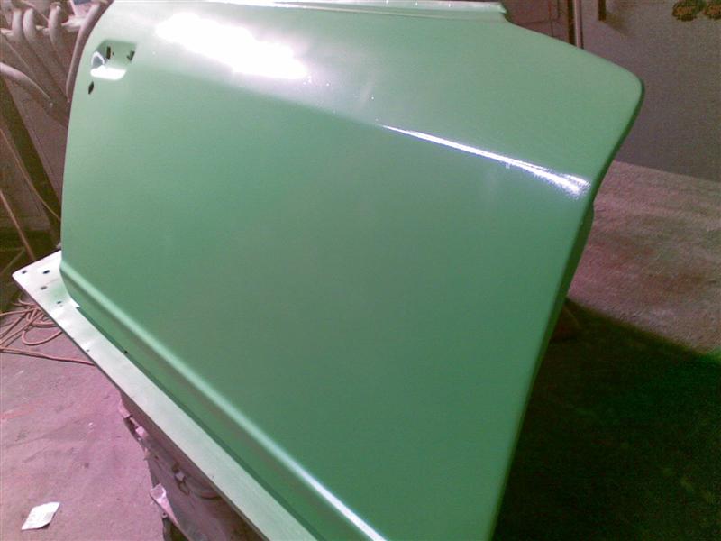

Scoota G Posted May 25, 2010 Author Posted May 25, 2010 And some color. I'll pop it back on tomorrow and then a wet rub and another 3 coats. Quote

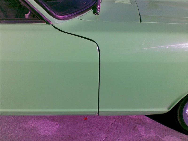

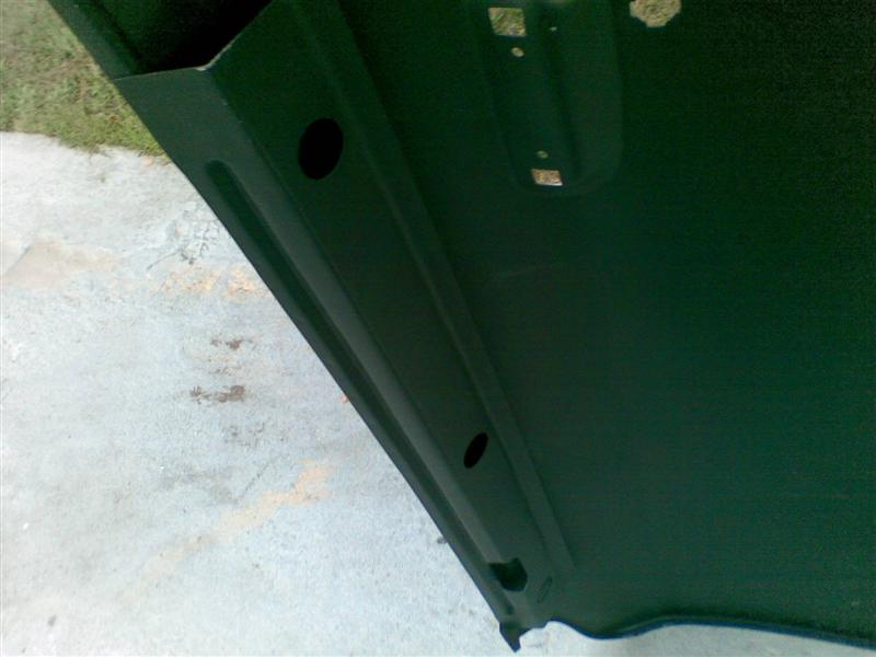

Scoota G Posted May 26, 2010 Author Posted May 26, 2010 Fitted the door today, there is a issue that when you wind up the window it fouls on the inside top support for the skin. Best to bend this out of the road before fitting. Quote
620Z Posted May 26, 2010 Posted May 26, 2010 I think all Zeds have this window problem Mark. Shame I didn't do it when we threw a brand new window into my door. Now the scratch's have started to appear again. Managed to get another new window a year or so ago. I might have to fit it one day and of course bend the rubbing metal peice away. All looking good there mate. We might have to do another Grampians drive or something once you are finished. Quote
