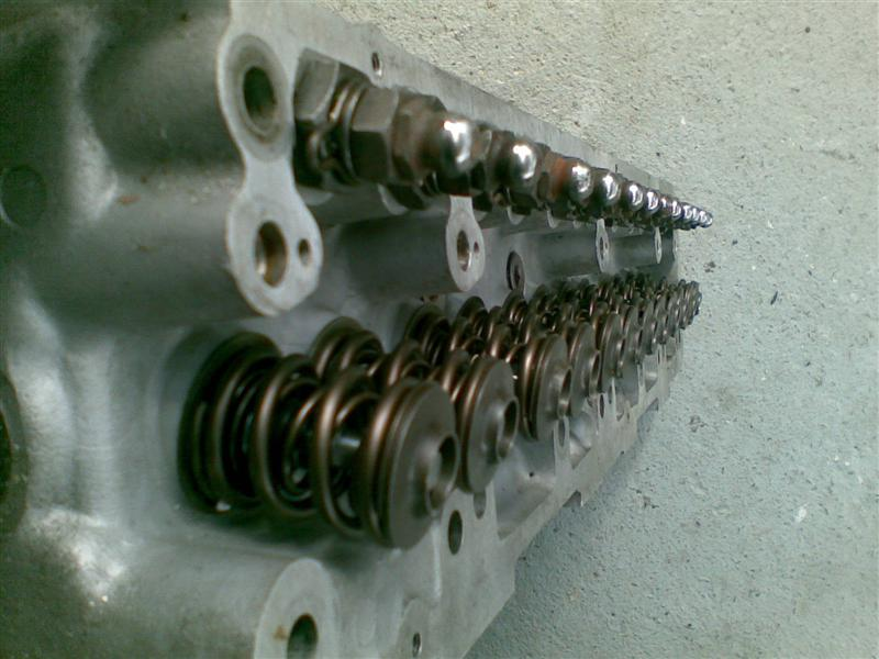

Scoota G Posted August 24, 2010 Author Posted August 24, 2010 This has the details of the head mods. http://www.viczcar.com/forum/index.php/topic,6905.0.html As for the compression ratio, it was bolted to a L28 with flat tops so on an L26 with dished i expect it to be streetable. I just want a little more than i have (ever heard that before). Quote
Scoota G Posted August 27, 2010 Author Posted August 27, 2010 All assembled now and i ordered camtower shims From Stewart Wilkins, i think it will just sit there now until i rework the engine bay although i can just feel i'll get tempted one of these weekends. I also think one of those twin idler gear http://www.kameariusa.com/L6_Twin_Idler_Gear.php would be a good addition. I found one on another site $200 cheaper. But for now i think i'll go buy some more paint and reskin the Passenger side door as the weather is starting to improve. Quote

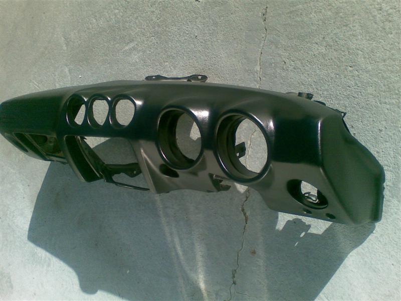

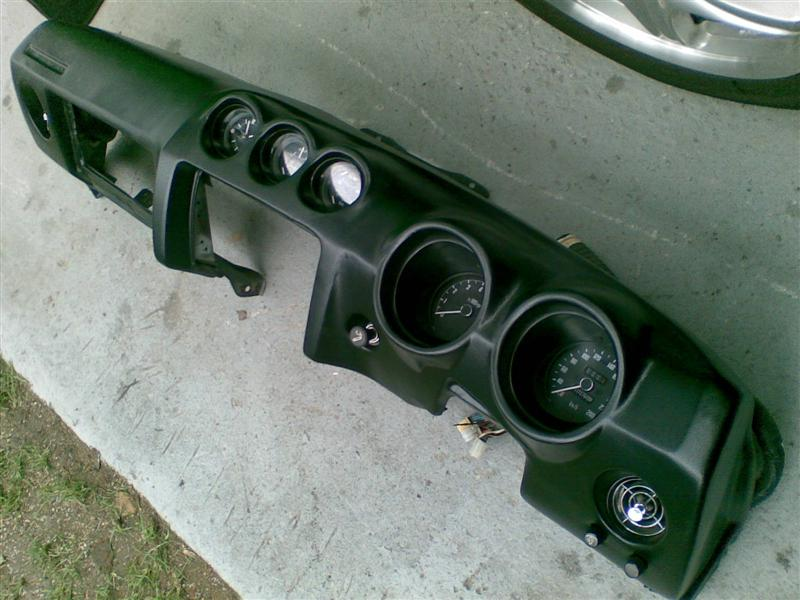

Scoota G Posted August 30, 2010 Author Posted August 30, 2010 Well after an Awsome weekend Helping rob (fuzzydropbear) out with his project and a Full On trip down to Phillip Island the car needed a bit of a wash. Also the pile of parts that need to be fitted grows ever larger with a Dash that i picked up off Peter when down at Phillip Island (with a working clock) and a set of camshaft tower shims that completes the list of everything that i need to install the cylinder head. Happy Days indeed. I swear everytime i walk even close to my car with a Parcel it's almost as if the front changes from it's current look to something that says "For Mee" Quote
luvemfast Posted August 30, 2010 Posted August 30, 2010 Oh that dash sure is purty What size shims are they? Why are you using them? Quote
Scoota G Posted August 30, 2010 Author Posted August 30, 2010 The shims are 1mm and i'm using them because the new Cylinder Head is shaved, i think the dash is awful nice too. We'll see tomorrow. Quote

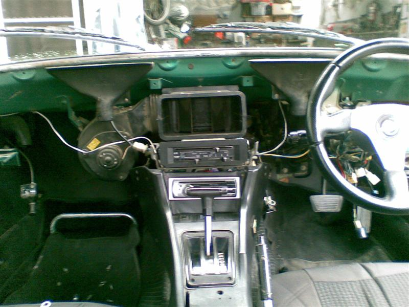

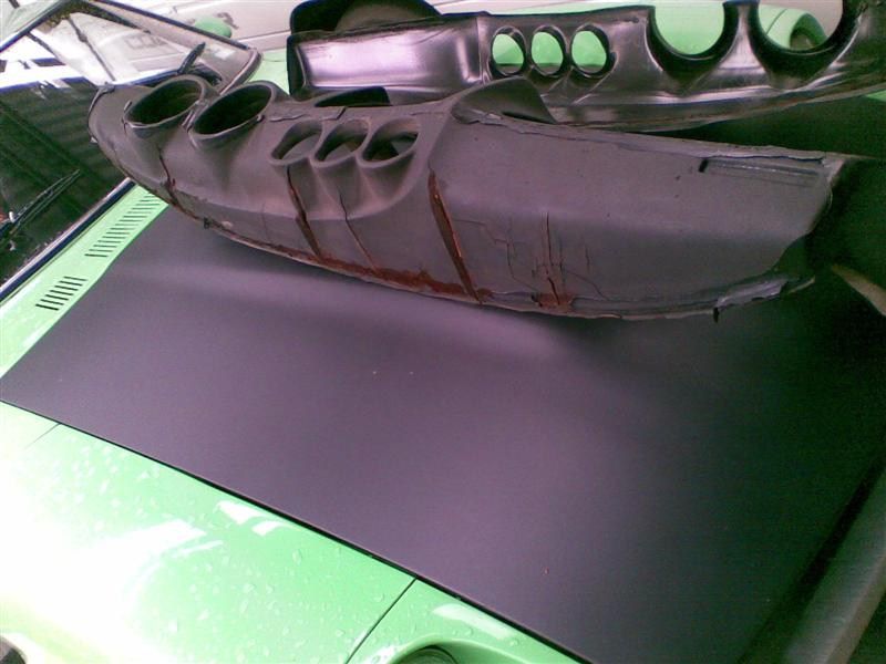

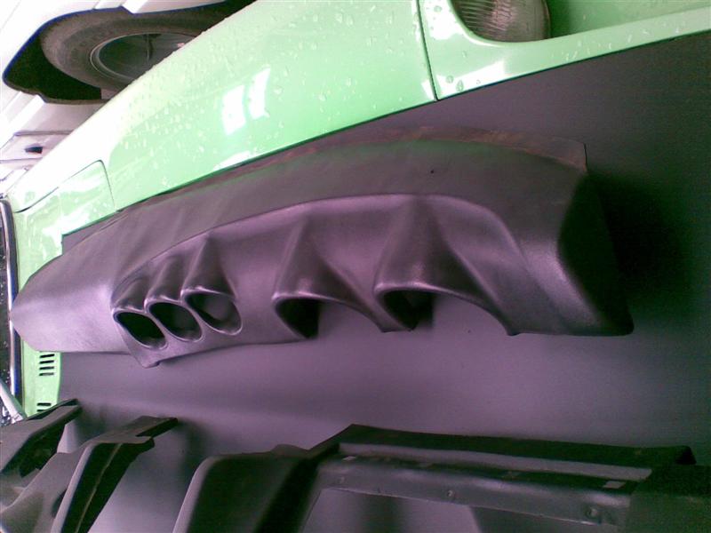

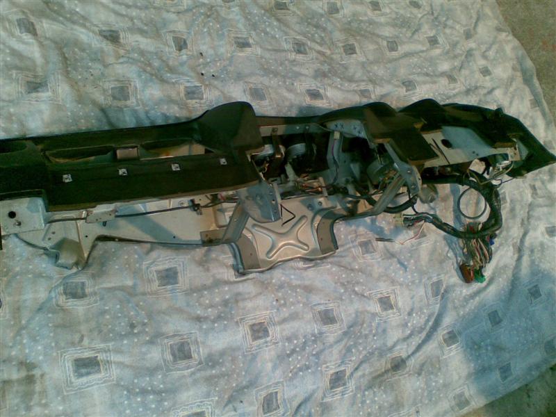

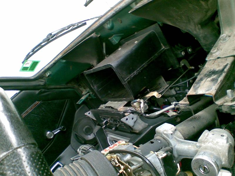

Scoota G Posted September 1, 2010 Author Posted September 1, 2010 Due to the rain i've been working on Oscar this week. The dash has been removed and then i removed the dash cap. I think the photos speak for themselves Quote

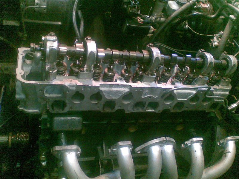

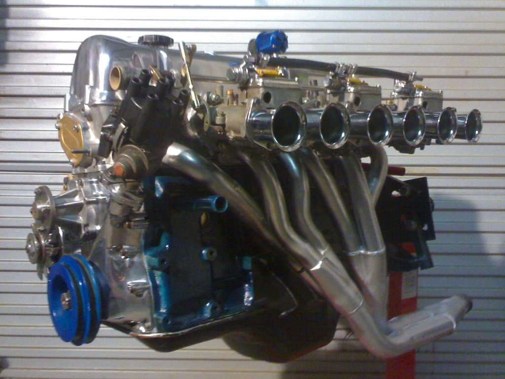

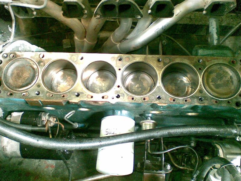

Scoota G Posted September 1, 2010 Author Posted September 1, 2010 ... I just can't help but post a photo of the L26 every now and then Quote
GV260 Posted September 1, 2010 Posted September 1, 2010 So what are the spec's of the L26 and have you had it on a dyno? Quote
Scoota G Posted September 1, 2010 Author Posted September 1, 2010 So what are the spec's of the L26 and have you had it on a dyno? Cold air intake, 2" Ramtubes, 45mm Dellortos, Kameri Manifold, Stainless steel valves, Shaved, Cc'd, ported N42 head, Crow cam and Valve springs, ARP head bolts, 280ZX Electronic ignition, Full balance, Chrome rings, 40 thou overbore, Hypertec pistons, Modified crank, Genie headers, Apart from that theres the 140 amp alternator, Aluminium radiator! No dyno session yet and i still have to fit the cylinder head. Quote

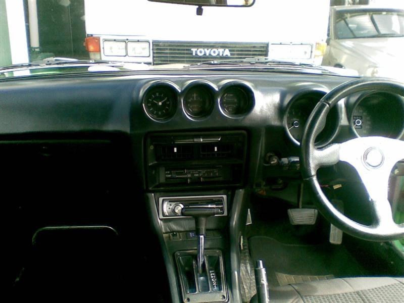

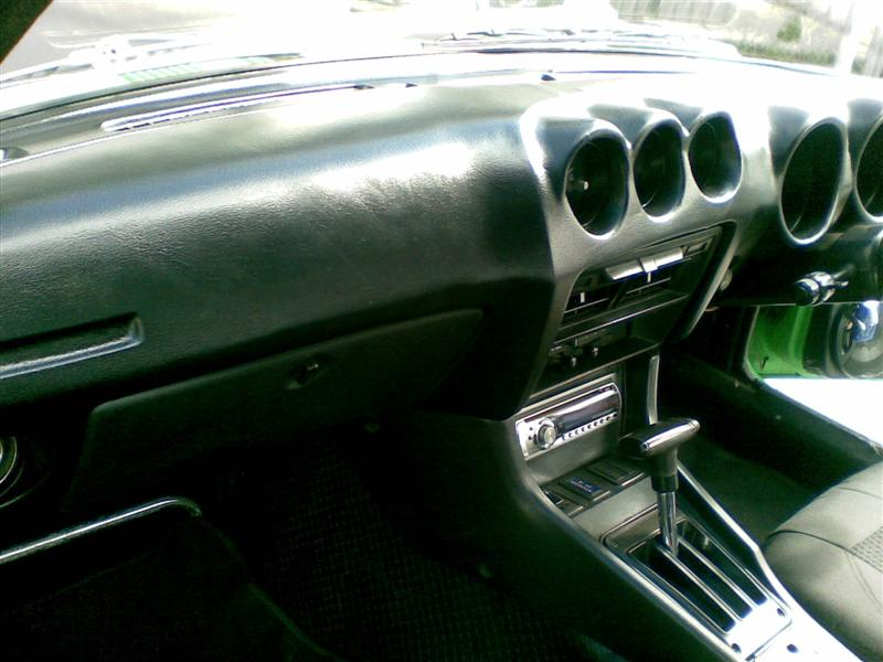

peter mc Posted September 1, 2010 Posted September 1, 2010 did the dash clean up ok for you mate Quote
Scoota G Posted September 1, 2010 Author Posted September 1, 2010 did the dash clean up ok for you mate Yep, the dash was actually grey as i suspected so i repainted it and it looks perfect, thanks again peter. Only weird thing is that working clock...after 13 years it's a bit hard to get used to. Quote

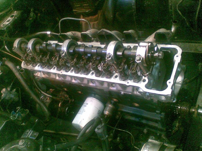

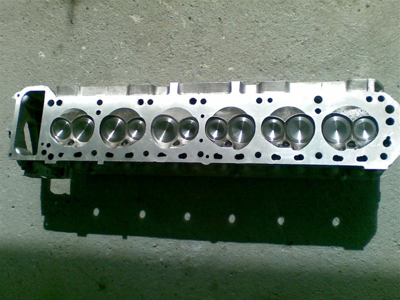

Scoota G Posted September 11, 2010 Author Posted September 11, 2010 I've put the new Cylinder Head on today (3 months to get all the bits) and it was very much a straight forward operation. This one is shaved with stainless steel valves, cam towers have been shimmed which set the pad wipe up perfect. Sounds SaaaWeeet but i'll wait for tomorrow for a run... i do remember saying that i was finished under the bonnet, i suppose one day that will be true :-\ Quote
