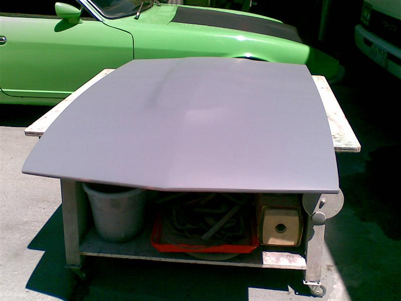

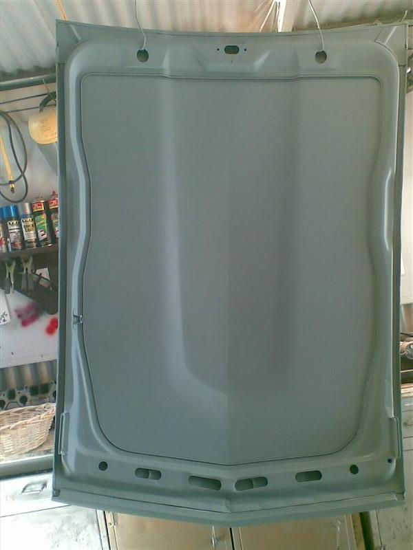

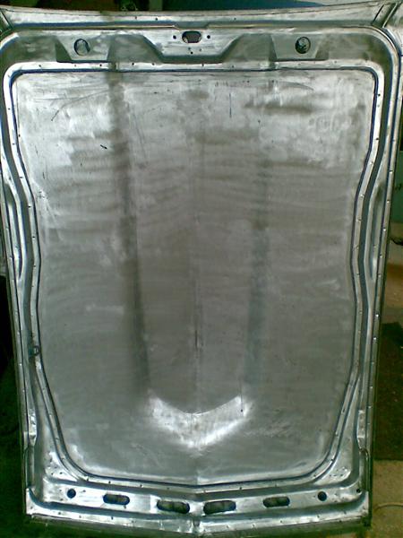

Scoota G Posted November 18, 2010 Author Posted November 18, 2010 The inside of the bonnet has been stripped chemically then hit with a wire brush. Quote

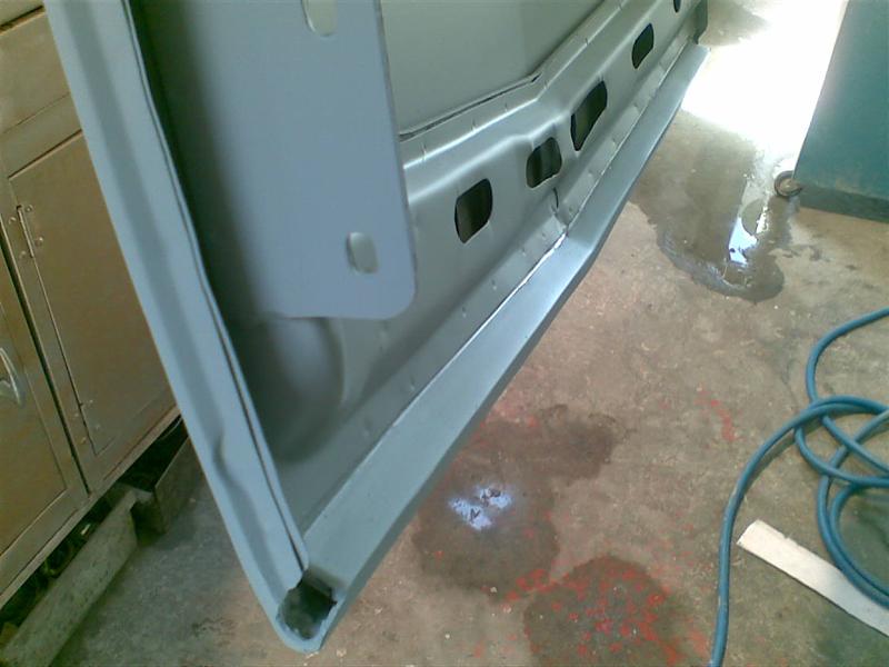

Scoota G Posted November 20, 2010 Author Posted November 20, 2010 Prime and paint, i always hated the lip on the bonnet so i deleted it. Quote

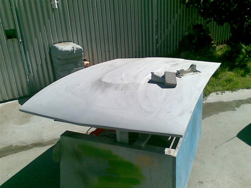

RB30X Posted November 20, 2010 Posted November 20, 2010 Make sure you use a long block and work front to back when sanding that bad boy, you never see them until it's painted. Are you going green? Quote
Scoota G Posted November 20, 2010 Author Posted November 20, 2010 Make sure you use a long block and work front to back when sanding that bad boy, you never see them until it's painted. Are you going green? Yea well you're right on with that as the Black has grown on me, so it'll have to be super straight. Midnight Black Gloss is the new colour. Quote

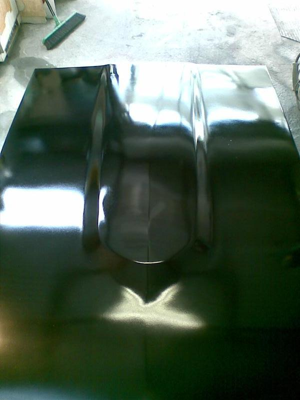

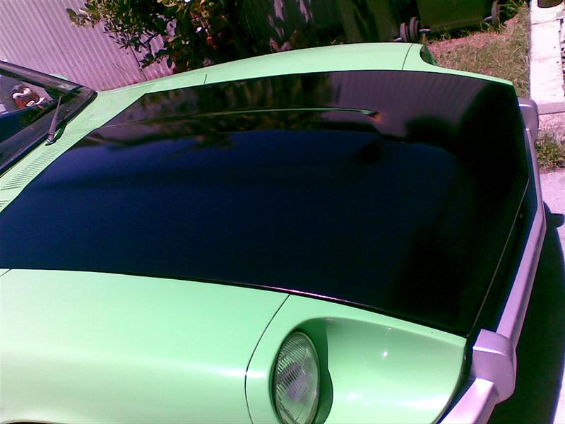

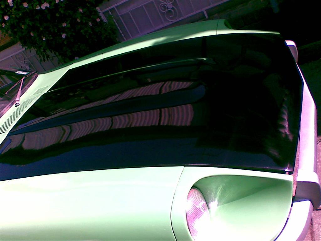

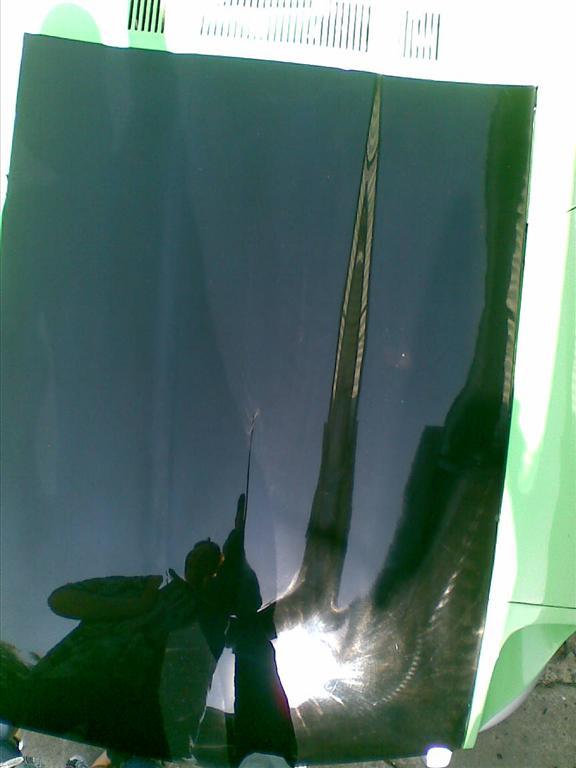

Scoota G Posted November 21, 2010 Author Posted November 21, 2010 Needs to cure then a color sand and buff. Looks muchly better than the old one. Quote
Scoota G Posted November 21, 2010 Author Posted November 21, 2010 Looking good Mark. Thanks buddy, considering the state of the bonnet it's come up not too bad at all. It's good to get another panel done as it's been a while, one step closer. Quote

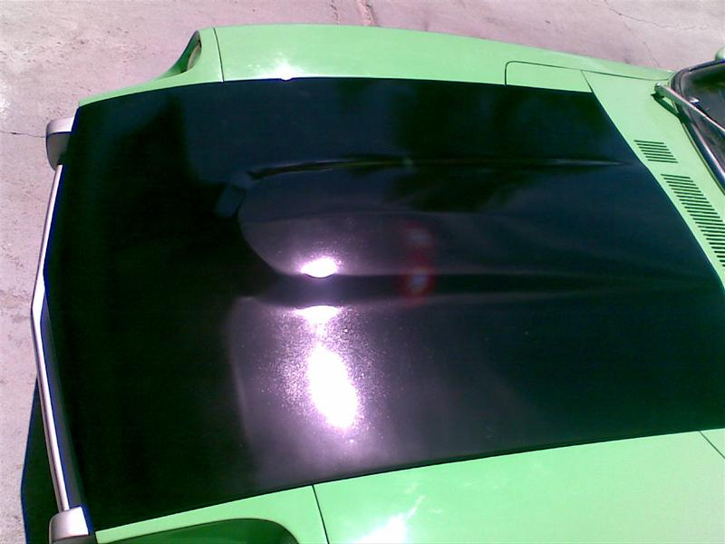

Scoota G Posted November 21, 2010 Author Posted November 21, 2010 Dang i'm impatient sometimes. Quote
Riceburner Posted November 21, 2010 Posted November 21, 2010 Nice job Scoota, jeez you work fast! Quote

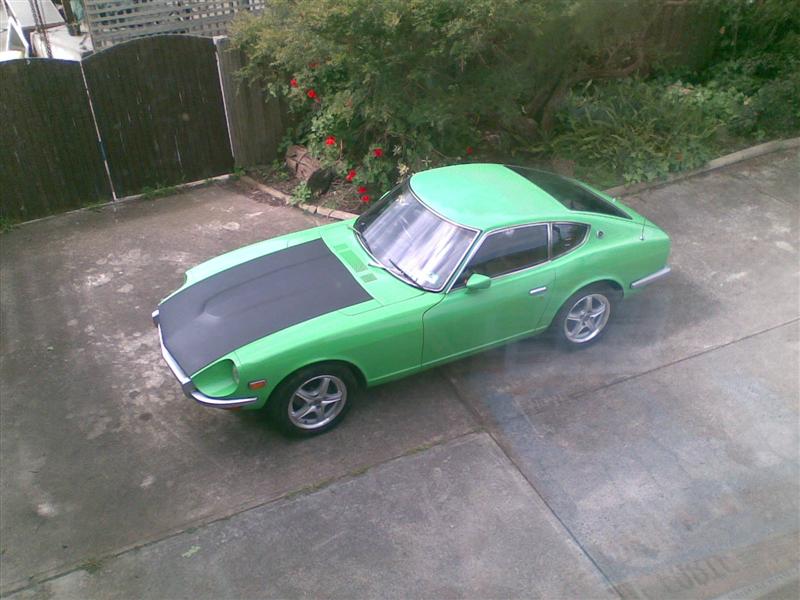

Scoota G Posted November 21, 2010 Author Posted November 21, 2010 The bonnet was supposed to be last but hey, i'm hoping that these pictures will get Dale revved up and we can get some Hue on his Orange Beast. I wanted to be a spraypainter when i was 17 but the only thing they had going was welding. I've only ever had one lesson and that was the rust repair day. Next episode will be the Passenger side door which i might ask dale if i can lend his parts car door so i can streach the prep out over the week and paint on the weekend. Then the tailgate gets done and i'll strip every panel off the car and do the quarters and roof in the one week, after that i'll throw the car back together and do a finishing coat with the car assembled. Looking to complete the car around April (the best laid plans of mice and men) but the under body detail and new interior may have to wait. Quote
FuzzyDropbear Posted November 22, 2010 Posted November 22, 2010 Wow, looks great scoota, so nice and shiny! Will have to come round with a beer and inspect Quote

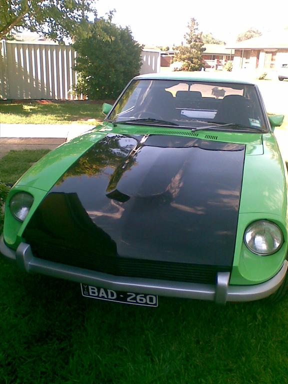

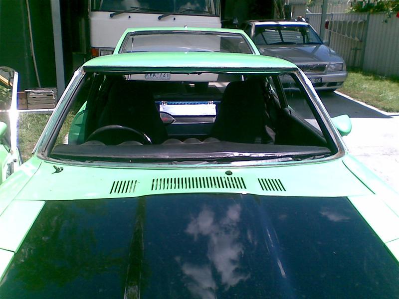

Scoota G Posted December 2, 2010 Author Posted December 2, 2010 Thanks Guys . . it still needs another 3 coats but i like to let the bodywork sit for a while and then block sand and recoat. Trying to keep with the front to back renewment (is that a word?) I'm getting a new screen fitted tomorrow. Sort of made me, you know, Happy. All the trims have been polished too. Quote
madz Posted December 2, 2010 Posted December 2, 2010 .....I think I want what you're on, Scoot.... Looking good by the way Quote

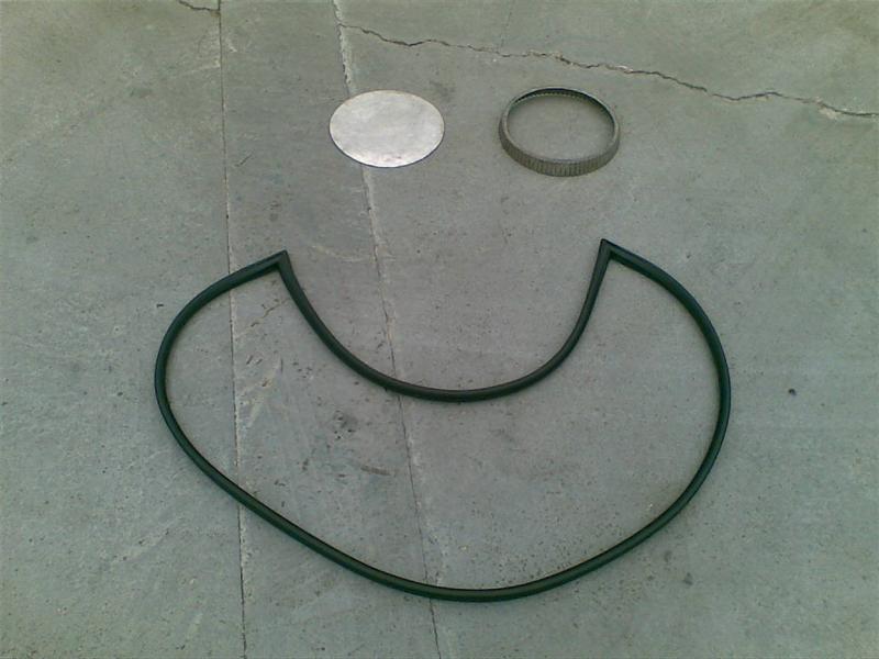

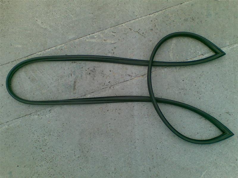

Scoota G Posted December 2, 2010 Author Posted December 2, 2010 Just for other's info the Windscreen is $200 fitted and the Rubber is $150. Quote
luvemfast Posted December 2, 2010 Posted December 2, 2010 That last pic looks like it is wearing the rubber Quote
Scoota G Posted December 2, 2010 Author Posted December 2, 2010 That last pic looks like it is wearing the rubber Hey simon congrats on your 1000 posts. As for the last pic i threw the rubber and it ended up more or less like that, it's kinda like an ink bolt test you see what you want to see................ Not Quote

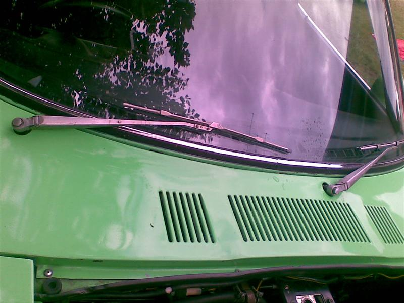

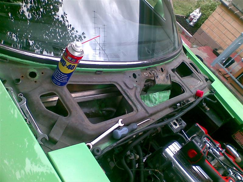

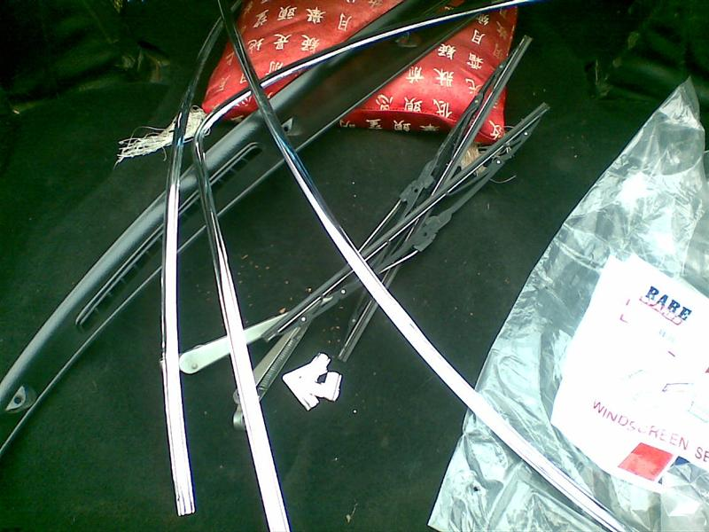

Scoota G Posted December 26, 2010 Author Posted December 26, 2010 Ok so Christmas Day i got the spanners out with some help from my amber friend / fiend and changed over the wiper arm mechanisim, which was really worn on one side, with the one's i got with a bunch of other parts i got from scoot3r42 (ben). How did you spend your Christmas? Quote
