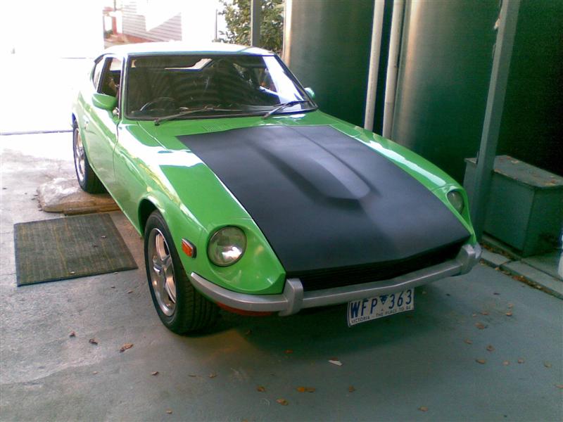

Scoota G Posted May 26, 2010 Author Posted May 26, 2010 looks great scoot.. get a new camera???no more black spots on the pics Ha!! someone finally noticed ... top darts. It's a new phone Quote

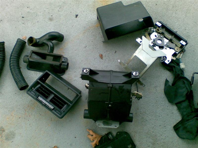

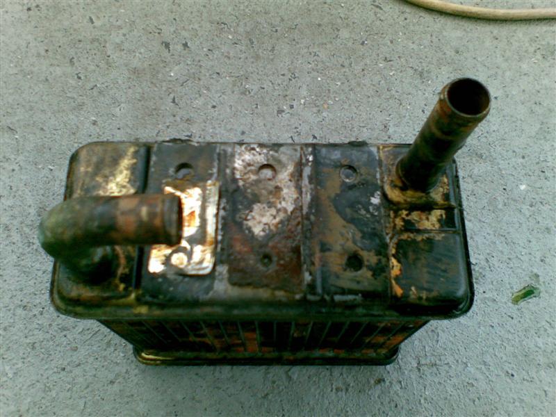

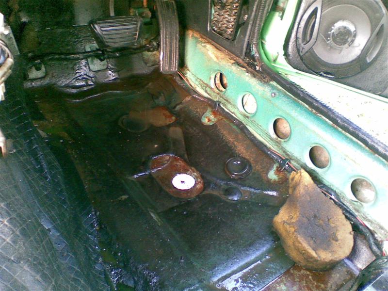

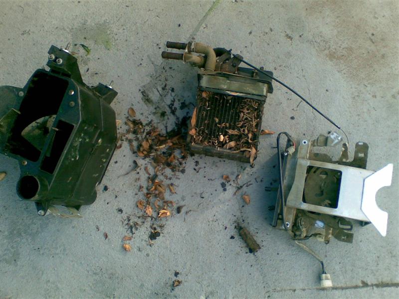

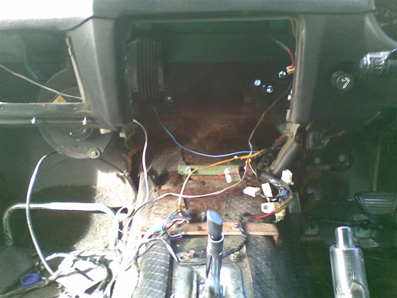

Scoota G Posted June 26, 2010 Author Posted June 26, 2010 A while ago i fitted a new Radiator and recently my Zed developed a leak from the heater core which got worse after we took the car for a spin down The Great Ocean Road, when i got the car home the Driver's Side footwell was pretty soaked. Turns out it just needed the hose clamps renewed and tightened. All the parts got a pressure wash and then went back in. Quote

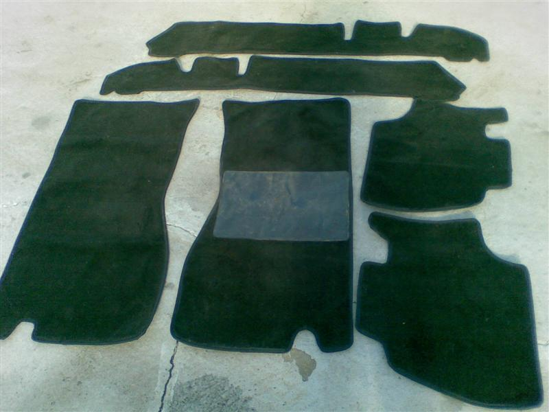

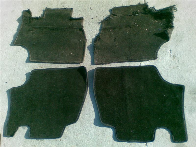

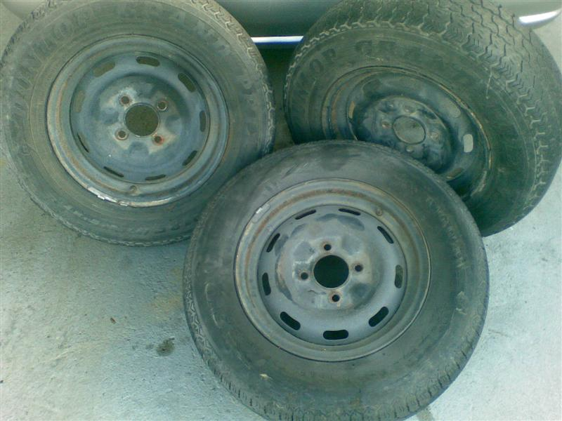

Scoota G Posted July 8, 2010 Author Posted July 8, 2010 I'll be back on track soon but just wanted to say thank you to another member (you know who you are ) who i got this carpet and also 3 x 240Z rims that now finish off a full set for Dalee's mustard 240Z. Ta very muchly! I think dale was reasonably pleased. Quote

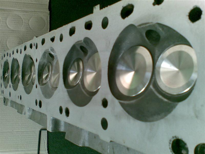

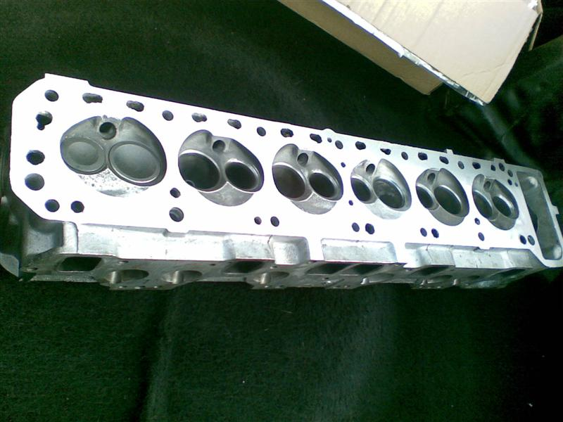

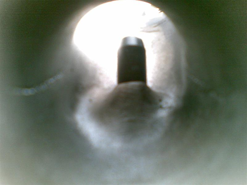

Scoota G Posted July 12, 2010 Author Posted July 12, 2010 Hey thanks for the parts too, dale was over the moon about the rims. On the mechanical side of my project, i picked up my Cylinder head that i bought off Dat2kman all fixed. Quote

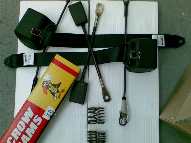

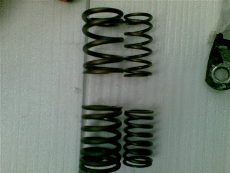

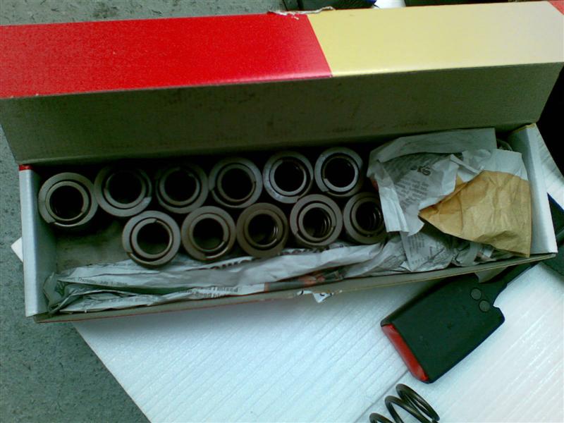

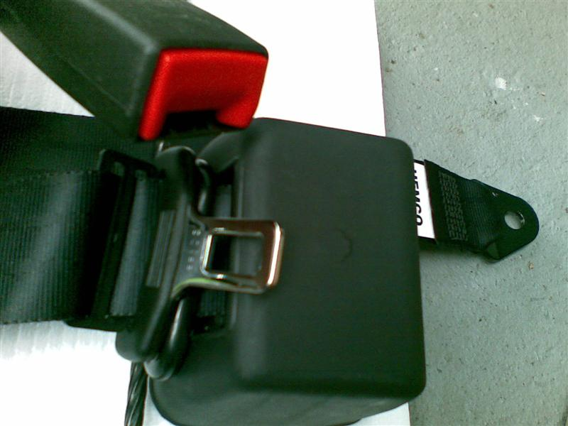

Scoota G Posted July 30, 2010 Author Posted July 30, 2010 Picked up these parts this week too, brand new seat belts from Hemco ($242) and a set of Crow Cams valve springs to go with the new cylinder head... Just need those Stainless Steel Valves now. Quote
Riceburner Posted July 30, 2010 Posted July 30, 2010 Hey mate where did you get the springs from? Reason I ask is I'm doing head work soon and was reaserching parts with SWM, said he's been having problems with crow springs, apparently they've changed suppliers recently (poorer quality) as a result he won't garantee them. He's even had them breaking in road zeds with mild cams.... Quote
Scoota G Posted July 30, 2010 Author Posted July 30, 2010 I picked those up direct from the factory. I'm wondering if you mean have Crow changed suppliers cause they make them there and also why would SWM advertise their product "Crow Springs" under the price of what Crow Cams sell them from the factory??? (What does crow springs mean as in crow genuine??) Mine are Genuine Crow Cam Springs, please bear in mind that i'm only using the info i have at hand. Quote
Riceburner Posted July 31, 2010 Posted July 31, 2010 Hmmmm, I thought crow meant crow cams. I could be wrong, maybe worth a check though. What type of cam did you go for? Quote
Scoota G Posted July 31, 2010 Author Posted July 31, 2010 Yea i definitely need to find out more info on those springs before i fit them. I have a modified Auto so i went for the mild Lseries cam which lumps along just nicley at the lights. http://www.crowcams.com.au/search.aspx?EG=58&MK=24&PC=1 Quote
C.A.R. Posted July 31, 2010 Posted July 31, 2010 I've broken Crow springs in the past, thankfully with no damage. I'd only use Kelford or Cosworth now... Quote

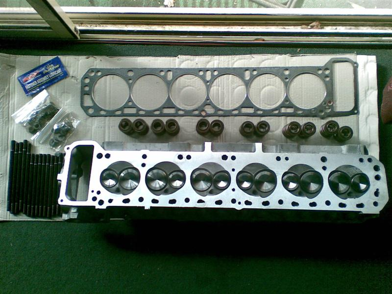

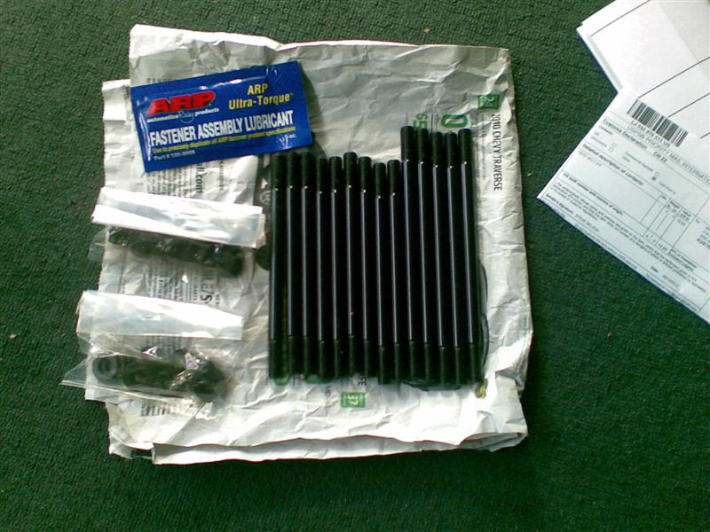

Scoota G Posted August 20, 2010 Author Posted August 20, 2010 These only took about a week to get here and at $170 they are $34 less expensive than VPW. Quote

tbscobraZ Posted August 23, 2010 Posted August 23, 2010 Awesome goodies, what sort of head gasket is that? Quote
FuzzyDropbear Posted August 23, 2010 Posted August 23, 2010 Mmmm, shiny things! Looks good Scoot, that head nearly looks too good to use You could always repaint your bonnet green and run one of the stripes up the bonnet. Quote
