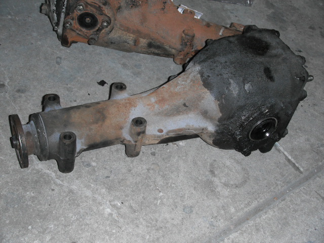

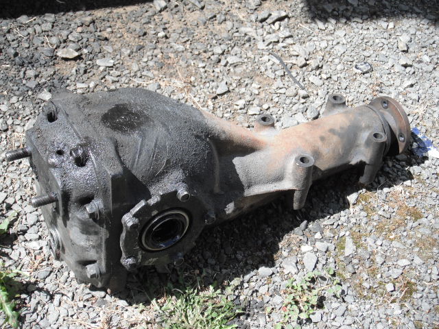

  14. Ill let ya know in a couple of days time, really chasing a 3.7.1 ratio cos its going behind a full manual 3 speed jetco, and at 3.9.1 highway rpm will be about 3600 or 3700 with 25inch tyre diameter. 3.7.1 is perfect for my application.
  15. The r180 i pulled out yesterday so I’ve had a good look at it. My output shaft splines are 25. They are cv joint drive shaft as well. Here is some photos of the r180.
  16. Hi fellow z owners, I am looking for a Gear Set 3.7.1 to fit a r180 long nose diff in my 280zxt , Note r200 is not what i am after brought one buy mistake . Let me know if you have got one, even a complete diff is fine cheers.
