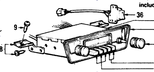

Stivva Posted September 13, 2012 Author Posted September 13, 2012 Would anyone happen to have photos or details of how the radio is mounted inside of the centre console? What are the brackets and bolts used??? I have looked everywhere and cant find a diagram anywhere? Quote

YosemiteZed Posted September 13, 2012 Posted September 13, 2012 Hi Only seen some details in the Haynes 240z/260z workshop manual for the original radio page 164 two brackets on the radio and also two brackets on the side wall of the console cheers Phil Quote
saxon Posted September 13, 2012 Posted September 13, 2012 yeah there are two bolts that as Phil said. Face plate is held on by the tuning and volume nobs. Quote
YosemiteZed Posted September 13, 2012 Posted September 13, 2012 Hi Stivva The bracket on the console is a single bracket that bolts to the two sides of the centre console Check the png file attached (thats bracket part ref 5) Quote

YosemiteZed Posted September 13, 2012 Posted September 13, 2012 Stivvas Found some detail for the radio bracket that bolts to the console frame bracket That all I can help you with Cheers Phil Quote
