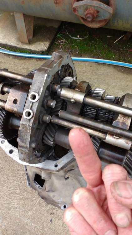

C.A.R. Posted April 22, 2016 Posted April 22, 2016 Today I learned not to post - what I find ironically humorous - photos on a Datsun page on the Book of Faces.The members lost their minds at this photo & called me an idiot. Quote
Moderators PB260Z Posted April 22, 2016 Moderators Posted April 22, 2016 (edited) Well, that photo does make one wonder what happened and why ? Edited April 22, 2016 by PB260Z Quote
dat2kman Posted April 22, 2016 Posted April 22, 2016 Becase most of the book-facers, have seen gearbox innards, and have lttle understanding! gav240z 1 Quote
Administrators gav240z Posted April 22, 2016 Administrators Posted April 22, 2016 Becase most of the book-facers, have seen gearbox innards, and have lttle understanding! Yes plenty of experts on bookface. . @Lurch - How on earth did you manage to break those? New motor? Quote
HS30-H Posted April 22, 2016 Posted April 22, 2016 Yes plenty of experts on bookface. . Ah, but it's a big step up from the class of comments you can find under YouTube vids... Quote
C.A.R. Posted April 22, 2016 Posted April 22, 2016 Someone previously had incorrectly double roll-pinned the forks, which no amount of hitting with the pin punch would make them move. It was quicker & easier to cut the rails and replace them with spare rails & forks. FB kids did not understand / comprehend this... Quote
Moderators PB260Z Posted April 23, 2016 Moderators Posted April 23, 2016 FB would blame "To much Boost - Bro" andyk_79 1 Quote
260DET Posted April 29, 2016 Posted April 29, 2016 Someone previously had incorrectly double roll-pinned the forks, which no amount of hitting with the pin punch would make them move. It was quicker & easier to cut the rails and replace them with spare rails & forks. FB kids did not understand / comprehend this... How were they 'incorrectly' double roll pinned? Quote
dat2kman Posted April 29, 2016 Posted April 29, 2016 How were they 'incorrectly' double roll pinned? Previous assembler used two metric roll pins, and rammed the living heck on the smaller one to make it fit.The second one is a very tight fit. Quote
