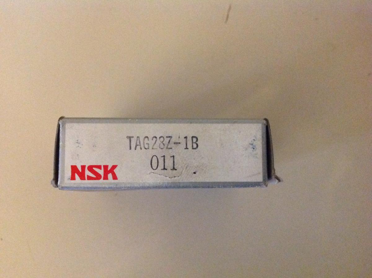

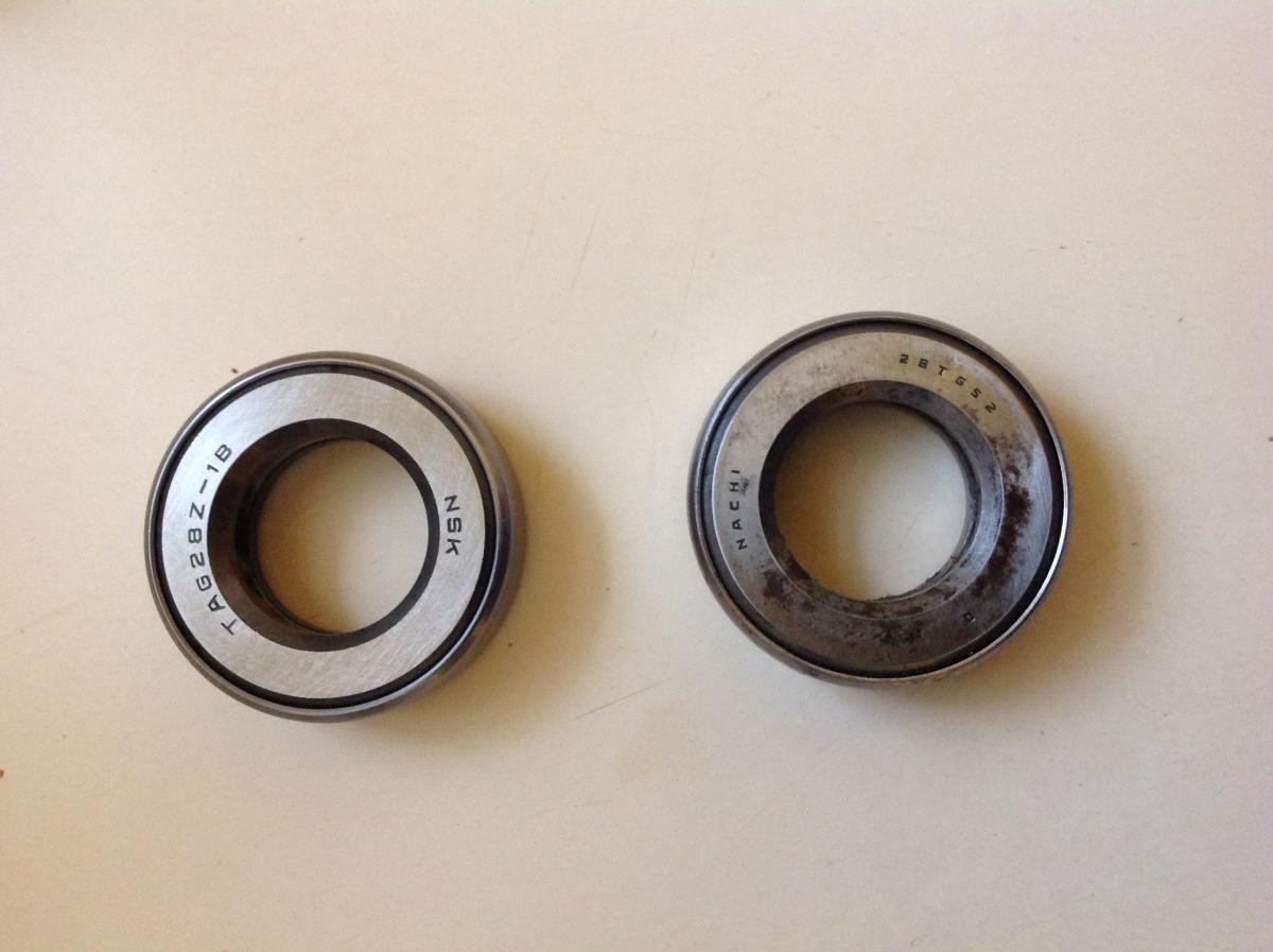

While doing some front end repairs I decided to have a look at the bearings in the strut tops to see how they were. One side was almost seized so thought I'd better replace them while the struts were out. I believe the genuine part is still available as the same bearing was used in some Nissan models into the early 2000's. Nissan didn't have any in stock locally, so I tracked down some aftermarket alternatives. Thought I'd post the aftermarket part number here for reference. And while I'm not 100% sure, I'd say the bearing is most likely the same across all S30's. Nissan part number - 54325-21000 NSK - TAG28Z-1B
