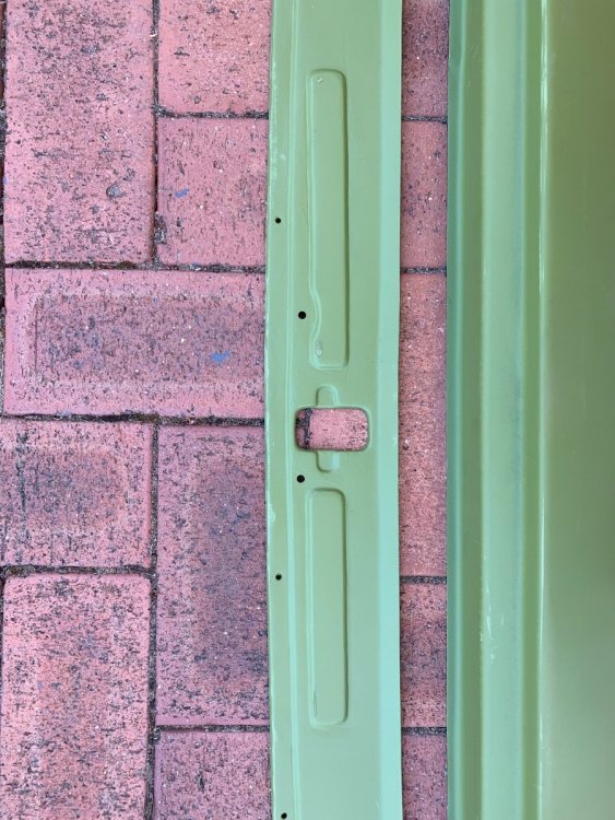

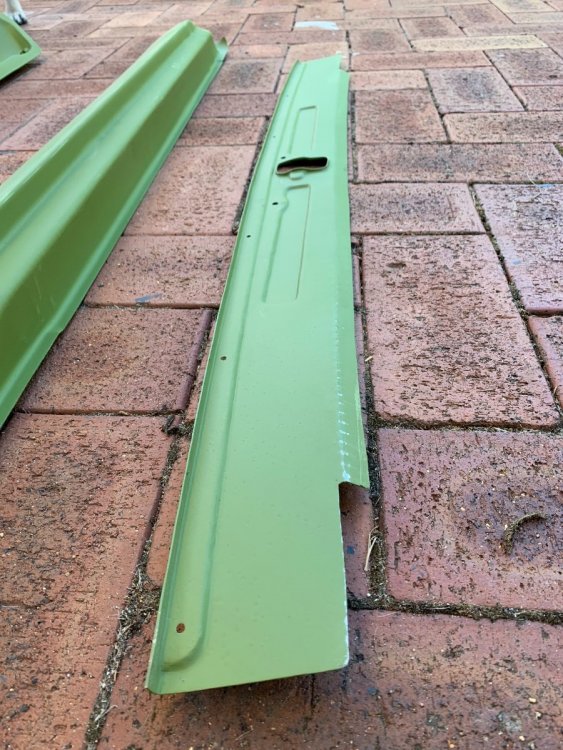

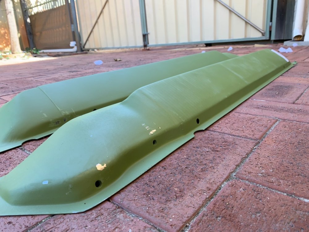

inner rocker reinforcements look good, fairly oem looking to me (not an expert), I haven’t actually seen mine yet so may not need these but will see, I think I will... there looks to be extra material for trimming and fitting
60C1E93F-C159-483B-8BF3-D2EF8B72FD7C.thumb.jpeg.890bd4bb95685ff3b68c385bbd5f8616.jpegE9D958FB-934A-41FB-8F73-C521E59C0878.thumb.jpeg.72b6b3bd298581c61fe06e1b36fe6b38.jpeg

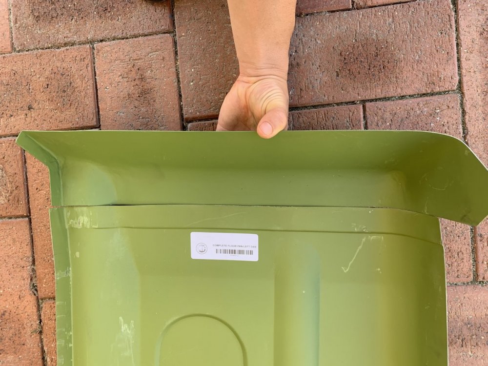

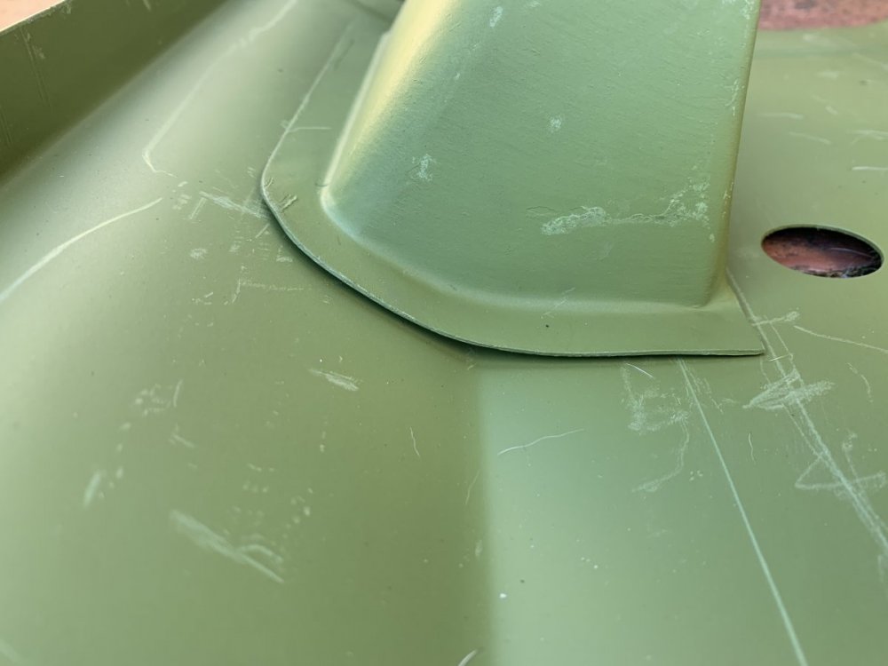

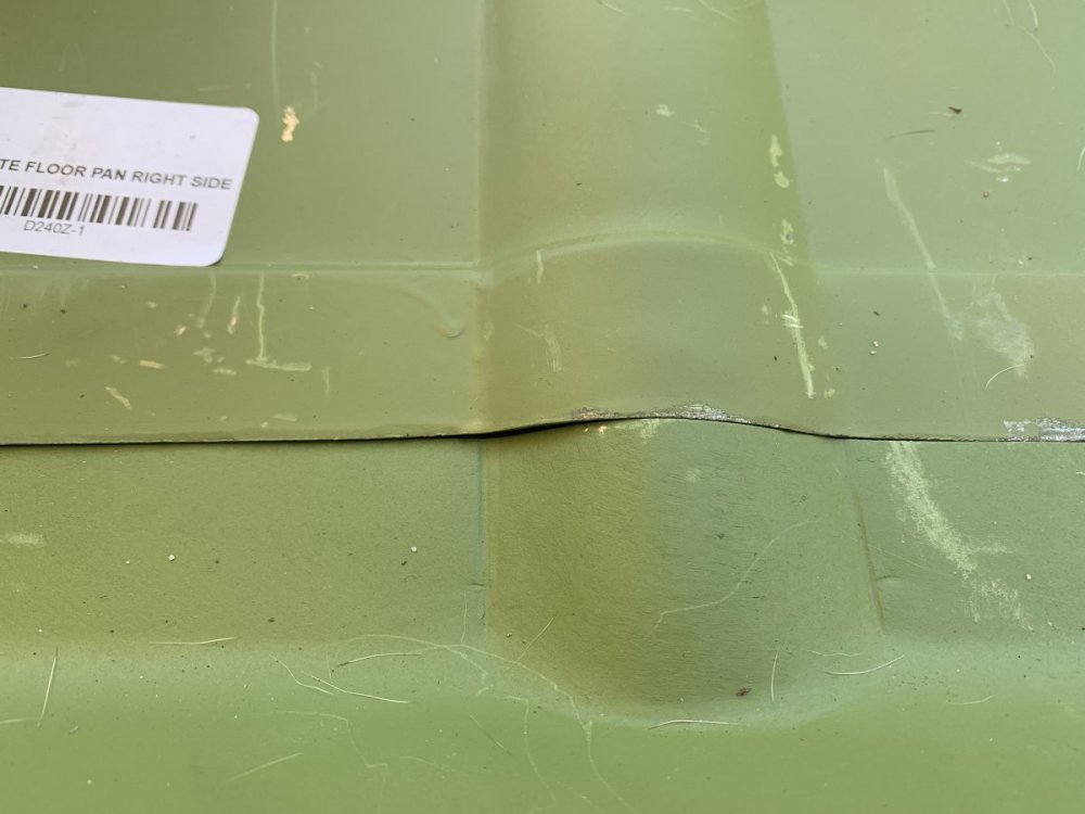

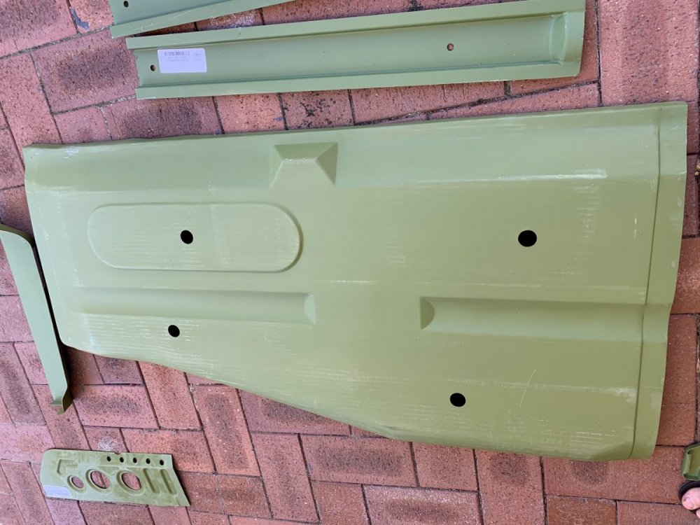

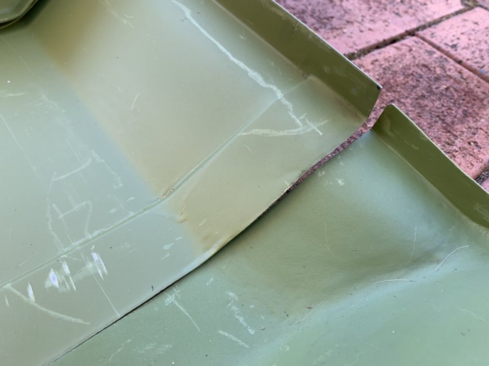

LHS toe board fitment looks reasonable. As with any replacement panel work will need to be done to make it fit. (So I’ve read :P) I’m not sure if the flange on the rear and front of the floor pans are extra material to be trimmed, see when fitment comes.
Edit: oem floor pans are flange lapped and spot welded
58F9D9F7-E89B-4D07-97D9-8D131B786012.thumb.jpeg.b3f92a6ab6532f65ba33f3322acb6912.jpeg5147533F-59BC-43D3-A0AF-55691411390C.thumb.jpeg.2eb7b9e0ea378bc7b8b82fb9edcf7416.jpeg

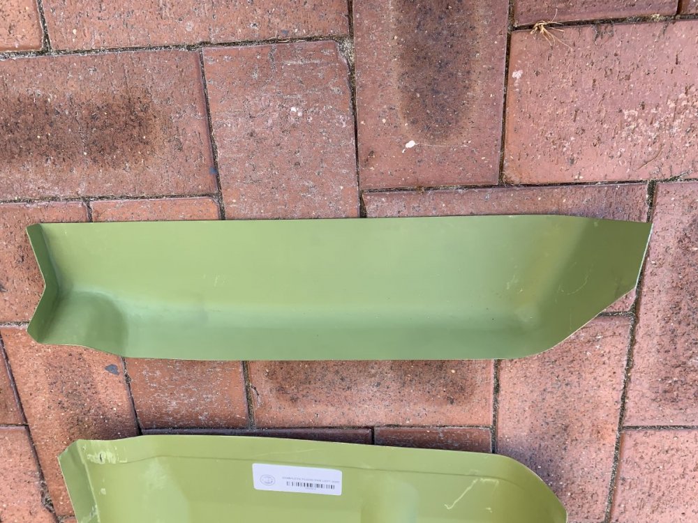

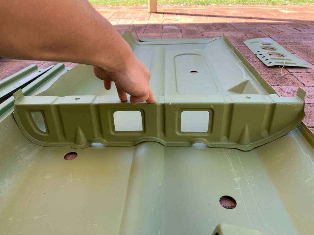

Rhs rear boards. To me these looked hand formed not a complete press like the floors. Center bead is pressed.
2F4D976C-18C4-4026-9D06-87D96D5C1BC9.thumb.jpeg.a3c479665f748d78fda76be4a5aa7617.jpeg4A9AA269-1D2E-4499-B7FC-22DA597F1FD9.thumb.jpeg.1ceaa648307f22609836ca4eace8a0a6.jpeg530632D5-5FFF-4DFF-9248-84AF2DDF78F4.thumb.jpeg.9ed51243d11ae452978b72f1887aceb1.jpeg

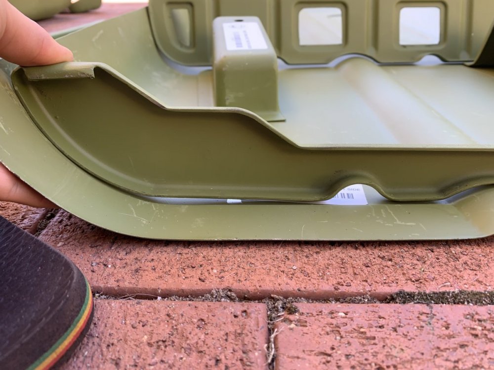

Rhs rear braces don’t  fit well, however I wasn’t sure on the exact placement/position it’s supposed to be in. LHS seems to be better. Modifications required. Tbh rear braces on my car are so deformed and rusted I don’t know what the fitment is supposed to look like.

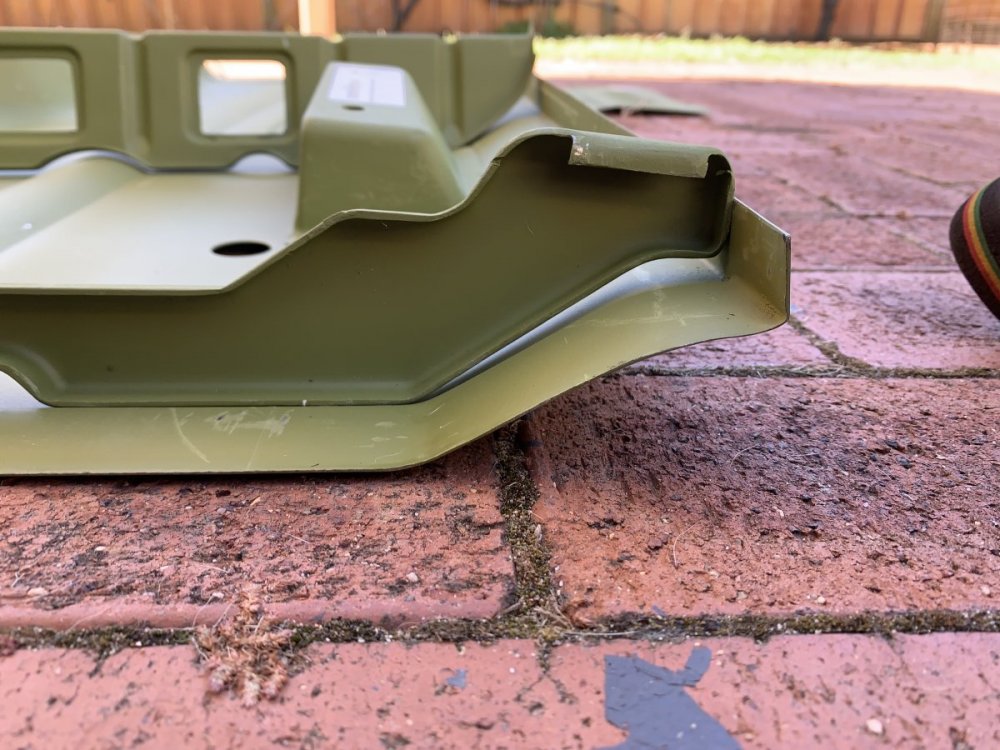

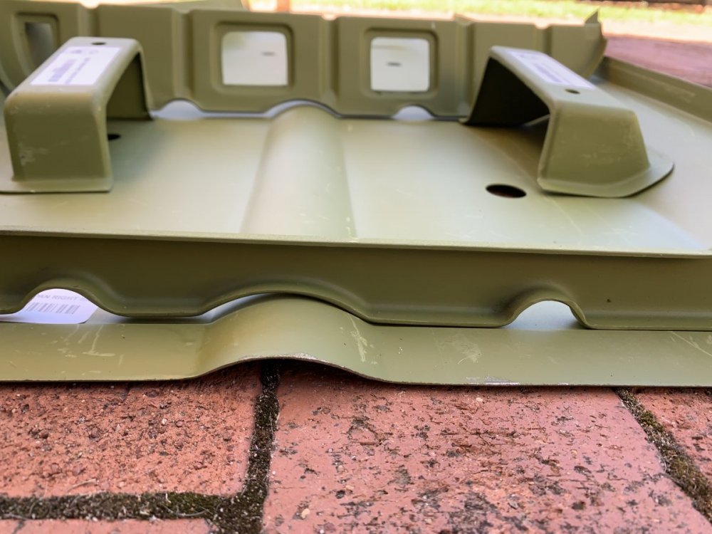

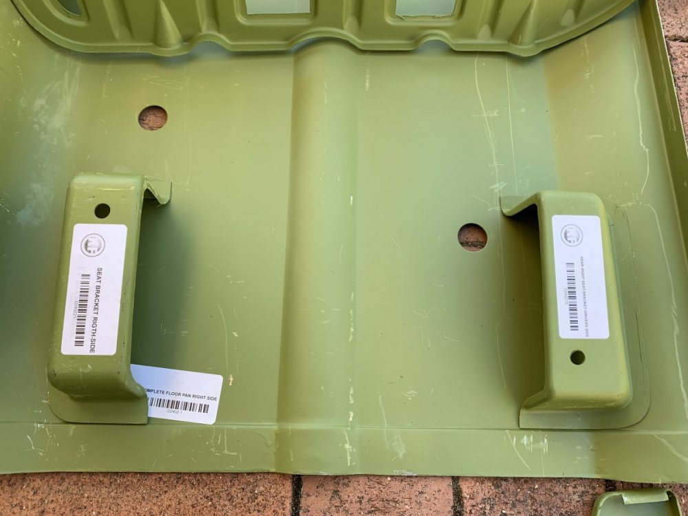

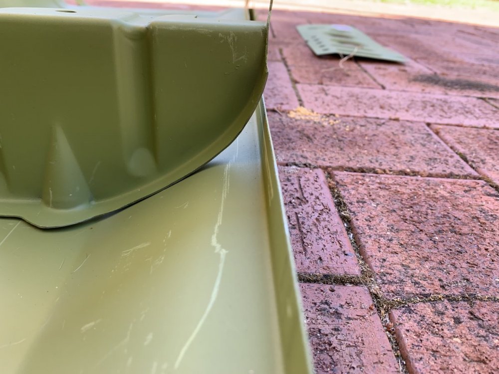

Seat mounts look good, fit well and have the extra bracing skin as well. I don’t know yet whether I need these or whether I can reuse mine, my floors are particularly terrible so I just ordered and can sell them on if I don’t end up using them.
front seat rails on both sides are ok but not sure about the gap in the corner on the outer sides. Was there a gap in the corner from factory? Maybe someone experienced can comment?
D6C69A7E-442A-45E3-950D-F2B14E89BD4B.thumb.jpeg.8be5882e40dc320e5a8908ec0b4ffdd1.jpegFBD039F4-BA7A-4D3F-9E1E-65F22B64B7A9.thumb.jpeg.7b01fbe104684aefe6aea067f00416d5.jpeg9E32AD0D-1419-494A-814E-D748C190BDA9.thumb.jpeg.57f4f53d3f1a045aa4760a3444bdaccd.jpeg

view of the underside of the floor pan. Very oem finish in my opinion, compared to other floor pans on the market. Yet to be seen how it fits though.
Overall very impressed with these panels. There is evidence that a lot of handforming is done as there seems to be a variance between panels and some welding is visible. But honestly I’m not too fussed.

They look great. More accurate that the z-findings floor pans. I used a set last year.
The stock seat mounts do have some gaps against the outside edge. That is normal from what I have seen.
cool I thought as much!

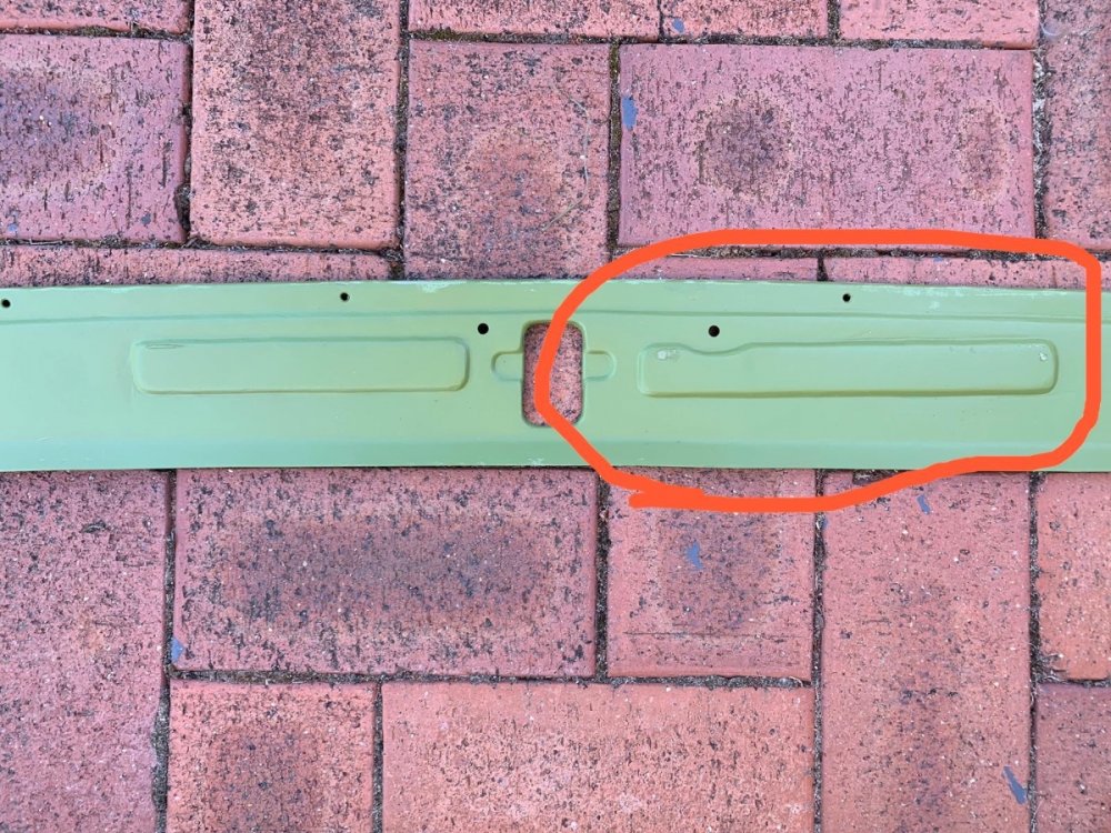

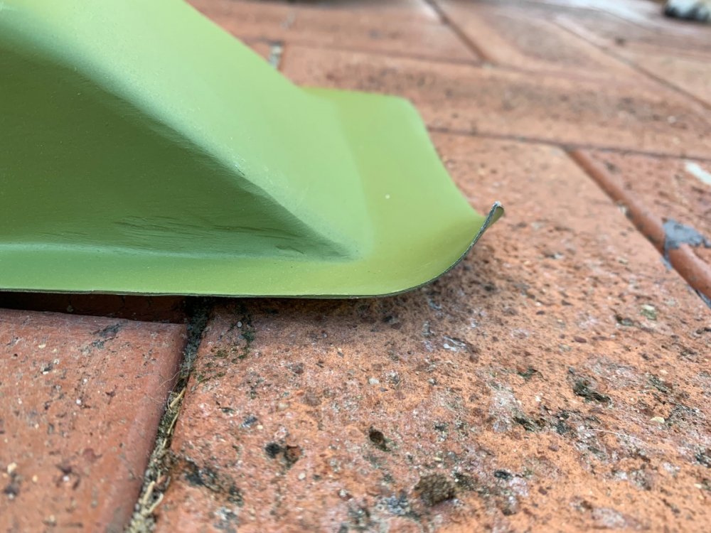

One thing to mention is the rear hatch panel has a pressing in it that is not straight. I’m reasonably sure this is not oem as standard. So if you’re going for concourse level this may not be the product for you.

Sorry locky maybe didn’t make myself clear enough, meant the indentations pressed into the panel weren’t straight, not the overall panel itself
See how it is a bit skewiff?
Edited by 240ZBUILTBYME
I think that's how they are, but I'll double check mine.
