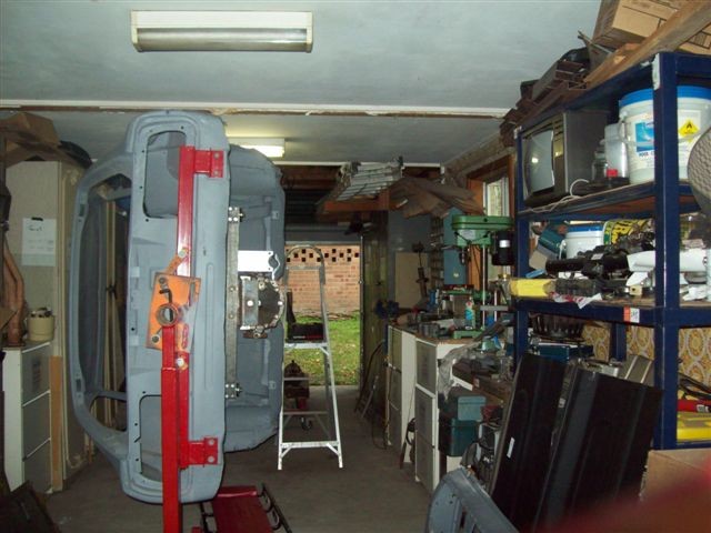

PeterAllen Posted November 23, 2017 Posted November 23, 2017 Paul. Having undertaken a rebuild in a single car garage the first thing I would suggest is a modification to the rotisserie mounting brackets. With the car held at 900 it creates more working space. You should make the axis of rotation 75mm above the bumper bar mounting points as this will allow one-person, single-hand rotation. You may find with your rotisserie you will then need to extend the vertical posts of the rotisserie (est. 20-30 cm) to ensure the body clears the ground. Andrew_L26 and Groundhog 2 Quote
Promethium144 Posted November 23, 2017 Author Posted November 23, 2017 Hi @ Gav yeah the battery area is the worst spot looks like someone had a go at ti in the past and did a pretty average job, but will be able to sort it out. Yeah the ding on the rear quarter is a bit of a nasty one but should be able to beat it out as you say will be aiming for minimal filler. @ peter Unfortunately thats not my garage (its living at the in laws at the moment) im building one in the back yard at the moment to house the car. it will be a little wider but not much. and yes i have had the same thoughts about the rotisserie at the moment you cant rotate it all the way around and its a two person job. if you stuffed up the roof would hit the ground, very not ideal. will sort this out once i get things settled in its new home. Quote
