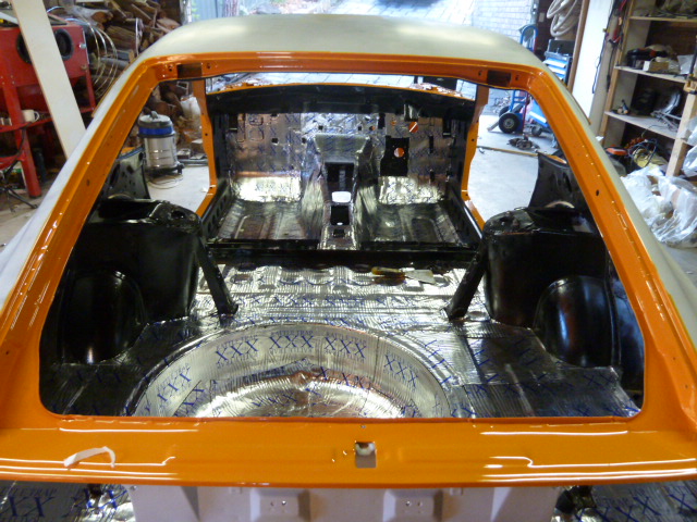

WA240Z Posted October 19, 2016 Posted October 19, 2016 (edited) Dynamat, have only done this in the foot well floors when I had the rails replaced, the rear area still has the original tar deadening. Then under all carpet Dynaliner stuck to the bottom, finally had the carpet loop edge bound to look original. This has given me a good result. Photos are of a test section I did for the passenger side with some house carpet. Edited October 19, 2016 by WA240Z Quote

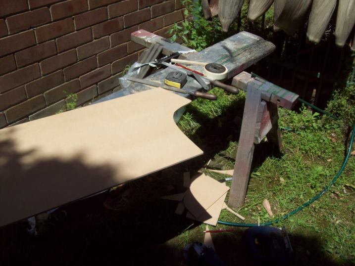

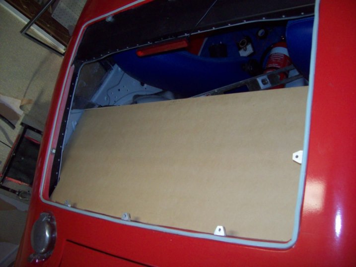

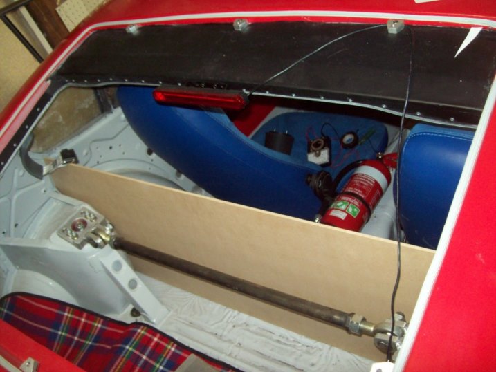

PeterAllen Posted October 20, 2016 Posted October 20, 2016 David. Every considered MDF... Knocked this up yesterday. Quote
