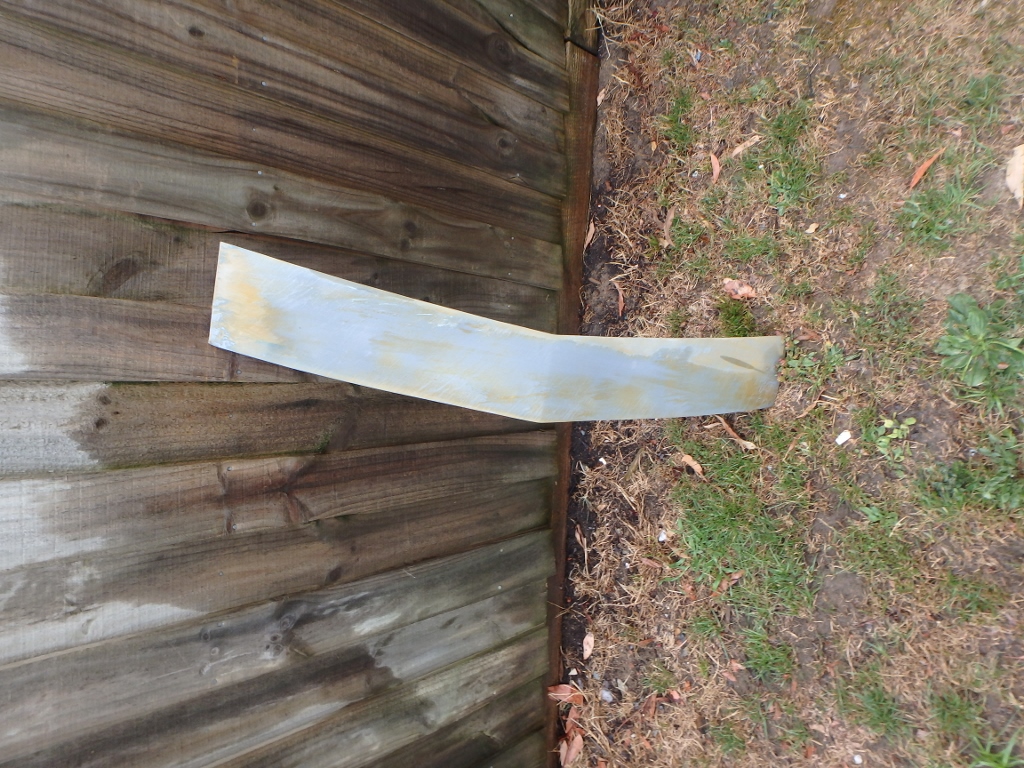

Cozza Posted September 13, 2016 Posted September 13, 2016 I think you may have misplaced a decimal point somewhere! I think 5-8 would be pretty close. I think the recommended allowance for thermal expansion is about 0.5% for Perspex (given a 50' temp change). Assuming 1m width would give 5mm. Another concern for Perspex is the long term moisture absorption, recommended allowance for expansion is about 0.3%. Worked on a project just recently with Perspex Impressive write up AK. Look forward to following your progress. Mick Quote

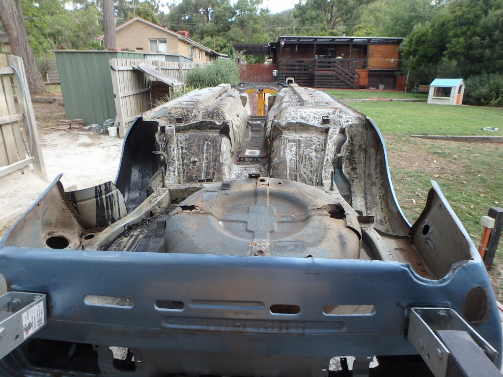

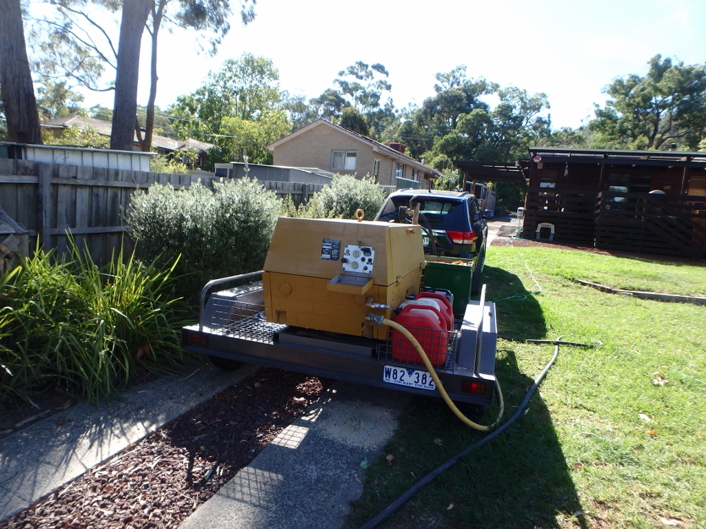

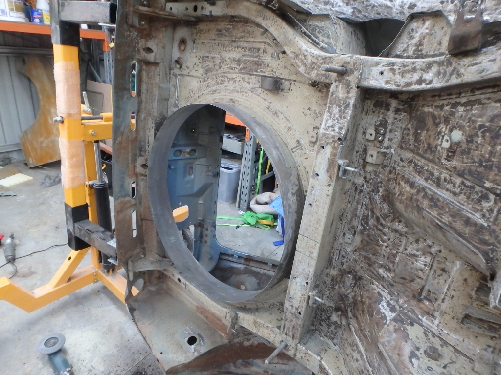

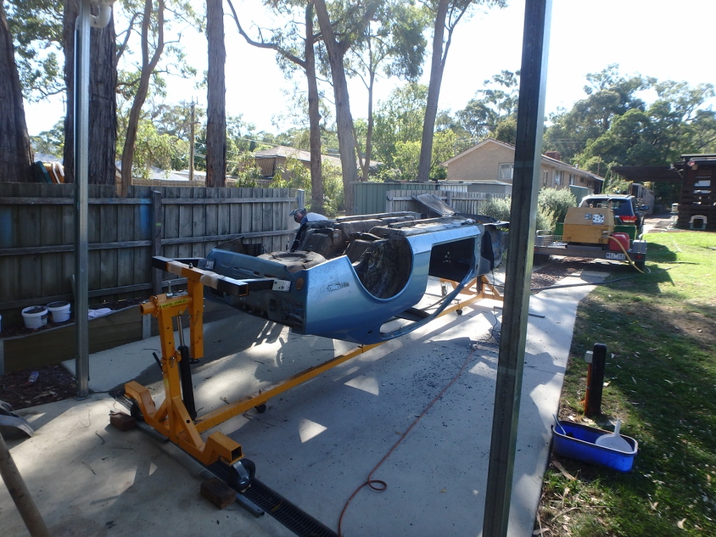

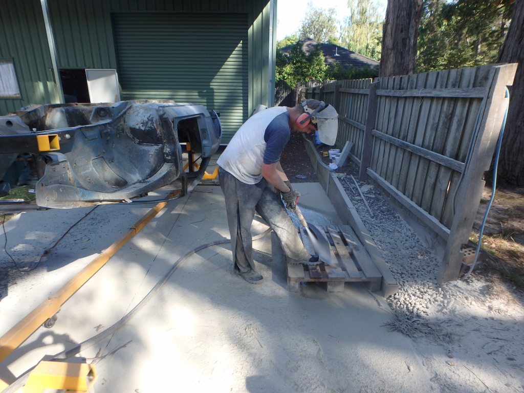

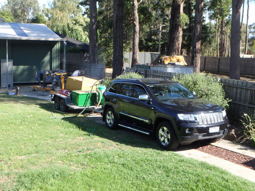

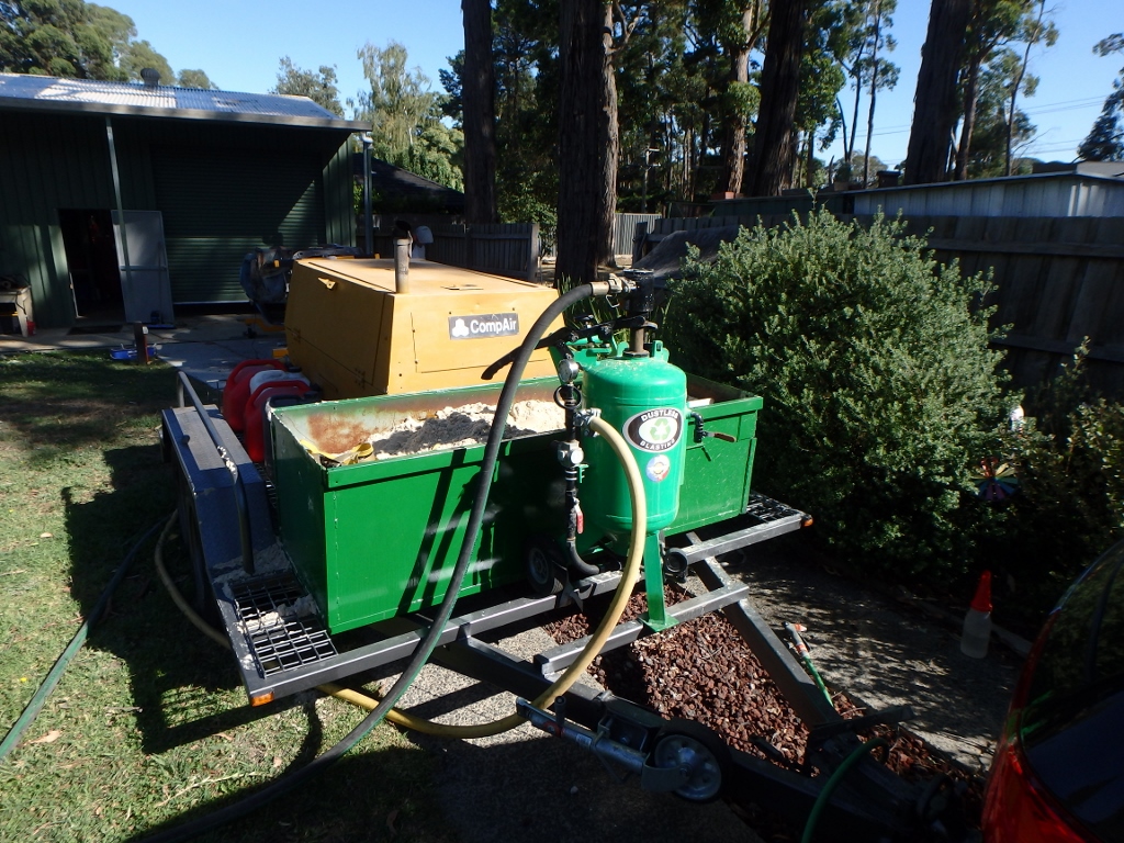

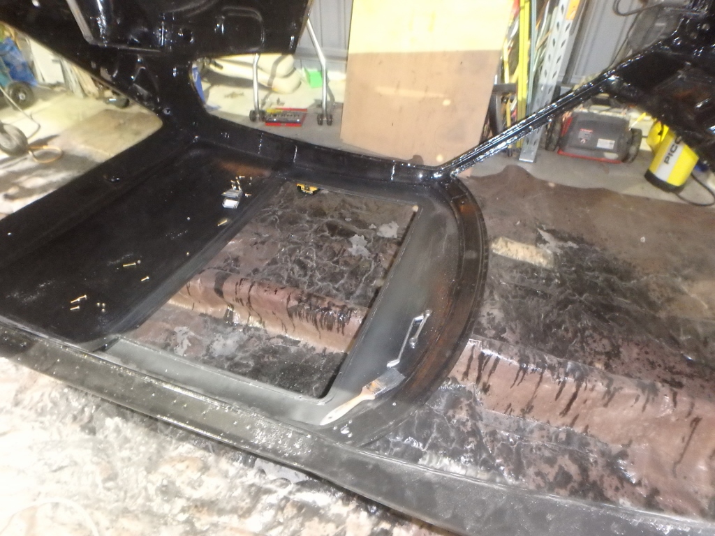

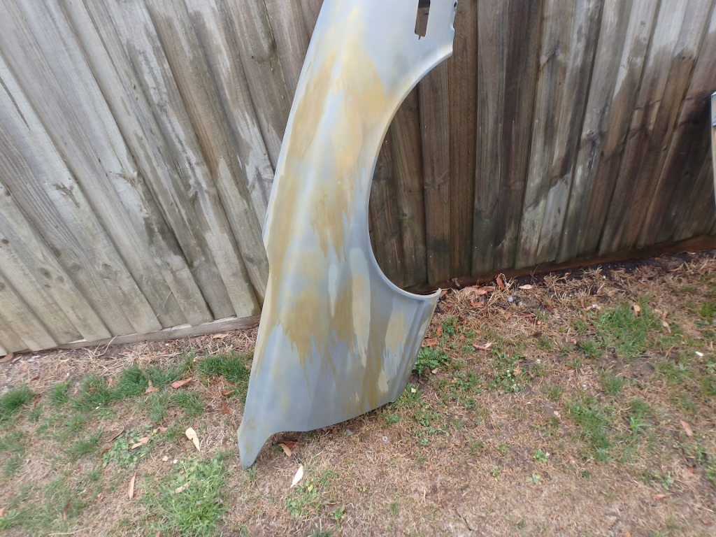

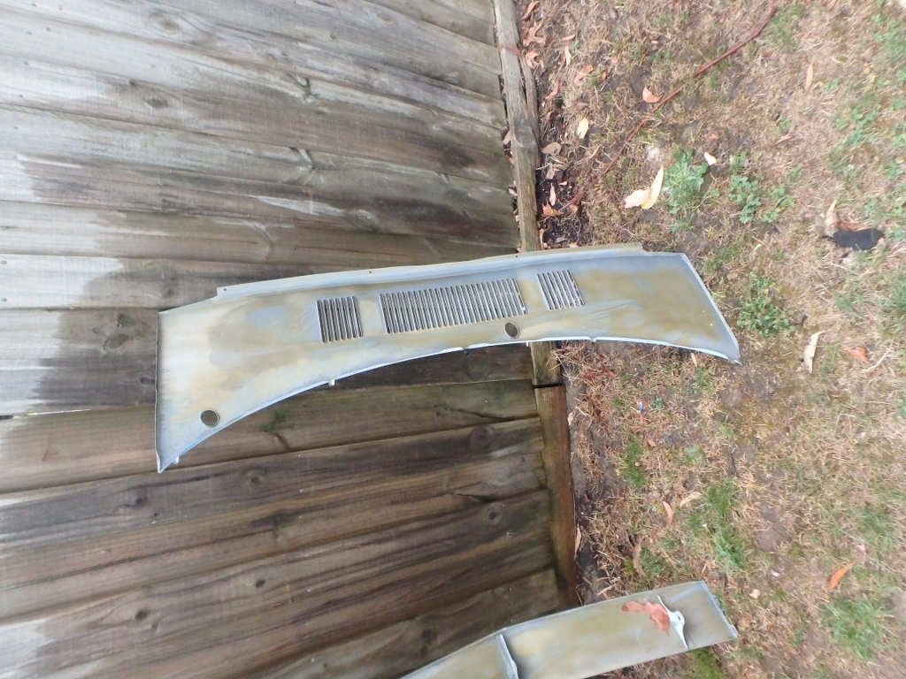

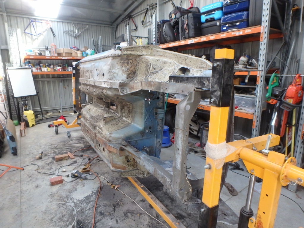

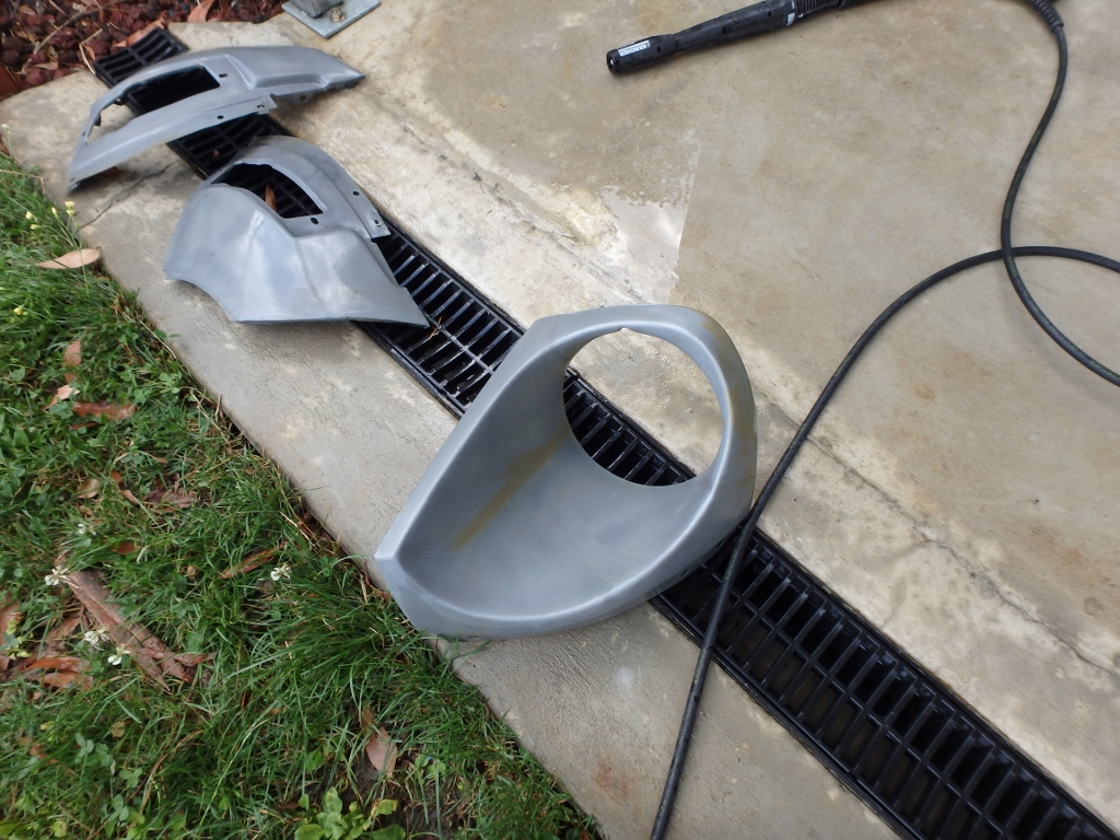

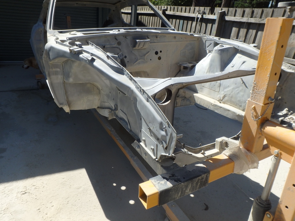

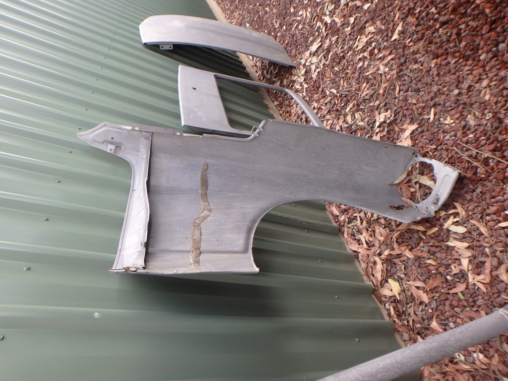

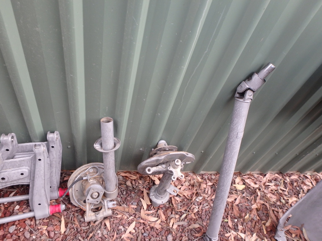

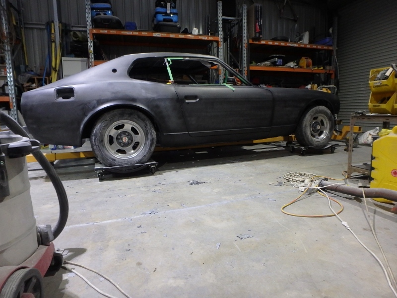

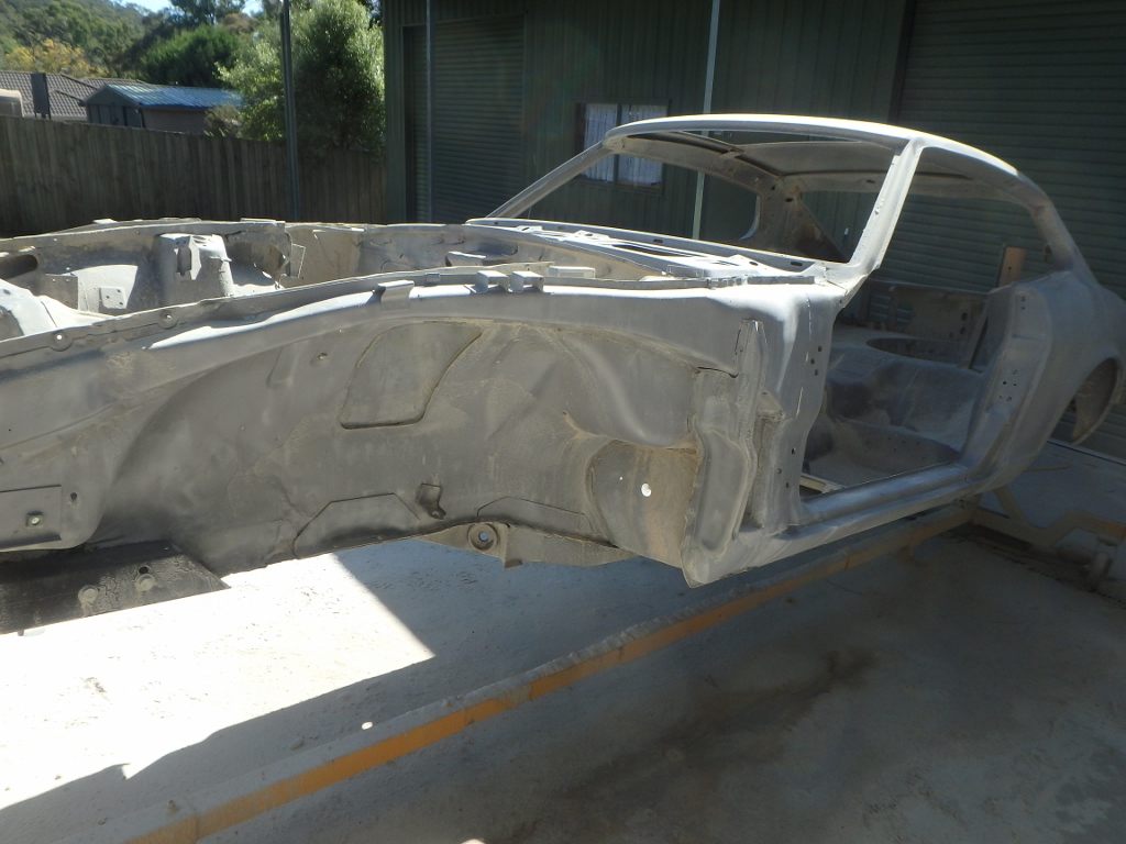

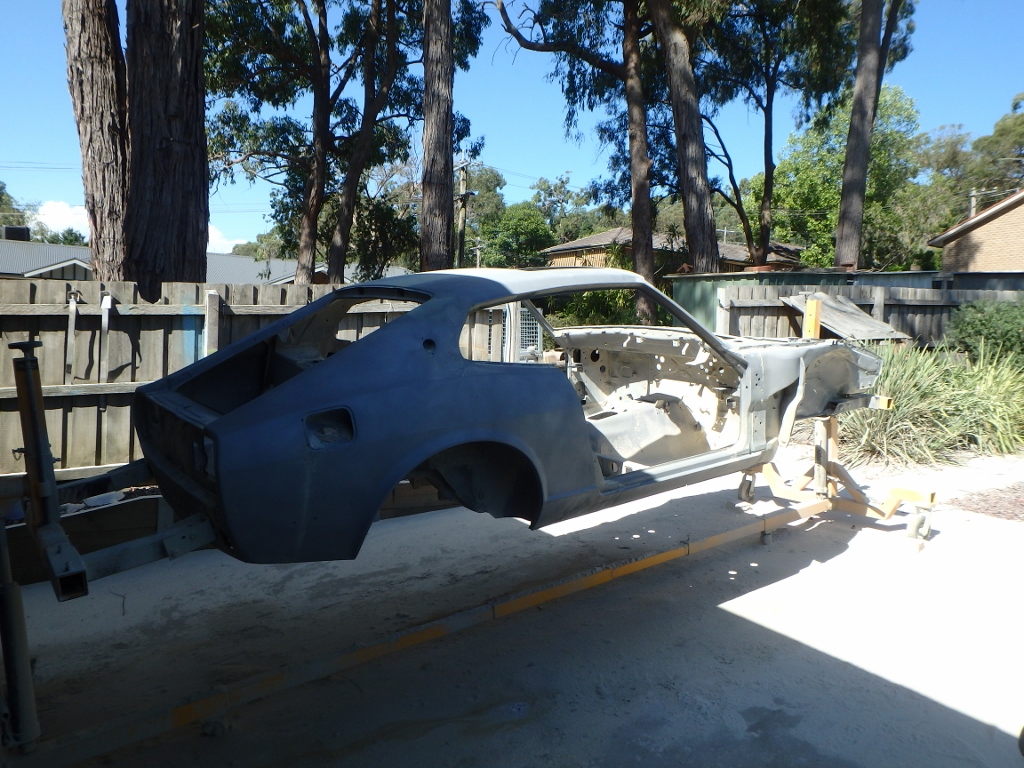

AK Posted September 17, 2016 Author Posted September 17, 2016 Hi Guys Time to add some more photos not sure if I am doing this right but here we go. The next batch of photos are of the Wet Blasting or Dustless Blasting process which over all worked really well, but on the inside of the car standard sand blasting (dry) may be better? both ways I imagine are equally problematic as the blow back from going into a sealed space would be or is really bad. The wet sand also tends to build up inside the tight spaces which means you have to stop scrape it out and start again - repeat and smile:) In any case compared to normaly dry sand blasting less mess with dustless wet blasting and the water keeps the panel cool so less warping and it keeps the dust down and it can be done at your house very handy. The process of washing out the car afterwords and getting the sand out once dry is quiet time consuming and requires patients and a strong shop-vac with a lot of different attachments to get into the tight spaces air strong compressor to blow it out as well was also useful here - scraping and brushing with a stiff bursh is also required to remove the sand - this was a painful process!!! The wet blasting doesn't hurt rubber so that's very handy, you see in the pics, but it also means the tar style sound deadners have to be removed before wet blasting and seam sealer also tends to make the sand bounce off as well so lots of vibrating tool action here which very hard work. The water that is sprayed also has additive called hang tight I think which stops the panels rusting bust in any case as said earlier I used the POR 15 process on the whole car pretty much after this wet blasting so the marine clean, the Rust Blaster and then Rust Seal Paint so reasonably bullet proof process hopeful. Rickers 1 Quote
blu260z Posted September 17, 2016 Posted September 17, 2016 No messing around here!! Straight into it, nice work AK Quote
CBR Jeff Posted September 17, 2016 Posted September 17, 2016 AK that's an impressive trailer load of sandblasting kit. Very impressive work and posts. It doesn't seem you need any encouragement as you are progressing very quickly, but keep at it. Did you hire the sandblasting kit? Jeff Quote
AK Posted September 18, 2016 Author Posted September 18, 2016 Hi Jeff I hired a guy who had all the gear to do it - for him it was a part time job. The cost of hiring was pretty expensive by the time you hire a big-ass compressor with the mumbo to push out the required pressure, a Kennards in the back of Dandenong was the only place that had one for hire. I researched it a lot before pulling the trigger - I think the only thing that would be better is putting the whole car in bath of Molasses. In regards to motivation - I have a tight time line December to get her all back together thats the motivation if the body can hold up. I have a small wet blasting kit that fits on to my 2500psi Karchner which is OK for small item but not would be to slow and messy (use a lot of sand) compared to the pro set up. Off to the shed Cheers AK CBR Jeff 1 Quote

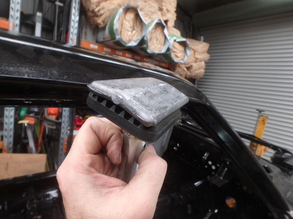

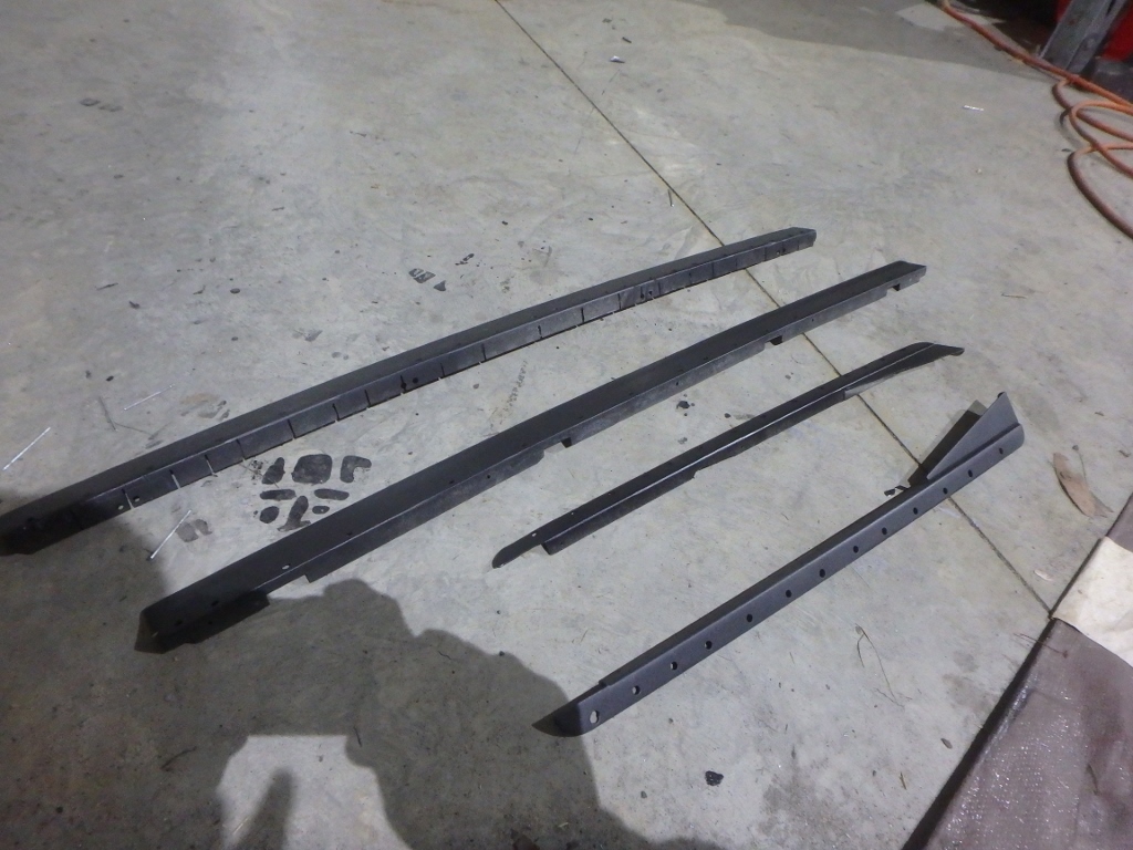

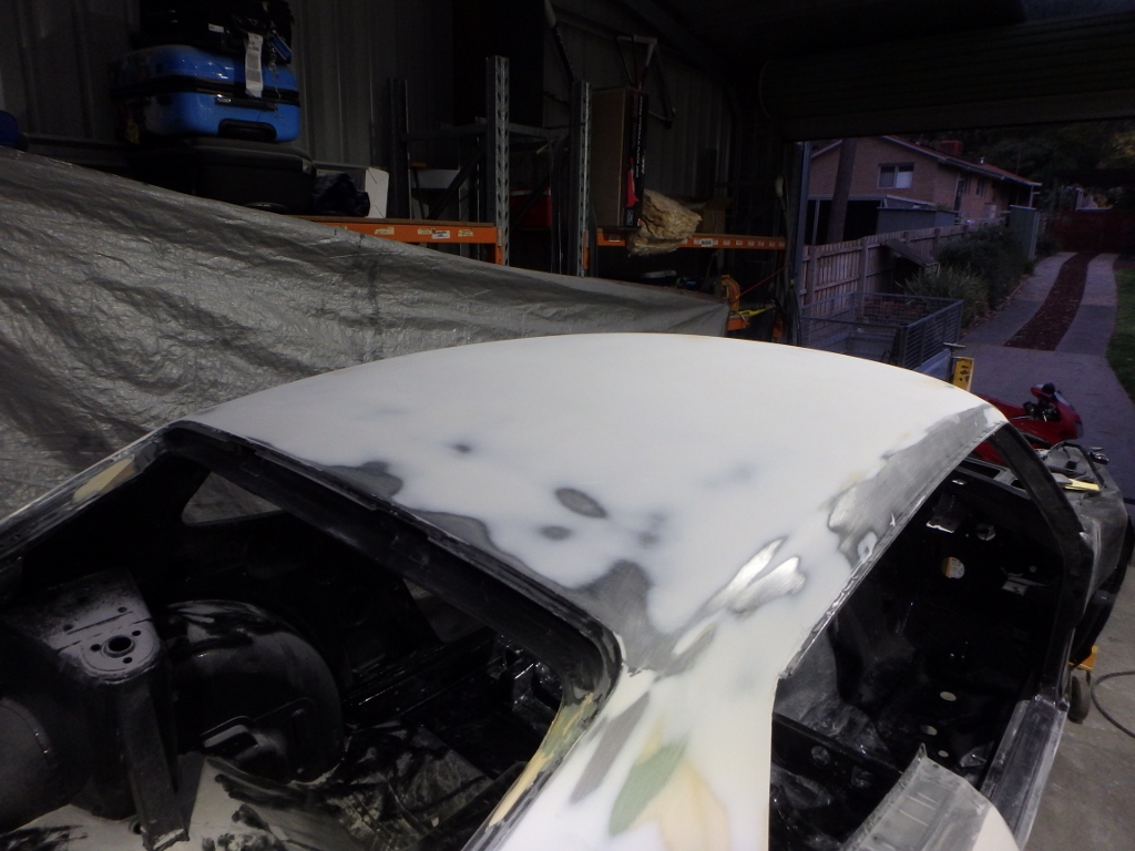

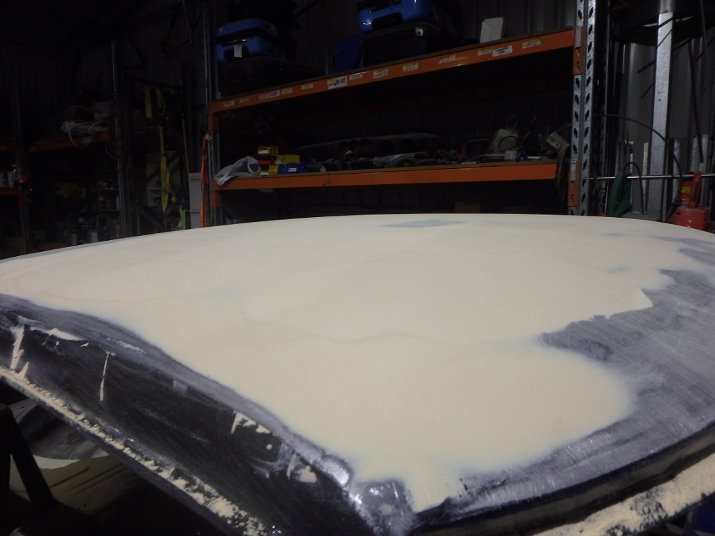

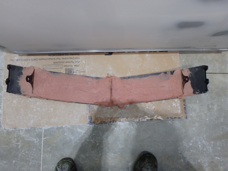

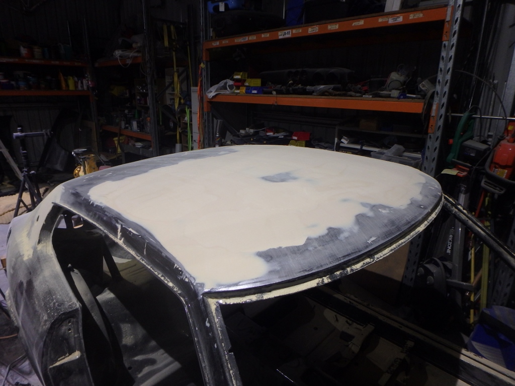

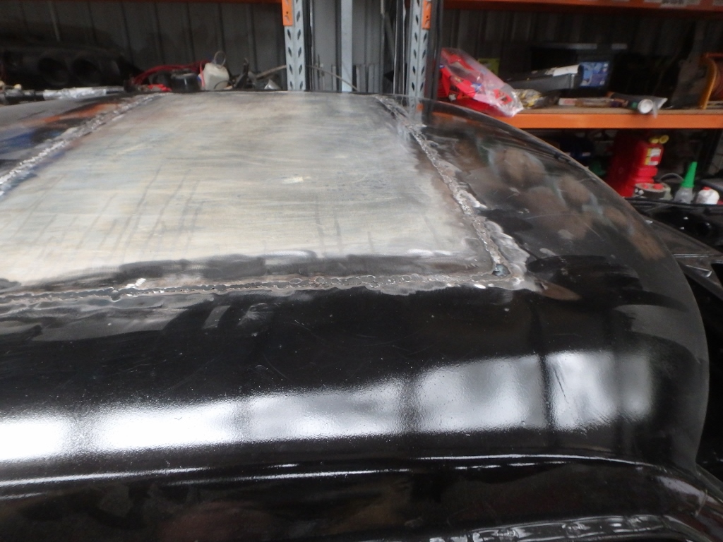

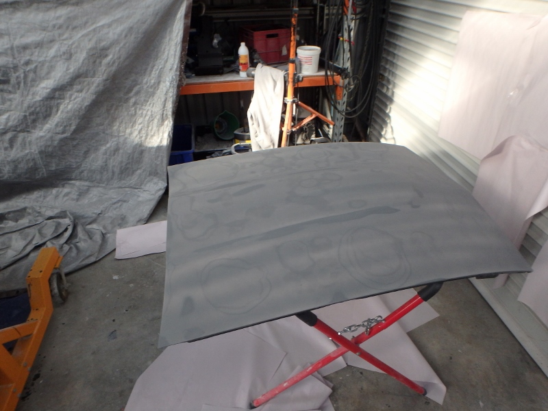

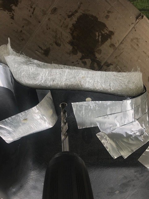

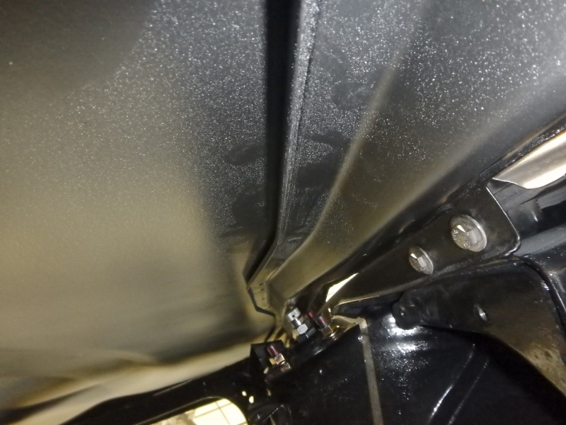

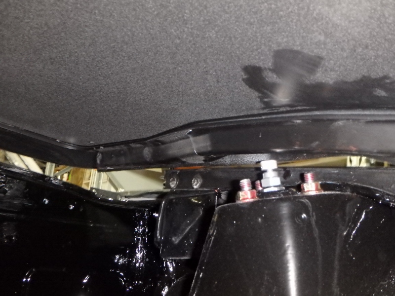

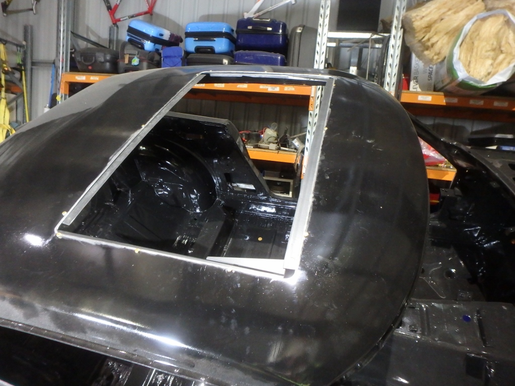

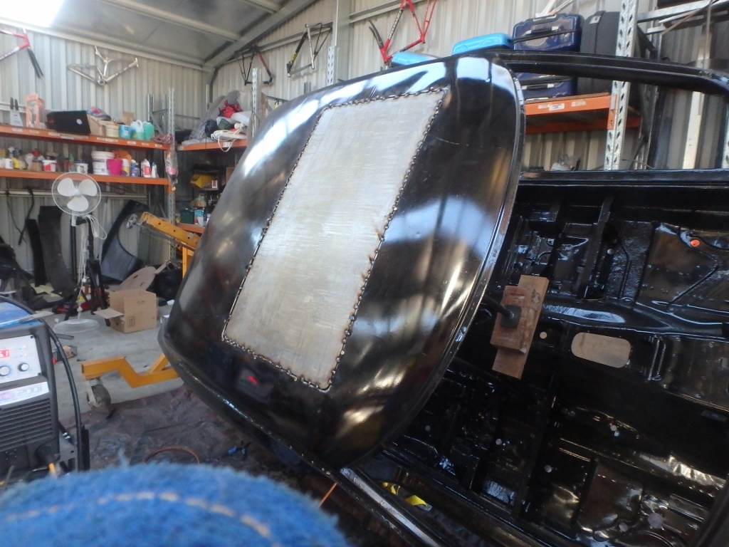

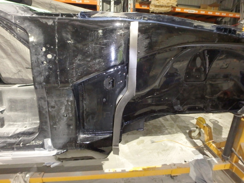

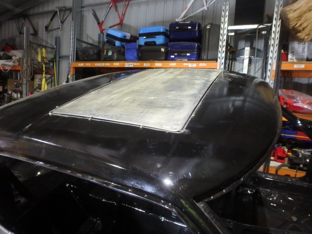

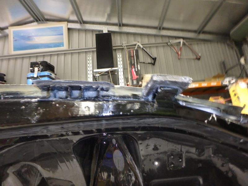

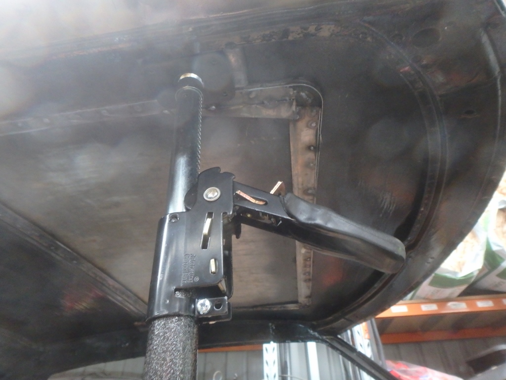

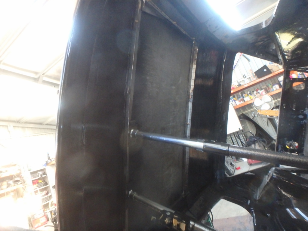

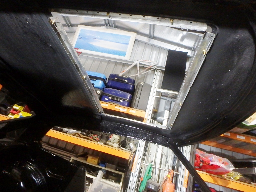

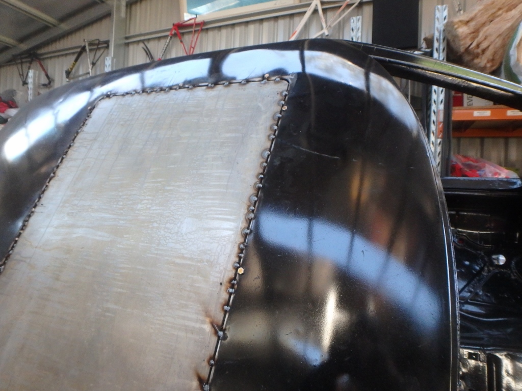

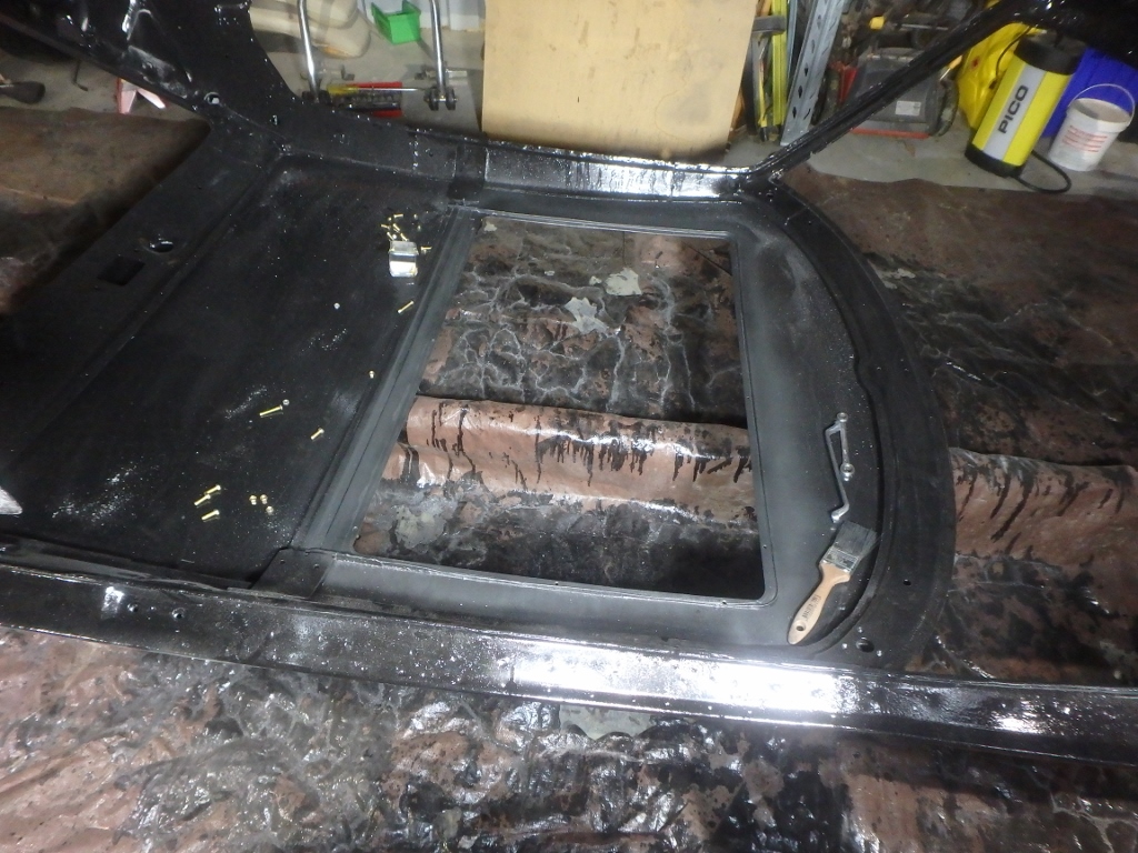

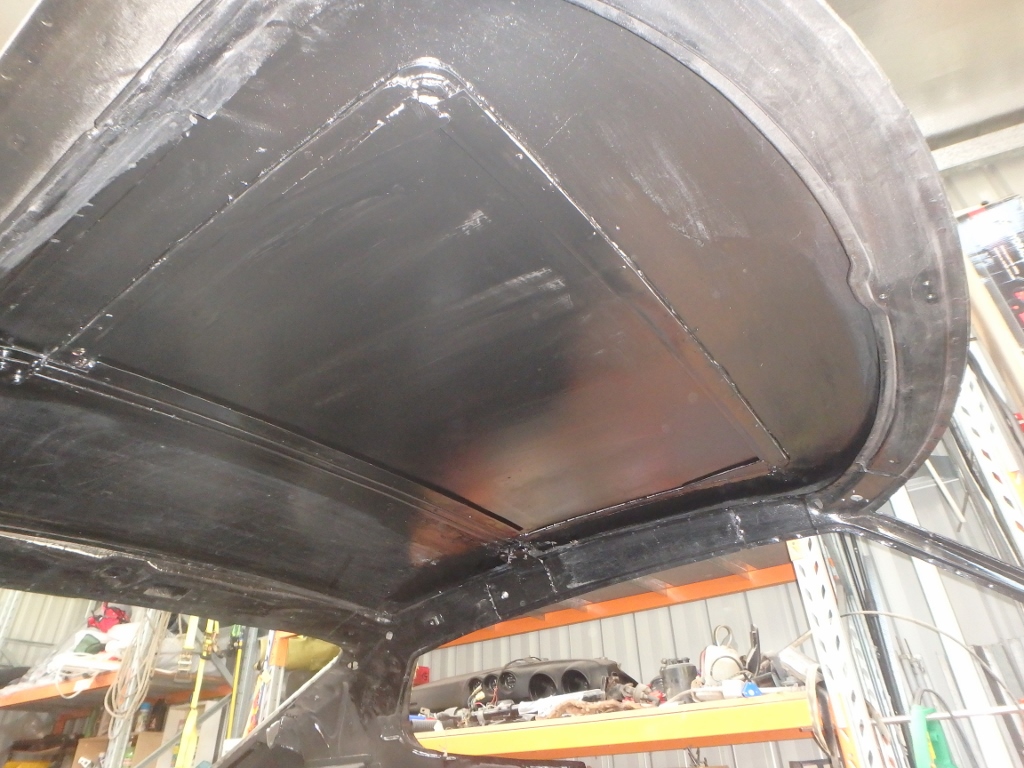

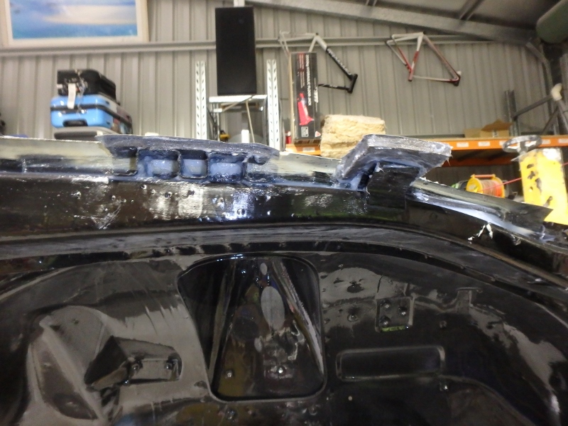

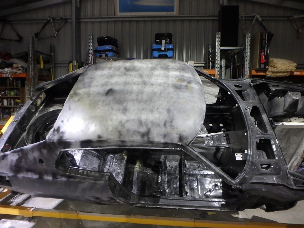

AK Posted October 4, 2016 Author Posted October 4, 2016 The sunroof delete Sun Roof Delete is always a topic of much discussion of how best to approach?? I mentioned my sunroof delete plan earlier in the build / reco - I will go into some more detail now. I can not say if this is the best way but is one way to do it - end result was pretty good and very strong - stronger than a standard roof easily. It took some serious hours to do this may even 100 hours - crazy amount of dicking around the principles of what I done where sound I think the execution was good for a first timer - but some one with more experience would nailed it and done in a 3rd of the time. This sunroof delete is more for the drop-down and slide back solid metal variety - but the principles could be used for any sunroof. 1. use the blank from original drop down and slide back sunroof - (removed all of the existing slide back sunroof without damaging the slide back blank is important as you will need this piece in good condition.) 2. pull out the internal frame edging around the sunroof blank - this was held in with a folded into a lip around the outer edge of the sunroof, to put is simply use these parts to make shelf for the sunroof blank to sit on at the correct level while welding into place - I saw this with my newbie welding skills as one of the hardest things to do besides trying to control heat warping from welding. Also framing the edge of the hole would make it much stronger and give more metal to weld too for more strength and better thermal control. 3. The existing frame work in slide back sunroof blank was relatively easy to pull out and it had the matching arcs to match the roof line so far the plan was working - I you had to make these right angle shaped arcs it would be hard to do it correctly - but you could also use flat pieces of steel with some light bending to match the roof line. 4. Drill holes through these frame work pieces and the edge of the the existing roof hole and bolt the metal frame pieces in place to create a shelf at the right height for the sunroof blank to sit in - once bolted in place start to spot weld this edging frame in place - note I used magnetic cooper plates and air compressor to blast the weld area after each spot weld to control heat saturation very lengthy and painful process 5. Pull out the bolts and nuts holding the frame in place and the weld in the bolt holes from the bolts using cooper plates and compressor for cooling again 6. Drop in the sunroof blank see if sits right matching the existing roof line, it pretty much did, I did need to space up the blank a little with some washers to get the right height, and use lead weights I use for scuba diving to hold it down in place firmly. 7. Start the many hundreds of spot welds crossing back and forward across the sunroof until you have solid weld all the way around - How did this work? Pretty good but a painful process with moving cooper plates and the use of the compressor to cool - even know I took my time I still should of taken a little more as I still got a little warping . So do not rush this and do not start welding again in that area until it is cool enough to touch with hand minimum at least is my advise. 8. The cooper plates I used are a Eastwood product and they are available through the Aussie distributor one plate was about 15cm long and 8cm wide the other was about a 10 cent coin size with adjust angle with magnetic backing for a novice welder like my self they where money well spent as they helped with heat absorption and reduced blow through hugely. 9. I still got some warping because of heat saturation build up from moving just a little to quick - so I had to hand beat and push out carefully and gradually without pulling the whole roof line out of shape - I used some expanding vertical bars here which where designed for making removable cargo barrier in a station wagons - I got these originally from Aldi ages ago and have used them for all sorts of things, I actually shaped a dive weight to shape of the roof and used this as pushing surface when pushing up from the inside of the car. This helped about 50% but it still need a lot hammer and dolly work to get it reasonable. 10. Fill the edging of the sunroof hole after grinding back the welds carefully I used a fiberglass reinforced filler here for greater strength. 11. Then a covered the whole roof in filler and blocked back this was repeated about 5 times - such a big curved flat surface it really was hard taxing job to get it right - lots dust, lots swearing and cursing but end result was pretty great I think - we will see what it sprays up like. 12. When you do your block sanding use a block that is long and retentively wide that you can 2 hands on and use a criss cross motion keep even steady strokes over the whole surface - do this twice with 40grit the whole roof covered evenly with filler, block back once and then recover the whole roof with filler and block back a second time with 40-git again and then go to the finer grits. Do not skimp on using the the 40grit as this really cuts and shapes the filler which is what you want to set up the correct base to work with to get a good result. Also use the black guide coat between changing to different grits to see the highs and lows in your work. No short cuts here just long physical hours here. See pictures attached Note a final spray filler will be need to marry up the surface completely and fill in all of the smaller imperfections blu260z, PeterAllen, CBR Jeff and 1 other 4 Quote
Linton Posted October 4, 2016 Posted October 4, 2016 looks great well done, its a good feeling to complete a major task like that, it has come up great, what are you going to do in regards to the inner hood lining ? it is normally glued on to the roof and you still have the bracket thingo's attached, thicker foam? Linton Quote
AK Posted October 5, 2016 Author Posted October 5, 2016 Hi Linton I had not thought about too much - I was going to give that job to a professional interior guy. I was going to glue a bracket in place with with some chassis body work glue make this pretty beefy as this would also be a central point to hold up the roof lining from, I have a 16 LED square interior light but it looks a little big so I may have to get a smaller unit and I starting think round or oval would be nicer match the car - that as much as I had thought about it, but i was also considering a roof counsel similar to modern cars integrated into the roof lining that has lights and sunglasser holder but that may be just a pipe dream and may look to out of place in the car - I have lots of ideas for the interior in general I want something upper class plush and expensive looking with highlights in carbon ect something Zonda like would be the ultimate but very expensive and time consuming - but time and money and motivation may have me just keep it stock as well. Did I say I had not though about it too much - God help me. AK Linton 1 Quote

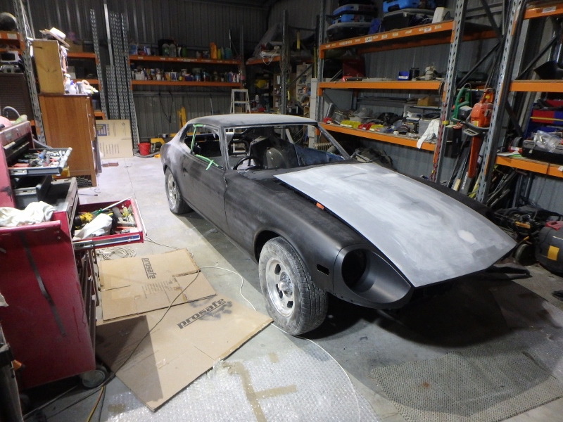

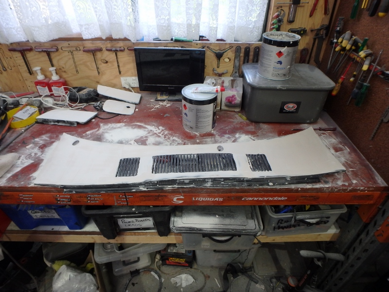

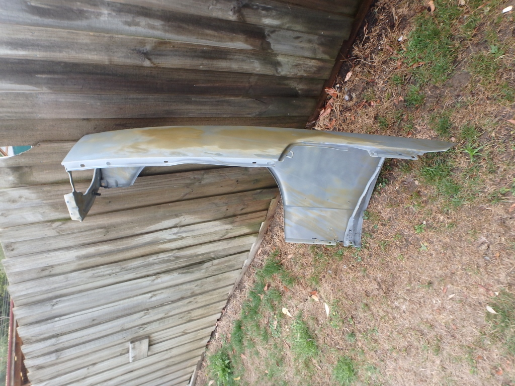

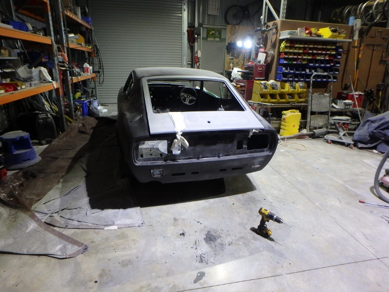

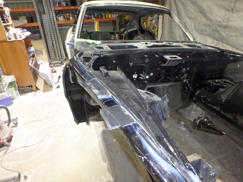

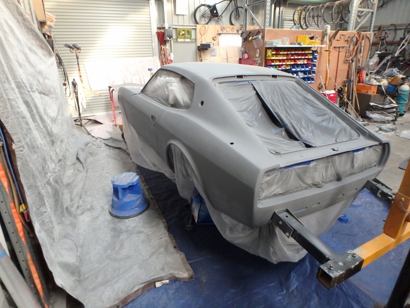

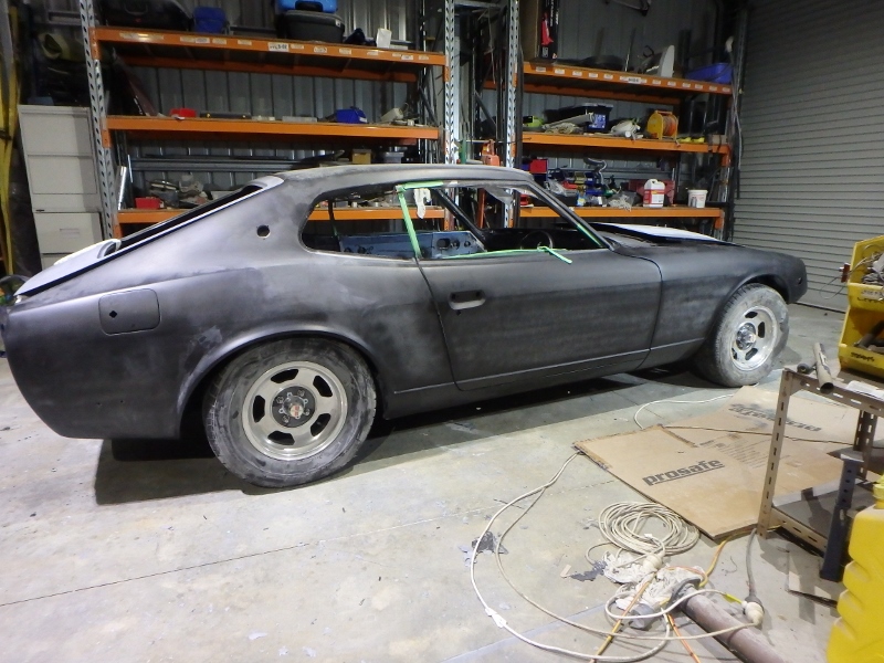

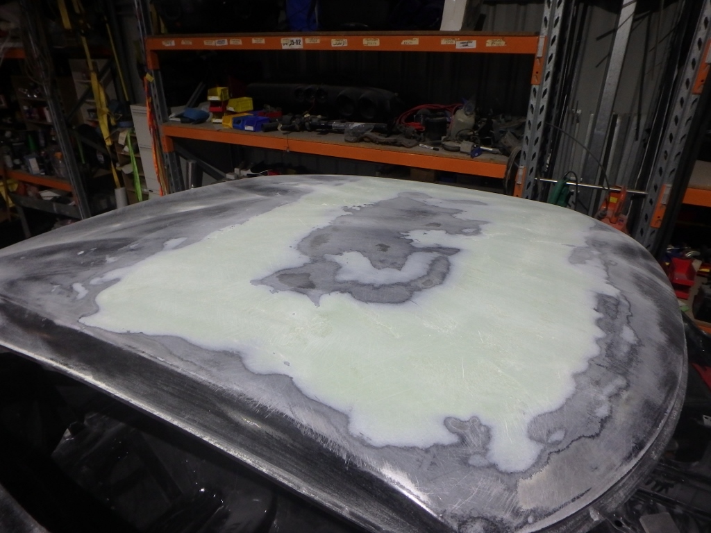

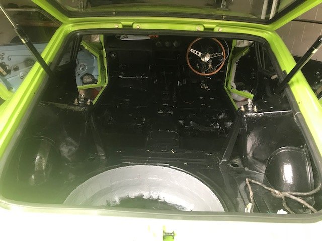

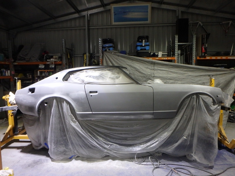

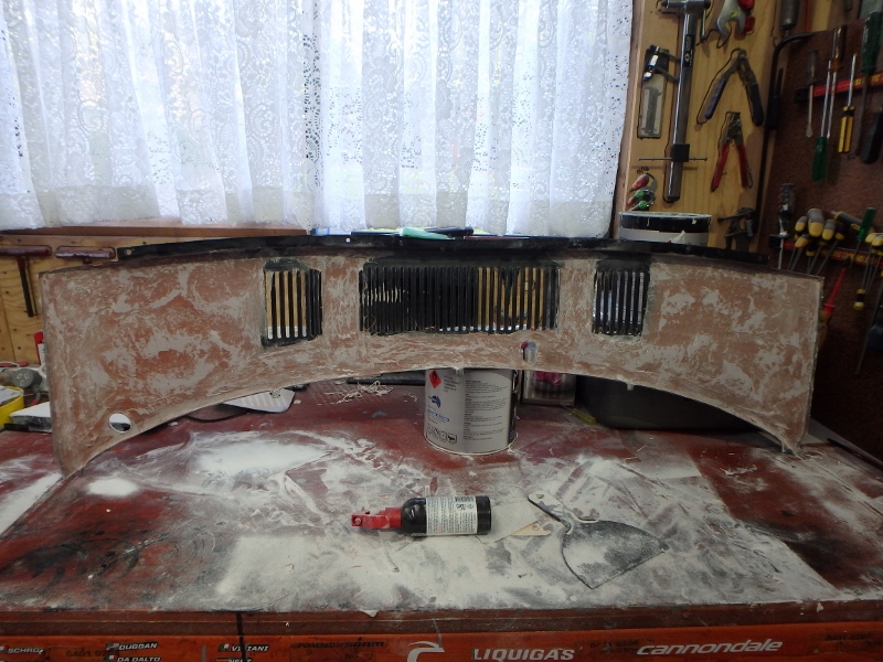

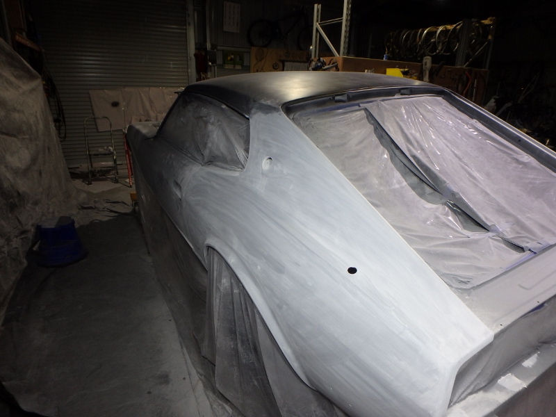

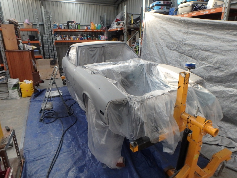

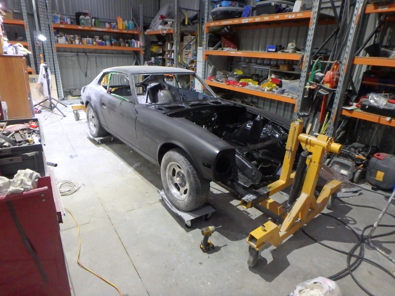

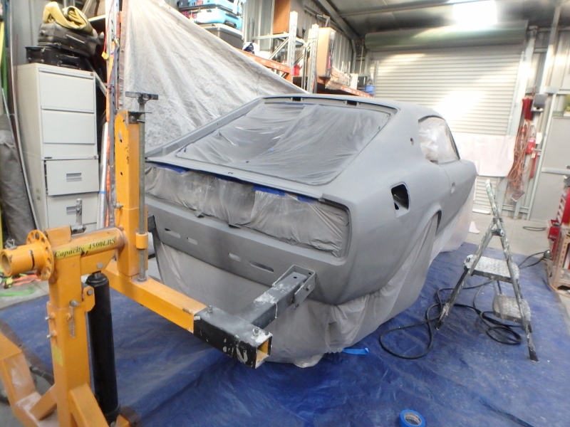

AK Posted December 19, 2016 Author Posted December 19, 2016 OK it been a while since my last post and to say the least - I have been busy – productive that's another discussion where you dont want to get the women involved if you know what I mean. Anyway what I have done since the last post : Finished the body work (say good bye to 100s of hours of painstaking work) · Got the bumpers back from being reconditioned · Picked up the incredible engine Re Build from Les Collins Racing · Picked up Re Built Gear Box from Les Collins Racing · Got the dif back from Les Collins Racing · Did the roof lining dark grey swede leather ( I did that my self) · Had the rear hatch and a new front Window refitted with new rubbers · Put in Dashboard · Put all the Suspension back in · Put the steering back in · Put the tail lights in · Bonnet back on · Fender mount mirrors in place · Some of the brakelines · Put the engine in · Put the Exhaust back on Combined this activity withthe selling the house and preperations for moving to the Sunshine Coast in Queensland – What can I say I am certifiably crazy Well it was very satisfying to finish the body work to a level that even the panel shop was ok with, in his professional opinion better than a lot of other panel shops would do. I have to say doing the body work was hard physically and it took about 5 times longer than expected and the 150 Square meter shed looked like a cocaine bunker by the time I finished white powder every where. No wonder it cost serious coin to get done properly I used a product called All U Need as spray filler for the final push to finish the body work off and it was really good, it got out the pinholes transition problems with different fill heights and to say it drys super hard with virtually no shrinkage would be absolutely correct. See some pictures below of the final push to finish all the body work - the every part of the car filled and block sanded to hopefully a near perfect finish. The front indicator corners and the stone tray where in poor shape thin and beaten up by the passage of time, these where massaged back into shape and Ii applied some fiber reinforced filler on the back, this gave the strength to hold shape better - I did the same with the grill under the windscreen. The Sublime Lime turned out awesome Finished the body work this was a massive undertaking for a newbie got say it physical taxing and the time it took was probably about 5 times longer than I thought it would take but if there was a hmd 1 Quote

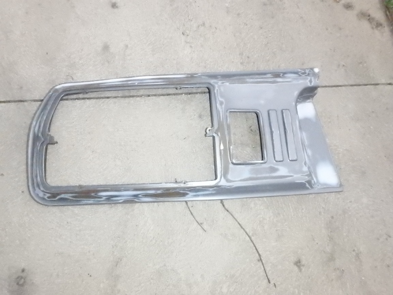

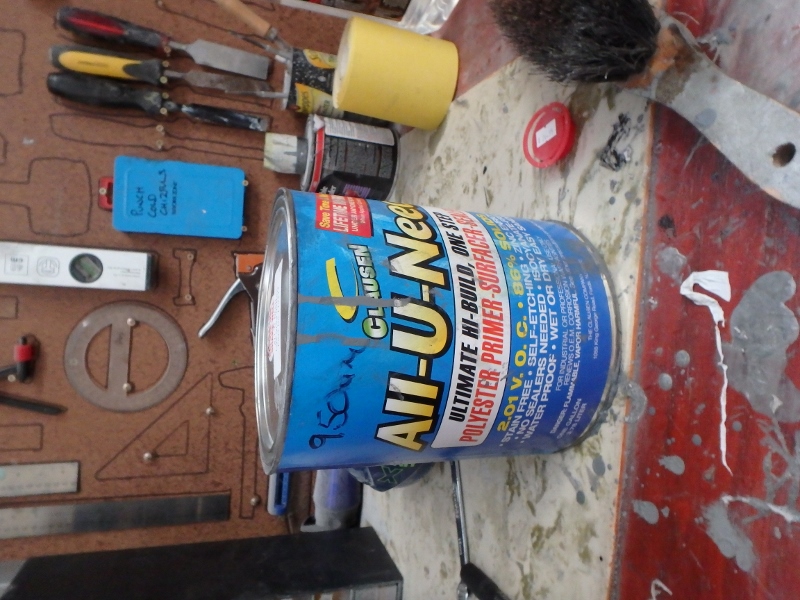

AK Posted December 19, 2016 Author Posted December 19, 2016 Back again Check out the All U Need Can Some more pics of the All U Need applied and then block sanded back to a 320 grit paper then Black Primer to seal it in a few places where the All U Need was thinned out from the blocking process of taking out the high and lows. Quote

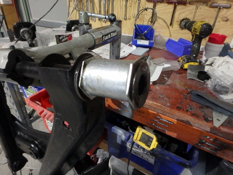

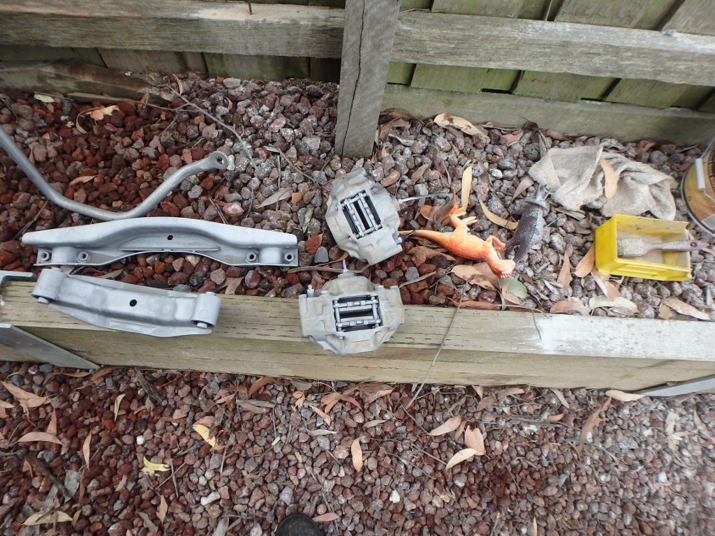

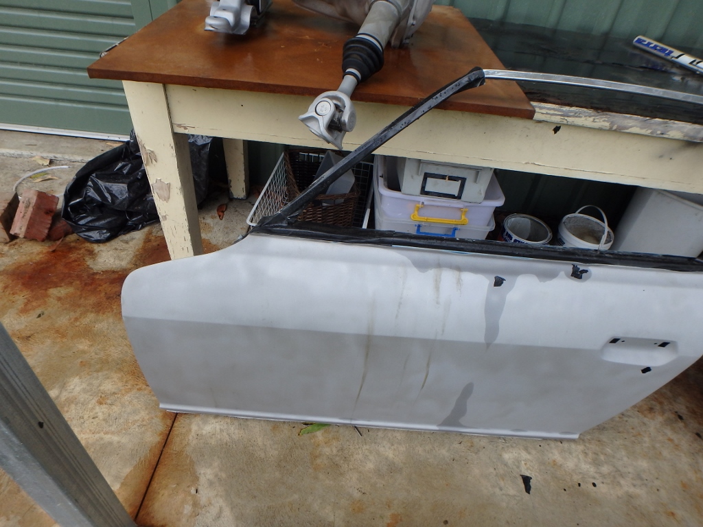

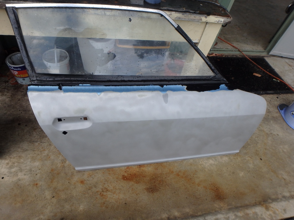

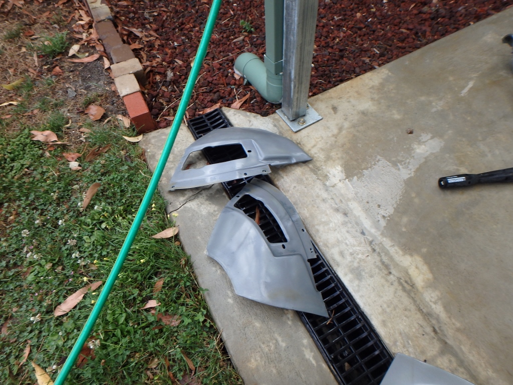

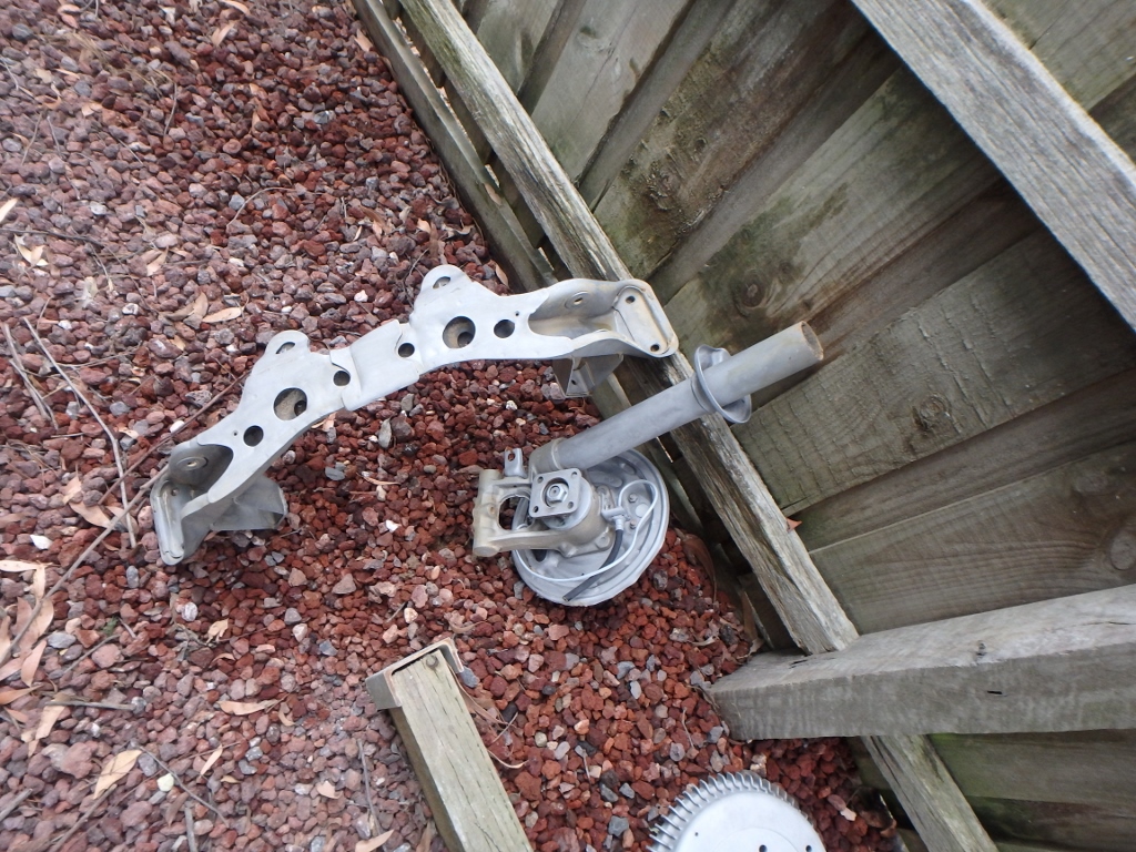

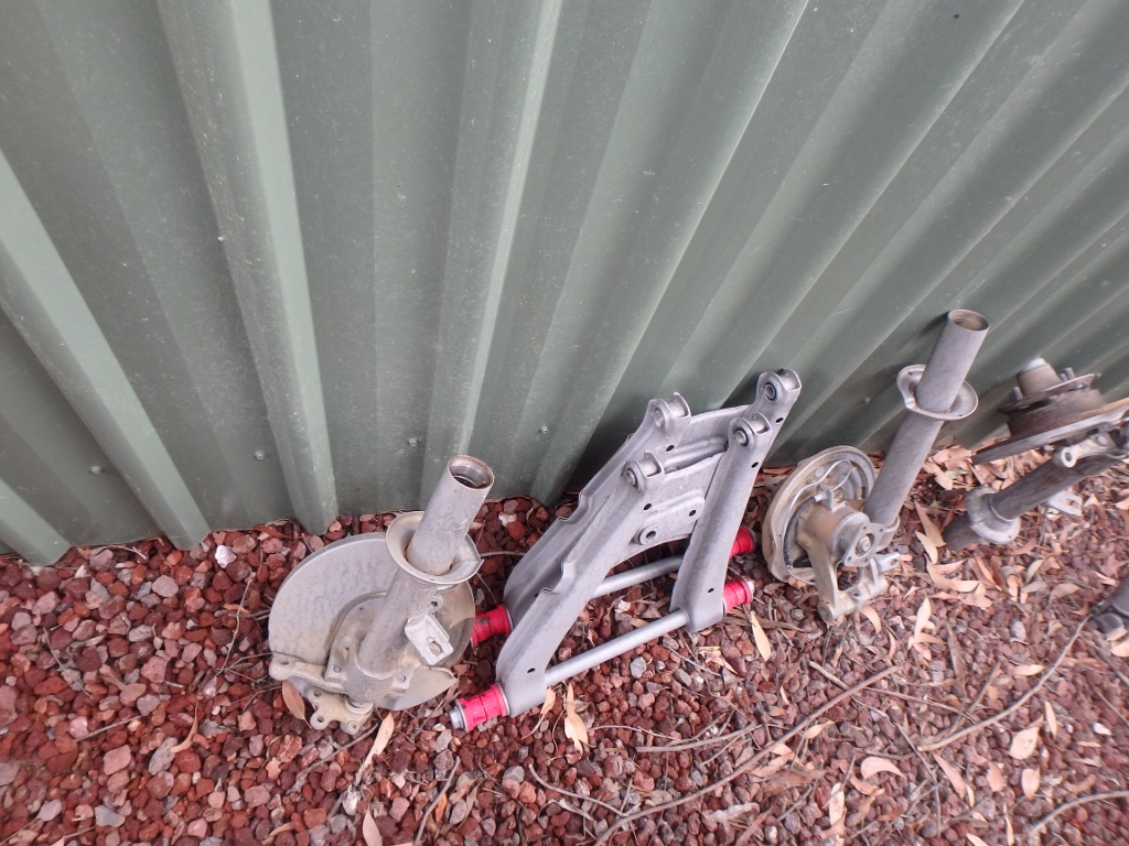

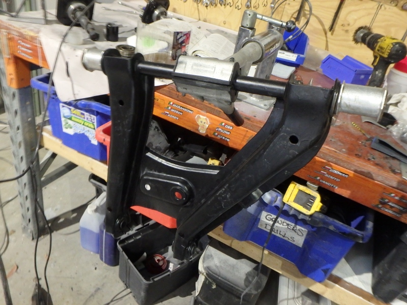

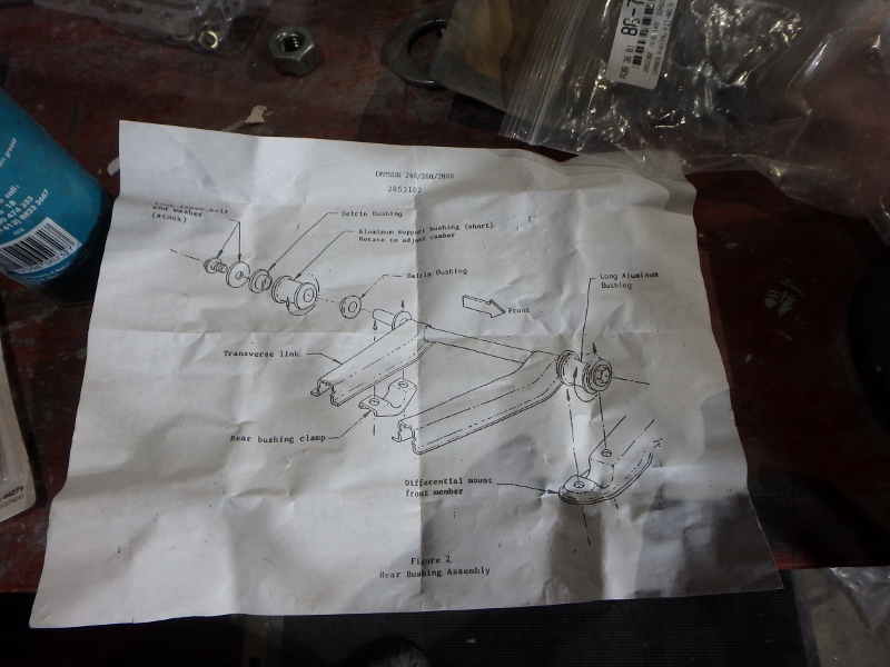

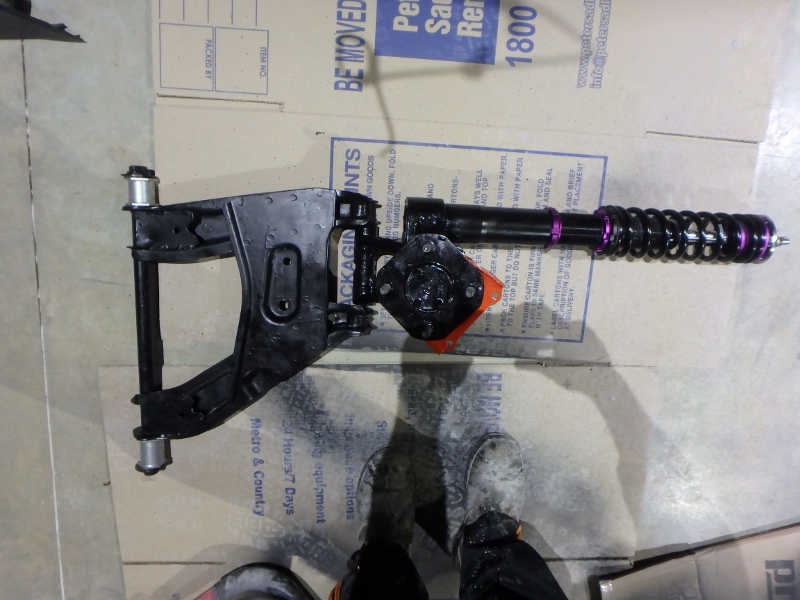

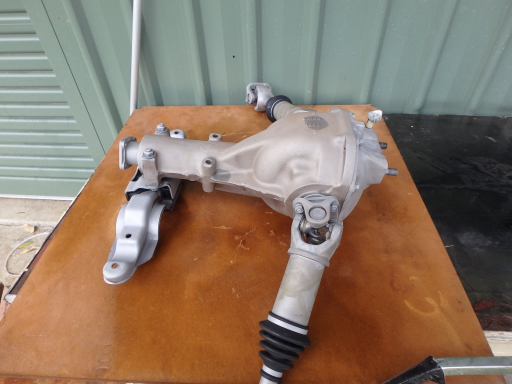

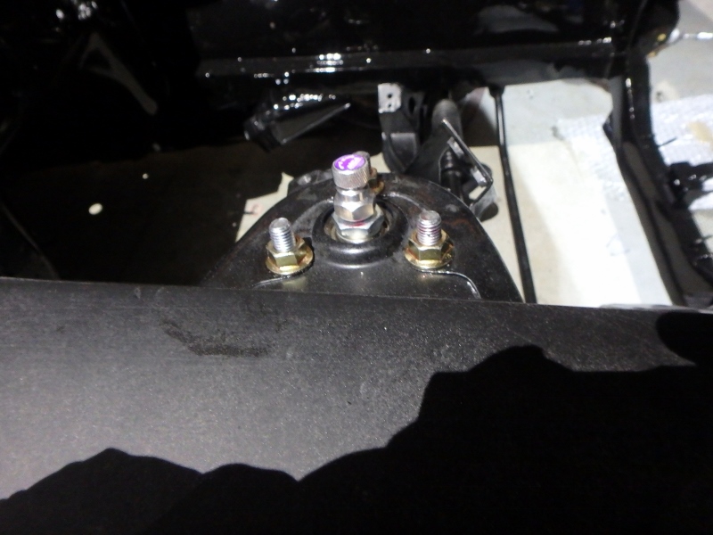

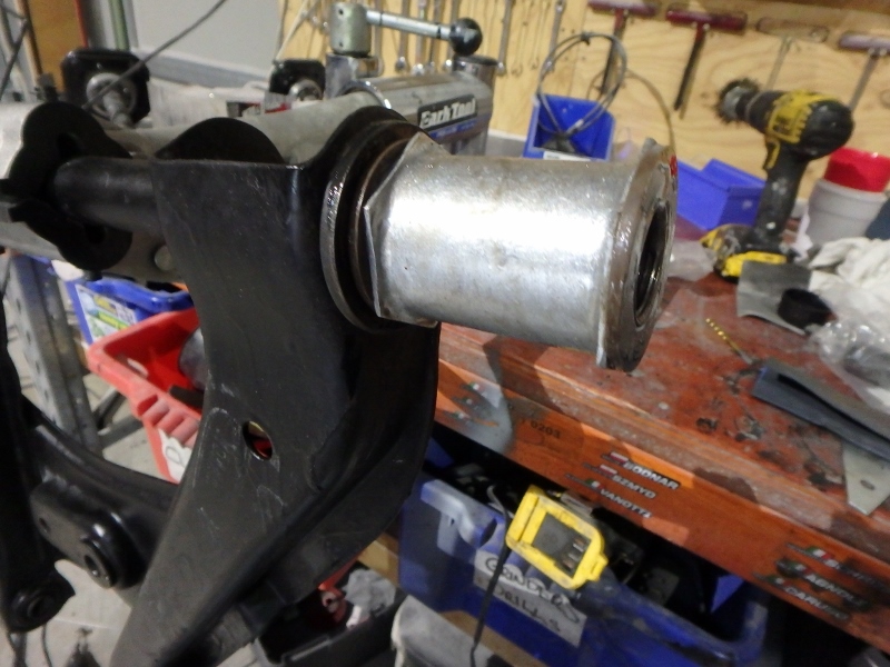

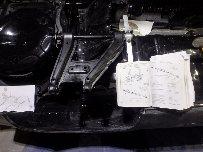

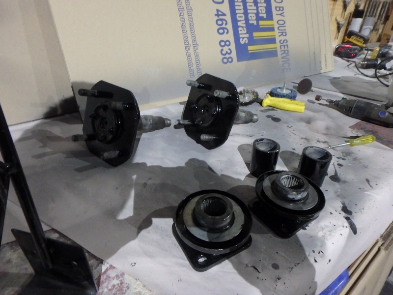

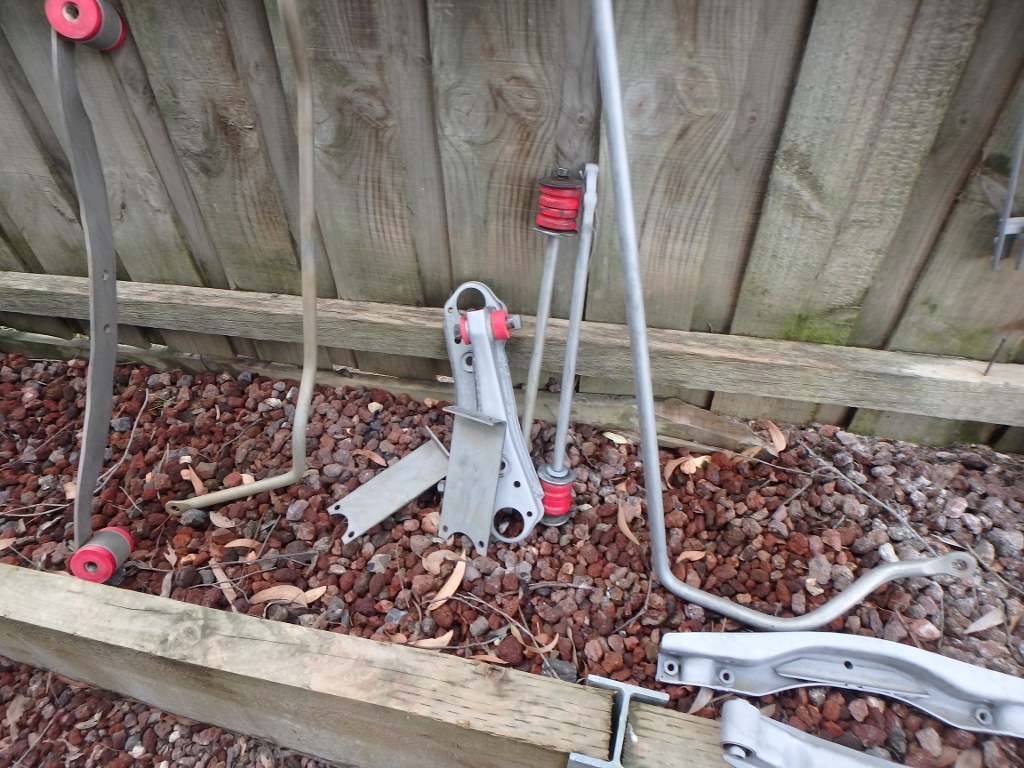

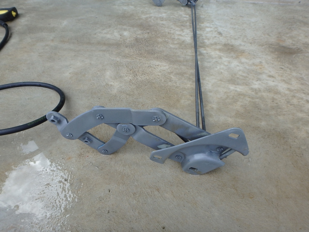

AK Posted December 19, 2016 Author Posted December 19, 2016 More pics of starting to put the suspension back and some more pics of the body prep before the professional spray job, fitted some adjustable camber adjustment to the pivot locations on front and rear so hopefully when it lowered that a proper set up can be achieved. Rear Axel Stubs refurbished and painted with KBS paint Fitting the Bushings for adjustable camber I broke a vice in this process fun and games and a lot more swearing it a second language sweararific. Which way does the swing arm fit - this way I had to make up plate as the diff assembly was still LCR getting done and I needed to get her on wheels so it could get sprayed . Sealing the car with black primer after the high-fill all you need Fitted the MCA Suspension - Mean AS!! - The adjustment caps where to high so for us Zeders you have to remove them put in the glove box and put back on to do the adjustment not to hard to do no big deal the car is super low now - you dont run the rubber mounting blocks at all with these shocks in and it makes a huge difference to the ride height. Can wait to try out seems like not body roll at all, I push on the cars roof line sideways with max force and does not move at all. Some more pic of paint work before the Sublime Lime goes on Dionysus and Groundhog 2 Quote

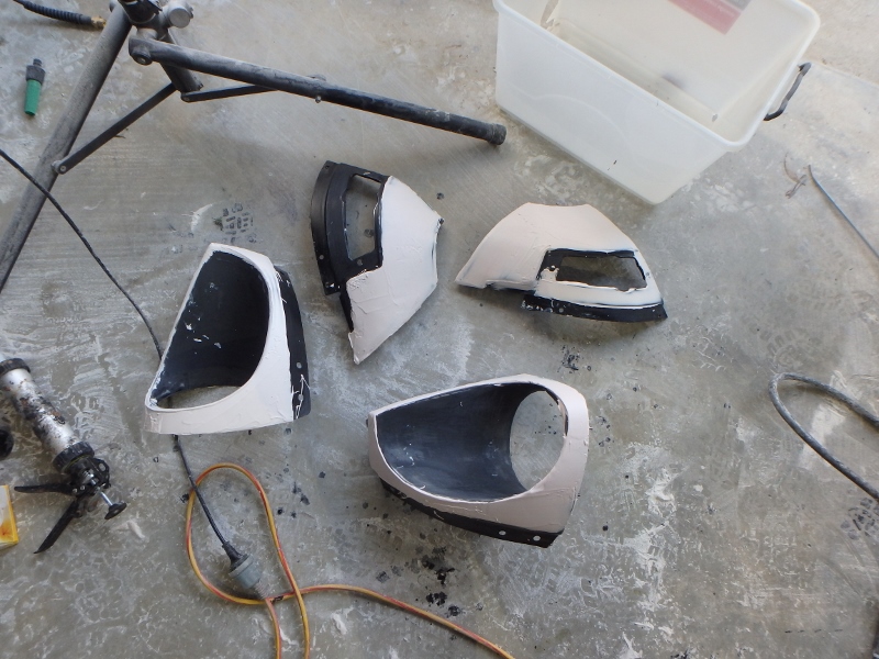

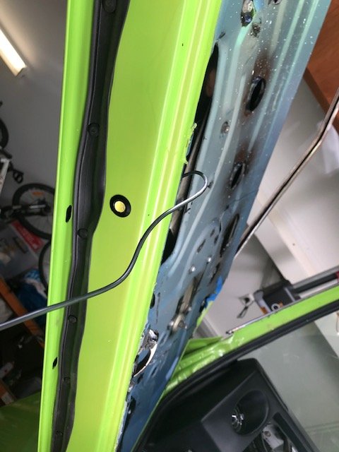

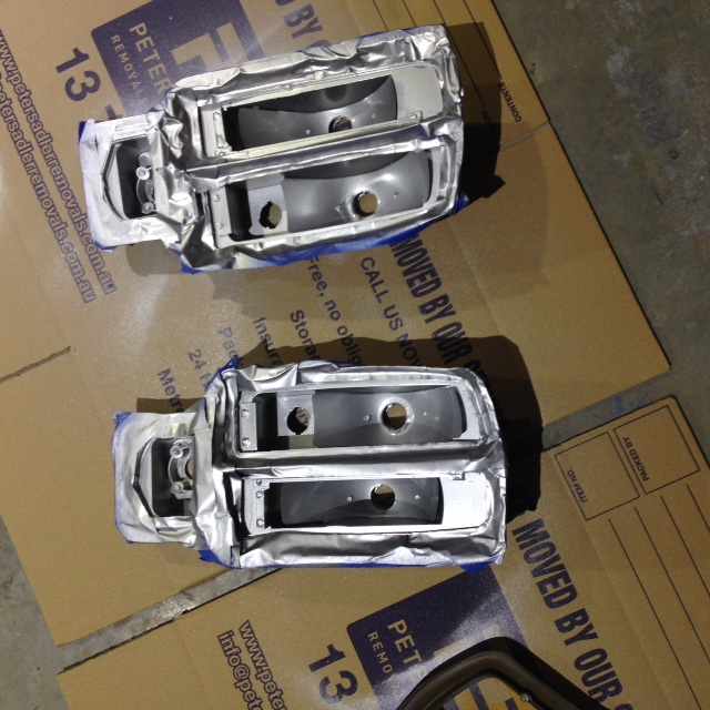

AK Posted December 19, 2016 Author Posted December 19, 2016 Re- Fresh on the Tail Lights I did this while the car was getting the coat of Sublime Lime at the spray painters. I went away from the stock silver colour for the outer assembly and went to satin black, which turned out great good contrast against the bright green and it made the tail lights pop – stand out . I polished up what was left of the chrome, pulled the whole assembly apart, polished the coloured lenses with a Maguires headlight polish for plastics . If you are going to hand spray parts with spray cans the UPOL Spray Cans are really good the size and power of the spray pattern is like a small professional gun and much better than anything else by a long stretch. The original white silicon/sealant that held the indicator and stop light lenses to the backing plate/lens assembly was really hard to get out.I used a thin vibrating tool attachment that was the only thing that really worked and it was a long process. I resprayed the inside backing lens in a metallic silver after a plastic primer was used first., Silicone the lenses back into place, there are some small round hoops spaced around the backing of the lens assembly and these are used to hold the chrome surrounds in place screwing through from the back . These small hoops in my case where fractured and thin so I got a super strong plastic glue and glued in the right size metal washers , with ample amounts of glue to reinforced the areas and then finish them up with a small Dremil attachment to sculpt back to shape that didn’t interfere with fitment of the parts. Anyway long fiddly process but in the case of 260 2+2 there are not may parts around here and I like the look of the 260 2+2 lights more than the other models so the end result was great. LED Light assembly’s with be fitted once I have all the wiring back in place this with give brighter more intense colour for the Orange and Rred and the White reverse lights blu260z and AndBir 2 Quote

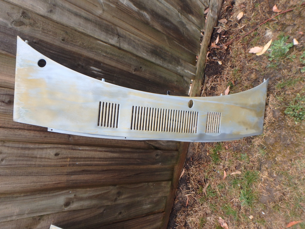

AK Posted October 25, 2017 Author Posted October 25, 2017 Hi Guys Its been a while and I have been settling into the new digs in the sunshine coast QLD - life is tuff! But I can tell you the wifes Honey Do list has been TUFF and long and never ending since moving - residential paradise comes at a cost! Anyway work on the Z starts again finding all the parts and opening boxes whats this where does that #$%!! part go? MY GOD my hair should be falling out but no rush - got time now - want to get done pretty right. FRESH CHROME - Finally shoe-horned some 260z badges a lot harder to get hold of than those common 240 badges ha ha ha , The Dato Deck Badge and The Tail Light surrounds all got fresh Chrome. KICK ASS NOW - couldn't face putting on the tarnished ones back into service. $630.00 all up quality of work seems good Chrome Tech Unit 40, 5 Anella Ave Castle Hill NSW 2154 T: 02 9899 9122 F: 02 9899 1622 M: 0412 255 666 E: info@bronzingstudio.com.au & info@chrometech.com.au Quote

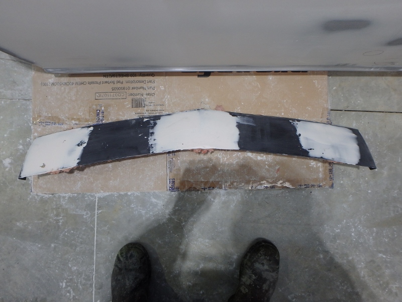

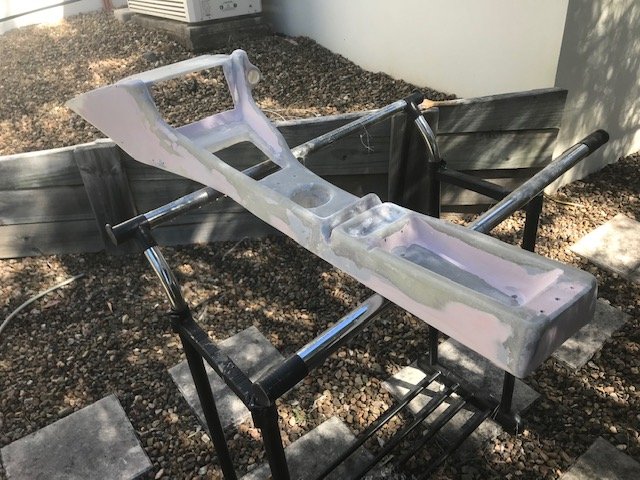

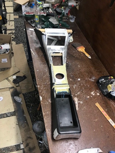

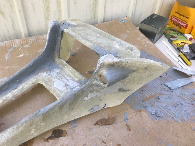

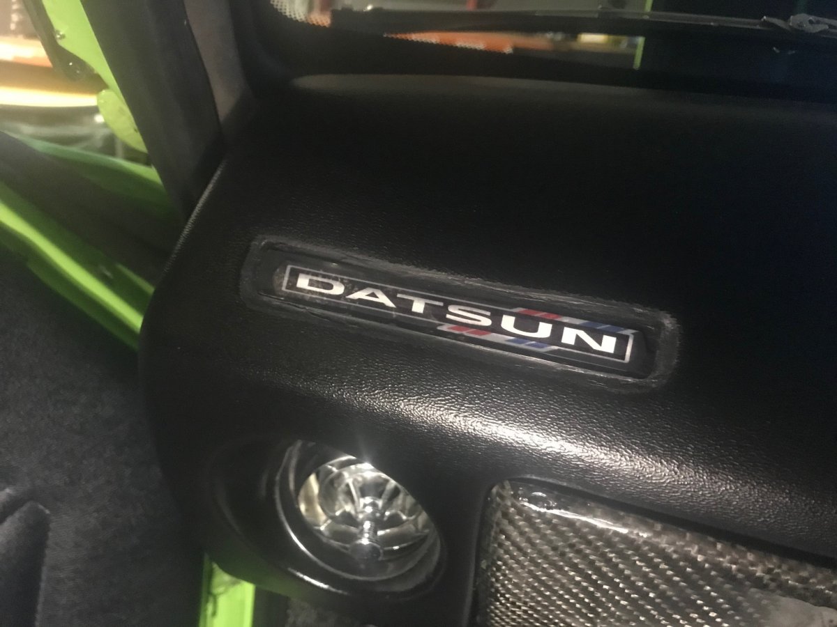

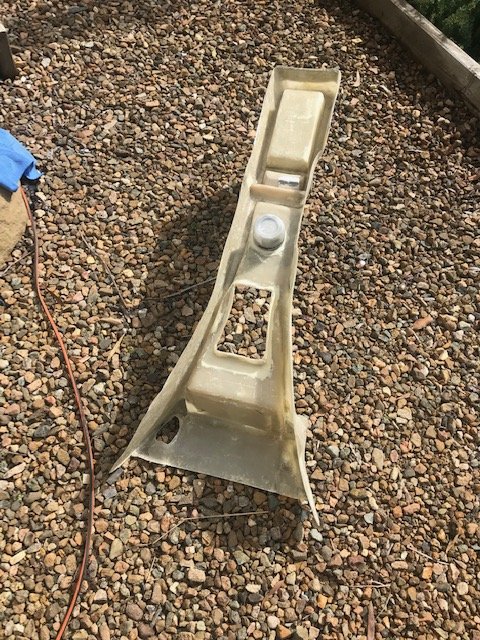

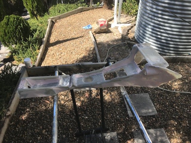

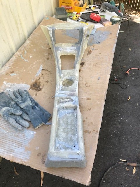

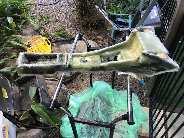

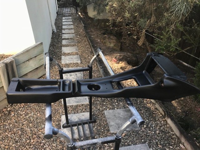

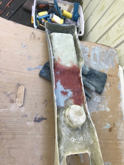

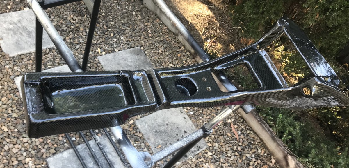

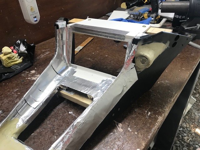

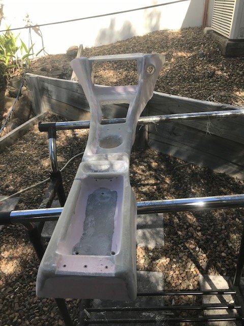

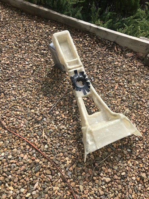

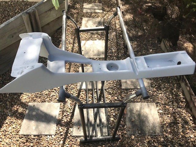

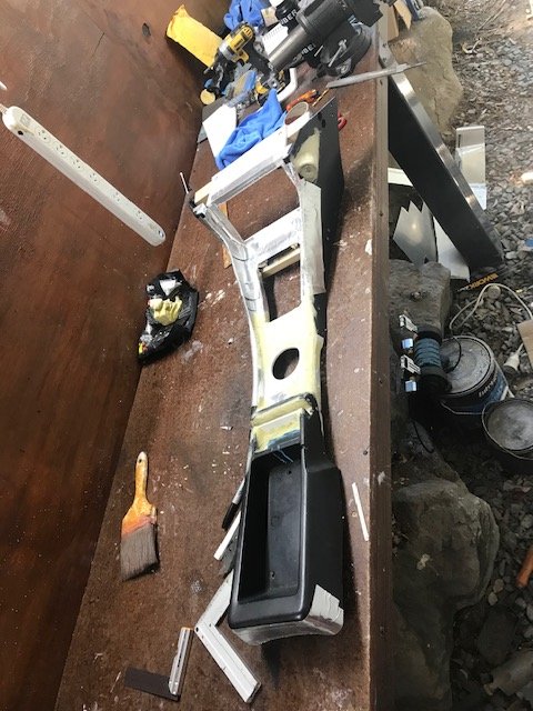

AK Posted June 19, 2020 Author Posted June 19, 2020 Yes i AM still here even COVID could kill me !!!!– Its been a while – still got some sanity but the last 15% of the build is TOUGH - REALLY TOUGH - putting together all the different layers of the build into its final configuration you find out what’s lost what’s broken - then seeing if you can buy a replacement second hand, new or what you will have to re-fabricate??, it is complex and time consuming and frustrating and then you get the layers wrong and have to re-do work needlessly. Lots of workshop manual checking – lots of reference photos checking and then still not finding all the answers, surfing the net for answers – its fun - really fun! This was bit of project!- if you thought the fuel tank saga was long this may of be 3-5 times longer - the centre console was cactus – cracked warped discoloured – I also wanted to fit in a double din stereo and drink holder – we are civilized now and we sit in traffic! Don’t forget a Mobile Phone holder and USB charging enabled! They old console was not going to hold up to patching and such radical modifications, I should of and I will say this again and again and again – DO NOT TRY TO DO THIS - buy a complete one out of the states in Carbon fibre it might not be the design and spec you want but the time it took to create was staggering. So I knew what I wanted so used Aluminium tape and a Dremel with a circular cutting saw and modified the shape of the old console, I dropped the floor of the console to make room for the double din stereo, spread the sides, then cut a slot for the phone, filled in the slide back hidehole and put in a drink holder, relocated the HAZARD Light switch to the side of the console moved the demister switch. Reshaped the rear open tray so it had change tray and dedicated flip-top arm rest. Deleted that ugly ashtray in the back and make the whole thing slightly wider and about 100 times stronger. How do you do that ! Well start cutting sections of the original ABS plastic console and allowing the cut parts to hinge-out to where you want them – little bit of heat shaping as well with a heat gun, then holding then newly formed shape by using adhesive aluminium tape - amazing stuff. I had a big roll of the stuff given to me by my legendary grandfather who taught me plenty. Then smoothing and shaping with plasticine for the final exterior shape – I guess it’s a little like doing second generation modern upgrade to car body design. If you are feeling tired and distracted at this point and can’t read any more, completely understandable and if you are not - you have a sickness and should check yourself into the loony bin right now. Next part is making a fiberglass mould of the whole thing – I hate fibre glass it is god awful stuff - you can do amazing things with it but the mess the skin piercing itchy fibres are like a disease! Even with lots of wax applied to the inside of the mould before the application of the inner moulding process it still was really impossible to pull-out the moulded blank without killing the outer mould – lots of time, lots of swearing I apologize to the anyone who might have been earshot - I think I am black listed by the whole street now and they haven’t even herd the rumble of the DATO yet .. And that’s just the start ! of making the console - now lots of sanding filling and more detailed shaping of the inner blank, then reinforcing of the design. Putting the phone slot is cool but it weakens the design structure, drink holder is cool and refreshing idea but the parameters to get it to fit in the sunken slot in the transmission tunnel - just in the right location is close to impossible. Now the finish – a genuine Carbon Fibre 3000k finish/laminate – seemed like a good idea, but ideas are dangerous, especially in the hands of mad man. I got it to work, but not perfect – but pretty good – was it worth the time and angst ummm NO NO NO. You adhere and layer the Carbon fibre material to the outer surface of the console by using a carbon fibre two pack clear resin, first step is applying a layer of this stuff to the whole console and waiting for it to go-off to tacky then lay on the carbon fibre material and stick it down with out getting wrinkles or distorting the materials fibres as they fray apart under pressure when you ask to much of it. Is this difficult, YES very if you had a flat or simple structure not to bad but the console is complex shape and you are really pushing the limits of what is possible doing it free hand this way with a complex shape , you do have too cut paste some sections to get work and overlap in a way that it is not too noticeable with change in material direction/application. The best way would be really to vacuum pack it and compress everything down too smooth it out and remove the excess resin – I wasn’t comfortable with going that way seemed to be less control potentially and I didn’t want to buy the special vacuum ect and I was more comfortable with this free hand way. Once you have a nice smooth uniform coverage you then apply the two pack resin too the outside of the Carbon Fibre about 3 layers – I used the WEST brand , works pretty good Then more sanding and one day you finish. Don’t do it. CBR Jeff, AndBir and ScottyD 3 Quote

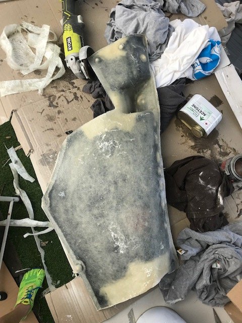

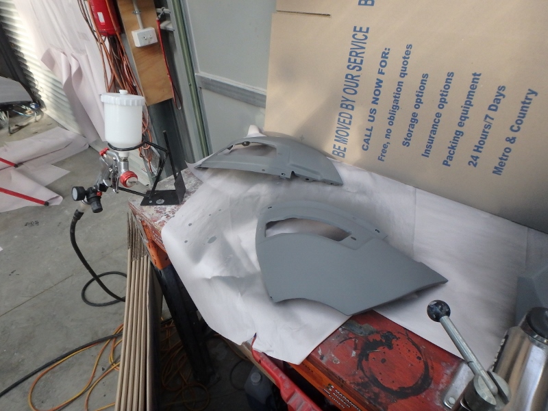

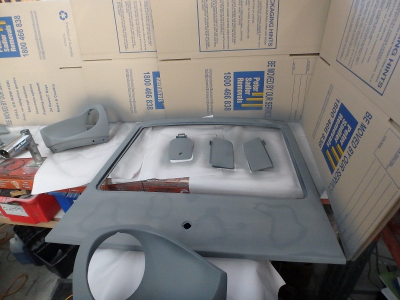

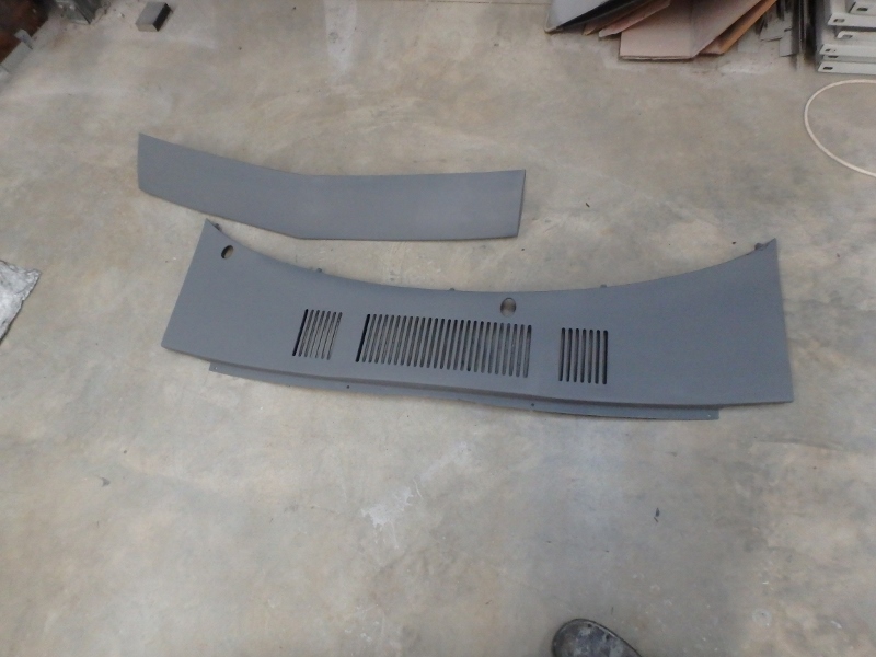

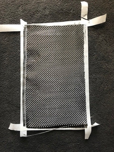

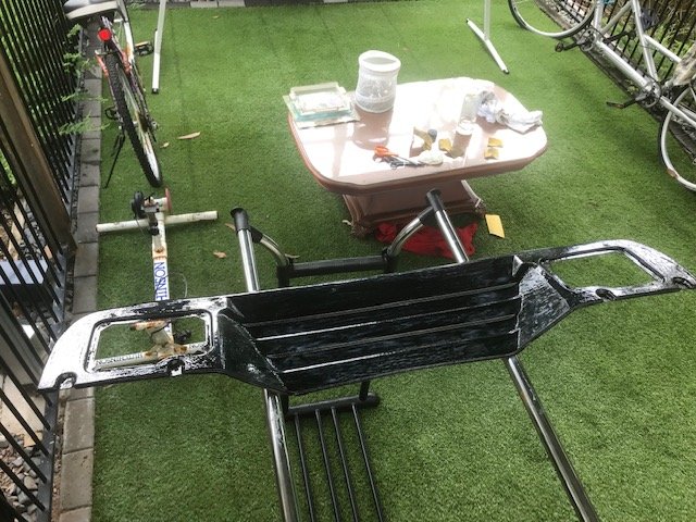

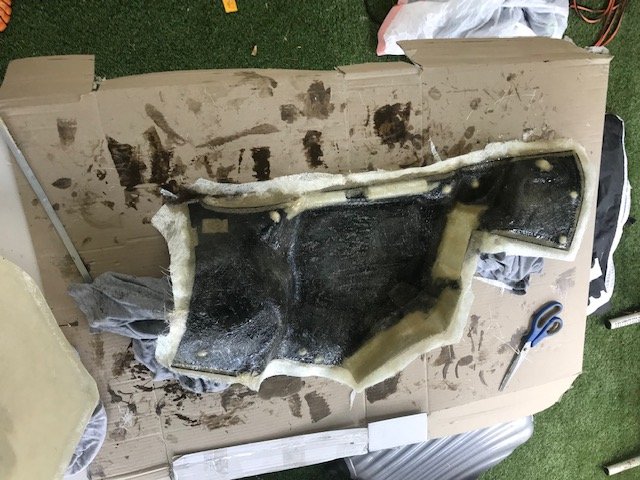

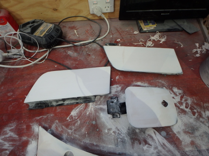

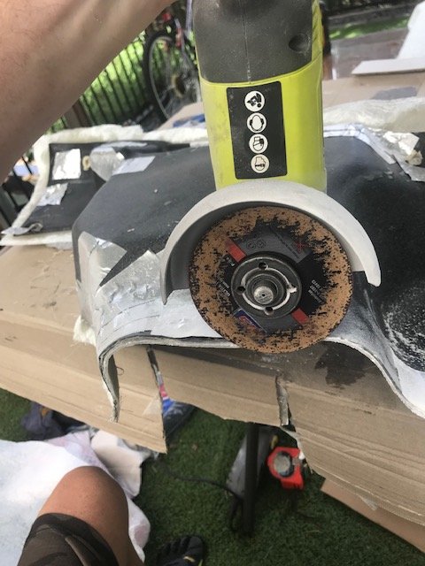

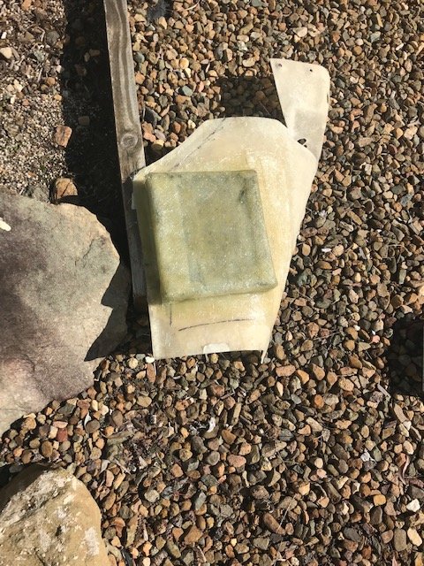

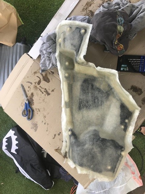

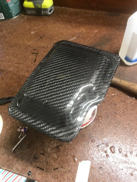

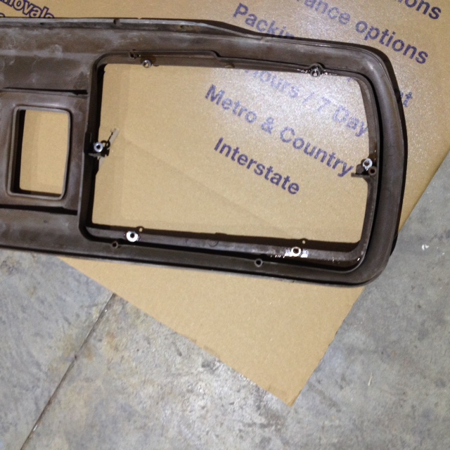

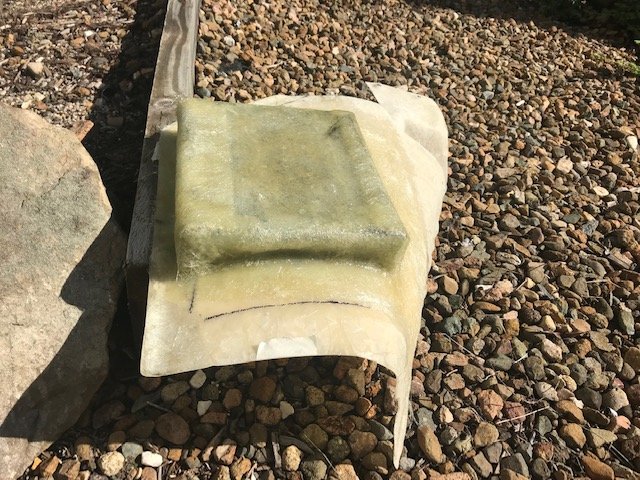

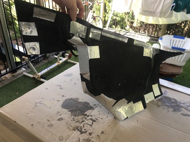

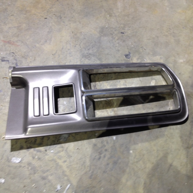

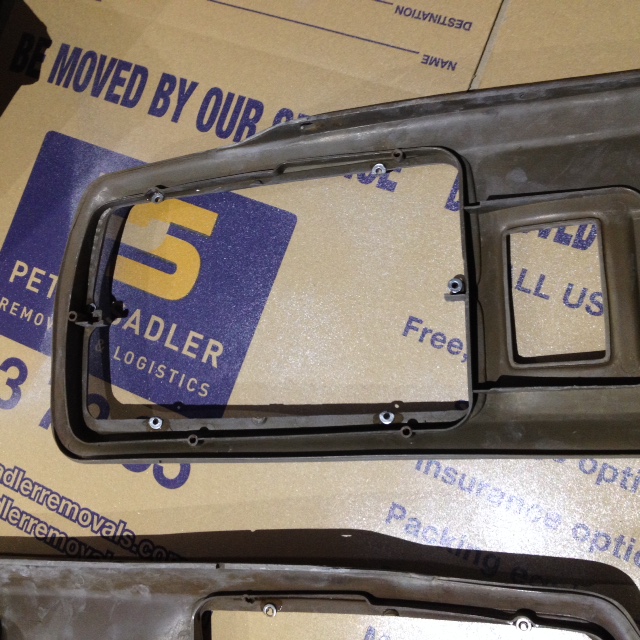

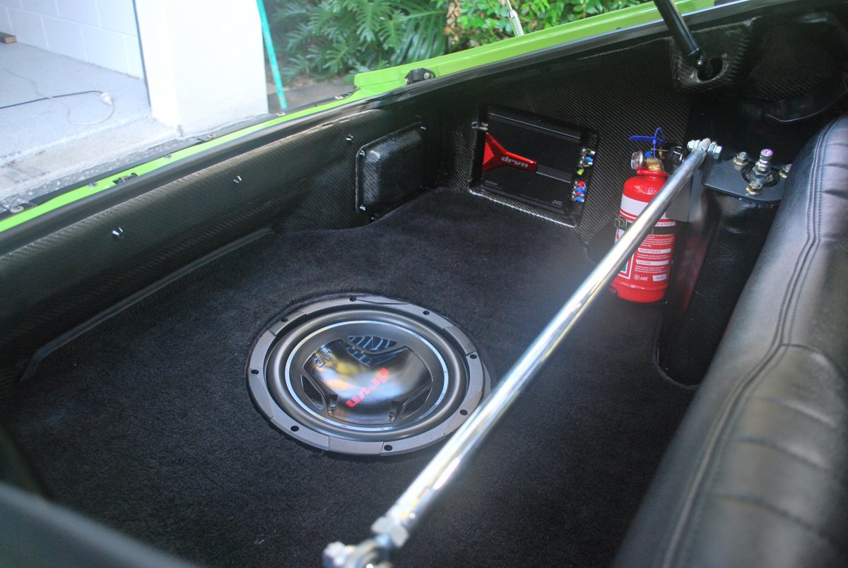

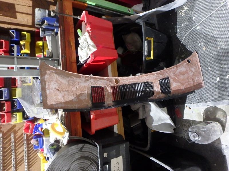

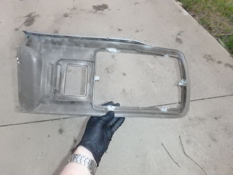

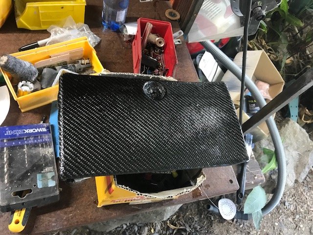

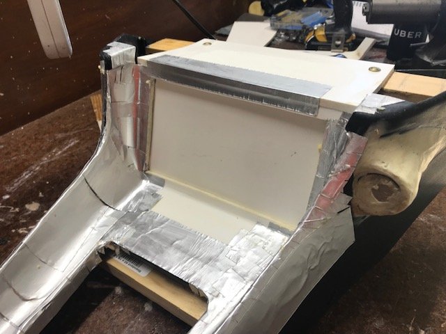

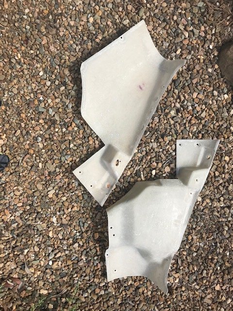

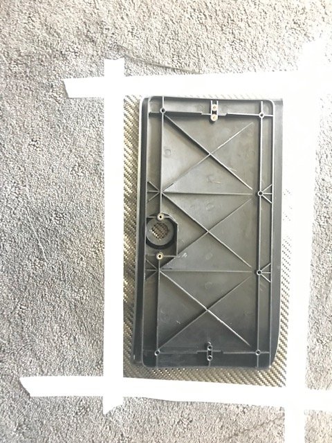

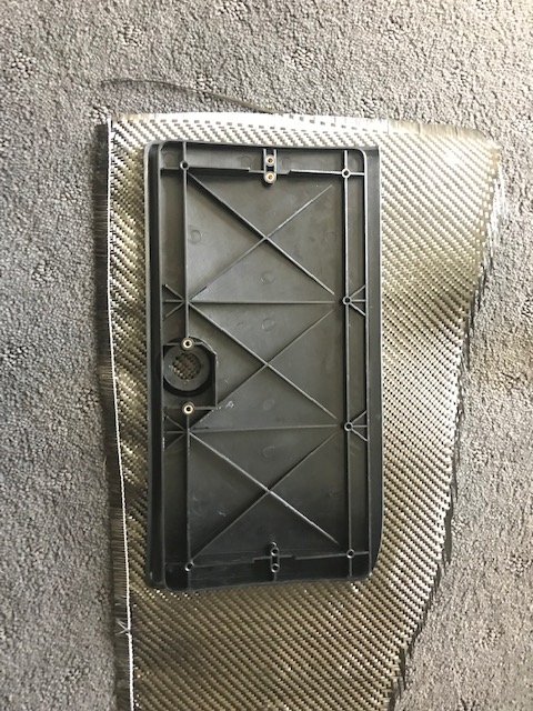

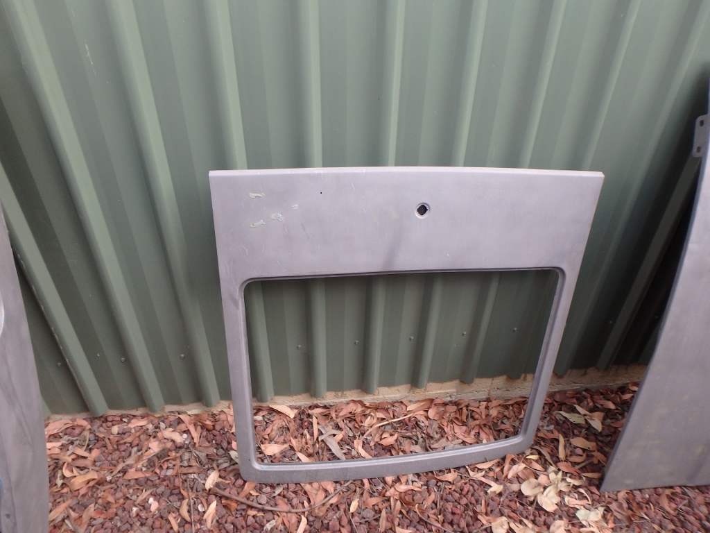

AK Posted June 20, 2020 Author Posted June 20, 2020 If that wasn’t enough I also did the rear inside hatch panels and the tail light covers and internal panel – yes I am really crazy. All these panels were even more stuffed than console and pretty unobtainable, well my car didn’t come with them all - so then I sourced some second hand they were nasty but it gave me something to work with so - no choice really. With inner panel on the aerial side I also incorporated a depression for the stereo amp to sit in – I also elected to take out the spare wheel and make into bass box – got love bass. Made a fibre glass mould of the spare wheel hole and then glued this to round MDF cover wasn’t to hard actually. Just going to have use tyre plugs and Slime Tyre Sealant and electric compressor on board if I get flat. Also did Carbon Kevlar door skin on the Glove Box and added a kick Ass surface mount LED Light that has some serious illumination. The Dashboard above the glove box has a rectangle slot for a Datsun logo to go into it – could not source one so I made one: Step One made Plasticine mould of the slot, then covered with surround wrap then did a mould of that with Plasticine and the pulled that of with some distortion and the reshaped to near the same as the slot in the dashboard - took some Vernier measurements to get exact as possible to the original slot, bought a Datsun vector on line in the style I wanted and then reformatted the size I wanted print off on photographic paper with a ink Jet Printer then sealed in a laminated plastic. Then uses a clear epoxy stuff to fill the mould, half fill then lay the logo on top the fill the last half and then wait for the whole thing to dry then polish and sand to fit the slot – Hmmm good use of time probably not – but its done! What else – Umm put in Door Still lights that are LED open the door shine straight down illuminate the area under the door so you don’t step in puddles or ding a door. CBR Jeff 1 Quote
