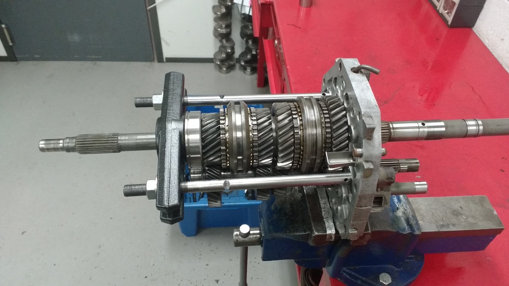

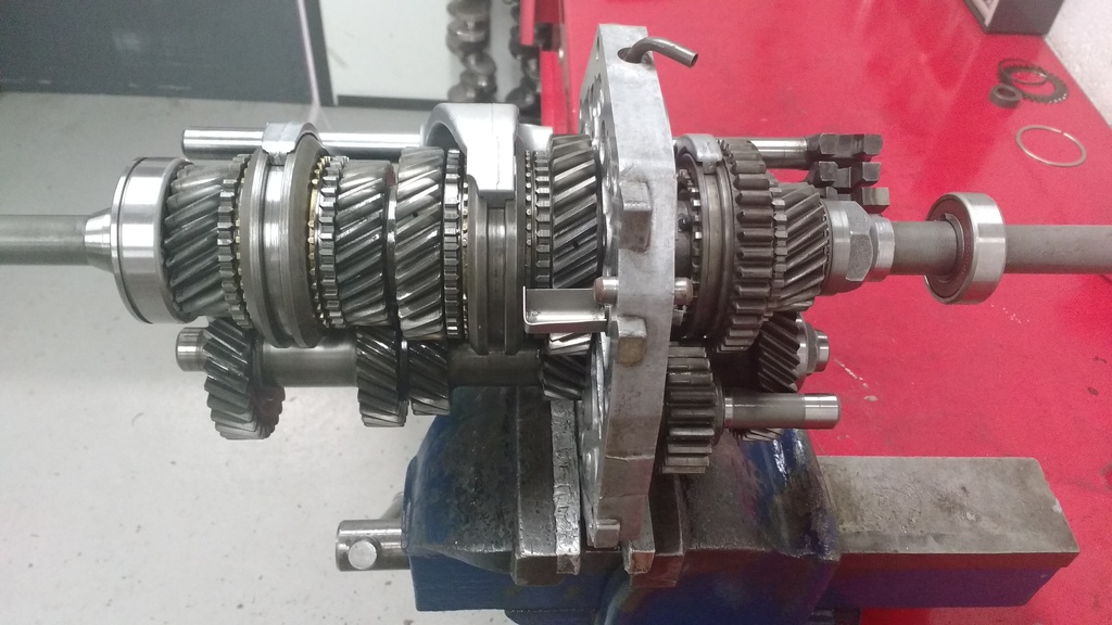

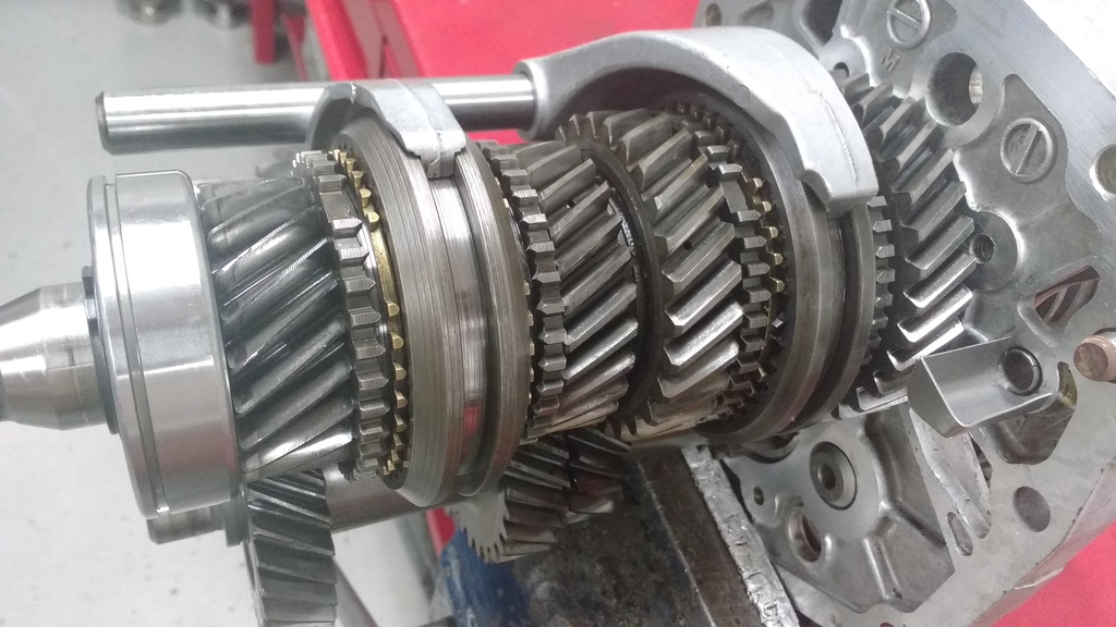

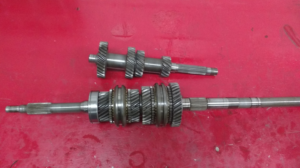

C.A.R. Posted March 14, 2017 Posted March 14, 2017 So, with this Zed having the eariler floor-pan (vertical fastening gearbox cross-member & more rearward shifter hole), there was a discussion to be made: Convert it back to 71A (eww) or use a 71C long box as a donor. With the 71C being the better choice, I procured an R31 Pintara gearbox off Les Collins which will bring the shifter out in the correct spot in the tunnel. It's also a 'narrow gear' 71C gearbox with brass syncros, which means I can install the 260Z gear ratios into it - which are closer together. I pulled the Pintara box apart over the long weekend, which also involved cutting the gears & pressing the dog rings off. All the parts were washed, the dog rings pressed onto the 260Z gears & I started reassembly. Alum. Sandwich plate - washed & new bearings installed. 260Z gears - 1st, 2nd, 3rd & 4th reassembled onto the Pintara mainshaft with the 260Z countershaft cluster above it: All the parts out of the Pintara box were in very good condition. I 'could' have changed the syncro rings on 2nd & 3rd as they were getting close to to bottom tolerance, but for the amount of work this gearbox is going to do, I decided to leave them. New ones are a few weeks ex japan anyway... Installing the mainshaft & cluster into the sandwich plate: A problem I encountered: The rear countershaft spacer from the Pintara box has a bigger ID than the 260Z countershaft tail - it would float around on the shaft like a dick in a shirt sleeve, so as I needed the required thinkness to be retained to correctly space the Rev & 5th gears on the C/S, I grabbed some 4140 bar stock & jumped on the lathe & make a suitable spacer with the correct length & correct ID. L to R The Pintara spacer, the new one, thin 260Z spacer. And finally the core assembled: Now I'm just waiting on a small hardend washer to arrive for the front of the C/S, then I can install the core into the Hydra-Jet blasted cases. TBC... scott, Ponyo240z and gav240z 3 Quote

Administrators gav240z Posted March 17, 2017 Author Administrators Posted March 17, 2017 Sad thing is, I'm only keeping 1st, 2nd & 3rd gears & the counter-shaft from the 260Z box - the rest isn't used. Everything else will be 280ZX... 260Z gears - 1st, 2nd, 3rd & 4th reassembled onto the Pintara mainshaft with the 260Z countershaft cluster above it: So what ratio's are in the box now? Originally you were going to use the 4th gear out of the 280zx box (but it turns out it was a 240K box). So I am assuming you kept 4th out of the 260z box and went with 5th from the Pintara is that correct? Quote
C.A.R. Posted March 17, 2017 Posted March 17, 2017 (edited) 4th gear in both box's is 1:1, so I did something tricky & used the Pintara input shaft & swapped the 4th gear C/S gear over - the Pintara one is now on the 260Z C/S cluster.The reason: the Pintara 4th gears are a newer design & run more quietly in in 4th Both sets of overdrive gears are the same ratio too. Edited March 17, 2017 by Lurch ™ gav240z 1 Quote
