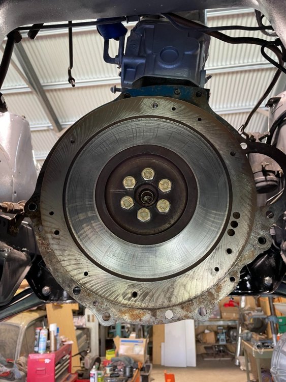

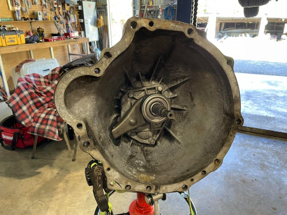

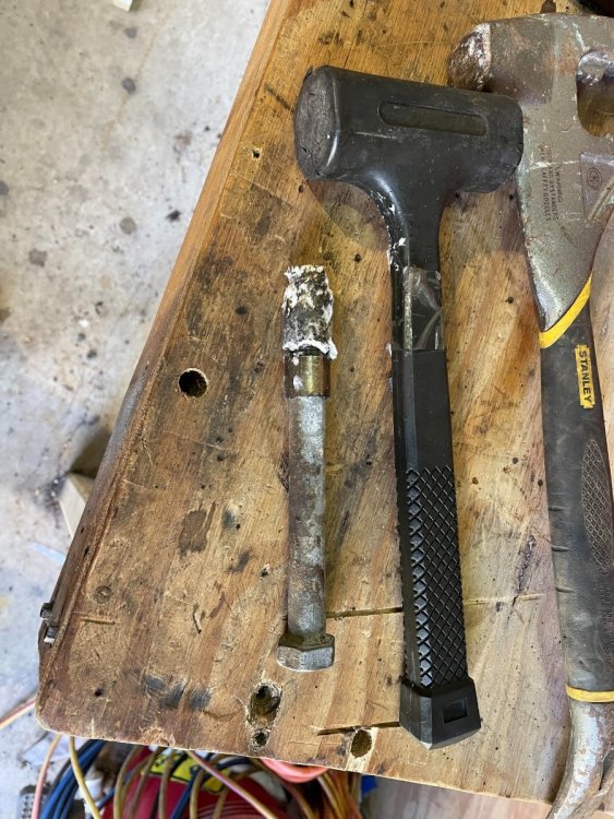

77260Z Posted September 12, 2021 Author Posted September 12, 2021 I got to spend a bit more time on the Zed recently and made some more progress. I dropped the gearbox and pulled the clutch. I'd actually ordered a new clutch but the engine had a fairly new Exedy clutch fitted so I decided to refit the Exedy one. The kit came with a new throwout bearing and spigot bushing so I changed the throwout bearing on the clutch fork and replaced the spigot bush while I had access. I didn't have a bush puller so I used a little trick that I read on a Skyline forum to remove this - essentially the same as the grease trick however using wet toilet paper instead. I was a little dubious at first (sounds like a classic stitch up) but it actually worked a treat. It had the added bonus that the TP collected a lot of the extra grease in the cavity and was much nicer to clean up. So at this point I had everything ready to put the entire driveline back together, which felt like another big step towards getting this thing back on the road. Clutch and gearbox went back together surprisingly easily. The only slightly tricky part was the rear driveshaft bolts where there isn't much access room above the rear swaybar. The focus was then on the engine and getting this built up and ready to go. I made some good progress and got the following done: front main seal replaced and air conditioning main pulley installed new water pump installed new thermostat housing, thermostat and temperature sensor installed headers installed (waiting on new studs & hardware to finish this install) alternator installed starter motor installed And finally, after most of the major engine work was done, the bonnet, front fenders, headlight buckets and cowl panel were installed. It's finally starting to look like a car again (albeit a very dusty one). Oliphips, gilltech, CroS13 and 4 others 7 Quote

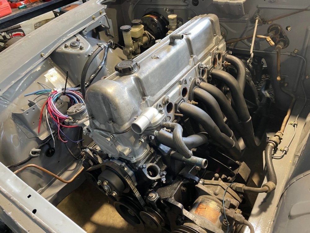

77260Z Posted February 24, 2022 Author Posted February 24, 2022 (edited) Big milestone! I was able to start it up last weekend and it ran and idled well. The 123 Tune Bluetooth distributor was actually very easy to set up. I haven't tried playing around with the tuning or advance settings on it yet but seems good so far. Also got myself a red top Optima battery. I've been working to get the cooling system sorted so that I'll be able to tune it up in the not too distant future. The radiator and the fan have now been installed (though I may upgrade to an aluminium radiator and an electric fan in the future). I also sorted out the PCV system - I added a Mishimoto mini oil catch can from the crankcase and valve cover that's plumbed back into the balance tube. The wiring is very roughly done at the moment - I just hooked up enough that I could start it. Next steps: Tidy up engine bay wiring and install a maxi blade fuse block for the alternator and starter wiring to replace the fusible links Connect final radiator & heater hoses and fill with coolant Connect choke cables and tune the SU's Complete headlight wiring mod to add relays for high beam and low beam so the power doesn't run through the switch Edited February 24, 2022 by 77260Z rubberman 1 Quote

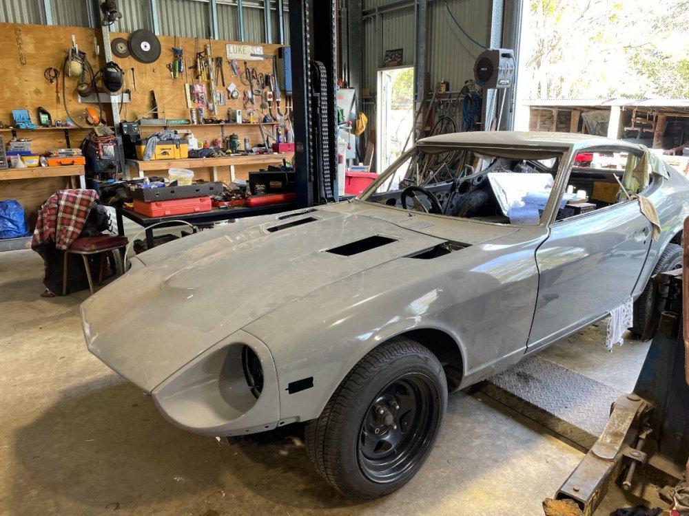

77260Z Posted August 7, 2022 Author Posted August 7, 2022 A few little things completed today, new brake light switch and installing a new clutch master and slave (forgot to take photos). Main thing really though was just cleaning up and getting it back on its wheels. Exciting that it’s starting to look like a car again. Quote

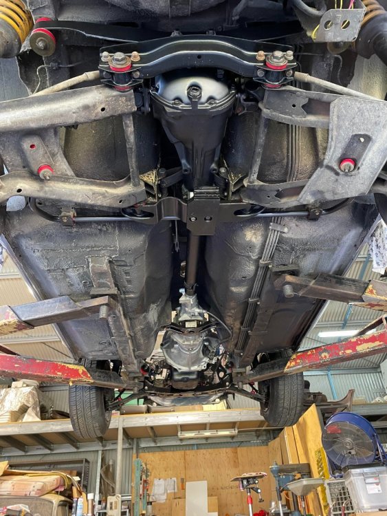

77260Z Posted August 5, 2024 Author Posted August 5, 2024 Had a few hours free so made a start on the rear brakes over the weekend. Decided to go down a fairly straightforward 'bolt-on' style method which retained the factory handbrake cable. Not the cheapest option in the end (circa $1500) as I went with new brake calipers but all in all not too bad. I utilised the Milkfab kit (Rear Disk Brake Kit - Datsun 240z/260z/280z (milkfab-engineering.com)) and ordered some new StopTech brake calipers (this kit uses single piston calipers from a 05-14 mustang). The only modification required was to redrill the rotors from a 5-stud pattern to a 4-stud. Luckily this didn't need to be absolutely precise to the hub-centric nature of the hubs and rotors. The adaptors themselves bolt on nicely and are a quality product - well engineering and nice powdercoat finish. Will complete the other side, connect up the brake lines and handbrake cable and test them out! gav240z 1 Quote
