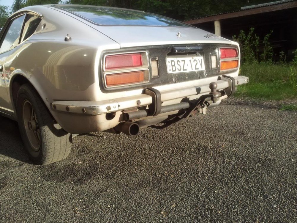

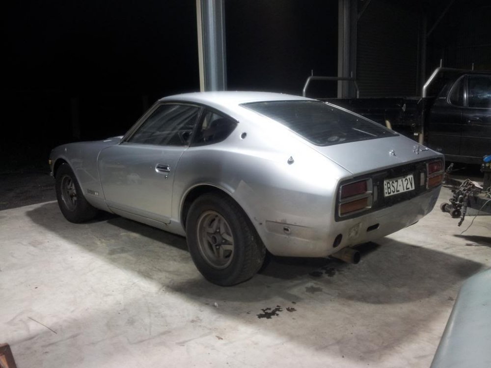

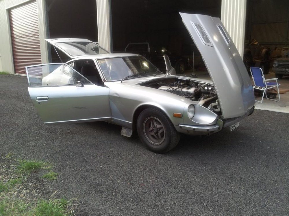

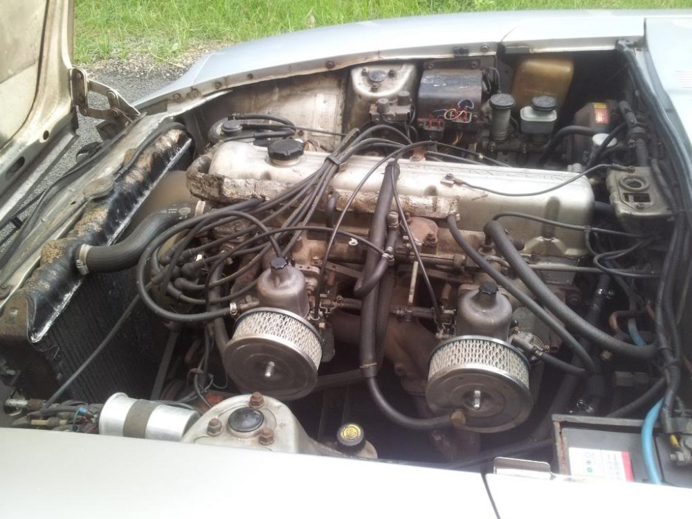

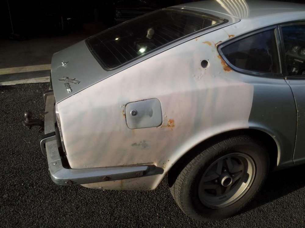

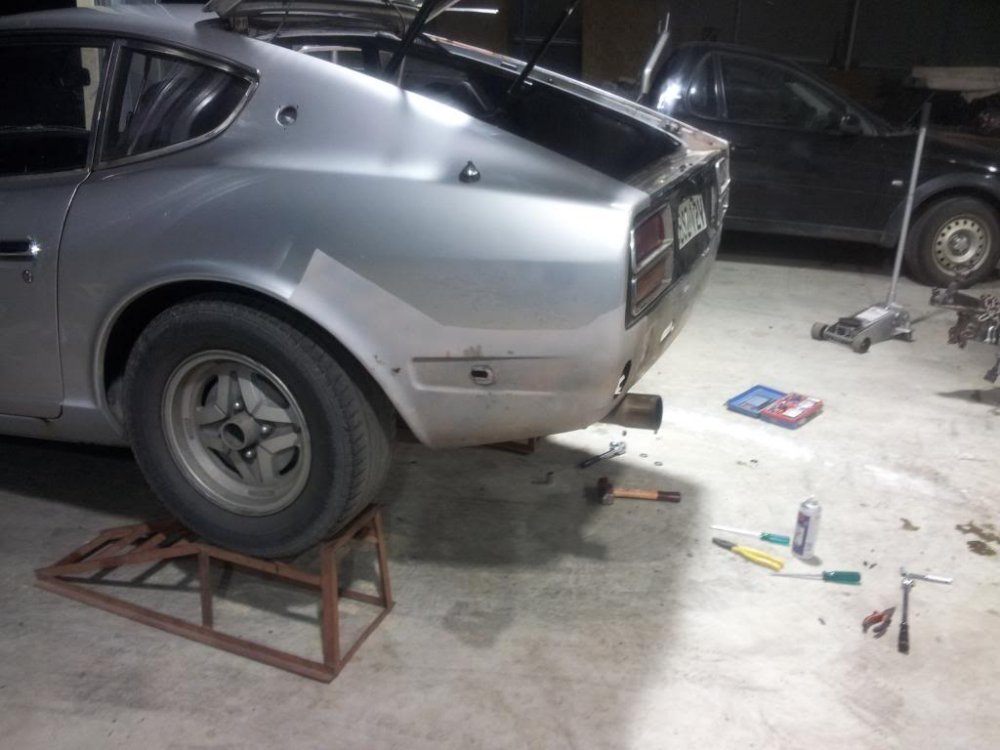

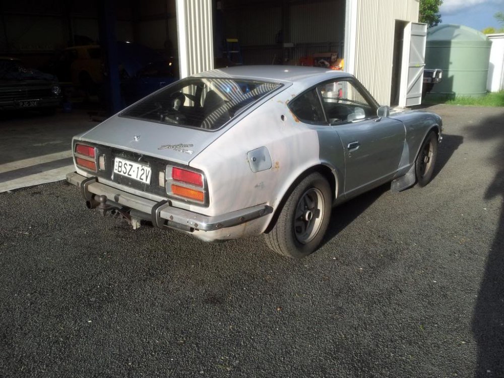

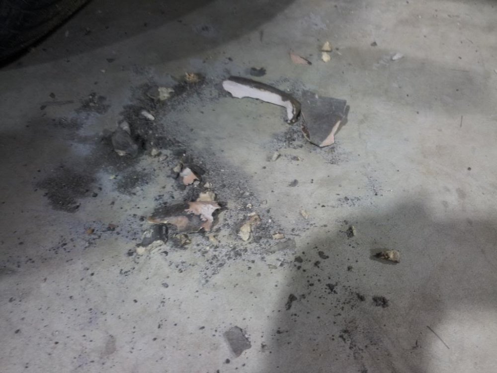

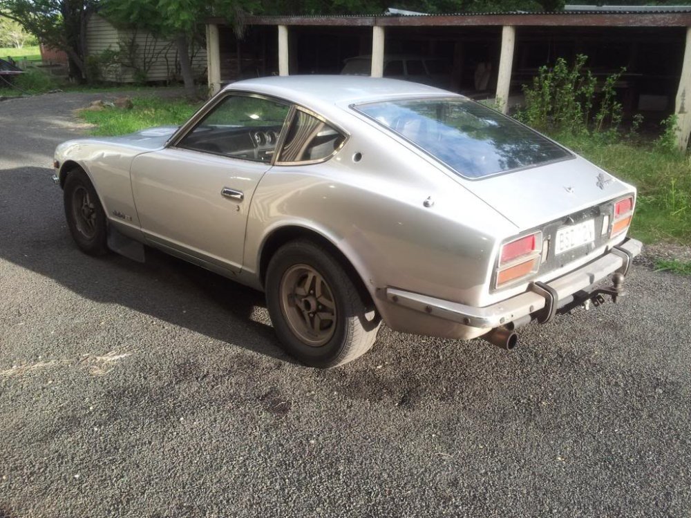

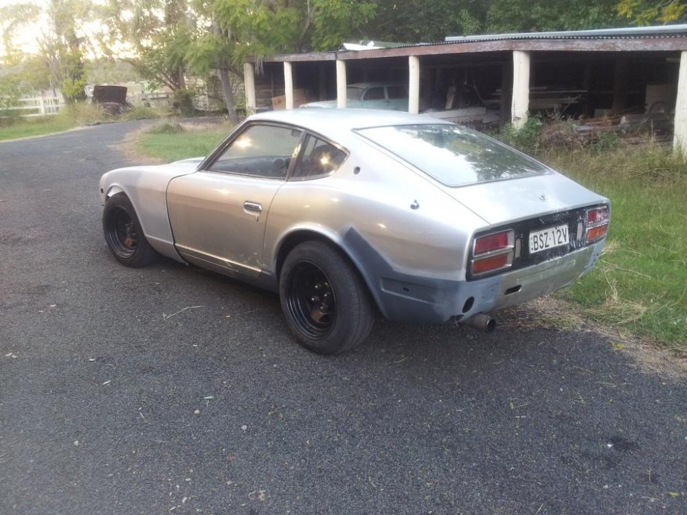

77260Z Posted February 24, 2013 Posted February 24, 2013 Just started an introduction topic: http://www.viczcar.com/forum/index.php/topic,12472.0.html Basically just picked this car up from Sydney and drove it home (to Brisbane) on Saturday. Big trip but she made it. I've got plans for it but it's going to need a bit of work. Rust is mostly restricted to surface rust, nothing really structural I've seen so far. Here are a few pics of the first inspection on her: Quote

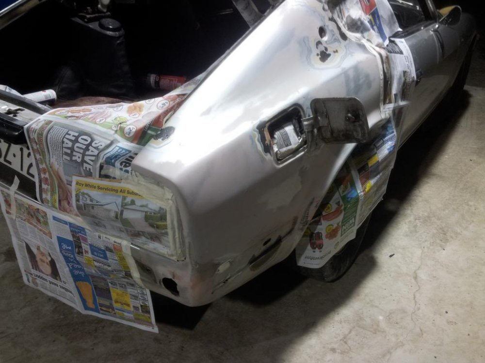

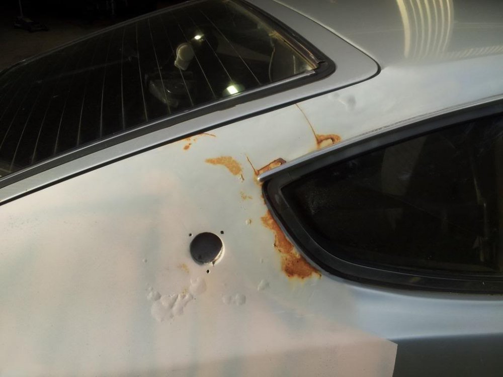

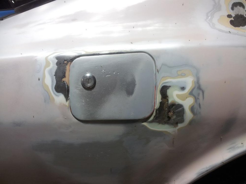

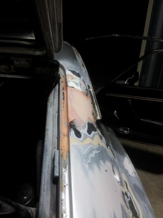

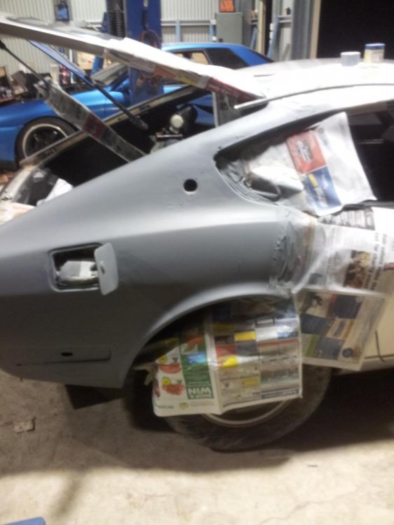

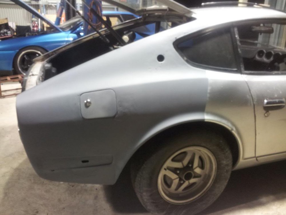

77260Z Posted February 24, 2013 Author Posted February 24, 2013 First bit of work I got done on her this arvo was sanding back the right rear quarter panel (it was in primer but a decent bit of surface rust was coming through as you can see in the pictures) and put it in etch primer for now. Not sure how I'm going to go with the rust repairs but I at least wanted to prevent it from rusting more. I also removed the rear bumper, rear towball and the mudguards from behind the front wheels, just to give it (in my opinion) a cleaner look. Quote
Administrators gav240z Posted February 24, 2013 Administrators Posted February 24, 2013 That's the way, getting stuck right into it. My old 240z also had a rear tow bar, 1 of the first things I removed also. Quote
luvemfast Posted February 24, 2013 Posted February 24, 2013 +1 with what Gav said about getting stuck into it. Now, when you say surface rust......... I've got some bad news for you. You have bought a Datsun S30 Z! There is no such thing as surface rust. Especially when there are rust bubbles and evidence of previous rust repairs. But thats why we love 'em Make sure you use the appropriate removal and treatment techniques or you'll be doing it all again in a few years. Quote
C.A.R. Posted February 25, 2013 Posted February 25, 2013 Congrats on the purchase, but I reckon that body has BIG issues... Quote
Moderators Zedman240® Posted February 25, 2013 Moderators Posted February 25, 2013 My first 260Z was like a metallic blue onion; more layers I stripped off, the more I found till I got to the metal. Best is a full body strip then you can asess what the body needs. Quote

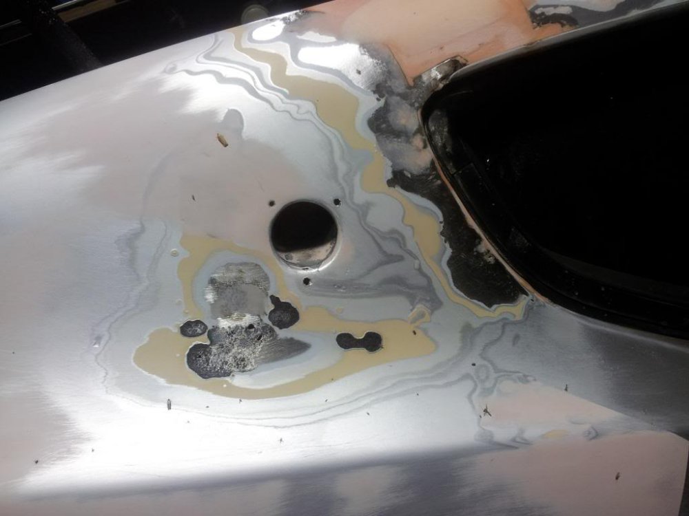

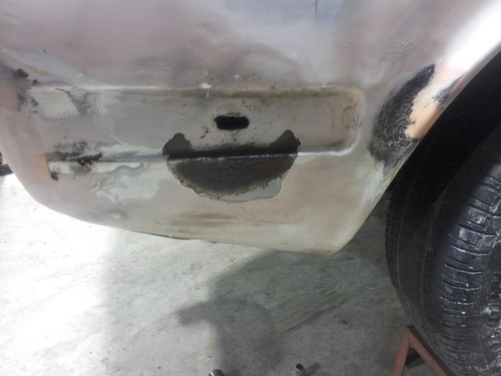

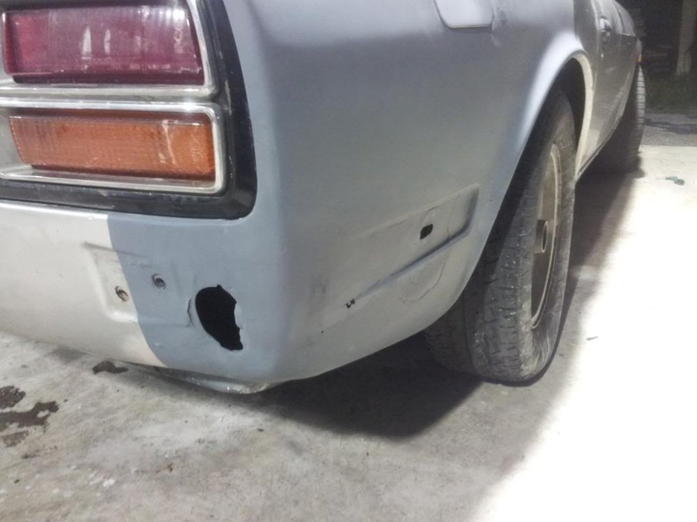

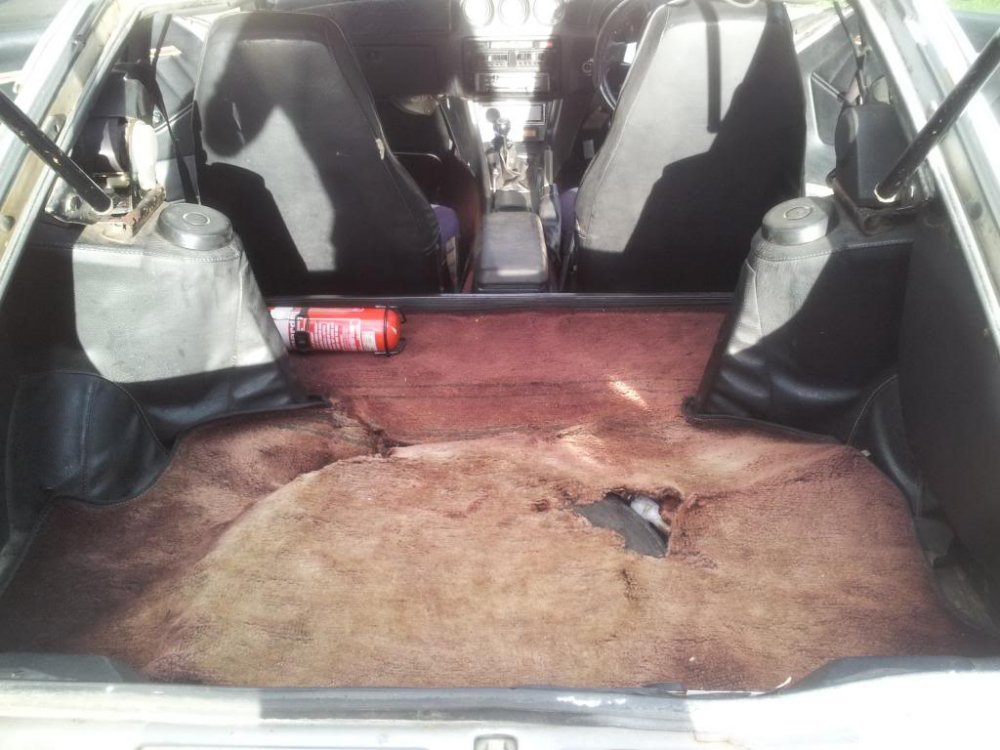

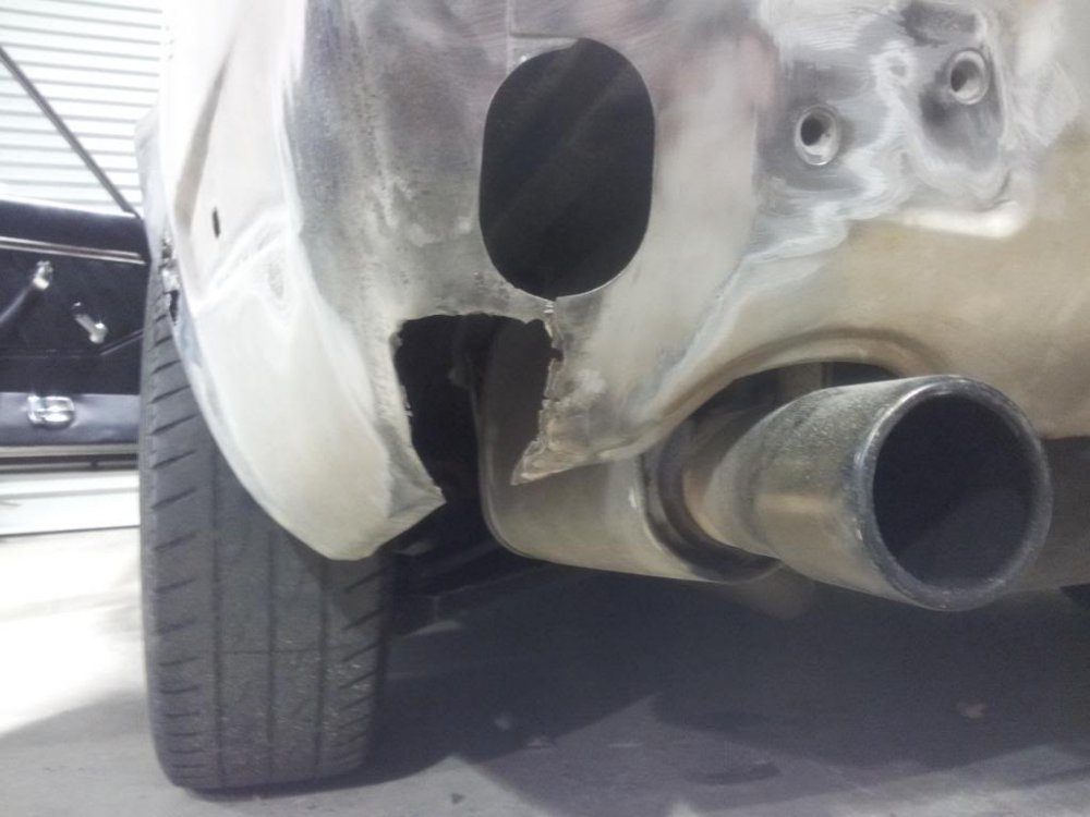

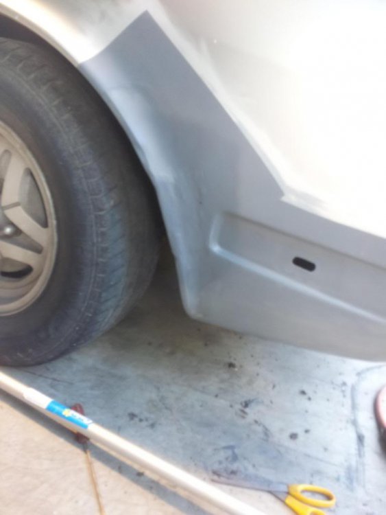

77260Z Posted February 25, 2013 Author Posted February 25, 2013 Yeah damn high post bullies! haha. Well I knew (sort of) what I was getting into, but I wasn't expecting this amount of rust. Unfortunately the more I look the more I find... Stripped a bit more off this arvo and found some nice sized holes that had been bogged over not too well... Does anyone make rust repair panels for these cars or am I going to have to make my own? Noticed the drivers floor has a bit of a hole in it too. didn't get a picture of that. That's a job for another day... I'm not expecting this to be a show car, just a fairly nice daily driver. I was really hoping I wouldn't have to strip it down to bare metal for a respray but it's looking like that might have to happen. For now at the very least I'm going to try to get to all the rust that I can and rust proof it / cut it out depending on how bad it is and put it in etch primer until I can get to spraying it. Better than letting it rust away more at least. Here's the day's progress/findings: and the pile of bog that came off from that. Here's tomorrow nights area to work on too: Quote
Moderators Zedman240® Posted February 25, 2013 Moderators Posted February 25, 2013 Nothing to fear....standard zed rust places. Few guys here can make parts. Ask and you shall receive.. Quote
luvemfast Posted February 25, 2013 Posted February 25, 2013 Yep Typical Z rust. Don't feel special Nice to see you're getting straight into it! Quote
Scoota G Posted February 26, 2013 Posted February 26, 2013 It's only about 10 Hours worth of restoration worse than the one i've been driving around for 15 Years. Looks like you are patching it for the moment but those spots will come back to haunt you. So save your dosh and get a full body resto when it does. Just my opinion. Quote

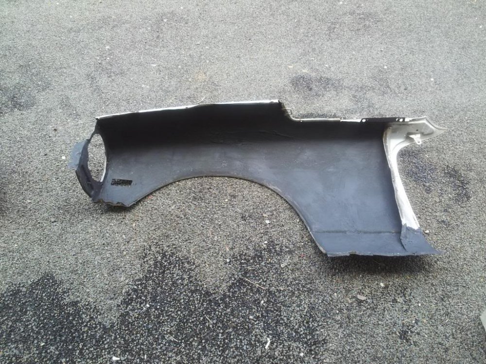

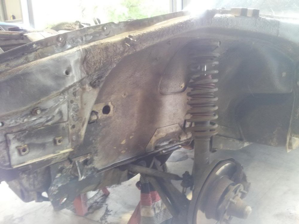

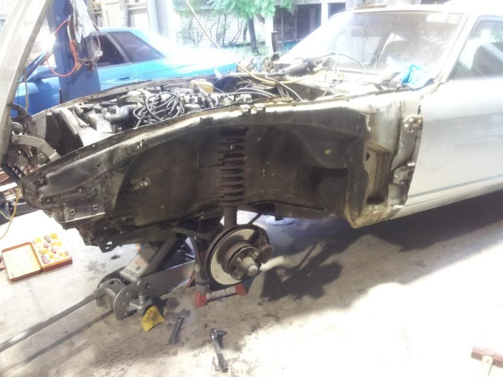

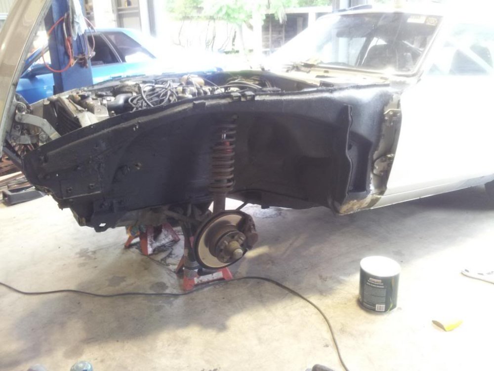

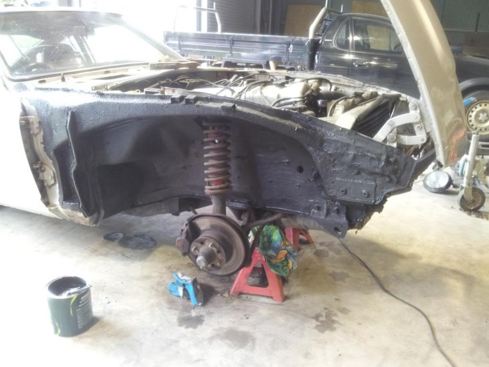

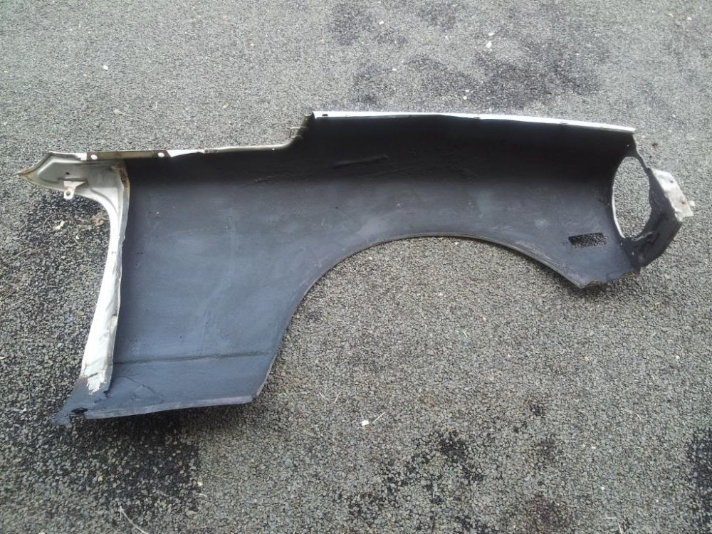

77260Z Posted March 4, 2013 Author Posted March 4, 2013 Got into a bit more on the weekend. Got the front bumper and the both fenders off and managed to get the front wheel wells cleaned up and body deadened. Next up will be getting the front fenders all straight and body deadening the back of those before they go back on as well. A few pics of the progress: Quote
funkmaster Posted March 4, 2013 Posted March 4, 2013 coming along very nicely great committment! Quote

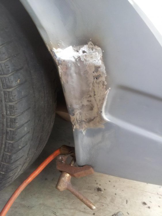

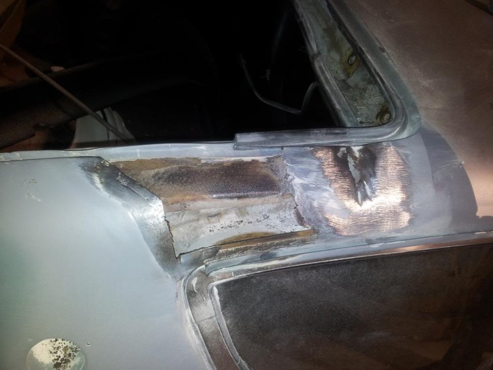

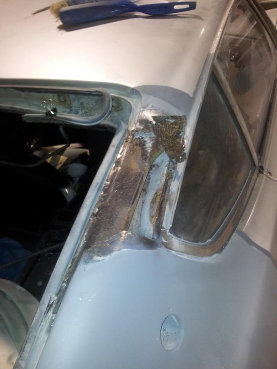

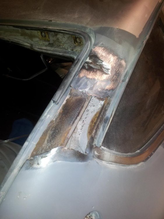

77260Z Posted March 6, 2013 Author Posted March 6, 2013 Got a bit more done recently... Got the inside of the front fenders done in underbody deadener. Should make a difference to in cabin noise I'm hoping. Also had a go at fixing a little rust section on the left rear quarter. Came out alright... This is the first patch I've made up from scratch. I used the metal off an old EH holden front fender and had to massage it a bit to get it to the right shape. A bit of bog will get it nice and smooth anyways, definitely better than a rusty hole. Quote

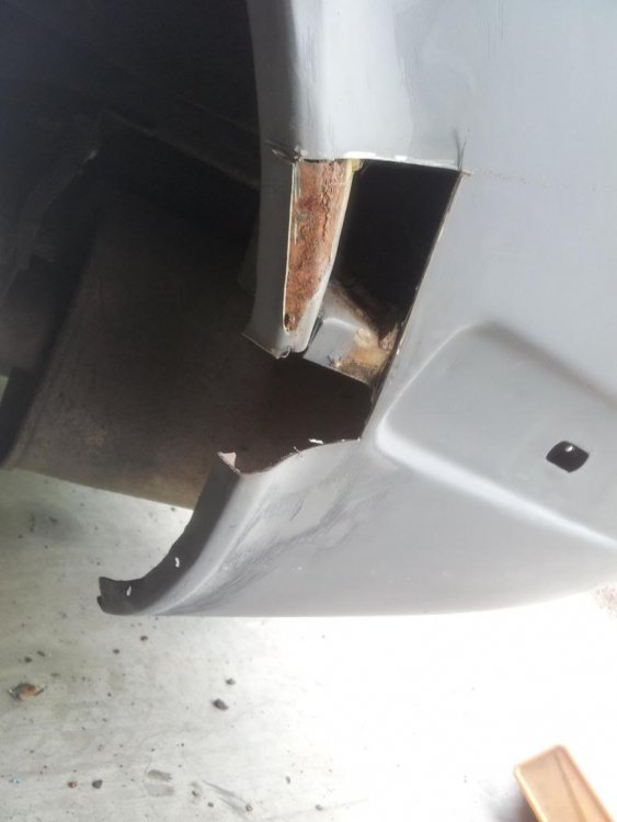

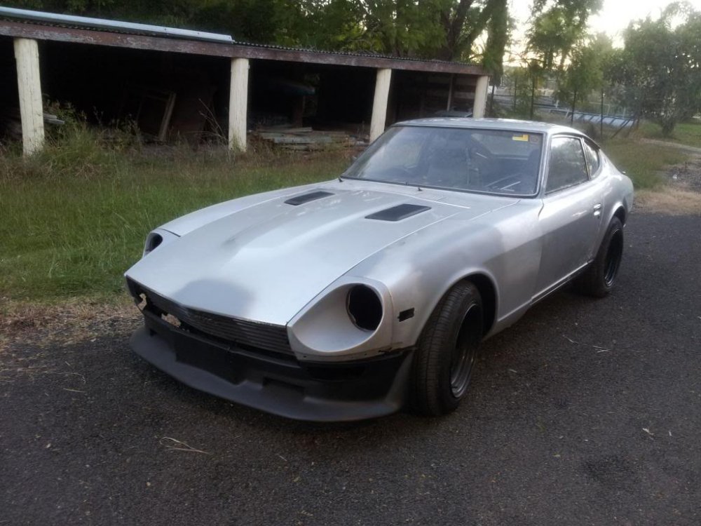

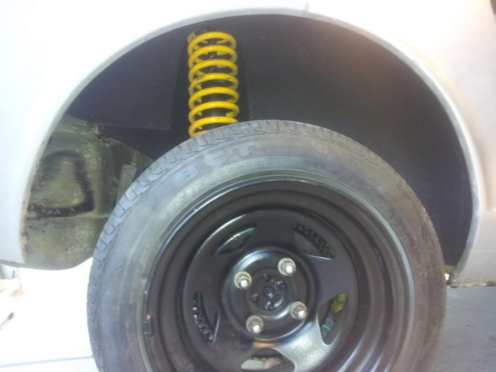

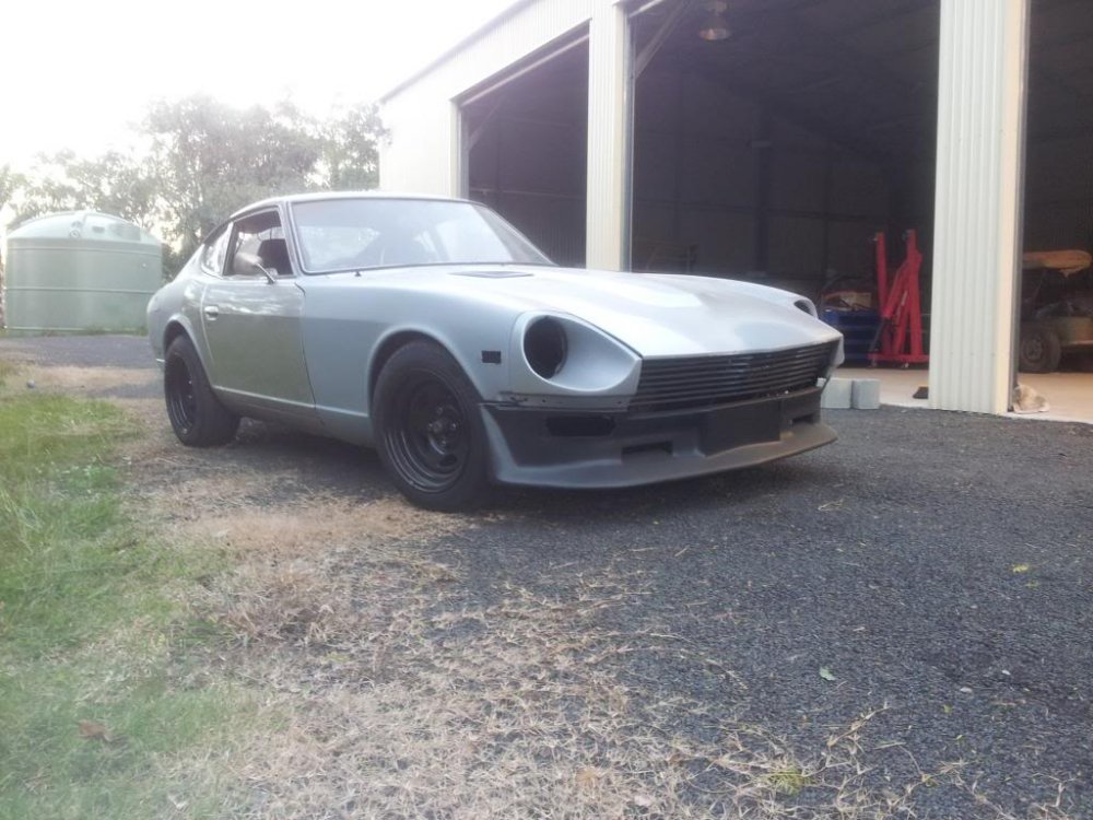

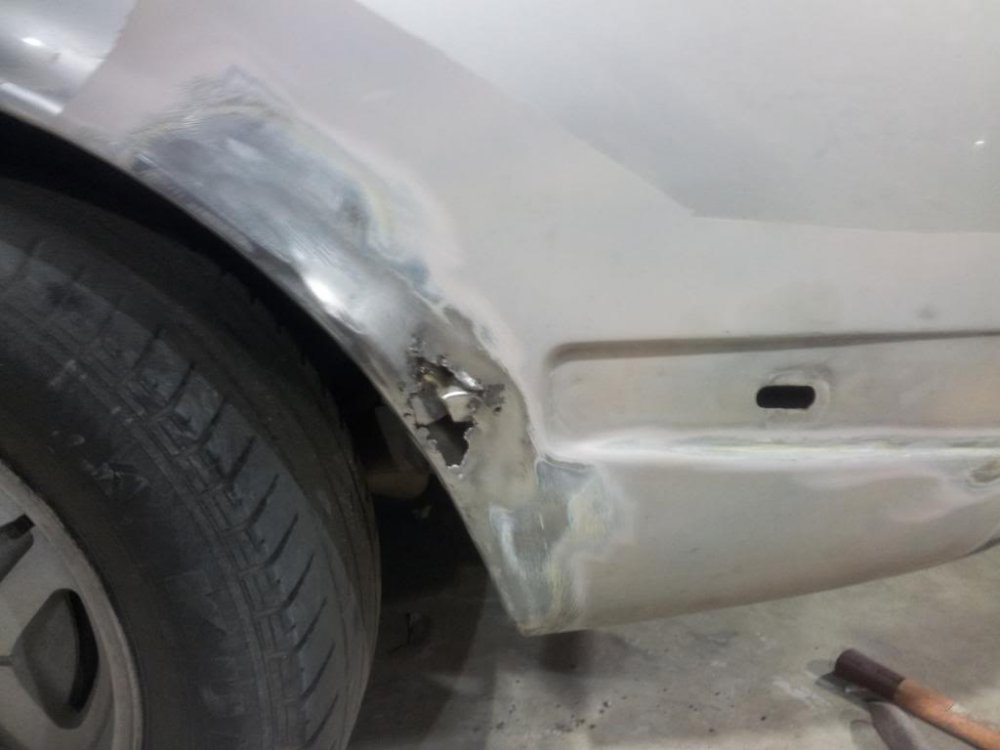

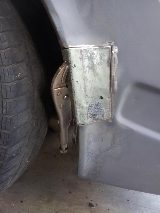

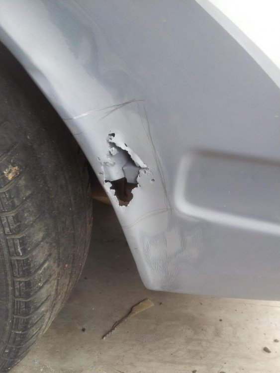

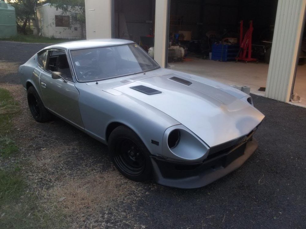

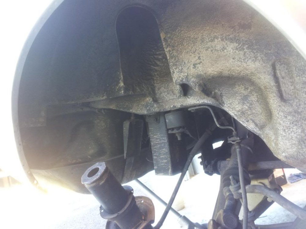

77260Z Posted June 11, 2013 Author Posted June 11, 2013 Alrighty, time for an update. I've been a bit slack updating this thread but have been getting a few things done. What I've done: - New wheels - 15x8 black steelies with 205 tyres. Tyres are a bit small for that stretched look so I might look at getting something meatier in the future. - New fibreglass front bar - second hand but with a bit of work it come up pretty well - Replaced front and rear shocks and springs with kyb shocks and king spring lows. - Put brush on body deadener in the rear wheel wells - Found some more rust. More on that later. Some pictures of the progress: So it looks OK in it's rat roddy form at the moment, but getting it in paint is the next priority. I figured it would be best to get as much rust as possible out before then. There was a spot on the upper rear quarter near the hatch that I'd been worried about, and with good reason. Here's what I found: (note: I didn't pull out the grinder, this is what was left after just wire wheeling) So it seems that Dodgy Brothers customs had a good chop at 'repairing' some rust last time. I know this spot will be almost impossible to get a patch piece for but if anyone on the forums has any ideas, templates or has an old shell they're happy to cut up I'd be happy to pay for the piece instead of trying to make one for it. Luke Quote
thriller Posted June 11, 2013 Posted June 11, 2013 Not a nice surprise there at all! I'd try bending a piece of sheet by using the other side of the car as a template. Just hand pressure should get a close shape, and lightly tap with the hammer along the edge to curl it over the edge. Then check how it fits on the rusty side, massage as needed. Even if you just use a few scrap bits of steel and have a few practice goes before deciding to pay someone else, all you've lost is a bit of your time and hopefully gained some XP points. Someone on here could surely make a perfect patch for the right $$$. Not sure how I feel about the wheels, but at least you aren't leaving it rusty like most other steely-wearing Z-rats Quote
