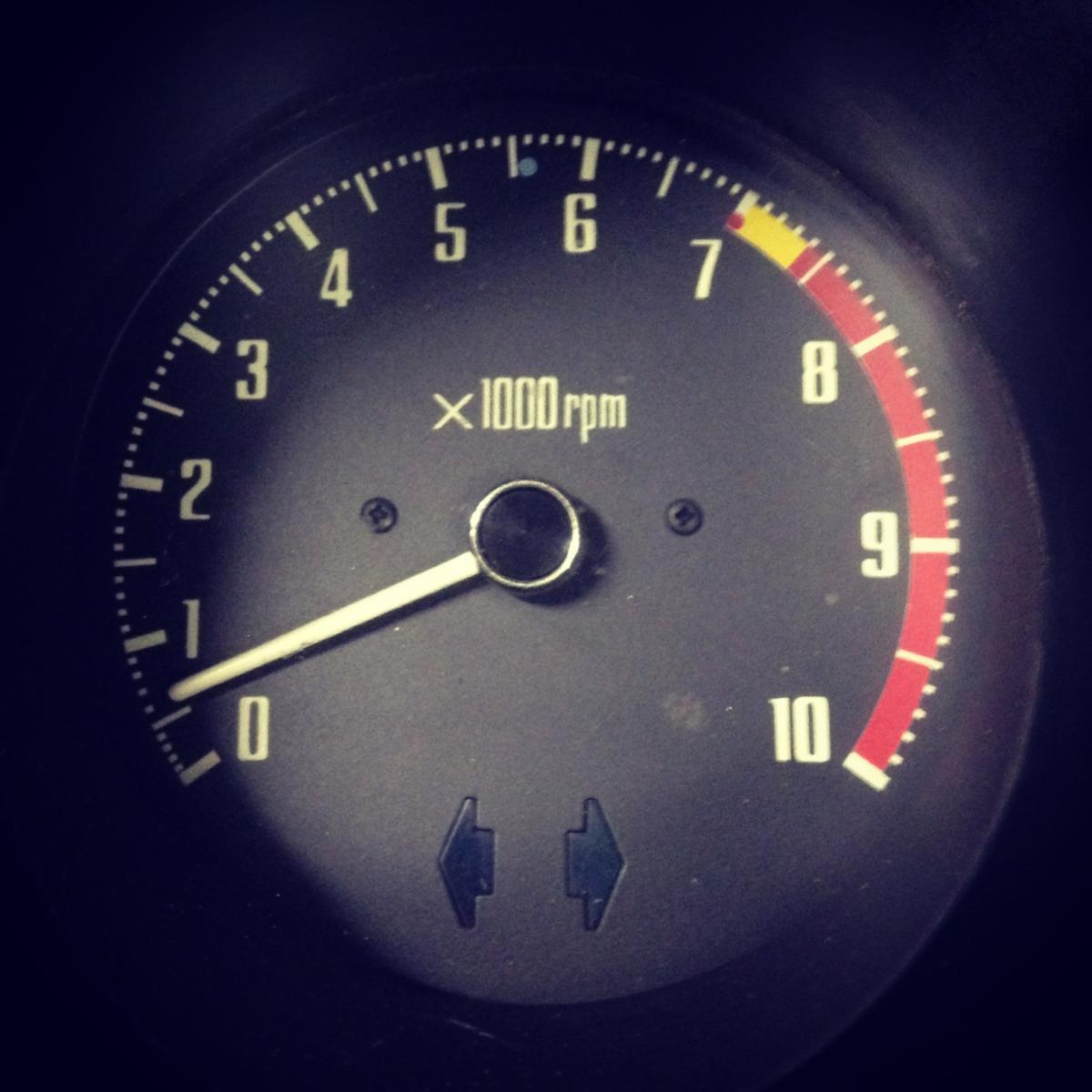

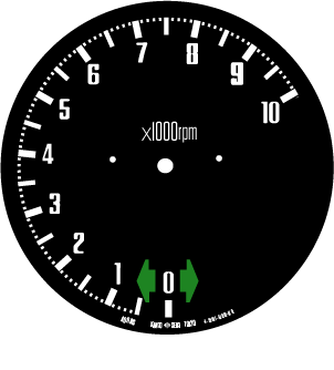

Moderators PB260Z Posted April 26, 2017 Moderators Posted April 26, 2017 Hi Gav They are looking good, I believe that if you reprinted the entire guage set in the same type face only the absolute purest would notice. Also, how do you plan on working out the adjustable yellow needle ? Cheers PB Quote

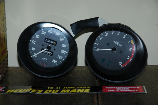

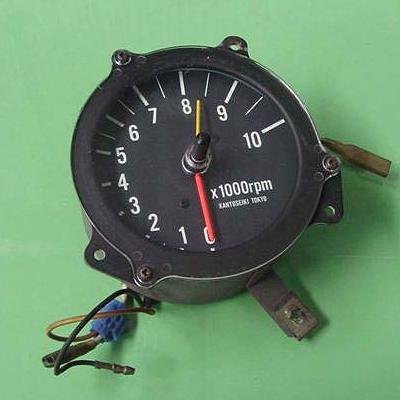

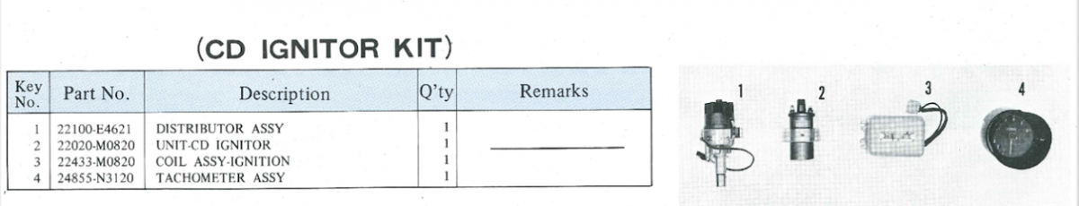

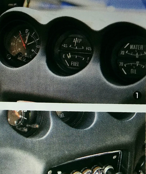

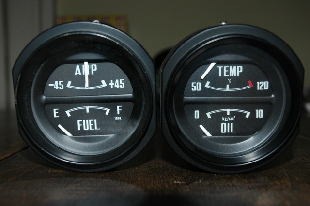

Administrators gav240z Posted April 26, 2017 Administrators Posted April 26, 2017 Long term thinking, I was going to get mine recalibrated to suit the ignition system I use. I would like to reproduce the yellow box (which is part of the Sports Option CDI ignition system). Not sure how I'll do that yet, but seeing what Ron did with the Oscillator box for the Rally Clocks gave me some motivation. At this stage I'm just trying to do the designs, there is quite a few different gauges that interest me (attached some examples) not to mention the PS30-SB ones like the 100L fuel tank and metric gauge oil pressure etc.. Worrying about accuracy at this stage is not really on my radar. I will be happy enough if the gauges turn out looking good. Quote

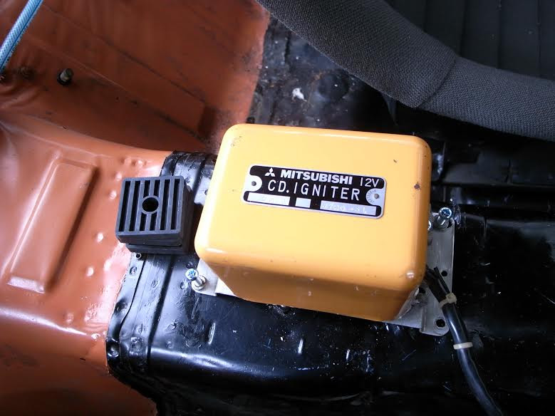

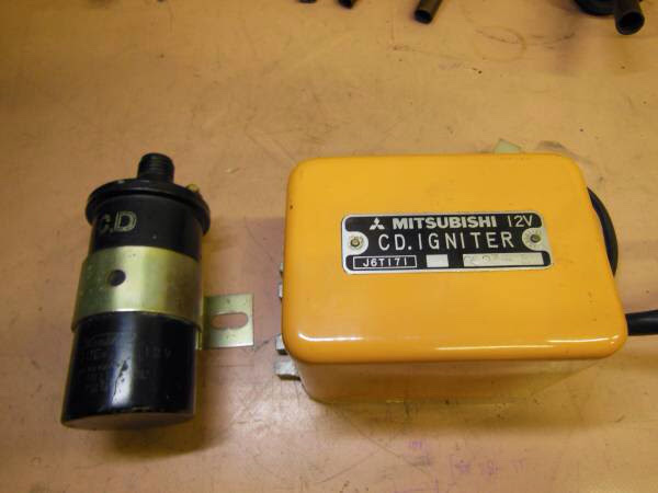

Riceburner Posted April 27, 2017 Author Posted April 27, 2017 I likey Do you know the dimensions of the CDI box, can you fit a modern one inside the replica box? Quote
Administrators gav240z Posted April 27, 2017 Administrators Posted April 27, 2017 I likey Do you know the dimensions of the CDI box, can you fit a modern one inside the replica box? No I don't, but I know someone who might have 1 (in Australia) I can use to measure up. They are mega expensive now, like insane expensive. There is also a white version with a military canon style plug that was the works part originally used on the likes of the Rally Cars (I got all this info from Alan btw). The yellow/orange box came later. I've never seen a photo of the white box (only photo I have I believe is the 1 attached). To give you some frame of reference here is a pic on the transmission tunnel of a genuine PZR with an orange box! So I'd imagine you might be able to tuck an MSD unit into it... Quote
Riceburner Posted April 27, 2017 Author Posted April 27, 2017 Hard to say but the mitsubishi box looks a little too short for the MSD6AL-2 box. Would Kameari's CDI box fit? It is a little smaller IIRC. Quote

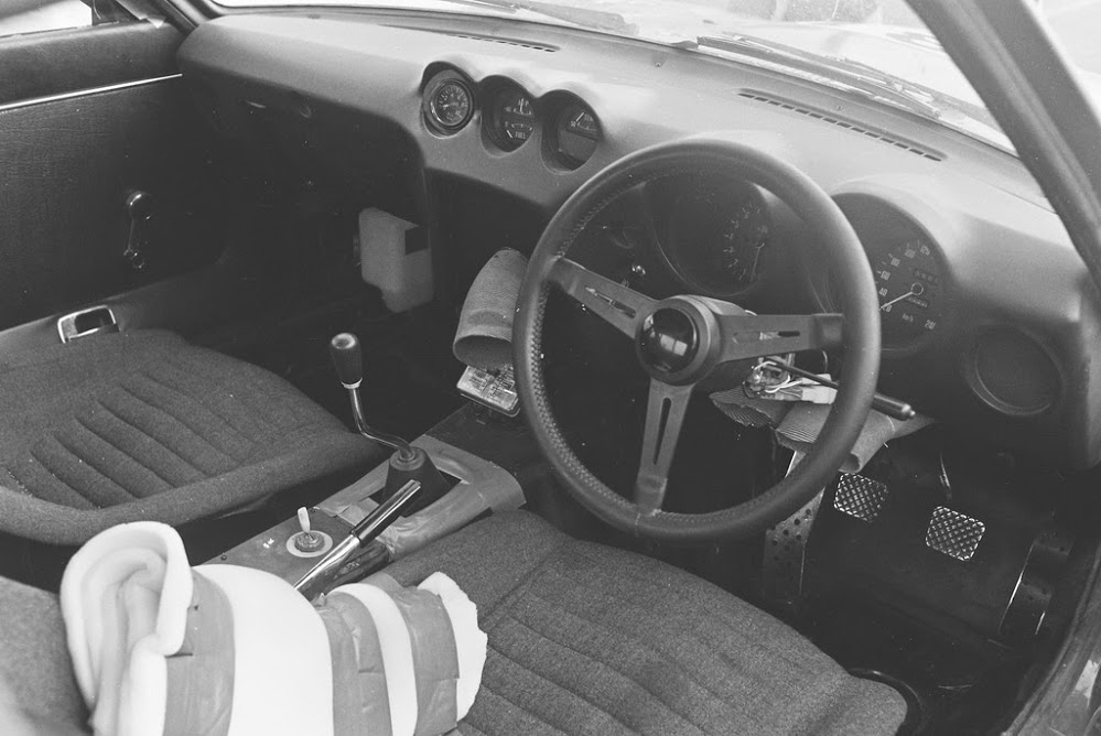

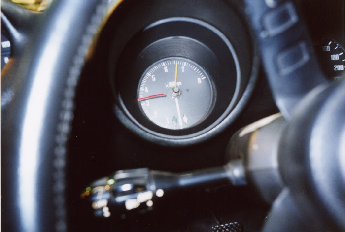

Administrators gav240z Posted April 27, 2017 Administrators Posted April 27, 2017 Hard to say but the mitsubishi box looks a little too short for the MSD6AL-2 box. Would Kameari's CDI box fit? It is a little smaller IIRC. I've not had any experience with either, so couldn't say for sure.. By the way you may appreciate this photo. (can you see what Tach it's running?) Quote
Riceburner Posted April 27, 2017 Author Posted April 27, 2017 Where do you get all these great old pics from? I could look at that stuff all day long. Quote
Administrators gav240z Posted April 28, 2017 Administrators Posted April 28, 2017 Where do you get all these great old pics from? I could look at that stuff all day long. I got that 1 from here: http://japanesenostalgiccar.com/forum/forum/garages/datsun-nissan-garage/287661-vintage-datsun-fairlady-z-and-240z-racing-and-rally-images However there is no captions with those images to tell you more about them. I believe however that the photo I posted above was / is a genuine PZR race car and had it's S20 removed and re-fitted with an L24 for a special type of circuit racing in Japan. I seem to recall Alan discussing it recently on Classiczcars.com in a debate about S20 vs L24 and which is better... If I can find it I'll post it again. I made a few edits last nigh to the tach, most probably wouldn't spot the difference but I didn't have a good example of the small inscription at the bottom of the tach where it says KANTO SEIKI and has the company logo. What's interesting is that I noticed Australian tach's have some kind of ADR mark I believe. Horrible pic but it was enough to allow me to trace what I needed. Note the ADR IC I am pretty sure that is for Australian Design Regulation etc..Would love to know if anybody else knows for sure? https://goo.gl/photos/tRwu75fzSYHugDa5A Quote

Brabham Posted April 29, 2017 Posted April 29, 2017 How did the 100 L tank fit in Gav? I assume it drops down lower with longer straps? That would be useful for long trips, I assume they are hard to find? Quote
Administrators gav240z Posted April 29, 2017 Administrators Posted April 29, 2017 How did the 100 L tank fit in Gav? I assume it drops down lower with longer straps? That would be useful for long trips, I assume they are hard to find? The 100L fuel tank displaced the spare tyre well, it is similar to the Skyline fuel tank. Photos of a genuine PS30-SB here. http://www.classiczcars.com/profile/8135-take432r/content/?type=gallery_image Z432-R boot floor. http://www.classiczcars.com/gallery/image/33920-432r-is-beautiful-but/ Quote

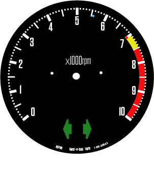

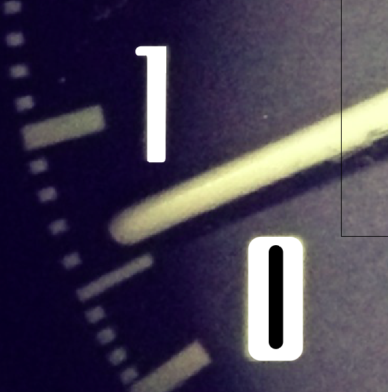

Administrators gav240z Posted April 29, 2017 Administrators Posted April 29, 2017 This came out looking quite good, only problem is I can't quite get the alignment of the positioning of numbers right. If I scanned the real deal in, it would probably have been easier... Quote

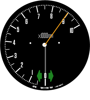

Administrators gav240z Posted April 30, 2017 Administrators Posted April 30, 2017 Also, how do you plan on working out the adjustable yellow needle ? It turns out that the 280zx Analog clocks have a very similar looking knob, only problem is they are encapsulated in the plastic lens. I'm not sure how they did it, but there is a spring behind it also so when you push on it you can adjust the clock hands etc.. I am not sure if Ron at Zclocks re-makes his own lens for clocks (I'm fairly sure he's made tooling to do it). In which case I may ask him about making a moulding with the 280zx knob and using another tach's spare needle and attaching it painting it "orange" etc.. although I wonder if the original colour is red and the photos show orange because it's faded over the years? It certainly seems that the Rally Clocks second hand faded to an orange (from a red-ish colour). I also think red would look more suitable... but first steps first. Quote

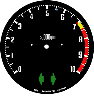

Administrators gav240z Posted April 30, 2017 Administrators Posted April 30, 2017 So I did what I set out to avoid doing, that is trace each single number manually... I hate doing it this way as it's far more work and rarely do the characters (alphanumberic ones look correct when traced out). But here is a sample of the tach with the "correct' type face. Bookmark for my own reference. https://mazda626.net/topic/39309-making-custom-gauge-faces/ Quote
gilltech Posted April 30, 2017 Posted April 30, 2017 (edited) Note the ADR IC I am pretty sure that is for Australian Design Regulation etc..Would love to know if anybody else knows for sure? ADR = Australian Design Rule. ADRs are a series of rules implemented from 1 January 1969 on, covering an increasing list of safety requirements for Aus-new cars. There is an ADR 1 which covers reversing lamps, and some of the ADRs have an 'A' or a 'B' appellation, but I can't find any 'IC' in the docs I have to hand. Anyway, the 'ADR' and 'IC' on your tach face are different type faces and I propose that they have quite separate meanings and aren't to be read together. Reasoning: my NZ-new RS30 tach doesn't have the 'ADR' on it's tacho face, it solely has the 'IC'. Perhaps others might like to check their non-Aus-new cars and report back? Edited April 30, 2017 by gilltech gav240z 1 Quote
