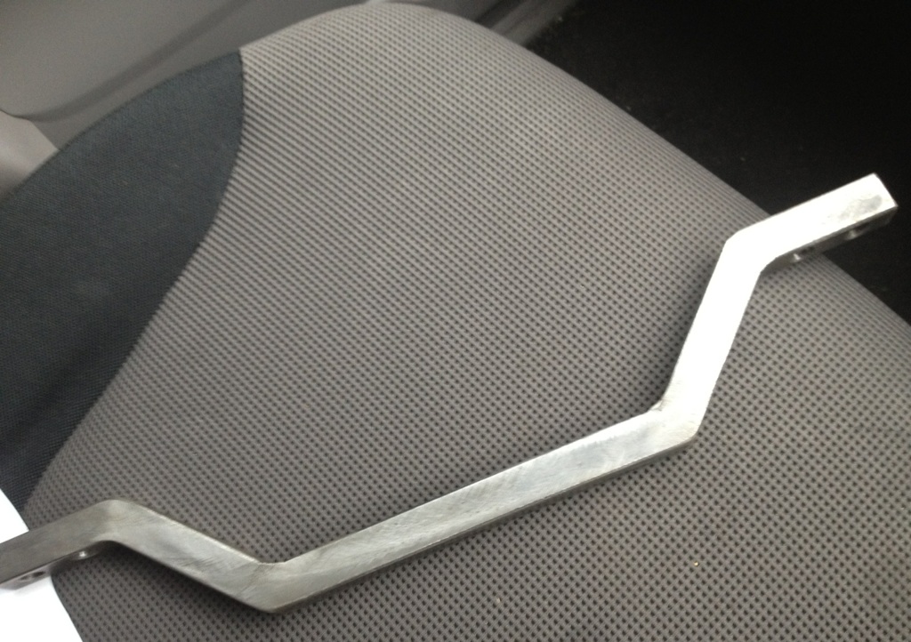

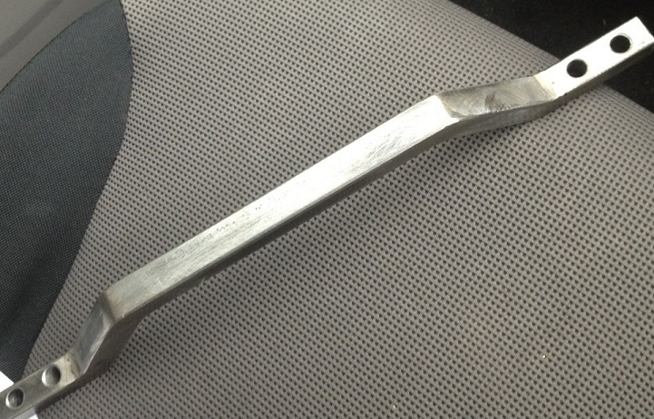

Riceburner Posted August 25, 2012 Author Posted August 25, 2012 cut them and fit a hose over them and make them as long as you want Good idea Pete, didn't think of that! More dodgey Iphone vids...... I felt like Mad Max or the Beverly Hillbillies and damn it was freezing Test drive down the driveway, went really well and seems to have plenty of power. Constant wheel spin, was very very hairy to drive. Plug color looks spot on! Also got the new diff brace made up, clears the finned cover nicely and that means the rear end is now finished! Woohoo, one down... twenty five to go. Quote

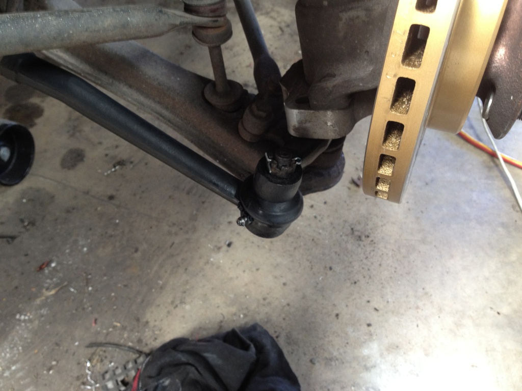

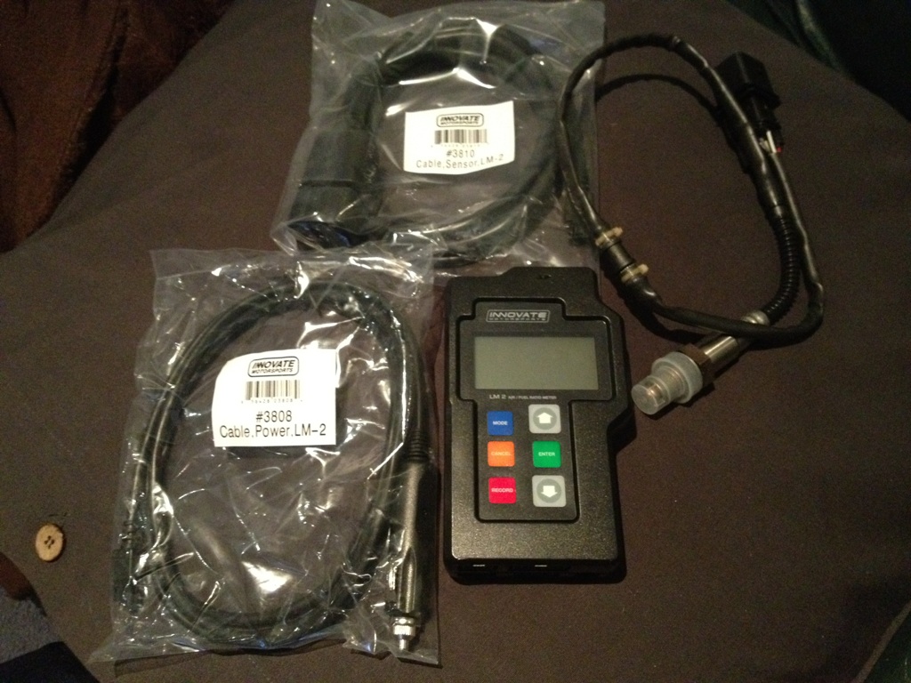

Riceburner Posted September 22, 2012 Author Posted September 22, 2012 Few updates. I got an Innovate LM-2 air fuel meter to check the tune on the FCR's. 13.5afr at idle, 11 when the throlttle is cracked with acc pumps, then between 12-13 all the way to redline I have not touched the jetting in any way since I fitted these, I did a quick sync once fitted and I only had to adjust the throttle cable as I was only getting 2/3 throttle whe doing videos before I hooked up the LM-2! I also got a chance to fit the Nismo short steering arms with the new tie rods I had. The old one were trashed so hopefully the urethane boots last longer on these, otherwise it'll be rose joints. Fitted new DBA gold rotors which are cross drilled & slotted. While I had the hubs apart I threw in the nismo long wheel studs too. Quote

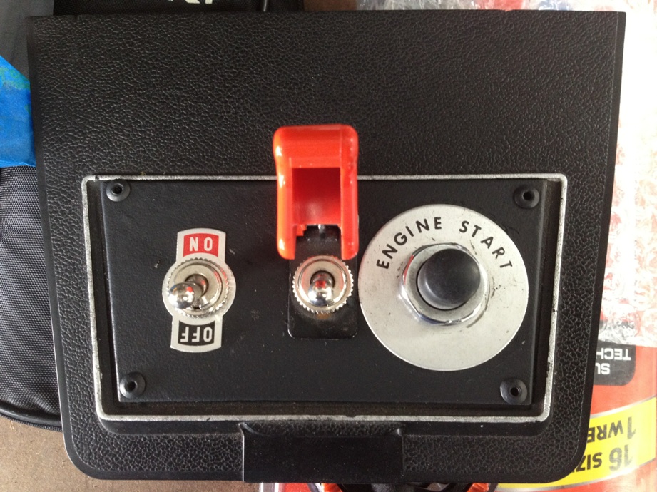

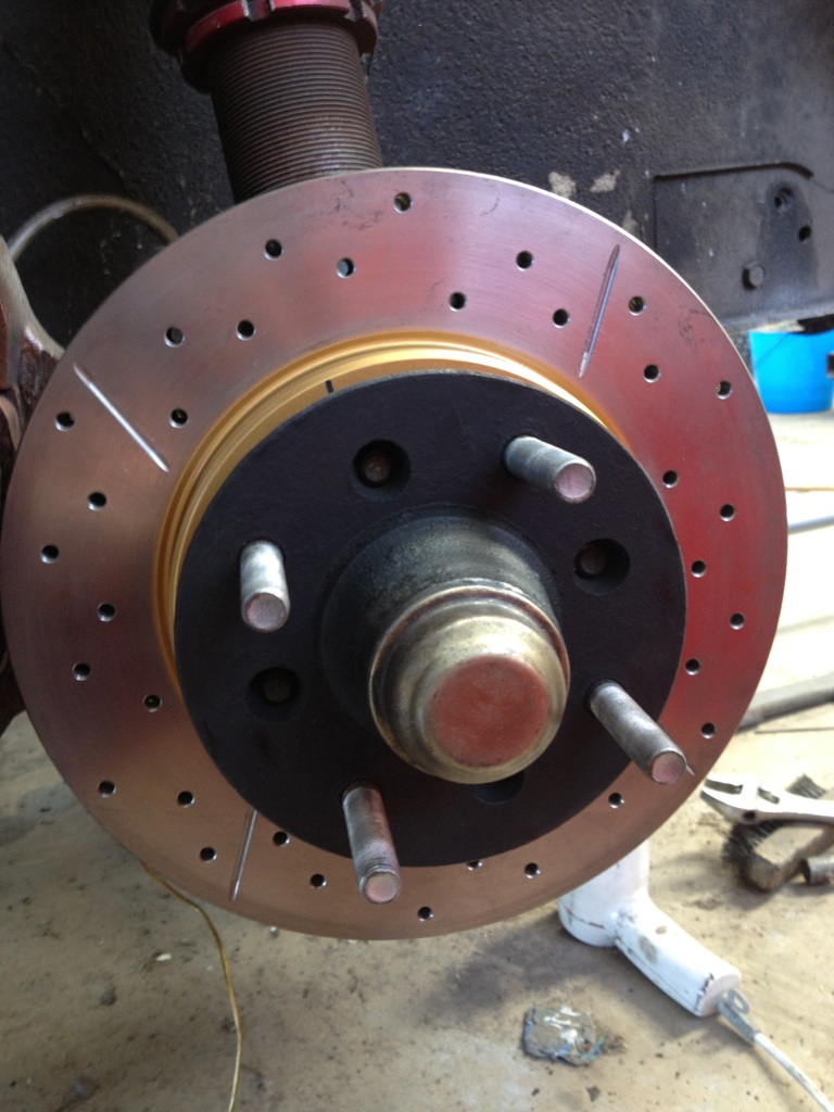

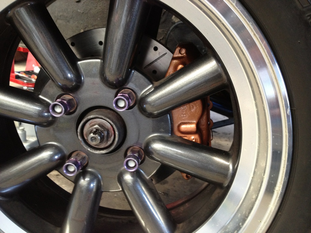

Riceburner Posted September 22, 2012 Author Posted September 22, 2012 I ended up repainting the calipers 'New Copper' which looks a little less boy racer. Next on the list was the start button which was an elcheapo i had run for a while. It worked well but looked a little to modern for the interior, so I found a start button from an old Peterbuilt Truck! Check out the patina I managed to get the doors on and aligned too. It's been nice to have some easy work to do for a change, the FCR's have cost me a lot of time so here's hoping the build pace picks up from here on! Quote

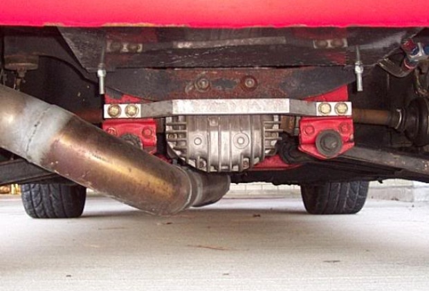

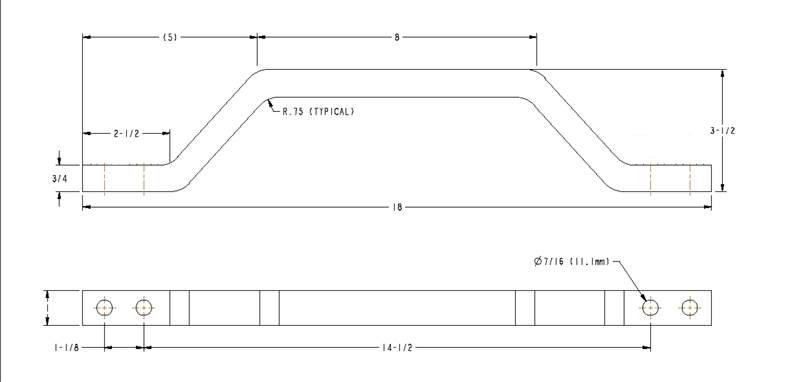

RB30X Posted September 22, 2012 Posted September 22, 2012 Nice diff brace. Got any pics of it fitted or at least in position? Quote
Riceburner Posted September 23, 2012 Author Posted September 23, 2012 Nice diff brace. Got any pics of it fitted or at least in position? I'll take one when I'm working on the car next. It's made from solid bar, to the specs in the plan below which IIRC is for an R200 finned cover. Quote

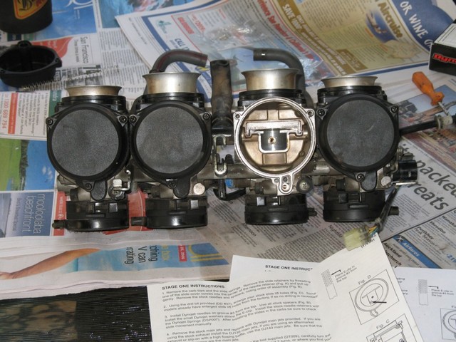

Riceburner Posted October 5, 2012 Author Posted October 5, 2012 Hi Adam, I did think seriously about FI. Cost was a factor but something unique and individual was also a thought. I chose to ditch the old CV's and get FCR flat slides instead, apparently they are about as close as you can get to FI when tuned properly. Supposedly FCR's & MSR's have been a performance option in Japan since the 80's, but outside of that there is very little to no info in english. I've done a huge amount of searching and come up with very little info relating to datsun or S30Z. Alas no dyno yet, it would be nice maybe one day. Very happy with the PMC head, it's transformed the engine! Quote

Riceburner Posted October 6, 2012 Author Posted October 6, 2012 MSR's are a flatslide carb produced by Mikuni. FCR's are made by Keihin, they're basically an evolution of CR carbs which were common on superbikes. They reworked them for max power and added an accelerator pump. In terms of power they should be very good, at WOT there is no venturies/choke/butterfly/throttle shaft in the way. There's just a needle, so it'll be 41mm of unrestricted fury The head is awesome, heaps of power down low and it just goes harder as revs increase. It's more noisey all round, but that's to be expected. Quote

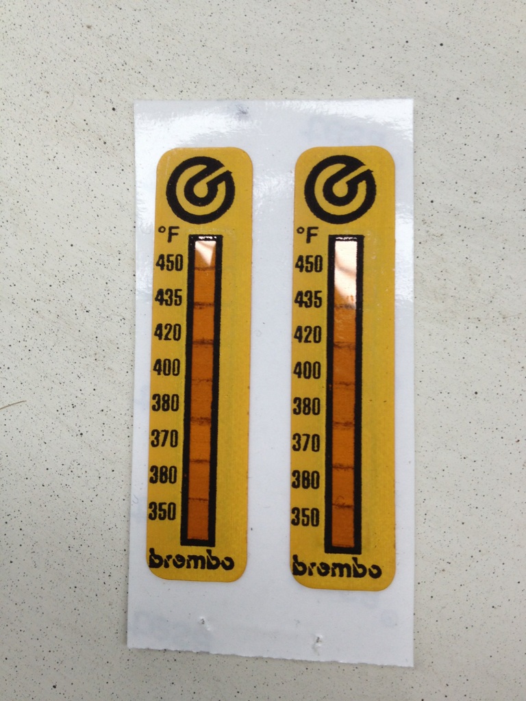

Riceburner Posted October 6, 2012 Author Posted October 6, 2012 Haha, Cheers Adam hopefully we're both going by then! Here's a pic of the diff brace fitted, not on my car but it's mounted in exactly the same way. Also got some brake temp stickers, they go on the calipers and show what temps your reaching. The max temp is 50F below my fluid boiling temp, Should be very handy info for track days. Quote

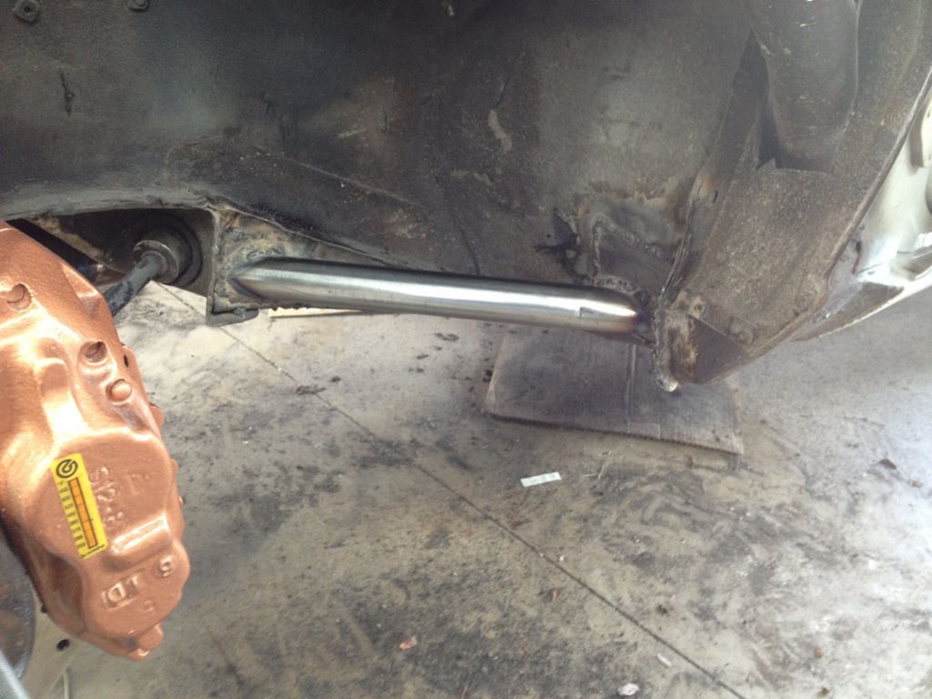

Riceburner Posted October 14, 2012 Author Posted October 14, 2012 More bracing plated both side then stiched in, the firewall side has a right angle that is stiched to the sill also. While I was under the car I also noticed a crack where the floor rail meets engine rail just back from the bottom of the firewall, the underbody paint had actually cracked off too Cleaned it up and made a small section of new rail which I stitched over the top. Shouldn't get anymore cracks with four new braces in the front! Quote

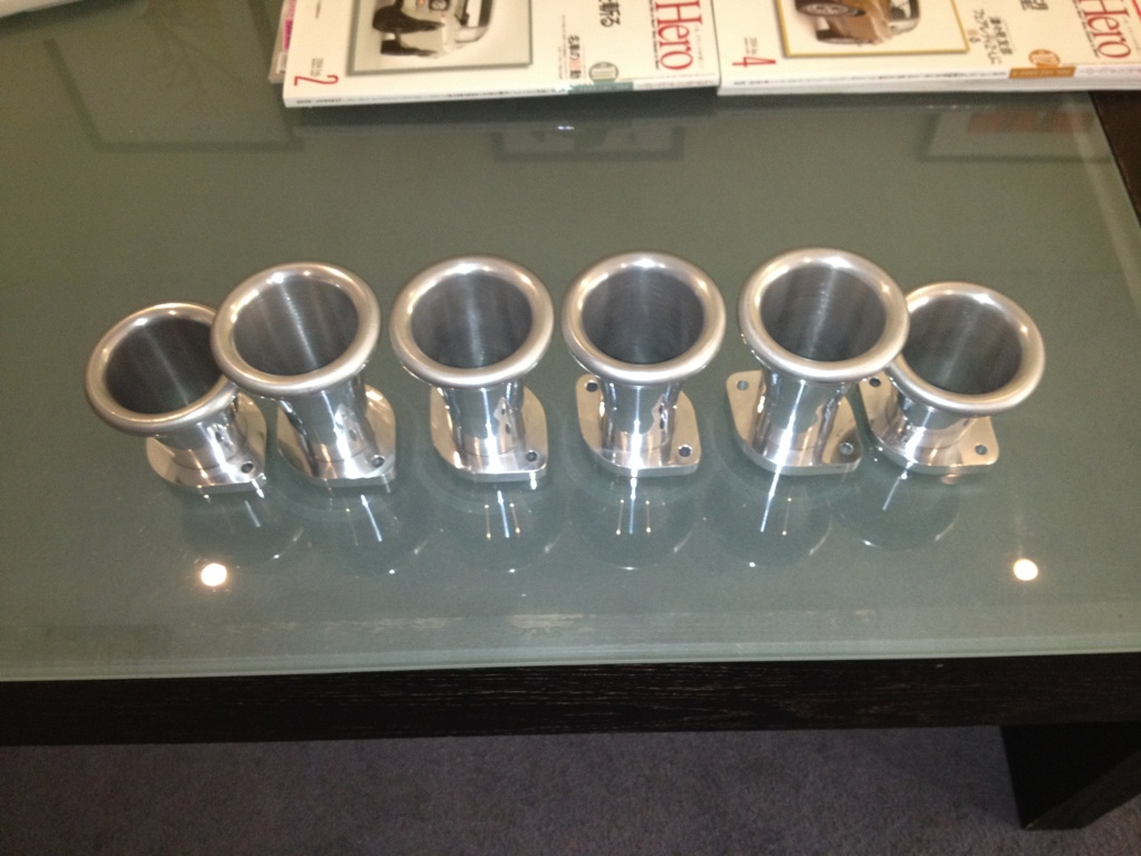

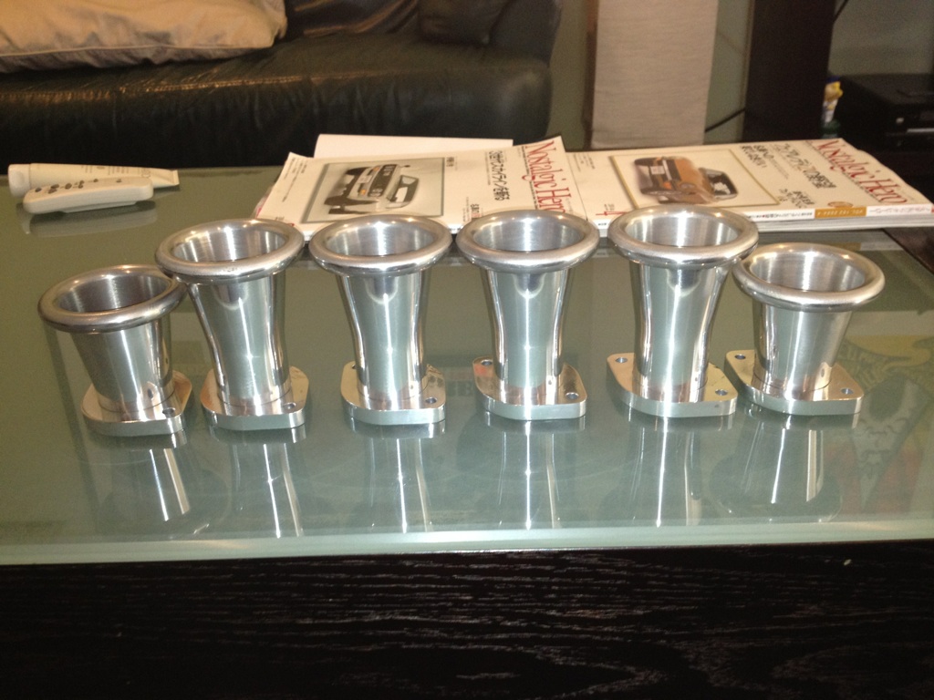

Riceburner Posted October 26, 2012 Author Posted October 26, 2012 Got some new stacks for the FCR's, tig welded to the bases for extra strength and a light polish Due to spacing of the carbs the standard blue stacks have factory 'flats' on the bellmouths for clearance to the next stack, it's super tight between carbs 1&2, 5&6. With these new ones the bellmouths are 80mm instead of 65mm, so I had to shorten stacks 1&6 by 20mm to allow enough clearance :'( I have four at 105mm and two at 80mm. Ideally they should all be the same length but with my setup it's not possible. I have seen bike carbs setup with the same configuration, my old blackbird carbs were like this and even had a smaller main jet in the carbs with shorter stacks. If it good enough for Honda it's good enough for me. I was going to paint them black, like the rest of the engine but with the way they've polished up I'm tempted to clear coat them as it. Opinions please? Quote
KatoKid Posted October 26, 2012 Posted October 26, 2012 Theres a whole science in inlet optimisation in cars through variable length manifolds and through the motorcycle industry with variable length trumpets . Modern day Moto GP and Superbikes have infinitely variable length trumpets driven by stepper motors from the fly by wire ECU. This has now crept into some production bikes but tends to be either on or off at a set RPM where the top of the trumpets are lifted off the base to give a shorter inlet tract. As you've pointed out many production bikes have different length fixed trumpets to spread the torque curve and make a softer transition when the inlet pressure waves ideally match the cam and exhaust. I reckon you're the man to adapt motorcycle variable length stacks to your FCR's Gareth. Go on, you know you want to. Quote
