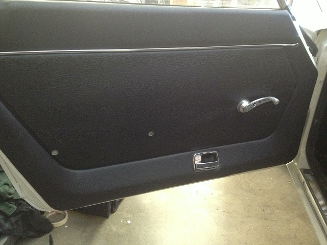

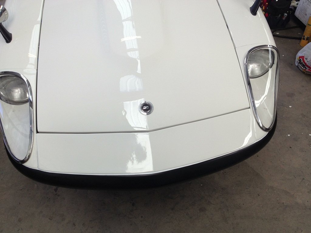

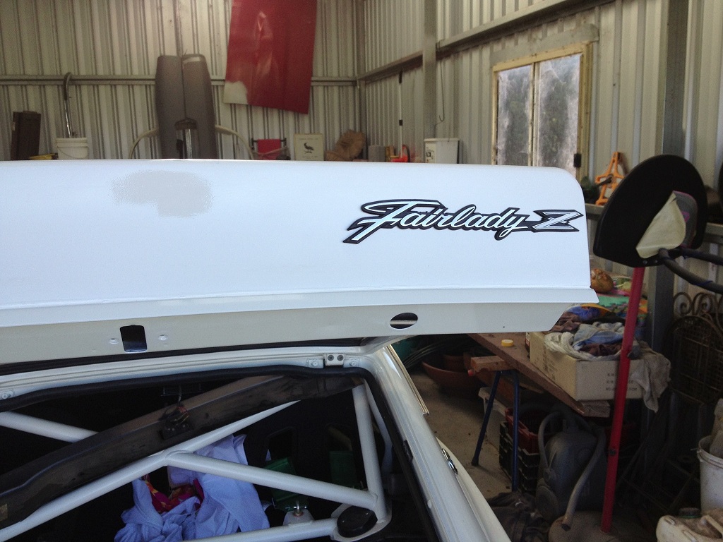

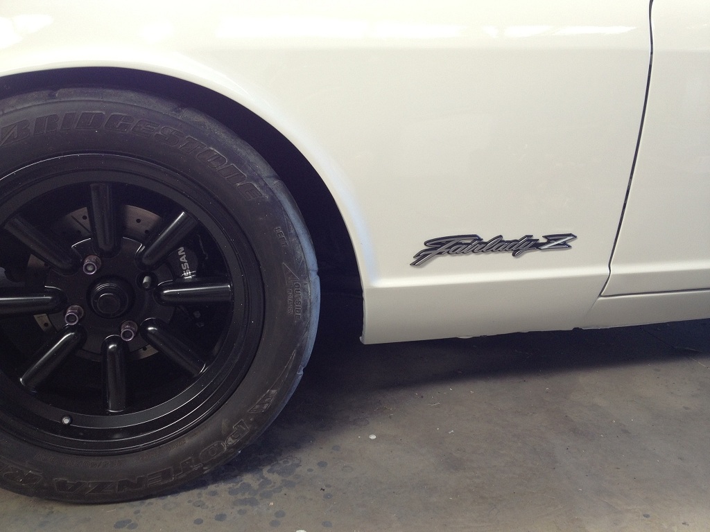

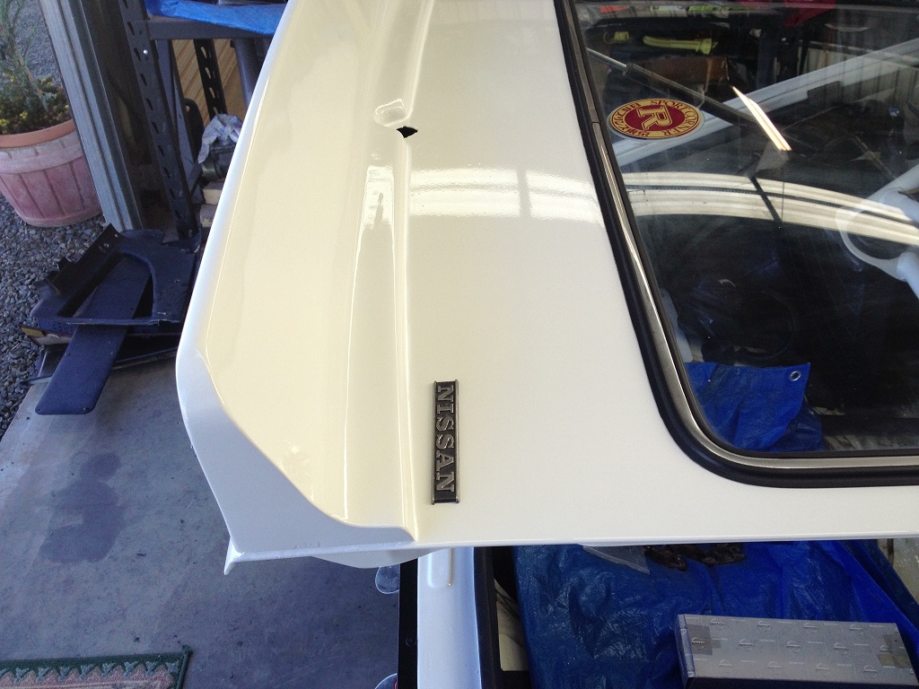

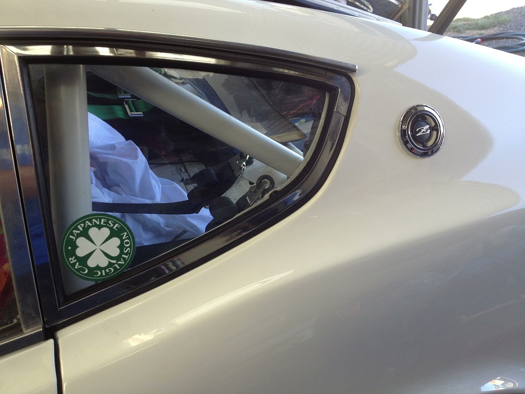

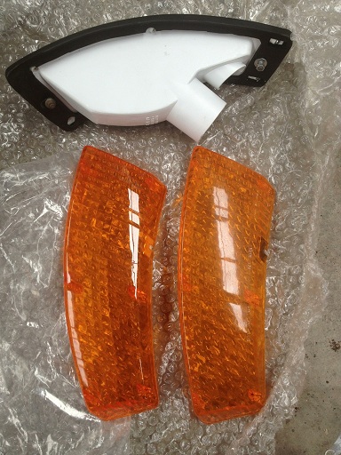

All New ginuine nissan badges fitted (nissan hatch badge still to arrive). Tig welded 1/4 window frames, linished and fitted with new inner/outer seals, man these were a damn tight fit!!!  All Z parts rear window seal fitted, no issues with the trim lip. New door handles drilled and fitted. New front park/turn signal light and lenses fitted with foil tape inside for added brightness as per rear tail lights. The new lens is on the left and old is on the right. New door trims fitted with aluminium drilled window winders to match the door handles. Fuel tank cleaned up and painted with epoxy satin black, Also did all catches/latches/strikers to match color scheme.
Definately at the nationals
No Tim haven't received those yet, I'll keep them as spares. The park/indicators are new ones I got several years ago, I haven't seen the eBay type. Are they any good?
I bought the ebay type us spec ones back in 2007. Perfect fit and cast a really retro light in the evening.
How have they held up Mark, Is the plastic/rubber quality as good as oem?

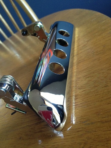

Nice buld mate, had a few quiet hours at work this morning so it was a pleasant read. One question - the louvered inspection lids, Ive been hunting for a long time on Ebay USA for these. Did u buy them or flute yourself???
They still look new  but they didn't come with rubbers. I just used the ones i had.
Do they have reflector panels inside them?
They didn't have the panels inside them but they can be fitted.
I got them from Ebay USA, but I have seen them on Yahoo Auctions Japan too.
Nice to know Mark, they sound like a good replacement for worn out originals.

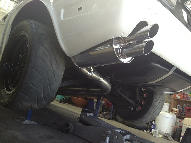

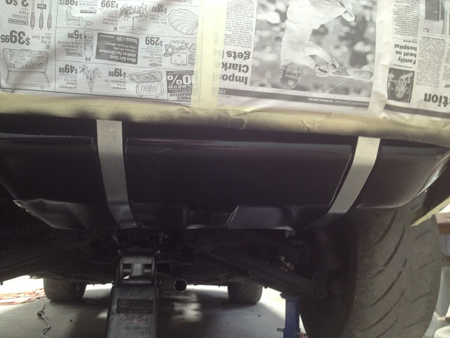

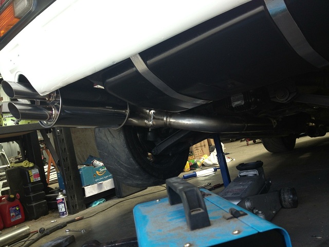

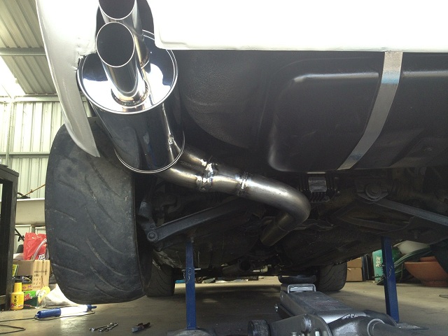

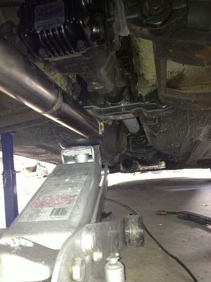

Started on the new exhaust. Decided to do it in 3" from the headers back, just as well I did... The exhaust shop did my system a many years ago and it was meant to be 2.5". The centre(only) muffler was 2" with 2.5" welded over the top, seems very restricitve to me? Not bad for gasless mig. It's only mild steel pipe for the time being, budget is being redirected for new tyres.

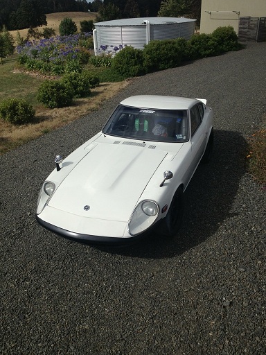

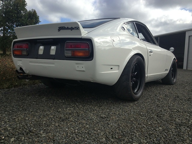

Yes that's right, even more crappy Iphone pics of basically the same car. Mmmmmmmm dusty :P

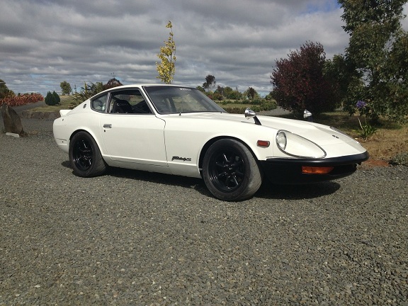

Genuine ZG's have a color coded rear bumper such as grey/black. I'm tempted to try it, not sure though? Chrome always looks great.
Love the muffler 432r style. Where did u find it?been looking for one.
Colour code the rear bar to match the front lower section. Also mirrors in matt black.
Are they watanabe wheels?
Looks great love to see it in person.
Car looks great.

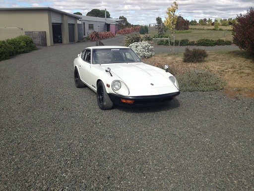

On an unrelated subject:  How do you keep you driveway looking so neat?  Is it very new?  Mine is from the same material and looks like crap after only 12 months  :'(
