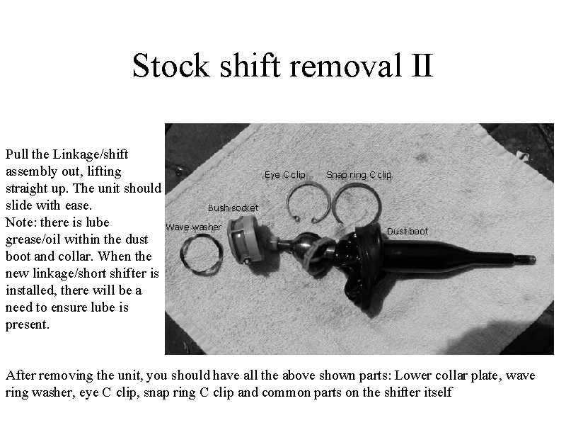

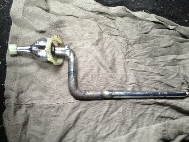

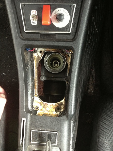

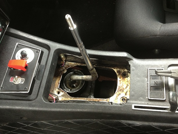

Riceburner Posted August 24, 2013 Author Posted August 24, 2013 Nice work Gareth. Cant wait to hear it now on the track screaming past. One day. Hopefully soon mate, It's been far too long! I have modified the shifter to fit and use the OEM shift boots, It' a hybrid of the RB base with my old Z stick as the top. The old stick was already offset as I was running a 260 box in an auto car, all I had to do was weld this onto the RB 'ball' and I have plenty of clearance. The trans tunnel is a mess, this was the hack job done by the people who did the manual conversion previously. Once the rubber boot goes on it still manages to cover the butchered part of the tunnel luckily. Kameari crossmember is ordered, hopefully this will solve the vibration @ 100kph. Kameari said this mount is only suitable for post September 72 Z's with the 71C conversion. Regarding the shifter, It appears I am missing the 'wave washer', 'snap ring C clip'. Anyone know part numbers or better yet have some they aren't using? I want two wave washers, this will tighten up the feel a lot. Did I say how awesome this box is, the ratios have transformed the car! Quote

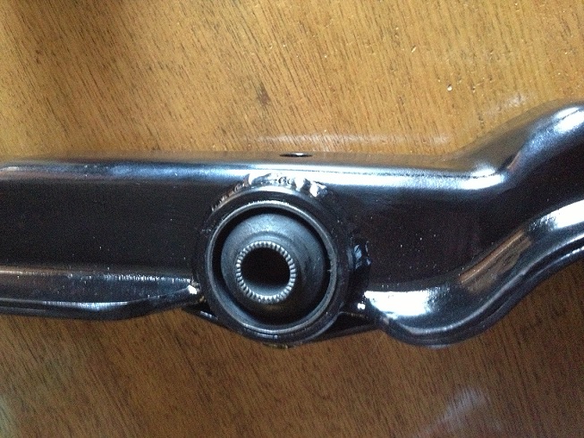

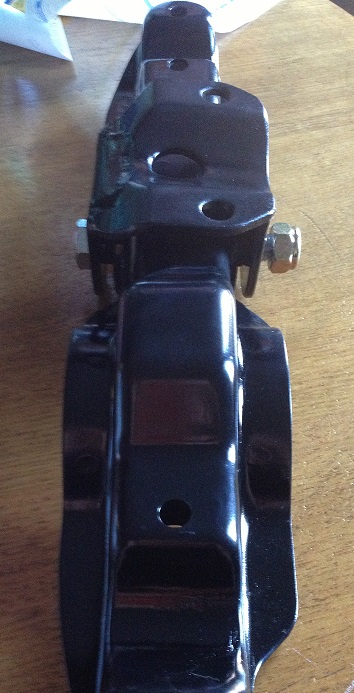

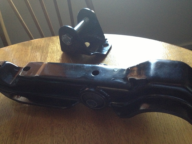

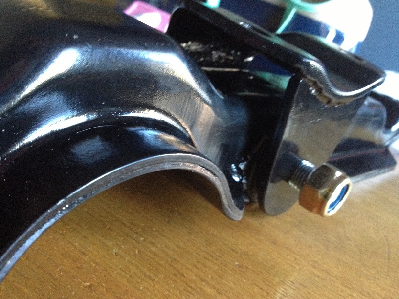

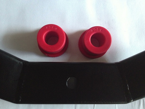

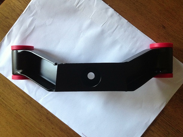

Riceburner Posted September 3, 2013 Author Posted September 3, 2013 For those of you looking at doing this gearbox mod here's some pics of the Kameari mount, Much nicer than I could manage. Once again this is only suitable for post September 72 Z's using the 71C gearbox. It has some urethane bushings in it, but they may as well be solid steel I'm thinking of putting my urethane bushes in but these Kameari ones look smaller. Anyone know the stock bushing O.D.? These are 31mm od and have 4066 stamped into the face. Quote
d3c0y Posted September 4, 2013 Posted September 4, 2013 ill buy your poly ones if you dont end up using them. I need a pair for my x-member Quote
Riceburner Posted September 4, 2013 Author Posted September 4, 2013 If my current poly ones fit and if these are the same size. You can have em Jake Quote

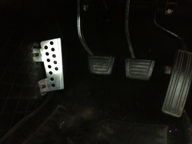

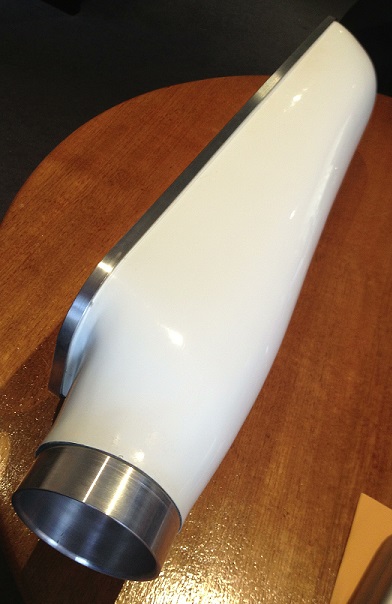

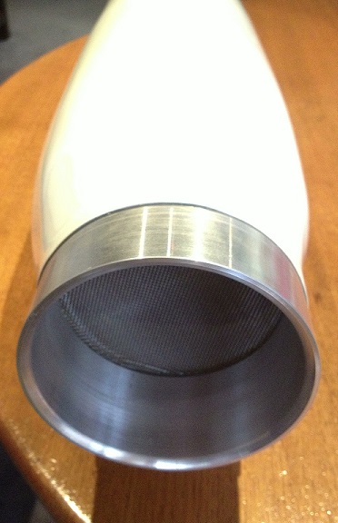

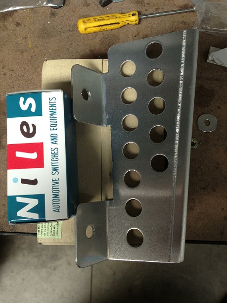

Riceburner Posted October 13, 2013 Author Posted October 13, 2013 Does it ever end? I'm going the airbox route for the intake on the engine, the socks are giving me the sh!ts. I'll copy Alans setup and duct the airbox to a 280z airbox with a K&N or uni filter. The airbox is from R-factory Japan, a suggestion from Nzeder got my interest, Alan (HS30H) runs it on his gorgeous 240ZG and was kind enough to take some measurements for me. According to my measurements I'll need some 20mm billet machined spacers to clear the upper bodies of each FCR carb, other than that it should go in nicely with a minimum velocity stack of 80mm hopefully more. I also got a great little aluminium dead pedal from them, It's meant for a KGC10 skyline but fits my S30Z perfectly and a lot more comfortable than the factory 'Lego Brick' I finally managed to get the reverse lights working with a new switch, I think I may have fitted a neutral switch from the RB box and then the OD switch which didn't work either. Whoops! EDIT: After reading horror stories of the diff solid mount I have removed it and fitted an OEM rubber mount with the RT urethane snubber trimmed. Guess what, the Vibration is back > That's it I'm going with a Stuart Wilkins style captive diff mount, It'll be bullet proof even if the bush fails! Quote

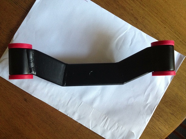

Riceburner Posted October 31, 2013 Author Posted October 31, 2013 Is it a crossmember is it an insulator is it a captive diff mount It's all of them and none at the same time That's right, this vibration is slowly making me more batty than I already am But will it fix the problem... I've also rebuilt both half shafts with new heavy duty hardy spicer uni joints. To be continued, same bat channel, same bat time. Kapow! Biff! Wack! Quote

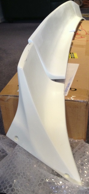

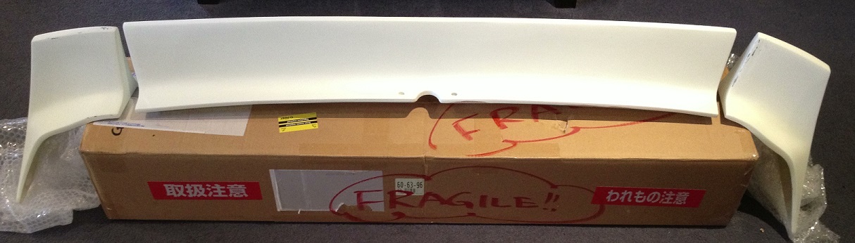

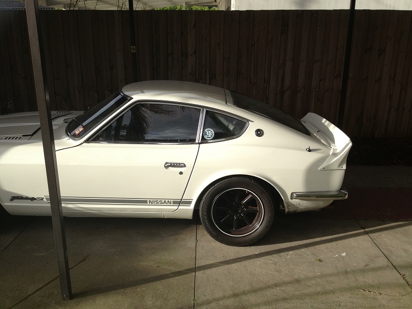

Riceburner Posted November 13, 2013 Author Posted November 13, 2013 nice work Gareth will be looking doing something similar when time come for my cars. none of them will have stock engine power and original setup is crap. Thanks mate, It fixed the vibration, Yay! I may do the same with the g/box crossmember, that way everything is captive and will last for a very very long time. Marugen Shokai works style rear spoiler finally arrived. Wow, it was worth the wait. Best quality fibreglass I've ever seen, finish is great and looks ready for paint straight out of the box Those others that ordered this will be very happy campers! With a bit of luck I'll get it painted this weekend Quote
