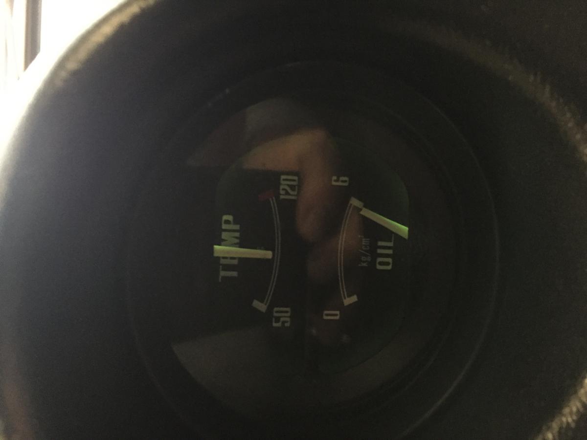

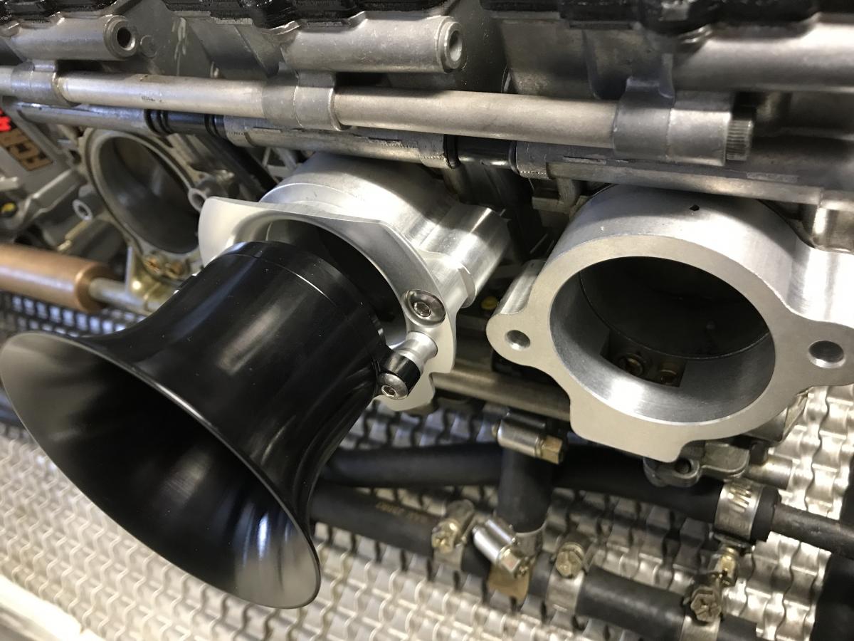

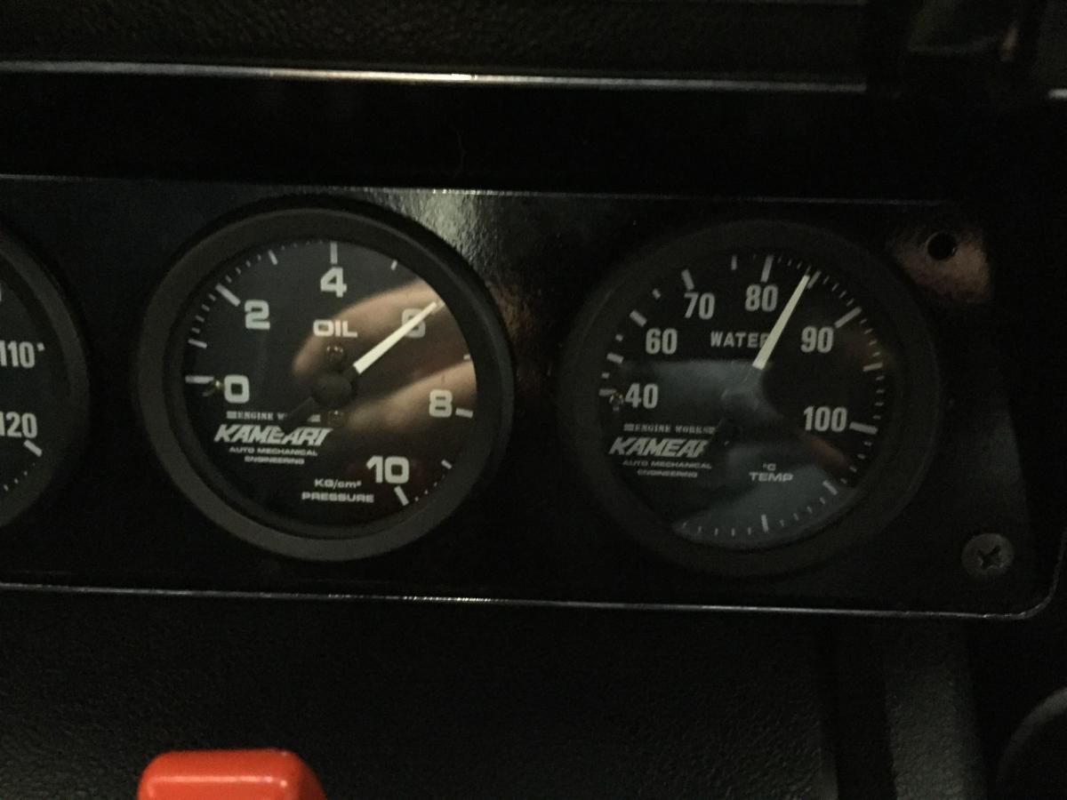

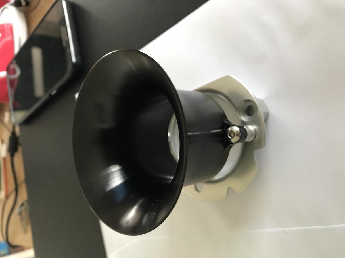

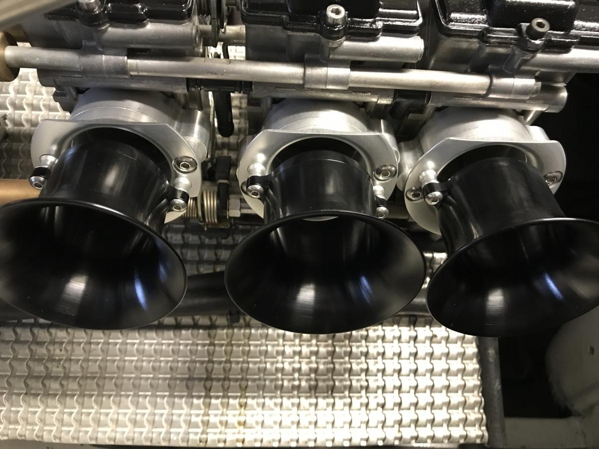

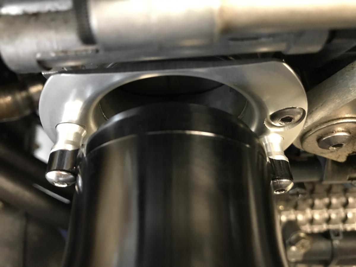

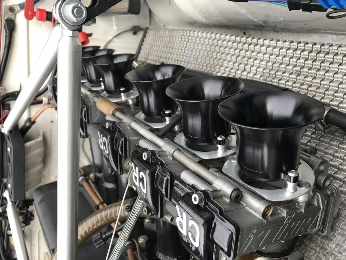

Riceburner Posted November 15, 2017 Author Posted November 15, 2017 (edited) Got the new metric factory gauge setup fitted and it seems quite accurate compared to the Kameari set. Also fitted some Yoshimura 'dual funnel' ram tubes. Supposedly gives the best of both worlds, short stack is 10mm then the second stack is 65mm long. I have a 20mm CNC'd spacer that will add to the lengths and allow me to run an air box or ITG filter down the track. The body of the carbs are angled and won't allow an air box or backing plate to bolt up without interference issues. Edited November 15, 2017 by Riceburner gav240z 1 Quote
d3c0y Posted November 15, 2017 Posted November 15, 2017 You need to head to a dyno with those stacks. I'm so curious to see if they work! Quote
Cozza Posted November 15, 2017 Posted November 15, 2017 You need to head to a dyno with those stacks. I'm so curious to see if they work! Me too Quote
Riceburner Posted November 15, 2017 Author Posted November 15, 2017 You need to head to a dyno with those stacks. I'm so curious to see if they work! Me too Yeah me too, I haven't even dialed in the cam yet. Lol Quote

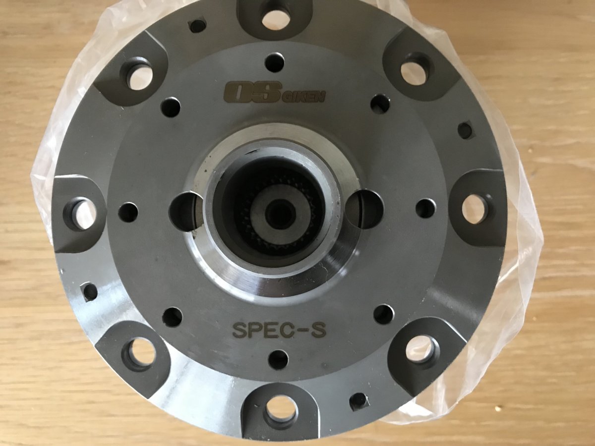

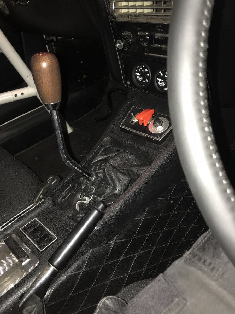

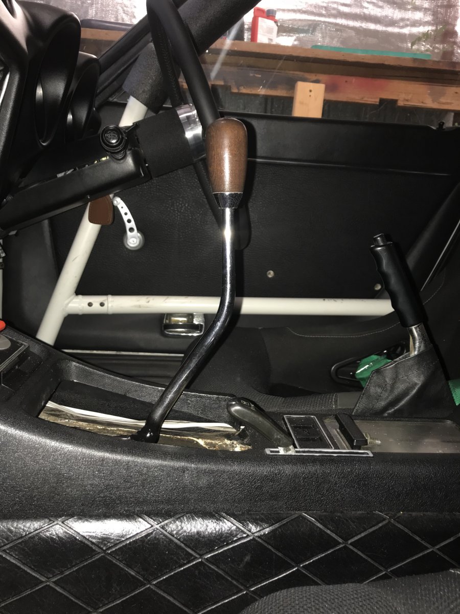

Riceburner Posted August 1, 2018 Author Posted August 1, 2018 Managed to get a little shed time, I always felt the shifter was too close to the dash. So I chopped a bendy shifter and welded it to the current one. Result is a much better position, it’s taller too for that old school feel. Also, the OS Giken super lock has arrived! I might have a go at setting this one up myself using Nissan’s Yellow bible, if I can’t figure it out I’ll drop it off to Chris Wood. He’s always done a great job on my diffs in the past and he’s cheap too. The Torsen centre will be for sale on here soon. C.A.R., Ponyo240z and hmd 3 Quote

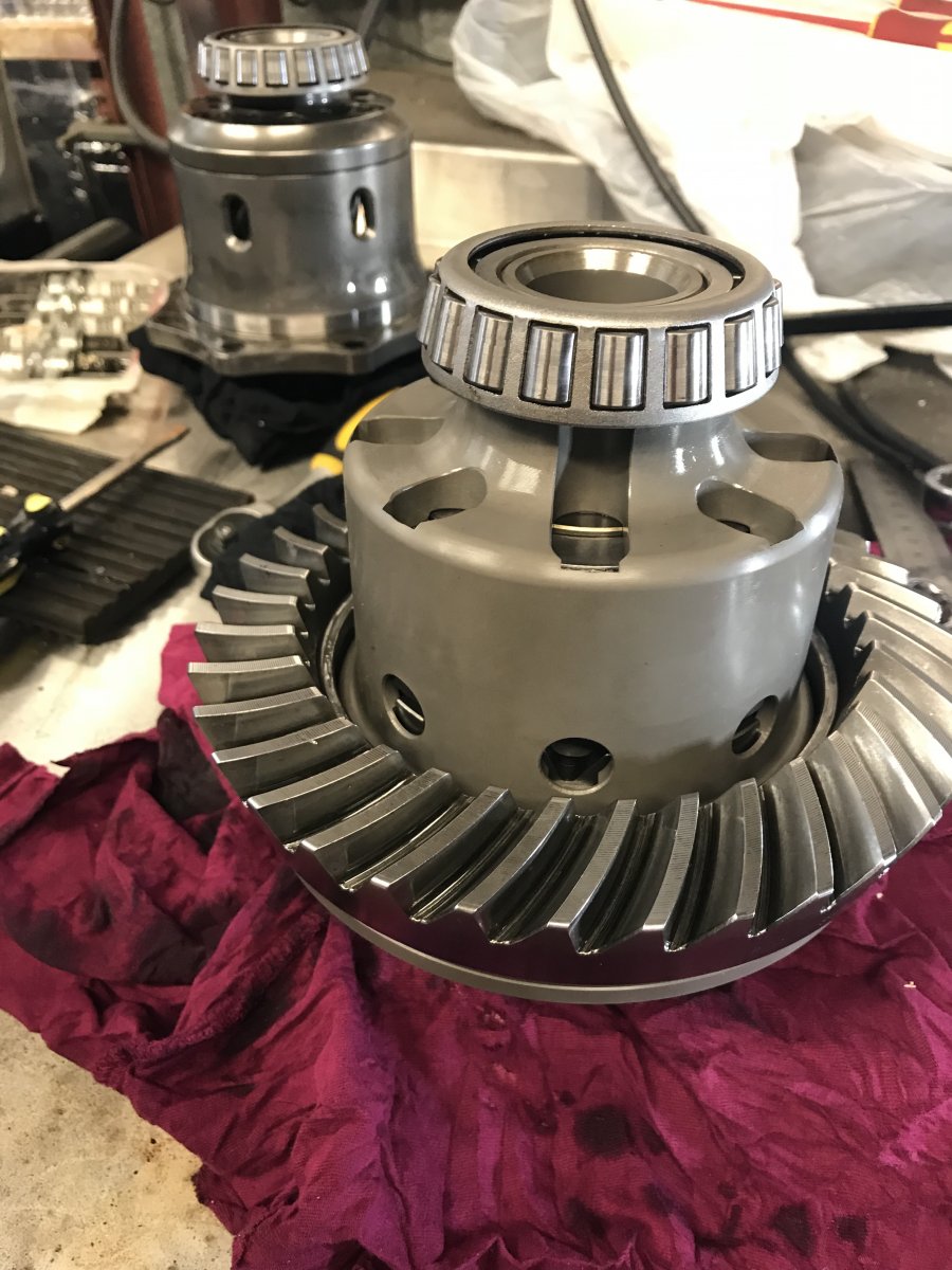

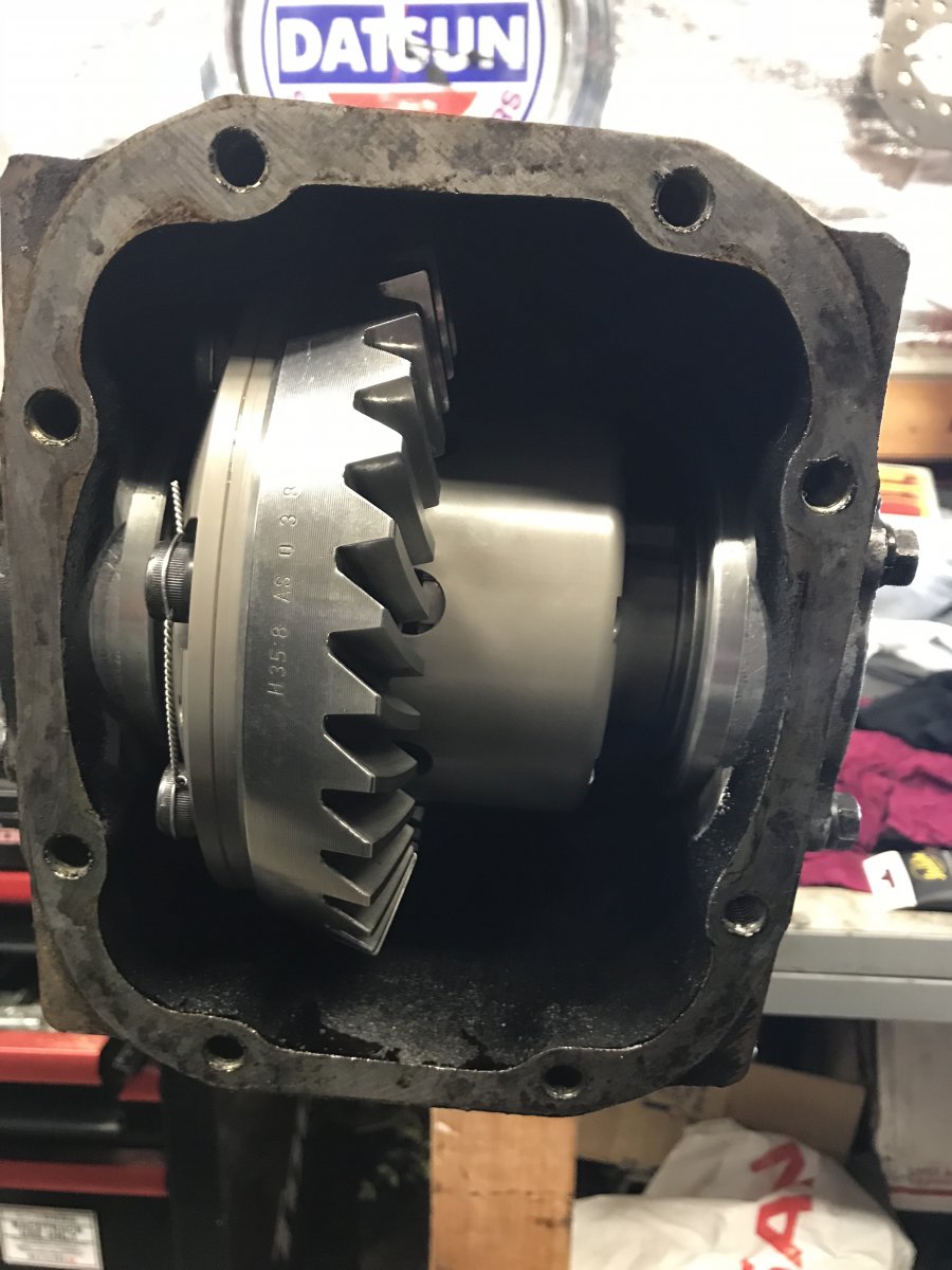

Riceburner Posted August 12, 2018 Author Posted August 12, 2018 Old Torsen diff centre out and sold. Came out in very good condition, magnetic drain plug was spotless and no signs of wear. OS Giken super lock installed and lock wired. I used a bearing heater to install new bearings, so much easier than pressing them on, new seals and the special Subaru diff cover gasket with the baffle in front of the breather. All wipe patterns and specs checked out. 1.3L of OS-250R oil. Short test drive, you don’t even know it’s there! Quote
