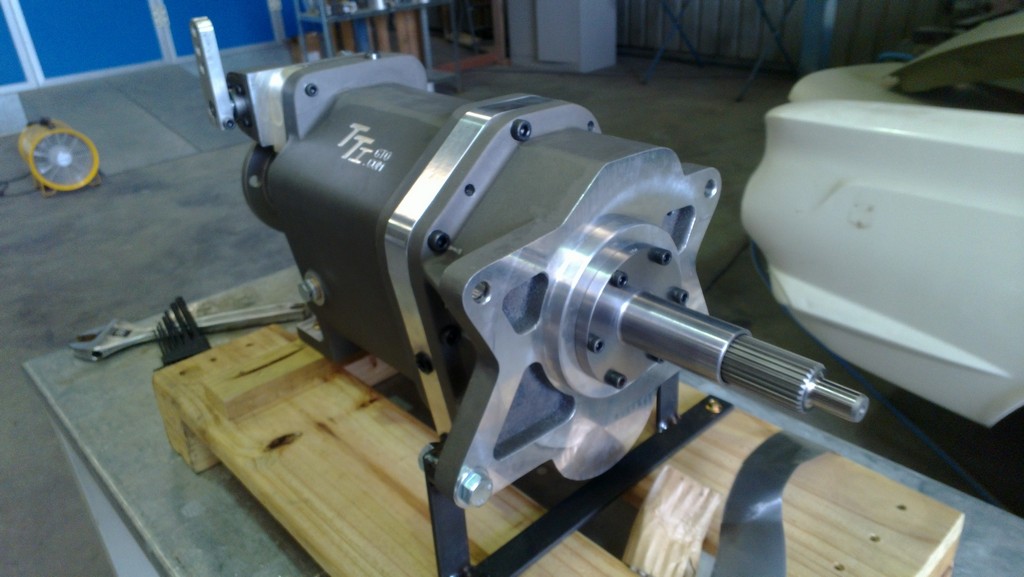

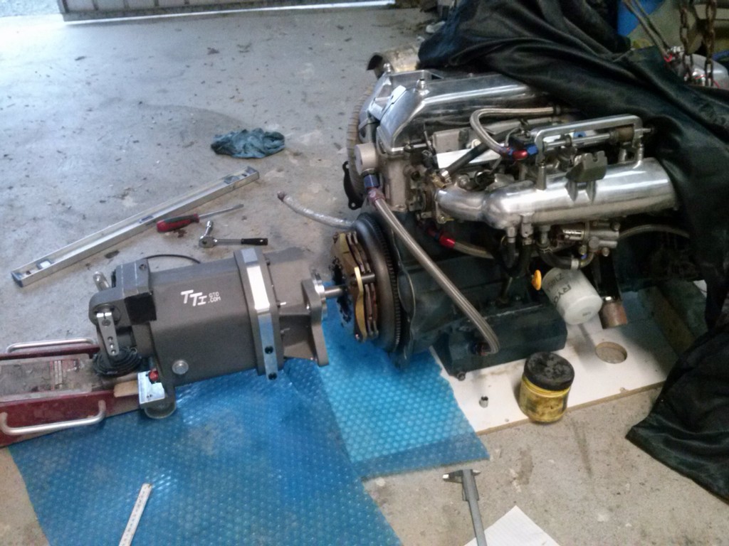

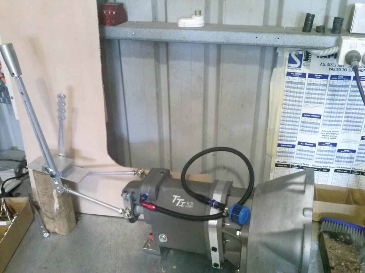

Ledge Posted August 11, 2013 Author Posted August 11, 2013 Well just fitted the custom spigot bush and sat the box on without bell housing to check clearances. Now just have to fit the Tilton internal slave and on she goes. Quote
Fairlady Z Posted August 11, 2013 Posted August 11, 2013 That is some serious gear there. Cannot wait to see it in person. Quote

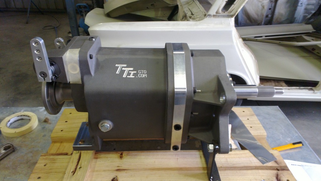

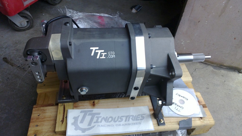

Ledge Posted August 19, 2013 Author Posted August 19, 2013 Its more I cant see the point of replacing standard RB box over and over. Or spending 7+ on a ppg gearset, abit extra got this 6 speed 1:1 sequential. Cant wait to put it in. probably this weekend. Quote

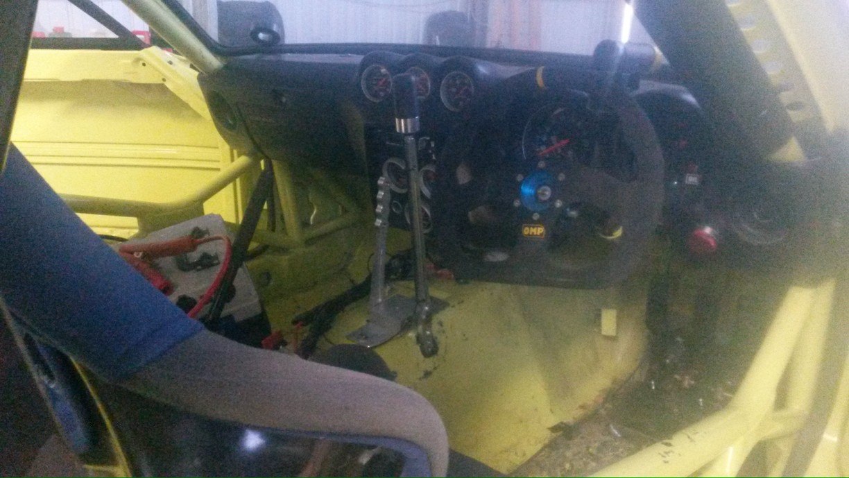

Riceburner Posted August 20, 2013 Posted August 20, 2013 Now that's a gearbox! Forgive my silly question but what are the two shifters? Quote
Ledge Posted August 20, 2013 Author Posted August 20, 2013 The tall one goes from nuetral to 6th, the small one will engage reverse. But only when other is in neutral. Great idea i thought so when you slamming back down through the gears you wont hit reverse. Quote
Riceburner Posted August 20, 2013 Posted August 20, 2013 This thing is gunna be even more of a blast to drive, can't wait for some more in car footage. Is there any special maintenance required to keep the box in good working order or is it just set and forget? Quote
sexual_sushi Posted August 20, 2013 Posted August 20, 2013 I reckon you could make your money back on it chargin people to go for a test drive Quote
Ledge Posted August 20, 2013 Author Posted August 20, 2013 This thing is gunna be even more of a blast to drive, can't wait for some more in car footage. Is there any special maintenance required to keep the box in good working order or is it just set and forget? Yeah I think first time out I wont have my good pants on that's for sure. Apparently the Dog rings are good for 1000 to 1500 hard race KMS. so for me that's probably 5 years. Another set of rings are around $600. They recommend a particular oil and to change it every 300 kms. about $80. I have a video that shows strip and rebuild of box, 45mins. very simple internals. So I can easy fit them myself After market ECU = yes. not 100% sure if it is flat shift capable. if not there is a good setup from England that is a stand alone unit so may go that way if my ecu cant do it. Incar footage will be uploaded. Cheers Paul Quote

Ledge Posted September 28, 2013 Author Posted September 28, 2013 HI Chaps That would be a valid banning to mate. Well its all back together and ready to go. Just need to put the stripe back on the bonnet and some logo's. Will try to get on Dyno this week for a look over. but im ridiculously busy at the shop so will do my best. ECU has been modified by Microtech to flat shift and have fitted Holinger Knob I will video and post asap. first event is just the Nissan Datsun SA Club hill climb at Collingrove in a few weeks. Cheers Paul Quote

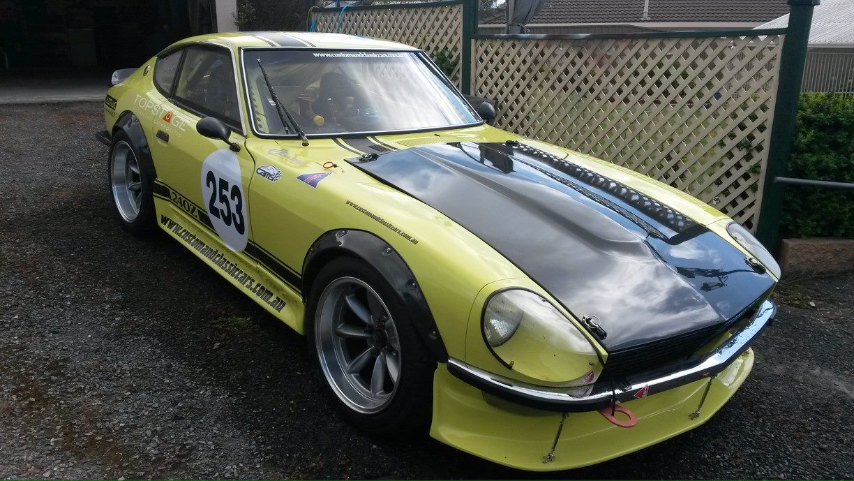

chartoo Posted September 29, 2013 Posted September 29, 2013 Where did you get the side skirts? They are nice. Quote
dat240z Posted September 29, 2013 Posted September 29, 2013 Forgive me if this seems a silly question, but this thing surely must be the quickest z in aus? Its uber cool Quote
Ledge Posted September 29, 2013 Author Posted September 29, 2013 Chartoo, Check with Ash from Moorabbin Auto Spares. They where on the car when I got it from him years ago but ive modified them a little. Dat240z. Can off worms there mate, There are some quick Z's around for sure. Cheers Quote
KatoKid Posted September 29, 2013 Posted September 29, 2013 fitted Holinger Knob I love a good knob! Can you adjust sensitivity of said knob? Quote
Ledge Posted September 29, 2013 Author Posted September 29, 2013 I love a good knob! Ummmmmmmm You can get adjustable ones yes Quote
