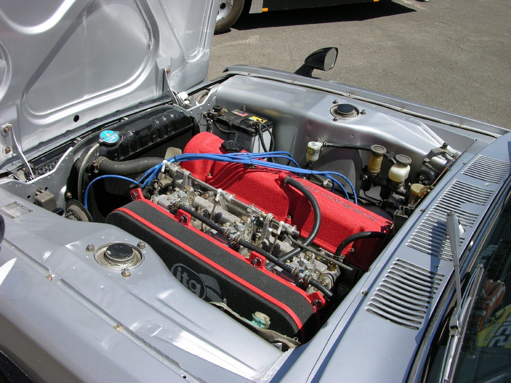

Ledge Posted June 26, 2015 Posted June 26, 2015 I got this from Motorsport Auto. Was pricey but looks good and we done back to back dyno runs to check its restriction and it didn't change a thing. Stacks fit on underneath. Quote
mossy Posted June 27, 2015 Author Posted June 27, 2015 I got this from Motorsport Auto. Was pricey but looks good and we done back to back dyno runs to check its restriction and it didn't change a thing. Stacks fit on underneath. Can't they still catch fire though Ledge? There is a couple of other options I'm looking at, the MJP cold air box http://www.mjpshop.co.uk/index.php?route=product/product&path=155_78_113&product_id=437 Gavin strongman airbox which I think alfa motorsports make http://www.viczcar.com/gallery/albums/cc04/IMG_1121.jpg also Mike NZeder was making a prince GTB airbox, although just wondering how well this one would work as it was designed for a 2lt motor. Quote
Ledge Posted June 28, 2015 Posted June 28, 2015 Well i guess they can. The foam is a lot finer on these than the typical sock so you dont need to spray the sticky oil shit on them. So i would say that would help minimize the chance of flames. Quote
Brabham Posted June 28, 2015 Posted June 28, 2015 There are also fine mesh filters that clip on the intake stacks, that could be a good option too. Quote
mossy Posted June 28, 2015 Author Posted June 28, 2015 Well i guess they can. The foam is a lot finer on these than the typical sock so you dont need to spray the sticky oil shit on them. So i would say that would help minimize the chance of flames. Looked into them and it seems they have a inner layer of self extinguishing filter foam, cost with the backplate will probably be about $400 so I'll weigh this up against the cost of a airbox. There are also fine mesh filters that clip on the intake stacks, that could be a good option too. I've seen those too Brabham but I think they can still let dust into the engine. Quote

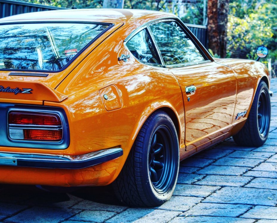

Sirpent Posted May 19, 2016 Posted May 19, 2016 Not every color works on the S30's, but this has to be one of the best ! mossy 1 Quote

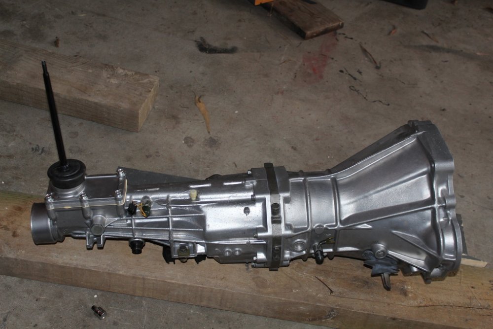

mossy Posted July 2, 2016 Author Posted July 2, 2016 Back on the road again thanks to a fully rebuilt SR20 gearbox with LCR short shifter from Les Collins Racing. Thanks Les and Locky Zedhead, gav240z and Sirpent 3 Quote
Administrators gav240z Posted July 2, 2016 Administrators Posted July 2, 2016 Nice what are the ratio's like in that thing? Quote
mossy Posted July 2, 2016 Author Posted July 2, 2016 I'm not sure exactly what the stock ratios are Gav but for sunday driving they feel fine to me. Once funds allow I'll probably get a kameari close ratio gearset but for now I'm happy, all new Nissan syncros make the shifting miles better, along with the LCR short shifter Quote
