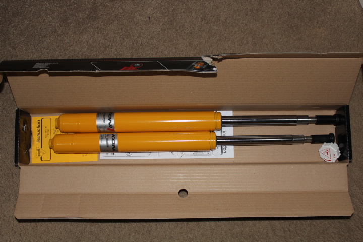

mossy Posted February 5, 2014 Author Posted February 5, 2014 Well I did stop by top performance today for a chat about some yellows but Barry wasn't there so I thought while I'm here.... Quote
George Posted February 5, 2014 Posted February 5, 2014 Nice. Matches your car colour! That's the main reason you bought them right? Quote
Riceburner Posted February 5, 2014 Posted February 5, 2014 Sport or Race Mossy and do you know the difference? Also what is length of them? Quote
mossy Posted February 5, 2014 Author Posted February 5, 2014 Nice. Matches your car colour! That's the main reason you bought them right? Of course! Sport or Race Mossy and do you know the difference? Also what is length of them? These are the 8641-1060 sport Gareth, not sure of the difference between them, the length of the body is just under 365mm Quote
