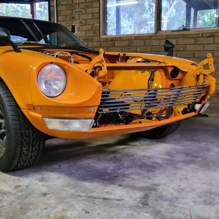

mossy Posted April 25, 2010 Author Share Posted April 25, 2010 Well the v8 zed has been put on hold for a while so it looks like this one is getting a lot of the parts I bought, I've already taken the sunroof out and paint stripped the roof in preparation for Rob at the z factory to fill the hole. Next will be to take out the entire drivetrain and the clean the underside in prep for a full coating of KBS then all my resprayed gloss black suspension parts with coilovers to go back in, also I will be stripping the body back to bare metal to give a new coat of paint (audi papaya orange maybe?) I've also got another new set of new Watanabes on the way, 16x8 0 offset in silver. Quote Link to comment Share on other sites More sharing options...

mossy Posted February 1, 2011 Author Share Posted February 1, 2011 Haven't posted here in a while so here is a progress report, z is currently undergoing rust repairs which will be finished and car sandblasted this week and ready for panel work next week.,the inside and undercarriage will be spray coated in KBS coatings. A lot of body spot welds were drilled out so they could be sandblasted and KBS coated underneath, the firewall and inside the skuttle was totally pulled apart, sandblasted, rust sections repaired and then KBS coated. I've aquired virtually all of my parts over the past year or so there will hopefully be no messing around searching for parts and almost all suspension etc has already been painted and assembled. Dash has been reskinned, seats redone and a nice set of 16x8 0 offset watanbes are ready to go on but I think I may have bought the wrong colour(silver, polished lip) I've still yet to get the L28 built (need to save more money), the matching numbers L24 will be stored away. The motor will be a F54 block 87.5mm flat tops, N42 head with 74degree hi lift cam,kameari adj cam pulley, ATI balancer, match ported kameari manifold with triple 45mm OER carbs. I hope to have the body finished and in paint in the next few months as our baby is due in June then I can just go to the garage and assemble as time allows. More pics to follow. Quote Link to comment Share on other sites More sharing options...
