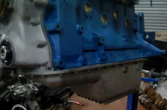

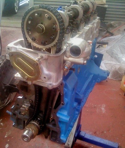

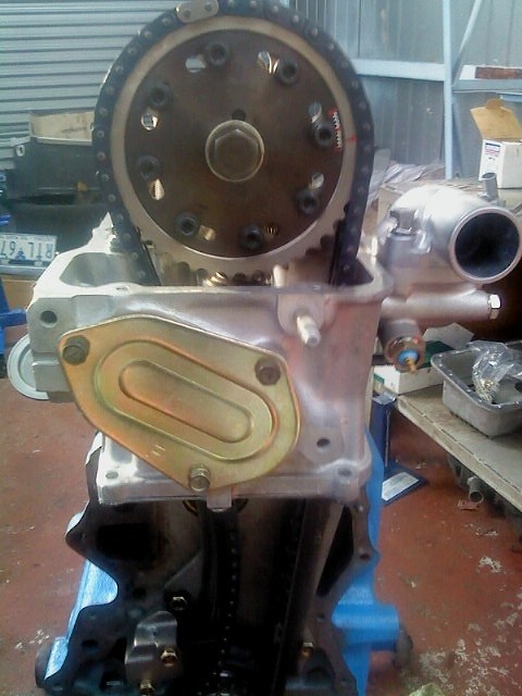

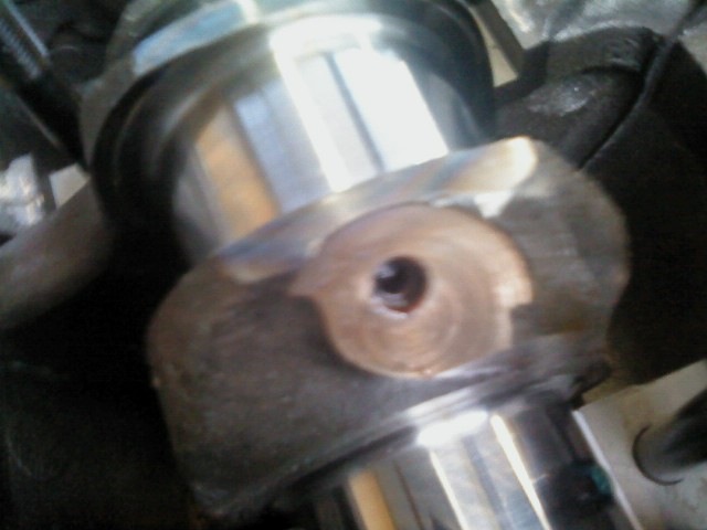

peter mc Posted April 30, 2011 Posted April 30, 2011 Just a few pics of the motor going togethet Mossy. The pic of the crank shows the screw in plugs and the ARP studs. Quote

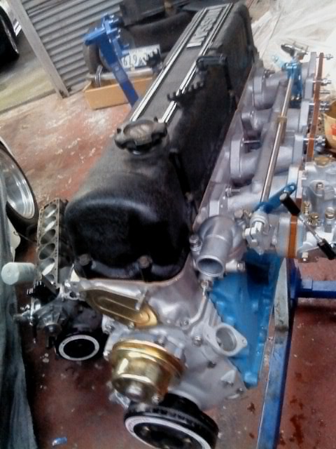

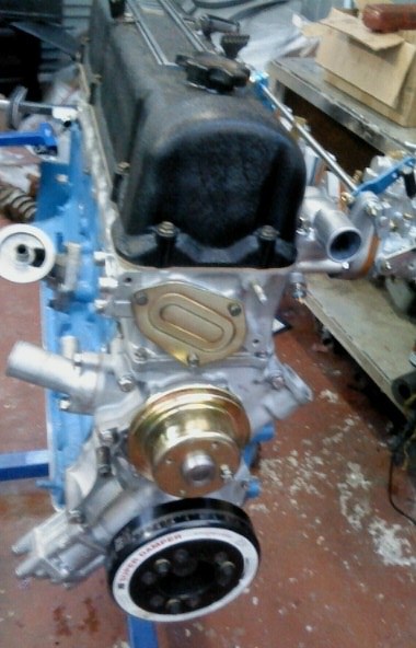

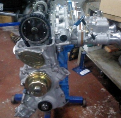

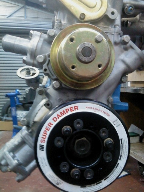

peter mc Posted May 7, 2011 Posted May 7, 2011 Hi mossy just need to no if you are runing a electric pump on it or not .hope you like the pics Quote
Scoota G Posted May 7, 2011 Posted May 7, 2011 Niice, looks like the cam is yet to be dialed in. Quote
mossy Posted May 7, 2011 Author Posted May 7, 2011 Thats gonna look sweet in my orange engine bay Quote
peter mc Posted May 7, 2011 Posted May 7, 2011 No that's the position it been dialed in ,will be a tuff L28 580th at the valve 280deg wade cam 45mmOTR carbs 10.5 comp all the good stuff will be a fast road car. this is number 10 . 10 l28s this year so far only 4 more in the shed to go ..... arrr Quote
Scoota G Posted May 7, 2011 Posted May 7, 2011 Gee those carbs and sump look HoT, pure Porn. Stuff the EFI. Quote
Sirpent Posted May 7, 2011 Posted May 7, 2011 Great work Pete. For someone that can get the best out of these motors, you also make them look simple but sweet from the outside also. Quote
mossy Posted May 9, 2011 Author Posted May 9, 2011 Looks great Peter look forward to picking it up soon Quote

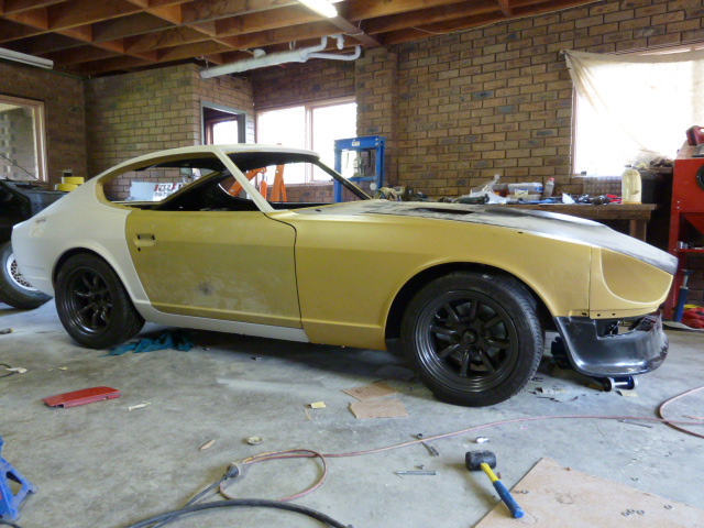

mossy Posted September 3, 2011 Author Posted September 3, 2011 Time to get back on this project or I'll never get it finished, so i bolted up the panels today to see if the gaps were good before the rest of the filler work is done on the body, as you can imagine it needs some tweaking but hopefully the beater can finish it off nicely. I also took off the front r33 caliper front disc conversion and placed the standard calipers with slotted rotors back on, the bigger setup was originally made for my 16x9 watanabes but I'm only going to use this on the street now so there's no need for it, I'll still be using the r31 disc conversion though. Quote

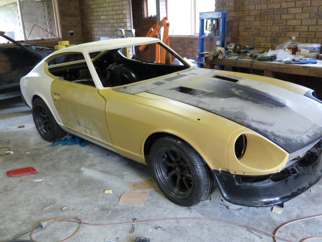

mossy Posted December 10, 2011 Author Posted December 10, 2011 We started working on the 240 again this week so happy to report progress is being made, looking like it will be in primer by xmas. Not sure if I'm being too fussy about gaps though, the door and gaps were being worked on today (aftermarket dog legs not helping the matter) got the gap uniform at the fender but the rear qtr was proving a pain, got to the stage were I was pretty happy with it but now I'm having second thoughts as it tapers out slightly at the top. Quote
Moderators Zedman240® Posted December 10, 2011 Moderators Posted December 10, 2011 Don't forget these cars were hand made new so door and other panel gaps weren't up to today's standard! Get them as close as you can but don't stress. Quote
zzzzed Posted December 10, 2011 Posted December 10, 2011 yes panel gaps are shocking on these cars from the factory. I wouldn't be over concerned. I got mine better than standard. I didnt realise this until i started checking out other peoples gaps. I ended up splitting and re welding the dog legs to make the door gaps better. But if i hat have realised how bad they were from the factory i would not have bothered Quote
mossy Posted December 10, 2011 Author Posted December 10, 2011 Had to do the same split and reweld to the dog leg as it off from the door. I might go to the garage and stare at the gap a bit more to see if I'm happy with, better to change my mind now than when its painted Quote
