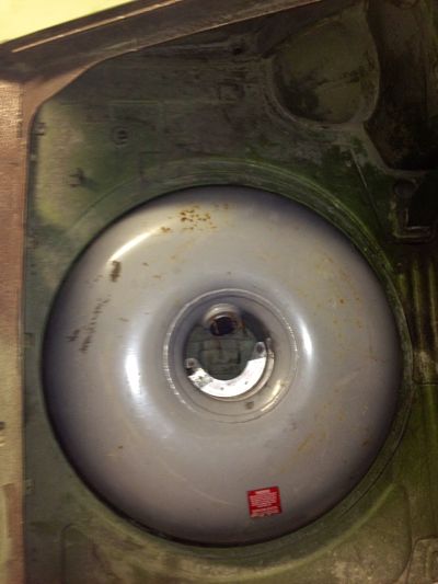

luvemfast Posted October 24, 2012 Posted October 24, 2012 How many donuts do you want to carry? Guess it will be a good base to modify into a fuel tank. But, how big is it? You may be driving from suburb to suburb, refuelling at each, with 300+ ponies Quote
Sirpent Posted October 24, 2012 Author Posted October 24, 2012 How many donuts do you want to carry? Guess it will be a good base to modify into a fuel tank. But, how big is it? You may be driving from suburb to suburb, refuelling at each, with 300+ ponies Suprise suprise Its 650mm in diameter, 265mm deep and has a water capacity as stated by the seller of 61 litres, add the neck capacity and then some when I change the centre from a donut to closed congigurations and Id say close to 65 if not more litres. I think its a pretty good solution. Cheers John Quote
lightmaster240z Posted October 24, 2012 Posted October 24, 2012 Nice buy John $5.50 for the tank $200.00 to get tested and fix . Quote
jamo240 Posted October 25, 2012 Posted October 25, 2012 Where is the spare wheel going to go? Jamo Quote
Sirpent Posted October 25, 2012 Author Posted October 25, 2012 Nice buy John $5.50 for the tank $200.00 to get tested and fix . No testing nor certification required as it wont be holding LPG LOL Where is the spare wheel going to go? Jamo Jamo Spare wheels are no longer a legal requirement, so either a can of puncture repair, a large phillips head self tapper and screwdriver, or a space saver wheel to sit inside above the tank LOL Cheers John Quote
jamo240 Posted October 25, 2012 Posted October 25, 2012 Fair enough. What are you planning to put in the space where the tank used to be? Quote
Sirpent Posted October 25, 2012 Author Posted October 25, 2012 Fair enough. What are you planning to put in the space where the tank used to be? Hi Jamo Mufflers with an aluminium heat shield above them to isolate heat sink between them and the pan. From the mufflers I will swing the twin pipes across so as they exit at the original Zed pipe point. Should also assist with the rear diff mounting as the M86 uses a rear mounting bush in an awkward place. Cheers John Quote

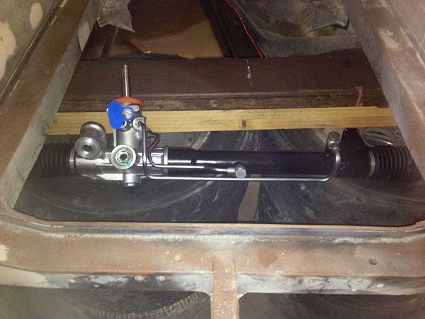

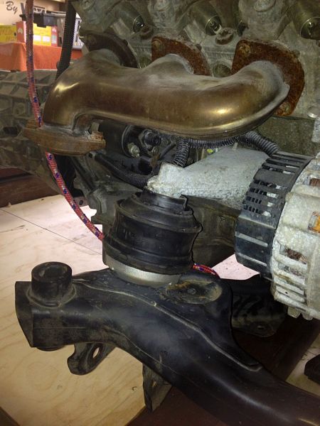

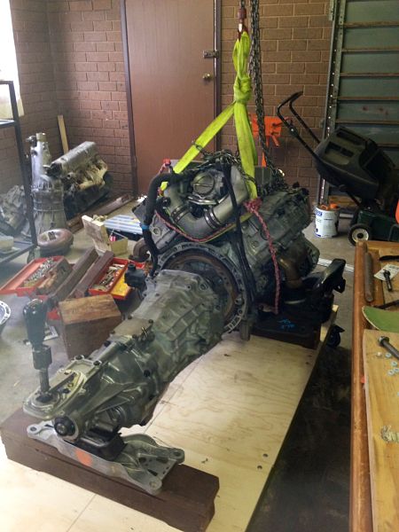

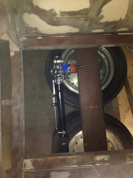

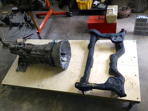

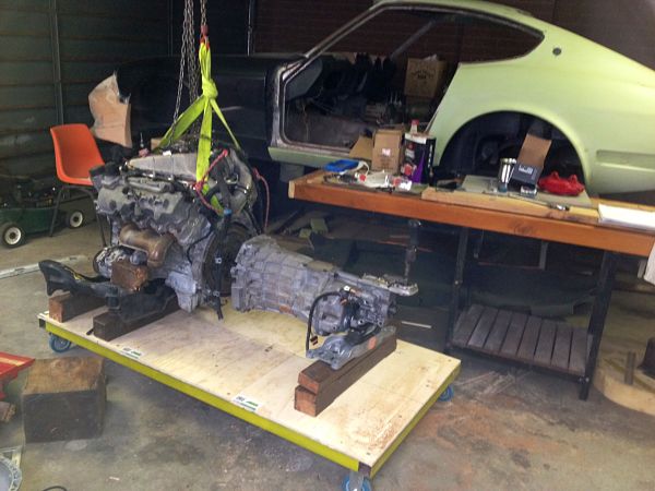

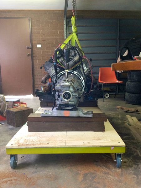

Sirpent Posted October 27, 2012 Author Posted October 27, 2012 Today's updates. Donut tank $5.50 ................................... Fit = Priceless FG Steering rack .................................... Trial plcement all looks great. Mounting of motor and trans to new mobile stand, less one engine mount which should be here by Wednesday, I'm transporting it to John at ARC on Thursday. Cheers John Quote
benny Posted October 27, 2012 Posted October 27, 2012 Today's updates. Donut tank $5.50 ................................... Fit = Priceless FG Steering rack .................................... Trial plcement all looks great. Mounting of motor and trans to new mobile stand, less one engine mount which should be here by Wednesday, I'm transporting it to John at ARC on Thursday. Cheers John wow nice job on the tank... looking forward to seeing that eventuate. Quote
Riceburner Posted October 27, 2012 Posted October 27, 2012 $5.50 for a 60lt tank with a factory fit, that's awesome. Great work John! Steering rack looks very close too. Waht are the details with this in terms of mods regarding rods ends, power steering etc. Could this be adaptable to stockish Z's? Thanks, Gareth. Quote
Sirpent Posted October 27, 2012 Author Posted October 27, 2012 wow nice job on the tank... looking forward to seeing that eventuate. $5.50 for a 60lt tank with a factory fit, that's awesome. Great work John! Steering rack looks very close too. What are the details with this in terms of mods regarding rods ends, power steering etc. Could this be adaptable to stockish Z's? Thanks, Gareth. Thanks guy's, The tank was a fluke find on EBay, dimensions were right, fit for my purpose, although a bit on the heavy side and probably wouldn't work out for "Speed Hunters or Track users" on this forum, but for what I'm after I'm happy. On the rack side, the rods are too long I'm afraid and will need to be shortened t fit, I'm estimating about 7Cm's each end but this wont effect the racks function as the rods are extremely long to start with. I don't think this will work for a standard Z cross member without some serious new bracketary work at the mount points, they are 65mm inward from each rail and use solid mounted bolts, no bushing material at all. The steering angle looks great, however I know I'm going to have problems nevertheless, so in my secret armory of suppliers, I'm planning to have a double Cardan jointed steering rod made up these blokes in Perth who Ive already spoken to. http://www.screwjack.org/cardanjoints.html Power steering pump wise, either the Benz pump, or maybe an electric Mazda pump, that's still up in the air. Cheers John Quote

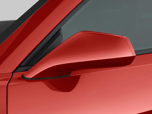

Sirpent Posted October 30, 2012 Author Posted October 30, 2012 Good evening Zedophiles. I know I'm boring you all to tears, but until that engine mount gets here (tomorrow) and I get the drivetrain to ARC on Thursday there wont be much tangable to report. So I thought I'd throw the cat amongst the pigeons, Ive been doing some shopping therapy, and came across an interesting set of door mirrors for $195.00 delivered, they are heated and fully remote, off the current Camaro. Opinions? Quote
Lukas Posted October 30, 2012 Posted October 30, 2012 Opinions? Keeping in mind how big the Camaro is compared to the Z (and that side mirrors seem to have gotten bigger over the years regardless), are you sure they won't look disproportionately large? Otherwise they look nice... Photoshop them onto a Z Luke Quote
lightmaster240z Posted October 30, 2012 Posted October 30, 2012 Me I like. Very German in style Quote
KatoKid Posted October 30, 2012 Posted October 30, 2012 On the rack side, the rods are too long I'm afraid and will need to be shortened t fit, I'm estimating about 7Cm's each end but this wont effect the racks function as the rods are extremely long to start with. John, what about the width of the rack itself? This needs to be somewhere close to the distance between the LCA mount pints to avoid bump steer issues, around 610mm from memory. Quote
dat240z Posted October 30, 2012 Posted October 30, 2012 Those mirrow would look great if not too large. Im on the lookout for a set aswell and came accross some nice f1 stlye carbon ones, roughly same price from states Quote
Agno Posted October 31, 2012 Posted October 31, 2012 Thumbs down over here. Having driven a Camaro they are enormous cars with enormous mirrors, that and I don't like how angular they are in comparison to the Z's flowing lines. Maybe if you can find a pair of late model 911 mirrors they might work better? Quote
Sirpent Posted October 31, 2012 Author Posted October 31, 2012 John, what about the width of the rack itself? This needs to be somewhere close to the distance between the LCA mount pints to avoid bump steer issues, around 610mm from memory. Hi David, take it you meant the pivot points ? although I'm at work and cant confirm exact measurements, I believe from memory when I was measuring it up at the sellers premises that it was within or close to the 610mm range, will confirm when I'm next at the secret man cave and can get a tape measure on it. Teddy, Dat and Agno, thanks for the opinion's, Ag's brings up a good point, they do seem overly large, may stop in at Kevin Dennis Holden and check them out as they sell new Camaro's. As far as the angular shape, I think they flow pretty well, probably will match well with my intended front air dam set up, but they seem to sit / mount in a similar body line as the S30 which was one thing i picked up on first. Will get back to all as to just how Americana up-sized they are soon. Now, have to raise this point as I will be away for all next week in QLD and NSW on business, and I'm running short on time. The chassis day is scheduled for the 17th and 18th of November, I know a lot of you stuck a hand in the air and said you would come lend a hand with the fabrication so on, for me that's the half of it, it would be great to share with you all a bit of my build, talk a load of Sh*t, down some drinks and good food and take the Mickey out of Simon for a day or two. I'm not holding anyone to their initial expression of interest, but I need to know if its worth while going ahead if there's no interest. So could I ask anyone who would like to commit to coming to post in this thread, I'd really appreciate it. Cheers John Quote

Sirpent Posted November 1, 2012 Author Posted November 1, 2012 David You are a legend, but seriously i cant take you away from your family 2 days before your departure, do feel obliged, I know what its like to travel and have commitments, not a good thing. If you want to come down for a few hours it will be a pleasure to have you there. Apart from what I have, I was going to buy a gas mig / tig, cut off drop saw and a bench drill for some accuracy, apart from those theres nothing else needed to be honest. I couldn't drop off the motor today as the engine mount was in customs for 3 days, didn't arrive yesterday as expected, so drop off is tomorrow mid day now, will take some pics and post tomorrow. The question you posed about the LCA pivot measurements, I will measure them tomorrow, but from some notes I took looks like they are at 640mm, how much of an effect that will have I'm not sure, being 15mm each end. Cheers John Quote

Sirpent Posted November 1, 2012 Author Posted November 1, 2012 Cheers David And you know I will reciprocate and when the time comes help with whatever you need done. Cheers John P.S. do you think the additional 15mm either end on the LCA pivots will have a dramatic or negative effect? Quote
