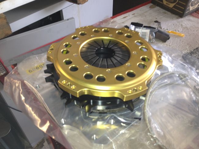

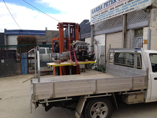

Sirpent Posted November 2, 2012 Author Posted November 2, 2012 Thanks Jamo Did the check this morning when I was prepping the engine and box for transport to ARC and it's actually 620mm so 5mm either end, guess we will see what need doing but I'm still moving ahead with this rack if at all possible. Trip across town went well, but it took me almost 3 hours to load the F*ckers onto the ute tray, secure it all and get across from the west to Mordialloc, nevertheless we all made it in one piece. A couple of pics from today's run across town to ARC, John was kind enough to show me some examples of what I can expect in the adaption along with the twin plate race/street clutch and flywheel they will be making up hopefully starting next Wednesday. New bling, shame it will be hidden under the bell housing. Cheers John Quote

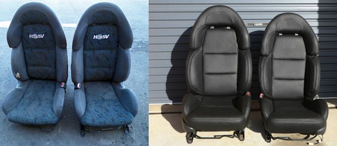

Sirpent Posted November 25, 2012 Author Posted November 25, 2012 Also Bit the bullet again and purchased some seats off EBAY this evening Picked up the HSV Coulsons for $675 which is about 1/2 the going rate. The cloth ones on the left are the EBAY items, the ones on the right are leather trimmed which will be the plan in the futrure. Cheers John Quote
benny Posted November 25, 2012 Posted November 25, 2012 nice looking seats!! have you sat in one before?? they look supportive!! Quote
luvemfast Posted November 25, 2012 Posted November 25, 2012 How will they fit, size wise? They look quite wide and normally go in supertaxi's Quote
dat240z Posted November 25, 2012 Posted November 25, 2012 Nice with leather wrap, but they look mighty wide? I doubt you will have much reclining action as the side bolsters will hit the 3/4 pillar near the door Quote
Sirpent Posted November 25, 2012 Author Posted November 25, 2012 nice looking seats!! have you sat in one before?? they look supportive!! Yeah Benny Spent some time behind a HSV some time ago with the same seats, very supportive and comfortable. How will they fit, size wise? They look quite wide and normally go in supertaxi's Ahhhhhhhhhhhh yes, wide back rests, but the bases are pretty standard, what makes them look even more bulked up is the fact that the adjustable head rests are so huge and wrap down into the lower cushions, I'm sure you will appreciate their comfort from the passanger seat when I take you for a drive one day Simon, be the best Taxi drive you have ever had. Nice with leather wrap, but they look mighty wide? I doubt you will have much reclining action as the side bolsters will hit the 3/4 pillar near the door Not that concerned as even at 6 feet tall I always found I never set the seat all the way back and still had a fair bit of room behind my driving position, so hitting the rear wheel well wont be a concern, as far as the quarter glass frame / pillar I'm pretty sure there will be plenty of clearance. Cheers John Quote
dat240z Posted November 26, 2012 Posted November 26, 2012 Nice one, height is fine as im 6"3 and fit not worries, but the shoulder bolsters on the a pillar will be tight Quote

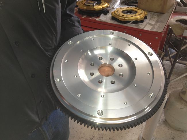

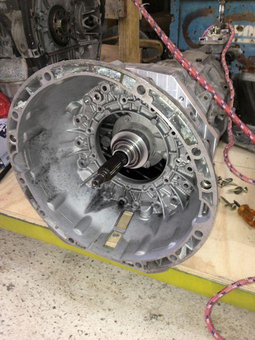

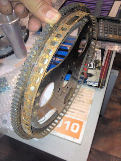

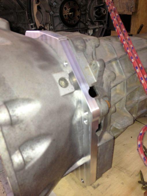

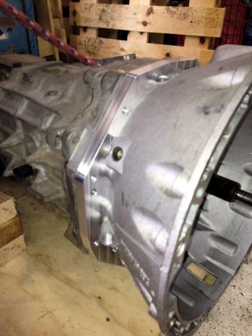

Sirpent Posted November 29, 2012 Author Posted November 29, 2012 Short but sweet update A picture paints a thousand words, hopefully these will also prove I'm not full of sh*t and a dreamer. The adaptor plate has been completed along with the machining of the Benz Bell housing and the photos below taken today show more or less the finished product, John and the boys have done a great job and I was smiles from ear to ear. Came up against a problem with the way the c32 amg crank shaft position sensor on flex plate is set up, as you will note, there is a ring gear built into the assy, attempting to replicate this on a billet fly wheel along with the ring gear would have been complicated and also very expensive. The boys examined the flex plate and determined in it unadulterated form that they can build a fly wheel that will sandwich onto the flex plate allowing for perfect alignment with the original mounting points and associated dowels. So, in the next day or so the flywheel will be machined and I should have some pics of the assy including clutch assy for you all. Cheers John Quote
benny Posted November 29, 2012 Posted November 29, 2012 looks awesome john!! these look like the guys to go to for this kind of work. Hope you havent departed with to much cash though it is a necessary component in the project. Quote
KatoKid Posted November 29, 2012 Posted November 29, 2012 Wow! Thats a funky flexplate. Trust the krauts to make it complicated. Quote
Sirpent Posted November 29, 2012 Author Posted November 29, 2012 looks awesome john!! these look like the guys to go to for this kind of work. Hope you havent departed with to much cash though it is a necessary component in the project. Benny all I can say is thank the good Lord my wife dosent read this thread !!!!!!!!!! Wow! Thats a funky flexplate. Trust the krauts to make it complicated. Spot on david but look closely, the flex plate is made from stainless !!!!!!!!!! If they had spent less time over engineering their war machines and producing mass quantity instead of low volume over quality I dont think the "Z" would ever have come to fuition and we would be a Bavarian vehicle forum. Cheers John Quote
