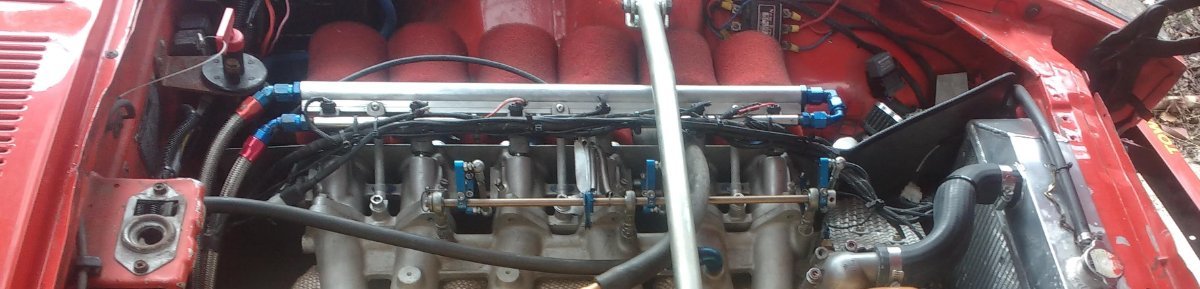

C.A.R. Posted June 9, 2019 Author Posted June 9, 2019 3 hours ago, Brett240 said: Ohhhh that's my old car! I could probably still answer a lot of questions about it if you have them. 2 hours ago, Brett240 said: It was a street car that I used to supersprint. If it's still the original LSD then it's a 3.7. Since your tracking it you can run a 4.1 pretty easily. I put the coil overs and adjustable suspension in it and put the injection rail on it. The motor was 2.95 litres when I had it. L14 rods bored out and a ported P90 Head. Good to see it still kicking around! Will try and find some old photos Ya kidding, Brett?! Jeeze this Z community is small!!! Yes definitely send me some more photos (I'll PM you my email) I'd love to add them to my album. It's had a few changes under Noel's ownership, but obviously not as much as I was let to believe... The diff is supposedly a 4.375 LSD now, but I'm not convinced. I have another 4.375 LSD I've recently had built, so I'll be swapping that in, in due coarse. Quote
Brett240 Posted June 9, 2019 Posted June 9, 2019 (edited) 4.375 will be great if it is, you'd run out of revs at Philip island and bathurst with it though. no probs send it through. i have photos from when she was a bone stock road car as well. the differences i can see form when i had it are the cage and interior strip out, plus if it has willwood brakes now then those have changed, plus theres been some work to the injection system. i had 300ZX vented fronts an AU falcon rears on it. the spolier and wheels i put on it, though i used lighter 16 inch rims for the track. Will have to change my profile pic now that the new owner has turned up! Edited June 9, 2019 by Brett240 C.A.R. 1 Quote

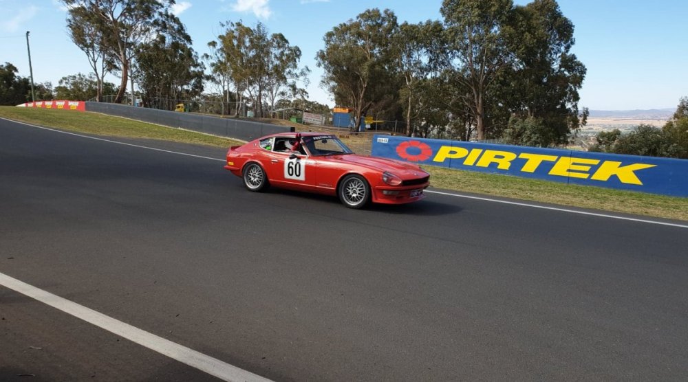

C.A.R. Posted June 9, 2019 Author Posted June 9, 2019 So after taking possession of the 240Z from Noel, a few things had to happen: *New drivers 5-point Harness. *Move the seat back - I'm 6'4" and Noel is 5'7" wringing wet... *Change the gearbox - see above or reason why. So with these items completed, I entered for P.I. on the 27th of April with the MSCA. It dawned a perfect Autumn day, cool but clear - perfect for good lap times. Unfortunately it wasn't to be... On only my 3rd lap, getting used to the Z and bringing the tyres up to temperature, coming up towards Hayshed the engine dropped onto 5 cylinders. Upon returning to the pits, we diagnosed a dead coil-pack. Without any spares or any locally available replacements (a genuine GM LS1 coid pack is required) I packed up and drove home Also during the first couple of laps, I wasn't convinced it was performing 100%, so I felt a dyno tune was in order... Quote

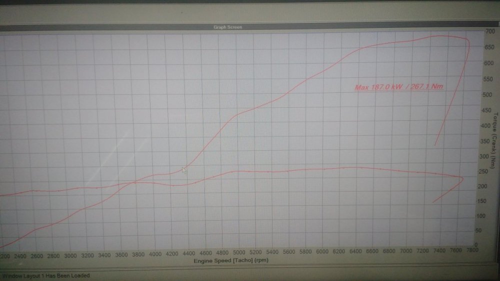

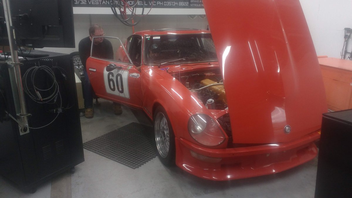

C.A.R. Posted June 9, 2019 Author Posted June 9, 2019 (edited) A few weeks ago, after replacing the coil pack (and ordering a spare!) I booked in with my local Haltech tuner, so make sure everything was in order. Long story short - it wasn't. We cleaned the injectors, new fuel filter and spark plugs. Then we strapped it to the hub dyno. Some fuel and ignition map inaccuracy's were discovered, but thankfully the tuner put it all right. Peter Mac also stopped by to lend a hand and adjust the cam timing. At the end of the afternoon, it netted 187kw at the hubs - quite healthy for a 2.9ltr! Edited June 9, 2019 by C.A.F. OdinZ 1 Quote

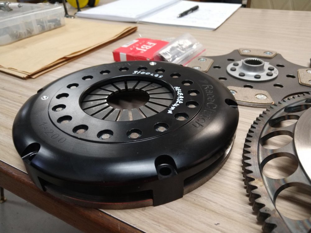

C.A.R. Posted June 9, 2019 Author Posted June 9, 2019 (edited) Sandown was the next outing as per the thread here: Unfortunately failure was rear it's ugly head again, when my best mate Alex, on his 2nd session - came crawling into the pits unable to select gears. Upon jacking it up we found the slave cylinder was working, but the clutch wasn't releasing. We couldn't do anything else so by late morning we packed up and headed home - defeated. WTF?! Is this thing cursed?! We removed the gearbox and clutch this afternoon, and found this: After speaking to Les Collins I learned some new things about clutch's... An upgrade is on the cards! Edited June 9, 2019 by C.A.F. Quote

Administrators gav240z Posted June 10, 2019 Administrators Posted June 10, 2019 On 6/9/2019 at 5:16 PM, C.A.F. said: Thanks mate Finally a proper track Z... I think if I get another, it will need to be a dedicated track car. On 6/9/2019 at 6:05 PM, C.A.F. said: At the end of the afternoon, it netted 187kw at the hubs - quite healthy for a 2.9ltr! Nice power! Especially given the weight of a Z. C.A.R. 1 Quote

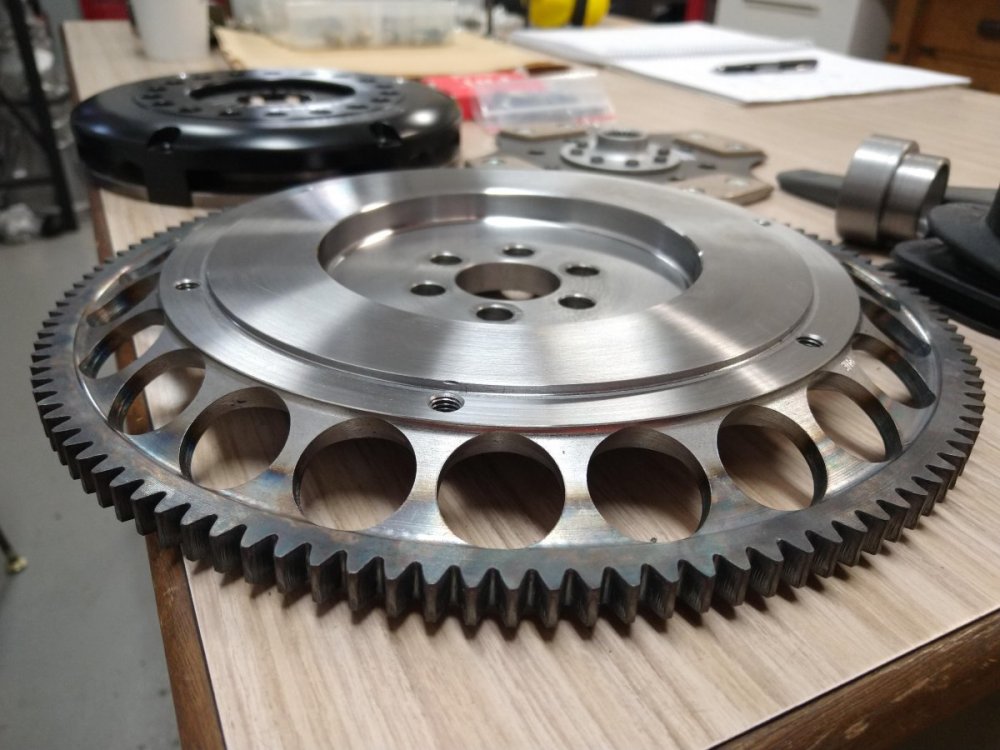

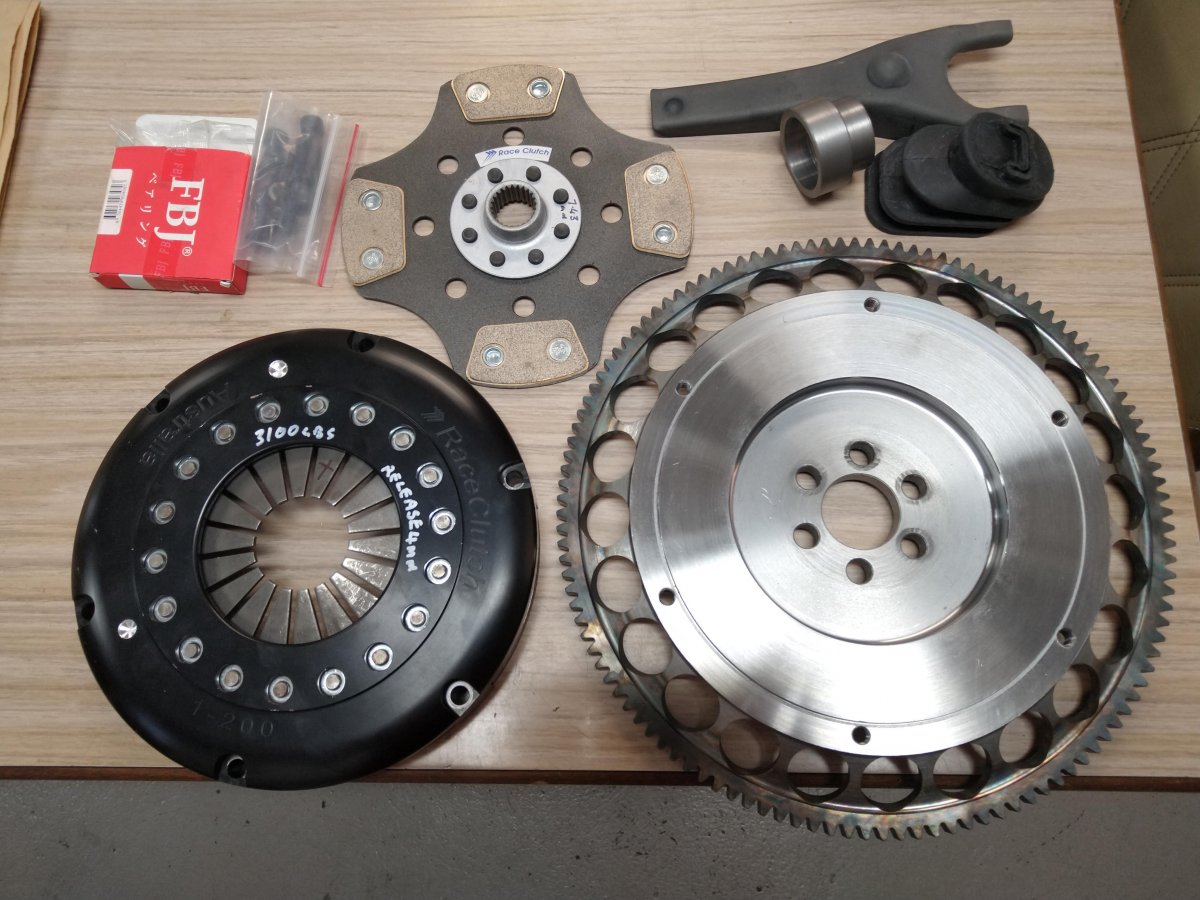

C.A.R. Posted October 3, 2019 Author Posted October 3, 2019 So after a conversation with Les Collins in which I expressed my displeasure of parts not up to the task and wanting a proper fix once & for all, a new clutch assembly was ordered from Jim Berry of "Race Clutch" in QLD. Jim can be a right PITA to deal with, but he's forgotten more about clutch's than anyone will ever know. However there was a problem: the new clutch won't fit the lightweight flywheel I had. The new clutch is MUCH smaller, MUCH narrower and requires an offset AND a receiver step in the flywheel to bolt to. My old flywheel couldn't be machined (not thick enough), so this meant that a new one had to be made... Two months(!) and many hundreds of dollars later, Les had this work of art ready for me. It's a once piece steel flywheel (4140) weighting in at 5.66kg - it can be lifted with one finger! The clutch assembly is equally ridiculous - it come in at just 3.85kg It's a 200mm assembly, billet aluminium pressure pressure plate rated to 2500lbs clamping force, along with a 4 paddle unsprung ceramic driven plate. Les assures me it won't be 'too' vicious... Cost - I'm now living on 2-minute noodles lightmaster240z, KatoKid, ScottyD and 4 others 4 1 2 Quote

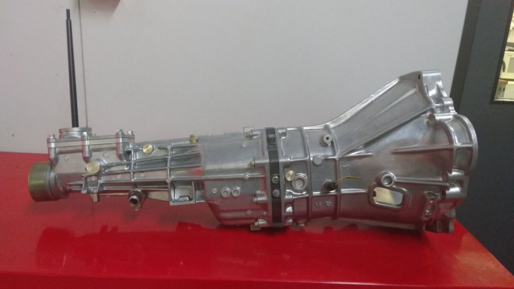

C.A.R. Posted November 7, 2021 Author Posted November 7, 2021 (edited) Time for an update on this pile... It's more or less been unused since CB19 and TBH after it's behavior at Bathurst and also due to the Beerflu not letting any events run, I lost a bit of interest in it. But that has to change. I munted 4th gear synchro at Bathurst, and not wanting to damage the very expensive Kameari kitted 71C gearbox further, I built a new (standard ratios) 71C box for it and that had now been swapped in. After pulling the injectors out to be cleaned some time ago, a wire pulled out of the injector plug. This was a minor issue as I don't possess the correct terminals and crimpers to repair it. But it did give me an excuse to tidy up the birds-nest that is the engine bay wiring... Cue a call to a Z owning mate who does a bit of wiring work for me from time to time, asking if he could repair and tidy it all up. Thankfully he said yes, but he's also ended up regretting it a bit! Old Injector loom wiring: New: And the crap he removed: And the rest of the birds nest complete with many spliced joins! And wait until you see the cabin buchery: How many wires would you like cut, sir? And check out the chocy block joining the headlight wiring together! Barring any other 'discovery's' he should be finished soon... Edited November 7, 2021 by C.A.R. KatoKid, gav240z, OdinZ and 1 other 4 Quote
