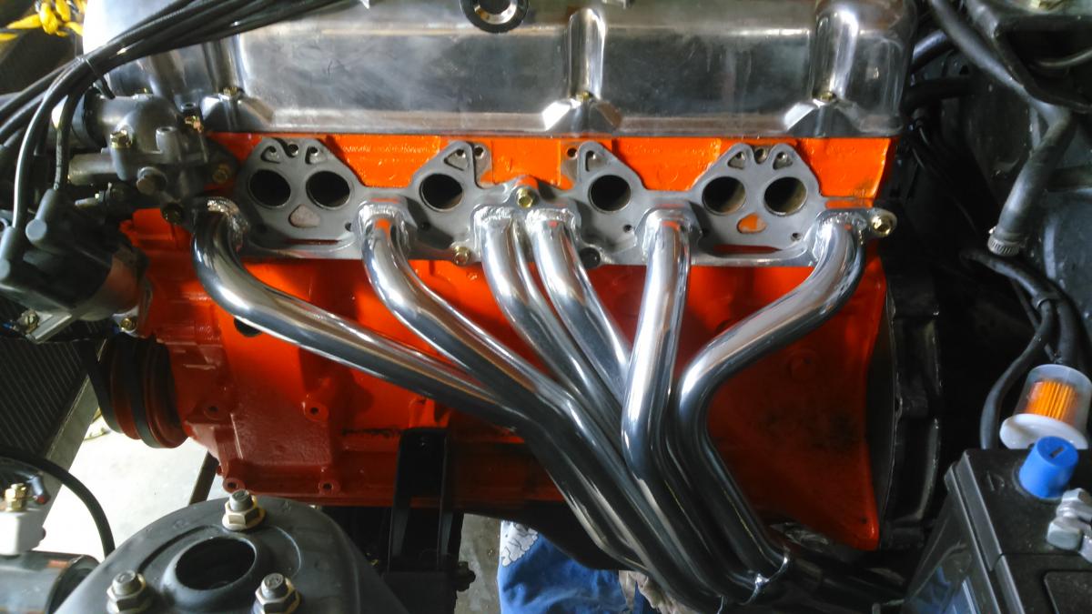

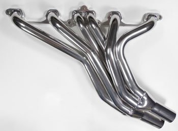

600Z Posted December 16, 2017 Posted December 16, 2017 I’m sure there not SW extractors but I don’t mind the look of them for the price. HomeBuiltByJeff 1 Quote
HomeBuiltByJeff Posted December 16, 2017 Posted December 16, 2017 I’m sure there not SW extractors but I don’t mind the look of them for the price. They look pretty good for the price. 600Z 1 Quote

CBR Jeff Posted December 16, 2017 Posted December 16, 2017 I don’t think you would be disappointed if you went fo the SW option. They look powerful even when not attached. Jeff gav240z, OdinZ and theremm 3 Quote

CBR Jeff Posted December 17, 2017 Posted December 17, 2017 Hi Jeff, how much are they from SW? If you can remember I honestly cannot remember exactly but Lurch may? Mainly because Les from LCR supplied them with the engine. I think they were about $1200 after they were coated? They are the small bore set 1.5" not the larger set. My motor is 3060 cc and made 305 HP so you wont need big bore ones for a. The design and flow of extractors makes a big difference to engine performance. While they may seem expensive in comparison to some other options its cheap HP. Jeff Quote

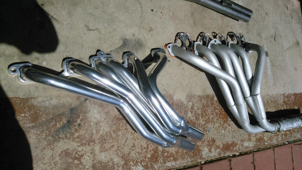

C.A.R. Posted December 18, 2017 Posted December 18, 2017 OK, to clear things up a bit, the headders Ned posted above are the generic Pacemaker / HM Headders style that have been around for decades. These are fine on mildly tuned L6 engines & will clear all manifolds - triples & twin Hitachi's. The ones Jeff posted that are on his engine are the SW Motorsport extractors. They are high performance headders that work best with built higher performance L6's. They are priced accordingly too as they are still hand made - around the $1500 mark (coated). Be advised - they do not fit with the twin Hitachi's. They also foul on certain triple carb manifolds, as the primary shape is longer as it exits the manifold face. OdinZ, gav240z and GongZ 3 Quote

Agno Posted December 20, 2017 Posted December 20, 2017 I've got a set of these to suit square ports (N42 head). The flange thickness on these headers is quite thin, meaning I had to weld up washers to get everything to line up square with my Redline manifold. I'm not sure of the flange thicknesses of the other types of header but at this price point it's probably on the thin side. GongZ 1 Quote
AndBir Posted December 20, 2017 Posted December 20, 2017 .../.... I'm not sure of the flange thicknesses of the other types of header but at this price point it's probably on the thin side. Seems to be a common issue as the SW Motorsport extractors flange is thinner than the flange on the Kameari (Harada) inlet manifold. Quote
