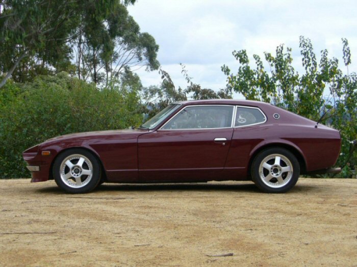

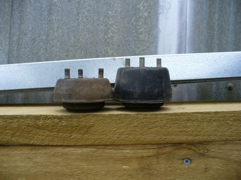

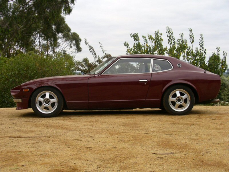

C.A.R. Posted April 29, 2008 Posted April 29, 2008 Guys, Today I fitted the front strut tops into the rear of my 2+2. I'd already lowered it with Kings 'Lows', but I felt it needed to go a bit lower in the rear. As you can see there is a noticeable difference in rear ride height - much flatter. The front strut tops are a bit over an inch shorter then the rears on late 260 2 seaters & 2+2's (see pic). Quick step-by-step Guide: Jack up car & place on Axel stands. Remove road wheels. Undo the sway bar thats bolted to the lower A arm & move up out of the way. Place a brake line pincher onto the rubber brake and unto the rubber brake hose from the body. Undo the half-shaft from the hub via the 4 14mm nuts. Undo the 3 nuts that hold the strut in the strut tower & slide the strut out. Undo the 17mm nut & remove the strut top (use spring compressors to compress the spring if you have the std springs still in). Swap the tops over. Install is the reverse of the removal. Quote
Toecutter Posted April 29, 2008 Posted April 29, 2008 Yes definatley noticable. Sits just right now...hmmm who would have thought you could do that!? Good work. Sulio Quote

NZeder Posted May 4, 2008 Posted May 4, 2008 man where have you guys been - hell zed boys have been doing this for years. And if you want to go lower you can heat up the whole 240z top and the bonding of the rubber bit breaks away from the metal shell. You then remove the rubber bit, cut it down lower still then place it back into the metal shell, then cut the metal shell ie hack saw straight lines down to the new rubber height then fold the metal over to 1. hold the rubber in place etc I would also bond the rubber back in too. This was what racers here in NZ were doing in the 70's and 80's with 260z and 240z. My 260z had these lower 240z top installed since 1991 I thought everybody knew this trick. Quote

620Z Posted May 5, 2008 Posted May 5, 2008 That looks much better Lurch. Good job. Make sure the tyres won't rub on thos bumps before the next Tassie trip. Quote
C.A.R. Posted May 5, 2008 Author Posted May 5, 2008 I've already driven it round the roads here Craig - not a problem Quote
stevo_gj Posted January 21, 2009 Posted January 21, 2009 Stupid question but... can I just check that when you say swap out the rear strut tops, you mean with a spare set and not swapping front to back? Quote
C.A.R. Posted January 21, 2009 Author Posted January 21, 2009 NOT swapping front to back Steve. You need to get a 2nd pair of short strut tops to fit into the rear. Quote
