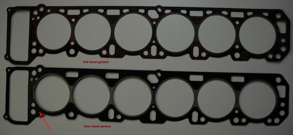

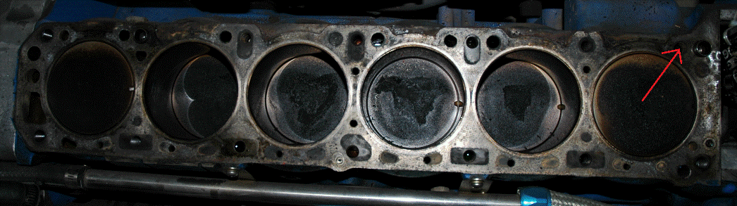

  20. Thanks for the info guys. I'll punch out the small hole to match the block and head as it doesn't sound like it is there to generate any additonal pressure and more flow shouldn't hurt. Should I also punch out any additonal holes to match the block and head not in this new gasket? For example missing holes either side of the head bolts on the spark plug side (top of pic).
  21. Hi Zedders, Would someone be able to confirm if: a) Durapro (GSDJ380D) head gasket is the correct gasket for a L28 engine (F54 block with a P90 head). Pic below shows the difference between the old gasket which was fitted and the new one supplied by the workshop which reconditioned the head. They advised me the old one is a generic gasket and the new is a factory copy....is this correct? b) I should enlarge the water channel indicated with the arrow on the new gasket, as it is smaller than that of the block and the head? Thanks in advance for any advice which will mitigate any potential disasters before I bolt the new had down. Simon R
